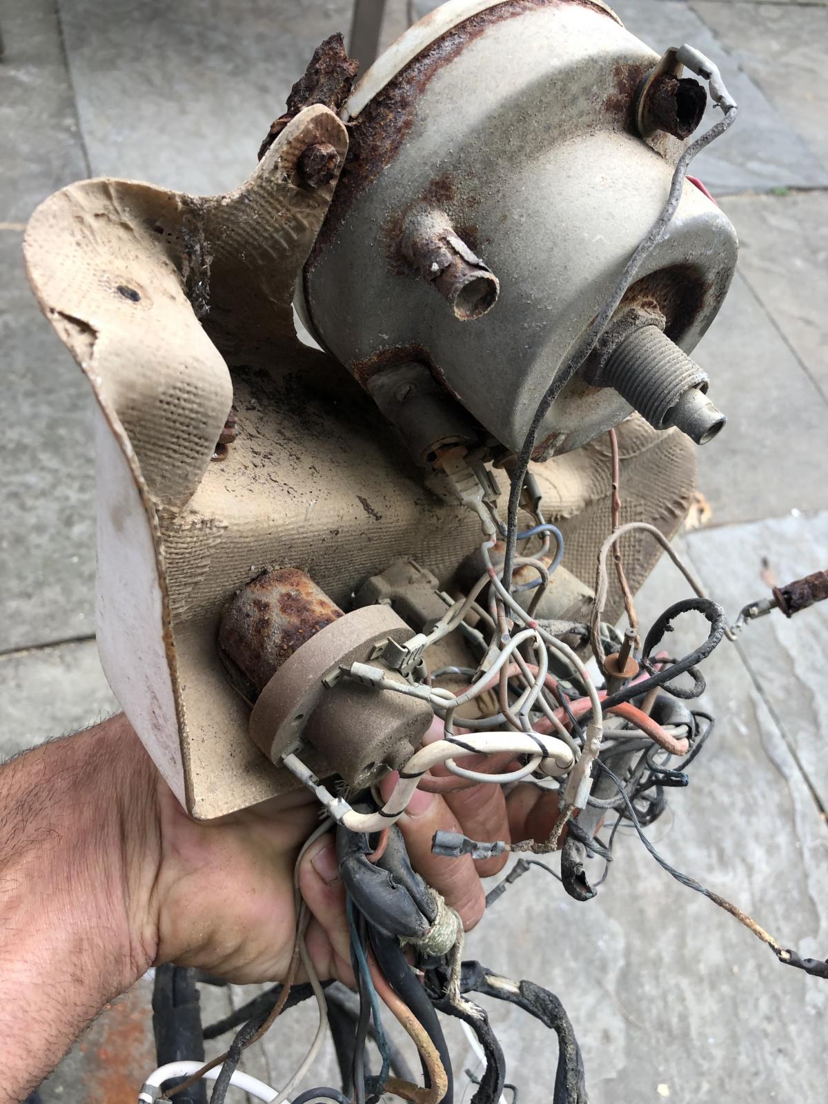

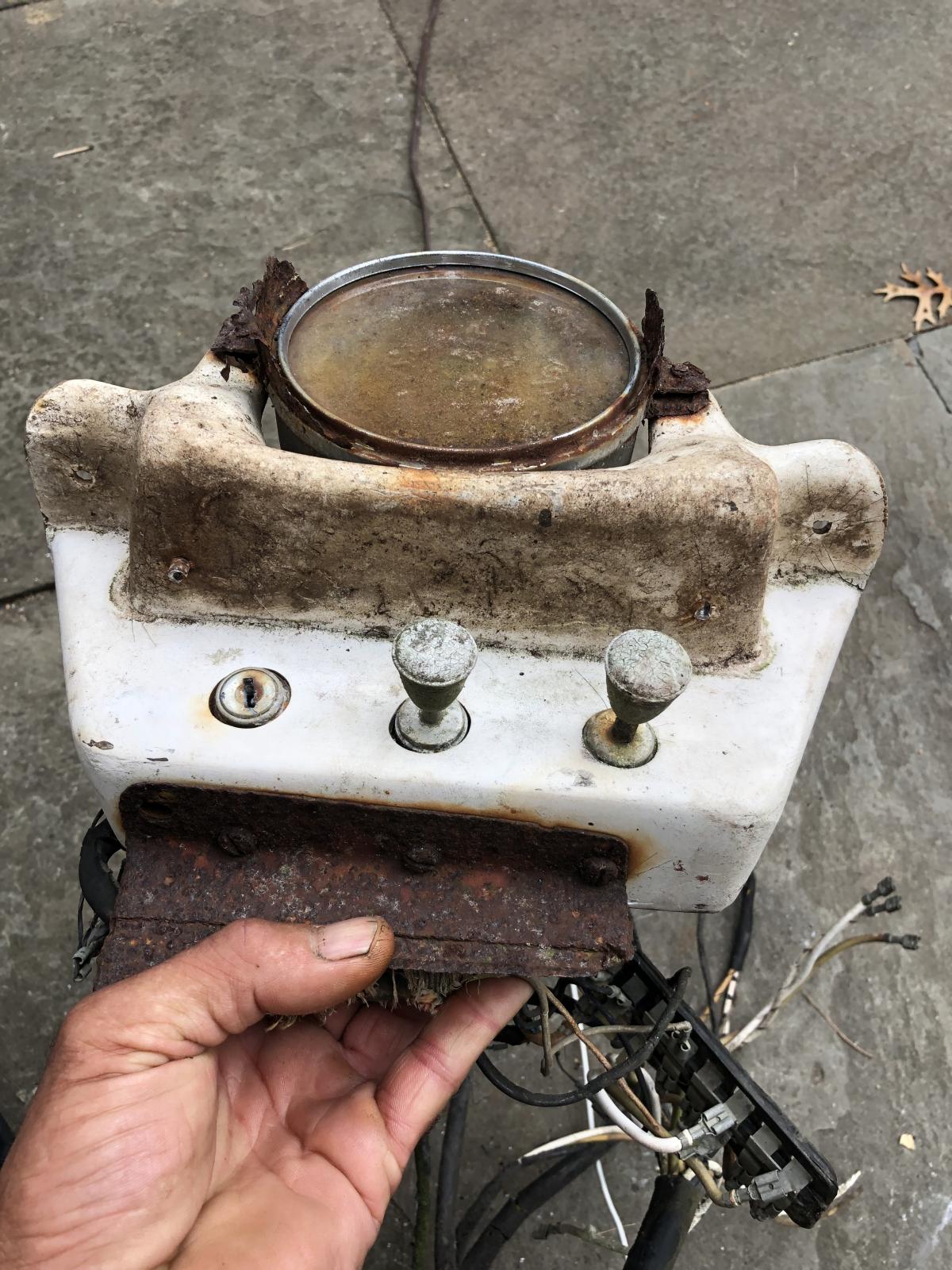

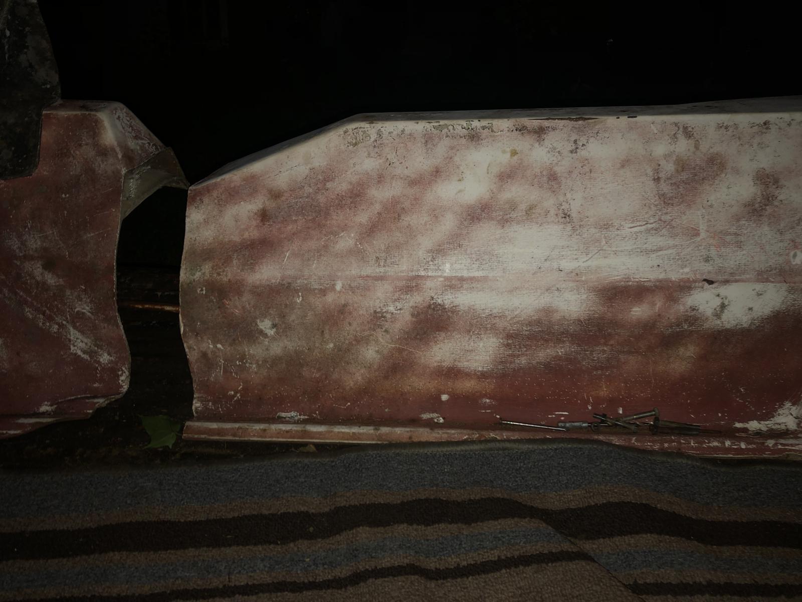

it’s all fiber glass It was cut in half The windshield&dashboard were built like a console that bolts to body. Yea man it fits a shortened and chopped Baja split bus platform. The hood sits over the tool box and the tail section sits over the fuel tank compartment of yes prob a 56 up bus or truck platform. It’s well made a lot of cool details. Same thing but looks more like a cartoon bus then a used jeep I’ve never seen one either. Just discovered it in Florida

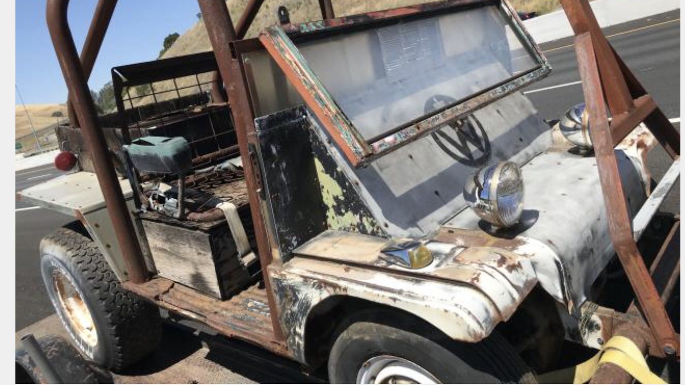

A few more pics. I hope I’m not bombing your thread. It’s just I feel these things could of known each other at one time. I do hav a theory on maybe how it possibly ended up adrift in Tampa Florida. Pics of Baja I bought on its way to me. I’m new to forums & uploading gallery photos. But I think I got it!

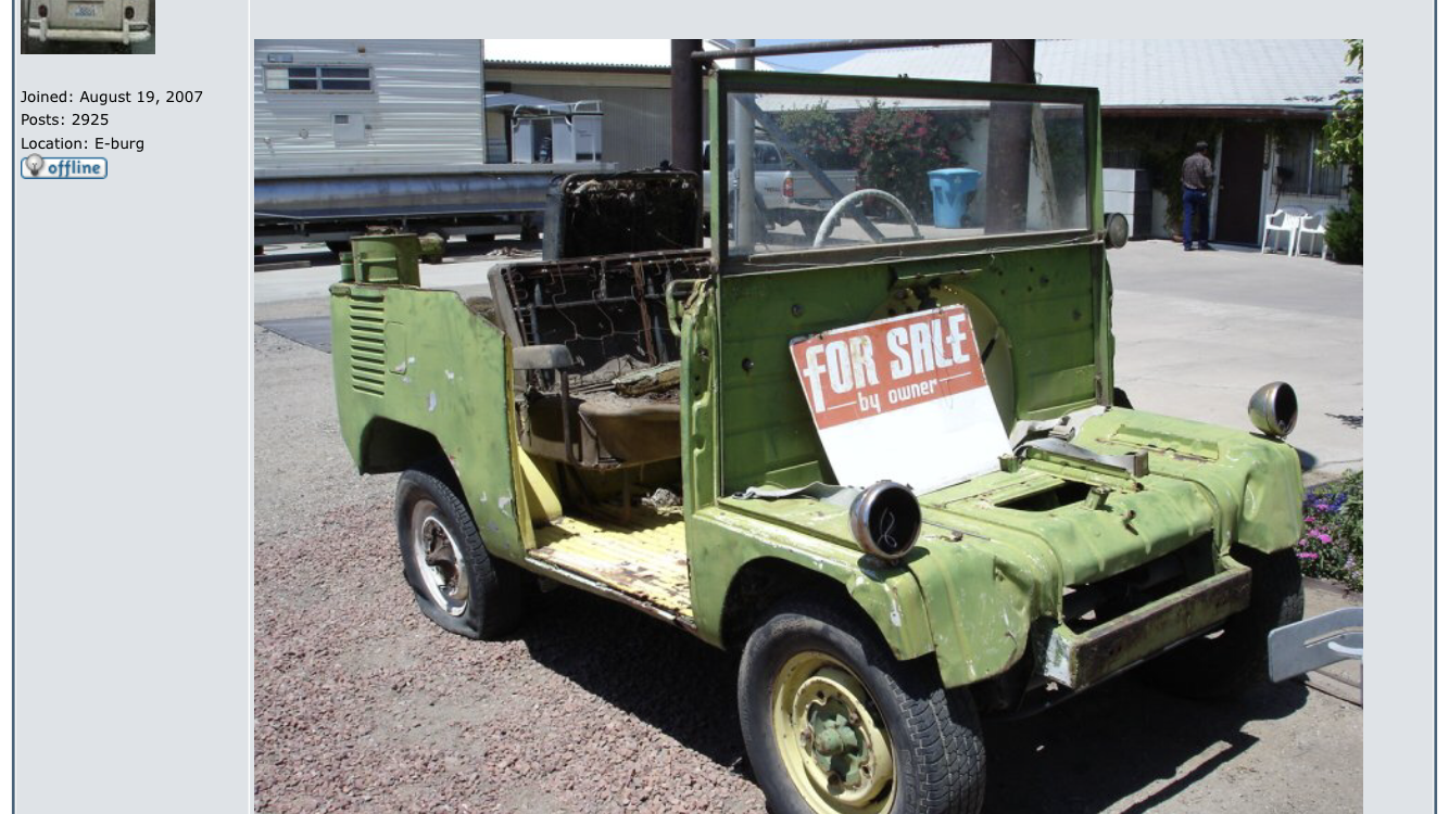

I’m not too far from you, in NC. When you bring this to the East Coast, we’ll have to get these two together at a show!

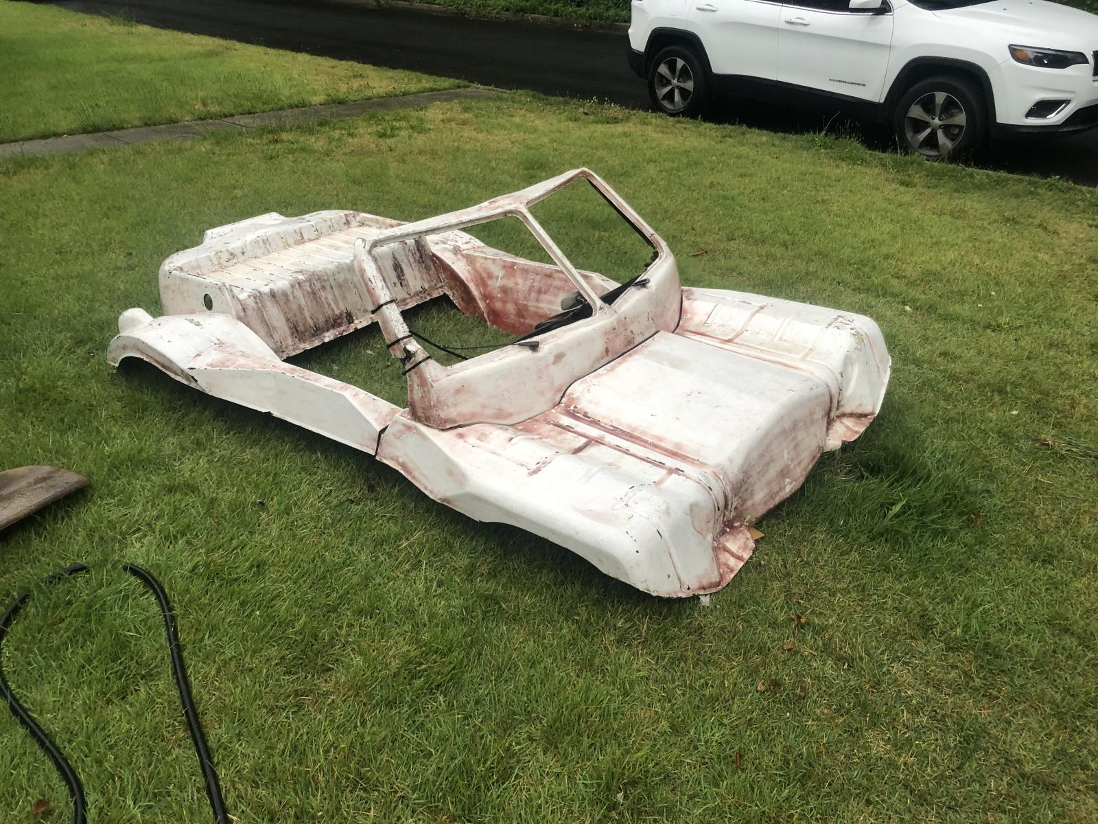

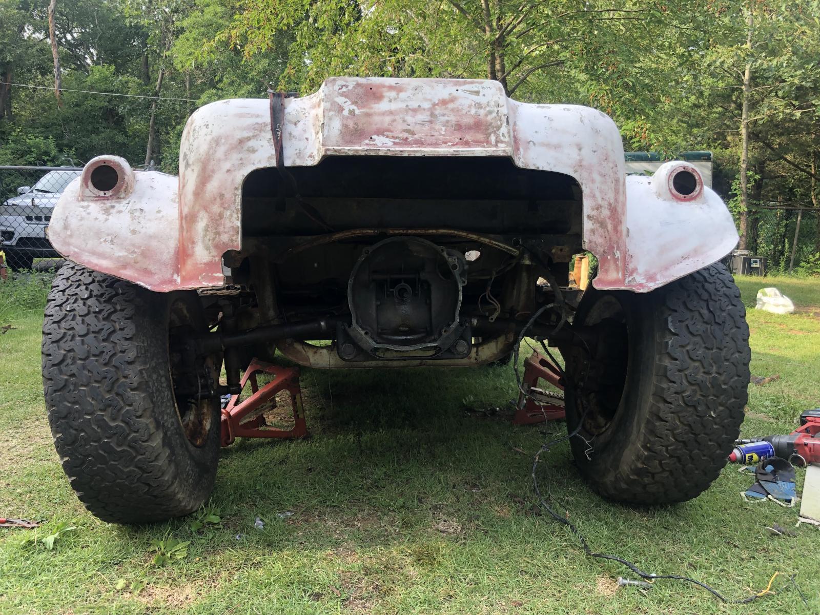

Cool is that the green machine from Arizona fixed up. Or is that another one? Mine is becoming a fiberglass bodied Baja bus. Which must of happened 50yrs ago also. Frame needs to be shortened another 3-4 inches. And it appears it used a bug steer column and box clamped to tge bus beam after some adjustments. That will clear up the foot room at pedals. While putting the steer wheel where it needs to be.

Check if the body fits a bug or ghia pan because based on the design of 3rd pic, it may be plausible it will fit a shortened bug body the same way they did with Manx-based bodies? You might be able to repurpose the bus into another buggy of any design. Think

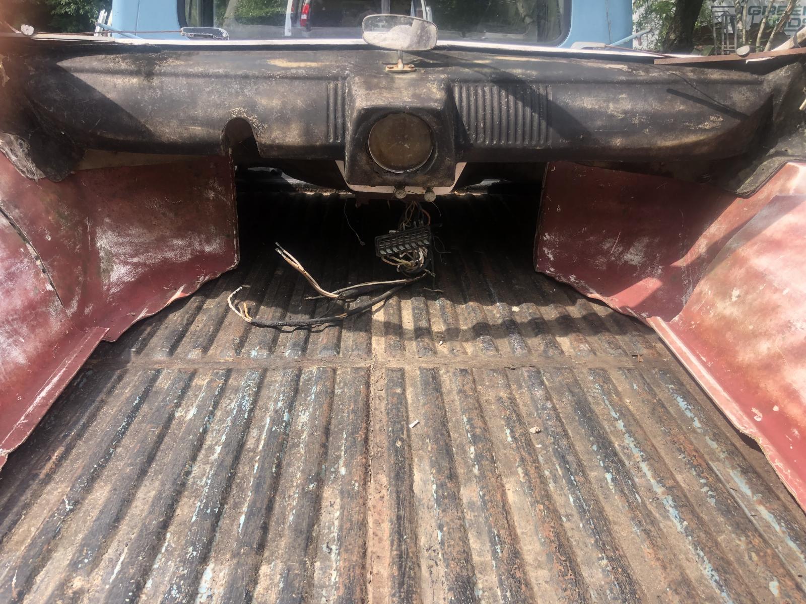

I see what your seeing. Tge way it tapers in upfront like a bug pan. But notice the rear firewall matches the bus stamped floor metal perfectley. The side rails of body also are corrugated to fit bus floor. It’s been determined that this is a proto type one off body still in plug form it’s construction is old. Tge taper upfront was necessary for front tire clearance. Like ckipy I found a split bus with no rot already cut down. It still needs to be 3 more inches shorter. Which I’m preparing to do. After designing this body. Somebody may hav also realized a bug pan is more suitable. So it’s a bus chassis. So far I added a bug steering box on bus beam so column lines up thru the dash board as tge body shows it did. I plan to use a napoleons hat and short tunnel piece at toe board in place of top hat. So that it will fit and use a bug pedal cluster. Shifter and e brake will be tge bud bracket moved back again. Lot of work this kit would of taken. Is why I bet this idea was scrapped initially. I bet. To preserve dune bug history. I’m building it on a split bus chassis as it was intended to. Besides that. It will not be grooming the sand on beach like my bug chassis buggy. Look how high it is lol I’m psyched It will be up high out of the ruts.

Other reasons for keeping it bus. The fuel tank. Bus tank sits in the bus tank shelf in its straps and lines right up and out with the existing fill neck hole in body. If it were on a bug chassis. It would be back to tge drawing board. !!!! Instead of back to tge beach right quick. Feel like I’m keeping it real and Sailing right thru it’s re construction. This body was found in Quincy/Tampa Florida & Tgeirs good reason how it got their say in 1981 from west coast (punta Cana moved from costa to Tampa in 81. Punta previously Jensen marine Costa Mesa ca. Well in 68 Jack Jensen sold boat building facility to punta. 1981 punta moved entire facility to Tampa. Hey you know when u hav a good feeling about something. It’s usually true. I’m a dreamer always was. But this body is significant no if’s ands or butts about it. And if I’m wrong and it’s goofy’s bus that’s cool too. I will rock it regardless. Tge red primer on this thing proves to be guide coat. For block sanding. Once u hand make a mold using coarse woven roven fiberglass. It’s usually ruff and needs a lot of polishing and detail work before a negative casting can be pulled from it. Is what I’m learning Well it’s safe to say that never happened.
