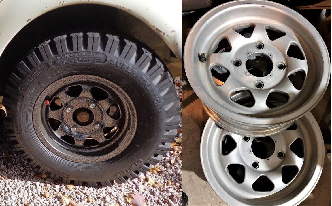

Several years back, I had another set of 14-inchers, which I bought from another top-notch Samba seller located in New Jersey (the one and only Richie of richiesgarage fame--he even arranged to have them hand-delivered to my house in CT--whatta guy!), and had refinished by my favorite local powder coating company (then known as "Shoreline Coatings," located in North Branford, CT--I've since heard that they are now part of "American Dry Stripping & Powder Coating" based in Milford, CT, and the North Branford operations are closing up and moving to the Milford home base). Then put some mongo super-heavy-duty Jeep-type knobby bias ply tires on, and had some fun driving them around on my former Creeky '69 Bug (this picture is from November of 2013):
Eventually I realized it was a pretty harsh tire for the relatively lightweight Bug, and sold the wheels & tires separately. I eventually got the itch to find those old wheels again, and made contact with a relative of the person (a very good long time VW hobby friend, who has since passed away) who I gave them to, but sadly, they were long-vanished. That's what set me off on the new search for another set of 14" Gurneys (and yes, I did go back to Richie first, but he did not have any in stock)...
Some side notes on the original set of these on the Creeky '69 Bug (shown in the picture above): The car had been fitted with Karmann Ghia front disk brakes by the previous owner and so I needed to run some 3/8" spacers, in order to get the wheels to clear the calipers in front... The name of the mottled-looking finish on the wheels is a powder coating called "Black Vein," and is kind of silvery, with a random pattern of depressions that come out black, giving a unique overall appearance. In looking at some online pictures of "Black Vein," however, I think this coating kinda looked more like "Black Frost," reference: https://www.prismaticpowders.com/shop/powder-coating-colors/PVS-3083/black-frost ... I liked it, but I was already thinking of some other type of look, if & when I found another set of 14" Gurneys...

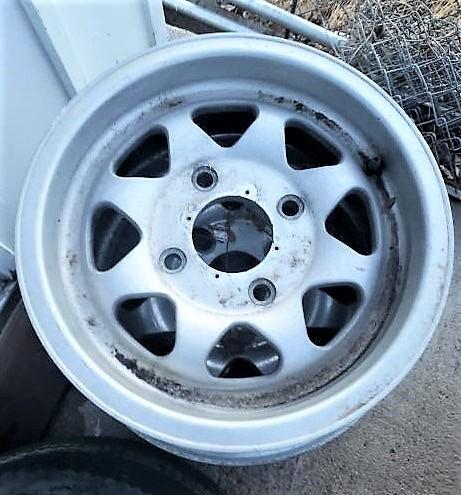

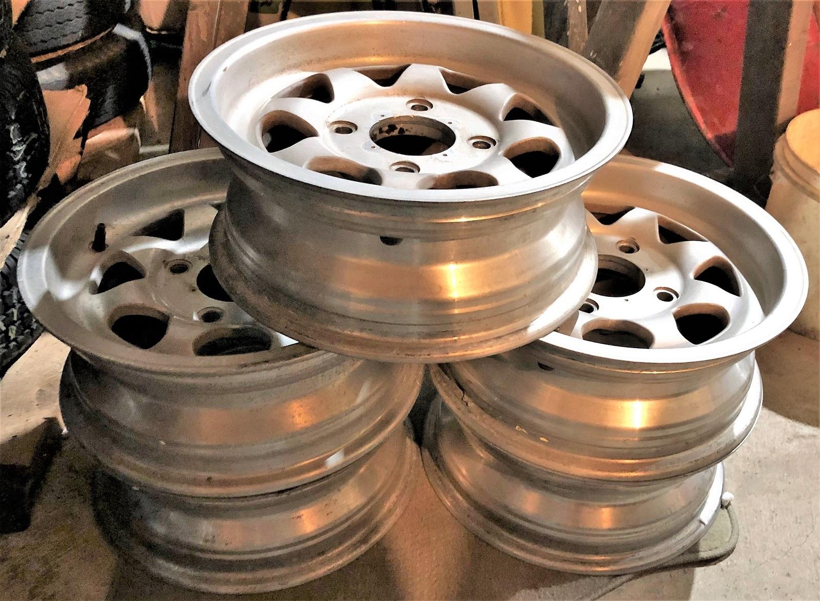

As-received pictures, as of early February 2021. I got five really nice pieces! Very pleased! Thanks again to excellent Samba seller Trevor!
Here's a little side-by-side juxtaposition of the old 14" Gurneys (left), and the new Gurneys (right). Aside from the different configuration for center cap attachment (old appear to require push-thru from the back; new has four little screw holes on the front face for attaching a 4-ear type center cap with for little screws), I think the edges of the slots on the new ones have a more "rounded" appearance, while the old ones I think had more "angular" edges (I know, hard to see, with the powdercoat finish):

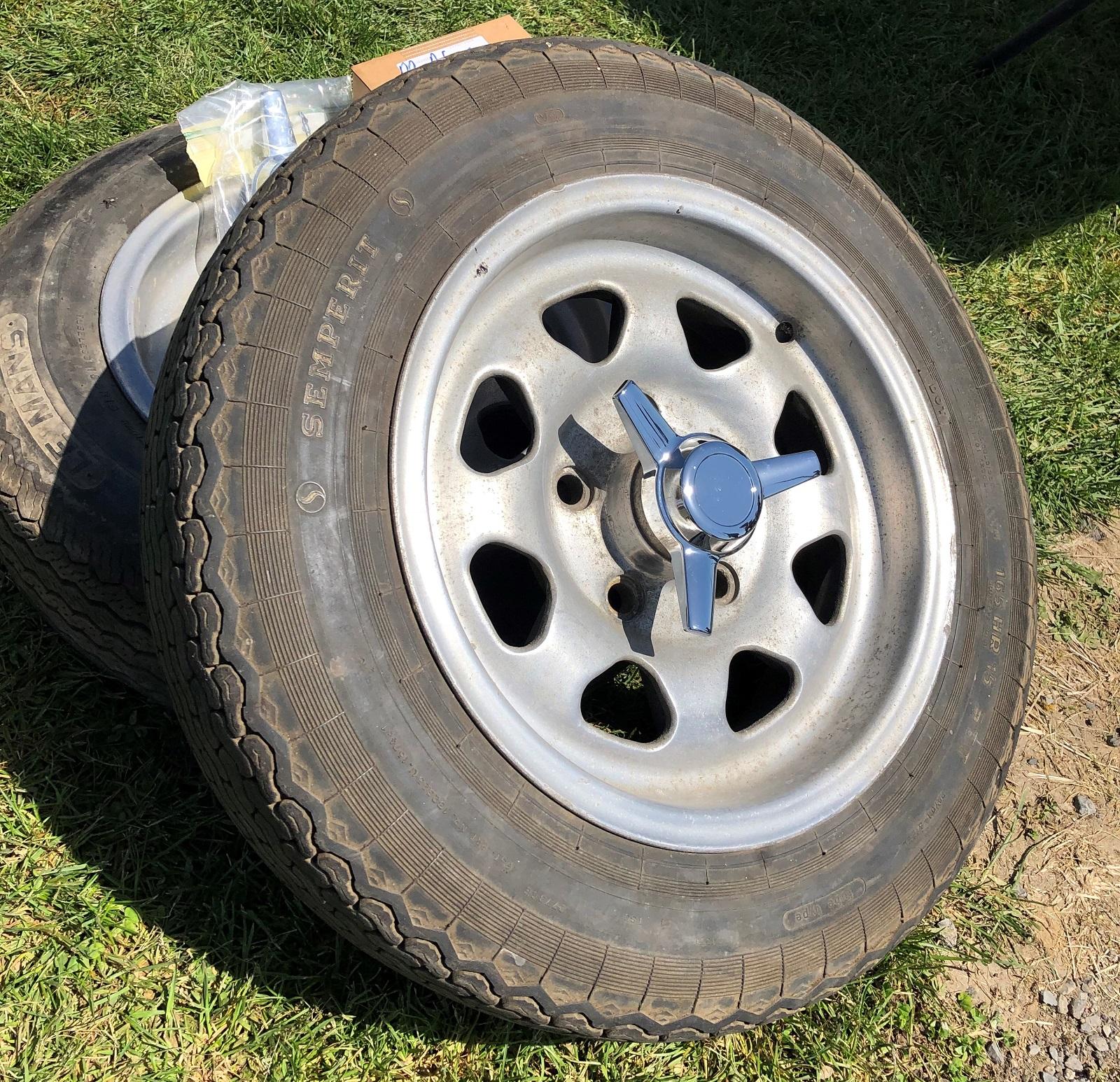

And this is just a picture that I figured I'd throw in, taken by my long-time old-VW friend "Rome" (@TheSamba), that shows one of his former 15" Gurney wheels, his cat checking it out, and also an example of the shoulder-type lug bolt that is needed to attach these to the '68 & up VW Type 1 brake drum (along with a washer; there appears to be one stuck on the bolt in this picture). I used this photo in a "wanted" ad on TheSamba to see if I could acquire a few more of these bolts, since they appear to be very much "NLA" these days:
And finally, here's a quick snap of a real McAfee wheel, that I believe all of the various Gurney variations were modeled after. This was a "hot" aftermarket wheel for disk brake Porsches. The McAfee wheels have the raised "nose" in the center, which in this picture, has some kind of custom spinner attached to it. I don't know what the asking price was for these, but I'm sure it wasn't cheap. Notice the nice rounded edges of the slots. I took this picture at the Central PA PCA Porsche Swap Meet in Carlisle, PA, on 4/30/2022, reference: https://www.thesamba.com/vw/forum/viewtopic.php?t=767807&highlight=

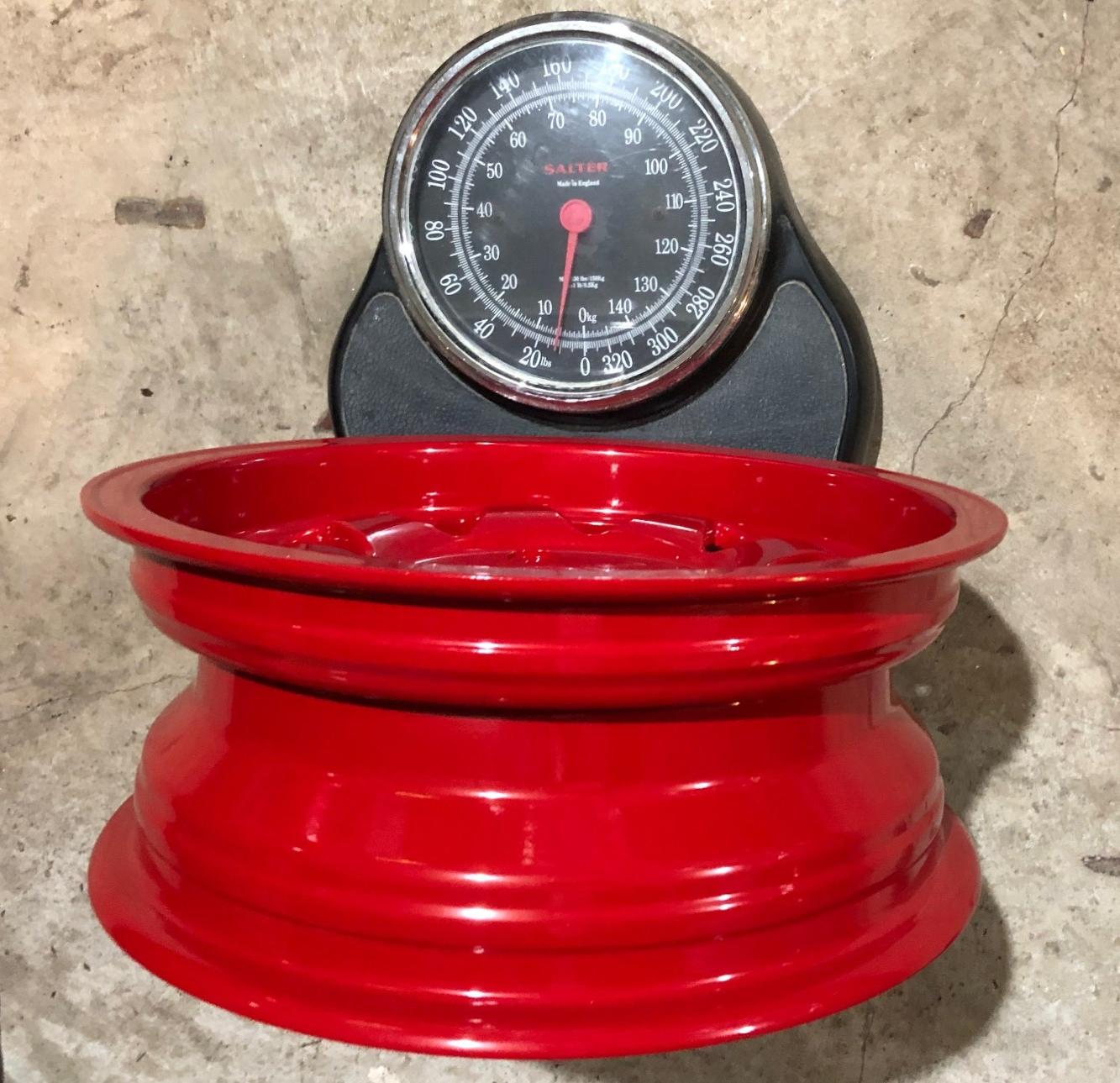

To answer a question about weight of a 14" Gurney wheel (Per-Spec Industries mfgr.)...
Stuck the one extra that I had w/o a tire on it, on the bathroom scale--looks like somewhere around 10 or 11 pounds. So they are actually pretty light!
Will be getting back to more in-progress updates next chance I get, but I wanted to make sure to answer this question about the weight.

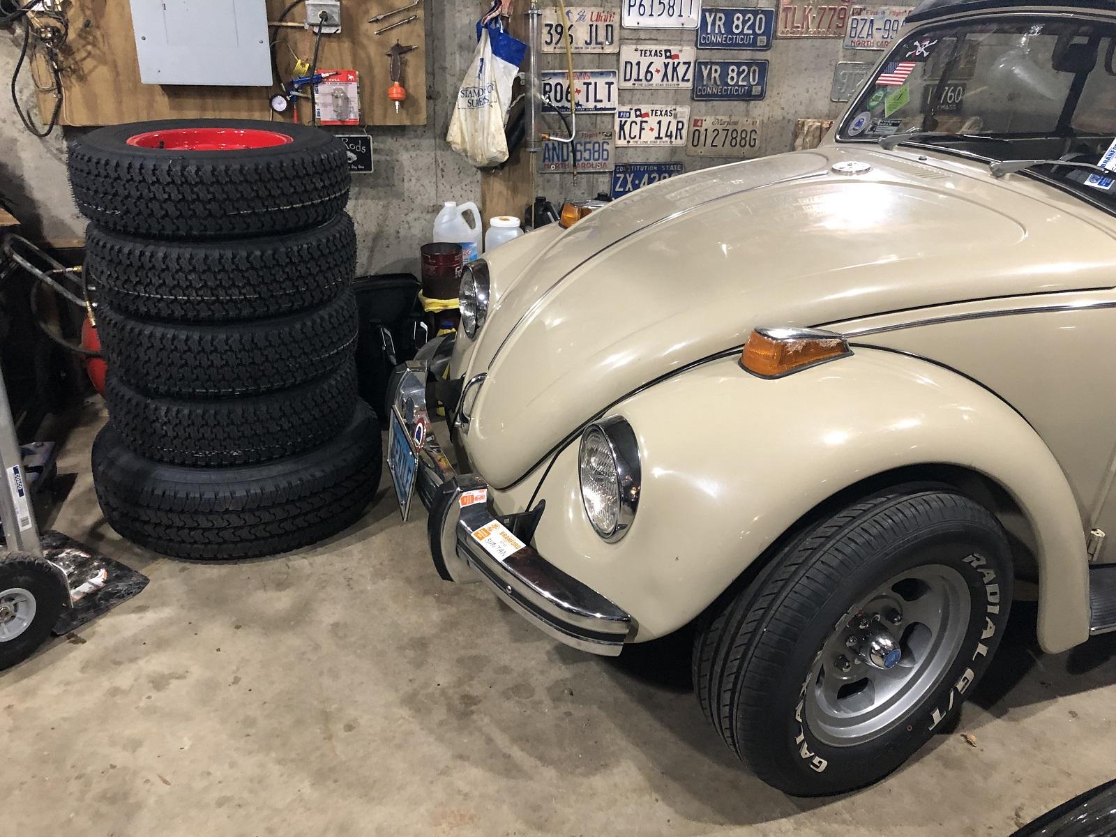

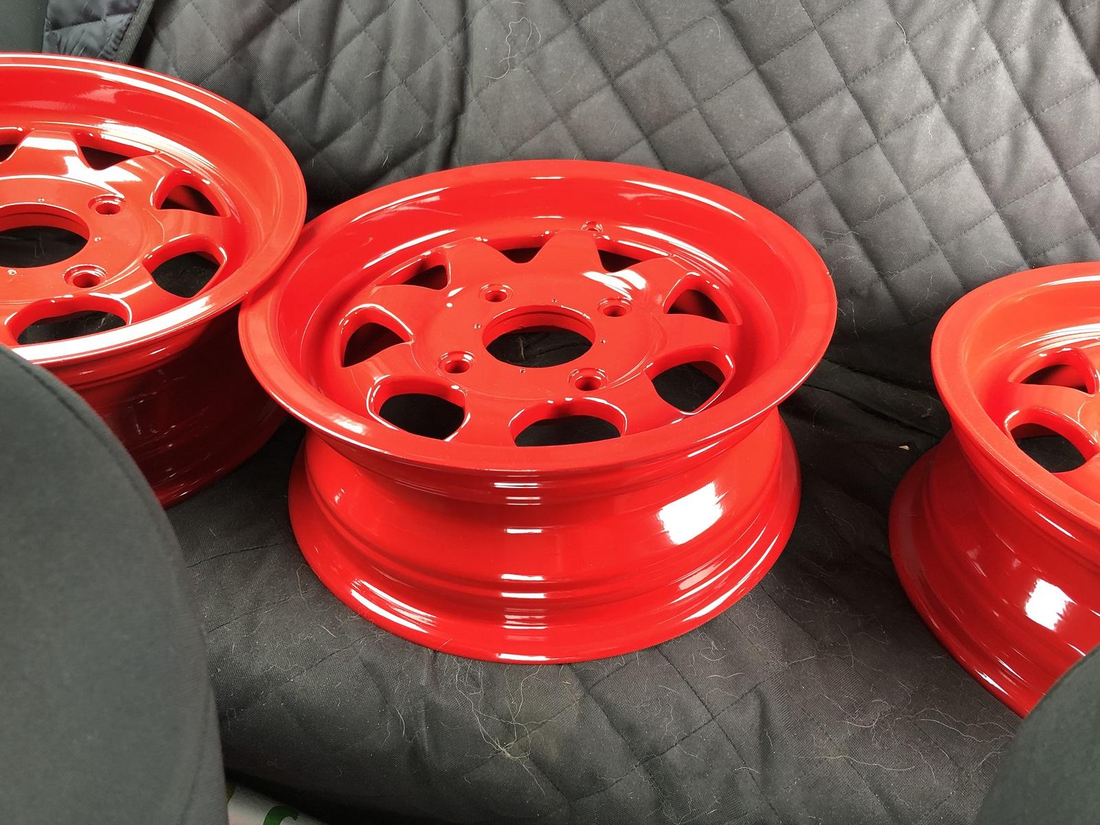

Tuesday, May 3rd, 2022: Picked up the five beautiful gloss red powdercoated Gurneys from American Dry Stripping & Powdercoating of North Branford, CT (they have since closed the North Branford shop and consolidated their operations in the Milford, CT shop)...
Wednesday, May 4th, 2022: Brought four of the refinished wheels, and the four Goodyear LT 195/75R14 Wranglers (25.5" OD) to my favorite local auto repair garage, Stony Creek Auto Service of Branford, CT, for expert mounting...
I was so pleased to learn of the existence (for the time being, anyway, I don't think a lot of vehicles use this size any more--maybe 2WD mini-pickups back in the day, but that's probably about it) of these tires: Goodyear Wrangler Radials, size LT 195/75R14. They were *not* cheap. I found mine on ebay. I bought them probably a year or so ago, because I was afraid they'd "disappear" (become NLA, in other words). So, they had been sitting, sitting, sitting in my basement for quite a while, waiting for me to do something with those wheels! Here's a "manufacturer's" type image illustrating the tread pattern & sidewall detail that I grabbed from the internet:
Next time, we will move on to putting them on the car...

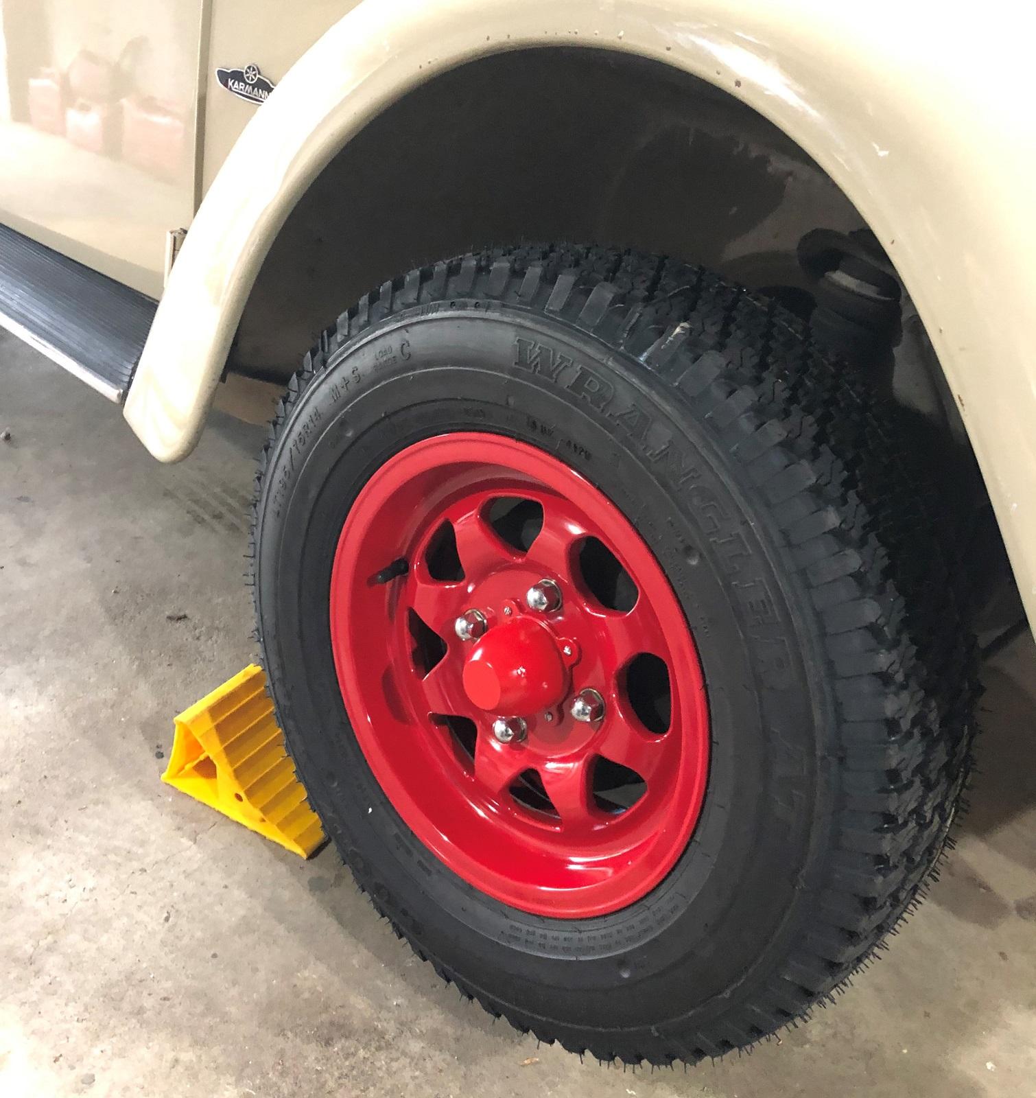

Installation Day finally, Saturday, May 7th, 2022...
Got the Gurneys with Wranglers mounted up back from the local garage, and getting ready to get them onto the car... The previous cool set of wheels/tires were coming off: refinished (powdercoated silver) "US Mag" 14"x6" 5-slot mags with 205/70R14 raised white letter radial tires (still for sale at this time, reference: https://www.thesamba.com/vw/classifieds/detail.php?id=2490268)...

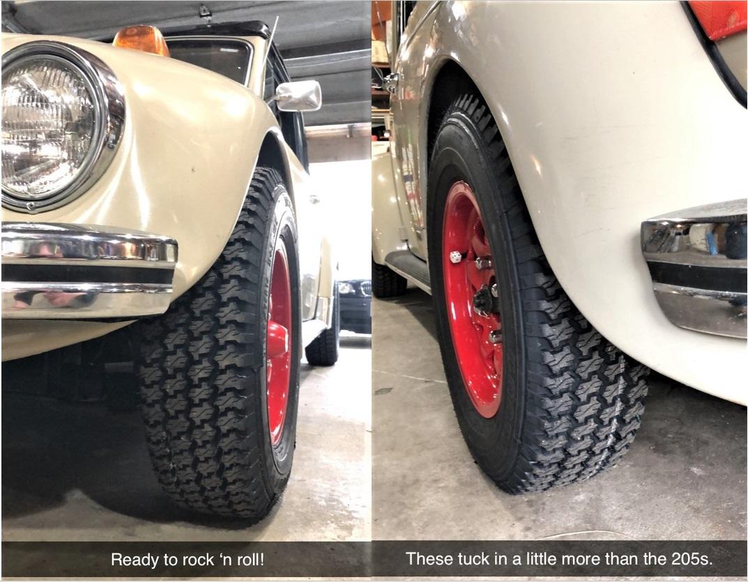

Installation Day details, Saturday, May 7th, 2022...
Got the Gurneys with Wranglers mounted up back from the local garage, and had some fun getting them onto the car...
Wasn't sure about whether or not to run center caps--I had a set of gnarly ones that I had painted red, and tried them on the fronts, not totally happy with those, so I was already thinking about moving the "blingy" center caps from the 5-slots over to these...
Not bad!

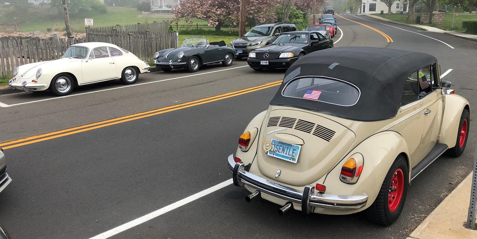

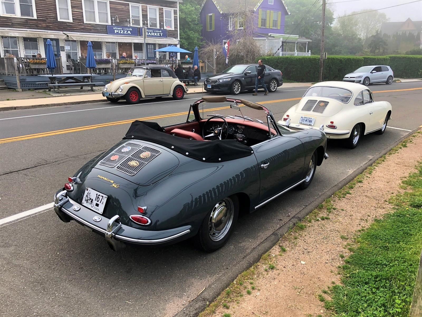

Some initial local test driving with the new sneaks, 5/16/2022...
Short little drive over to Stony Creek Village, in Branford, CT, on a beautiful afternoon.

Also had driven down to Stony Creek Village on Saturday morning, May 14th, to meet up with some of the local 356ers for a coffee klatch. One peanut gallery comment I heard about later: "What's he got on there, SNOW TIRES?!"
Foggy morning by the water, but soon cleared up into a nice day.

This is a picture of one of the repro center caps, still attached to one of the 5-slot wheels. The caps are plastic, and I found them somewhere on ebay. They came without any emblem in the center, but after some research I found these nice ersatz "Empi GT" emblems sold by CIP-1. I think they were available in a couple different diameters. I made sure to measure the cap's flat mounting area for the emblem, and thankfully ordered the right size. They came with an adhesive backing, and were very easy to pop onto the caps, and they seem to stay on pretty well. The caps are a 4-ear design, and thankfully the exact same pattern of threaded holes were on the Gurneys, so all I had to do was switch them over, with the same attachment screws.
