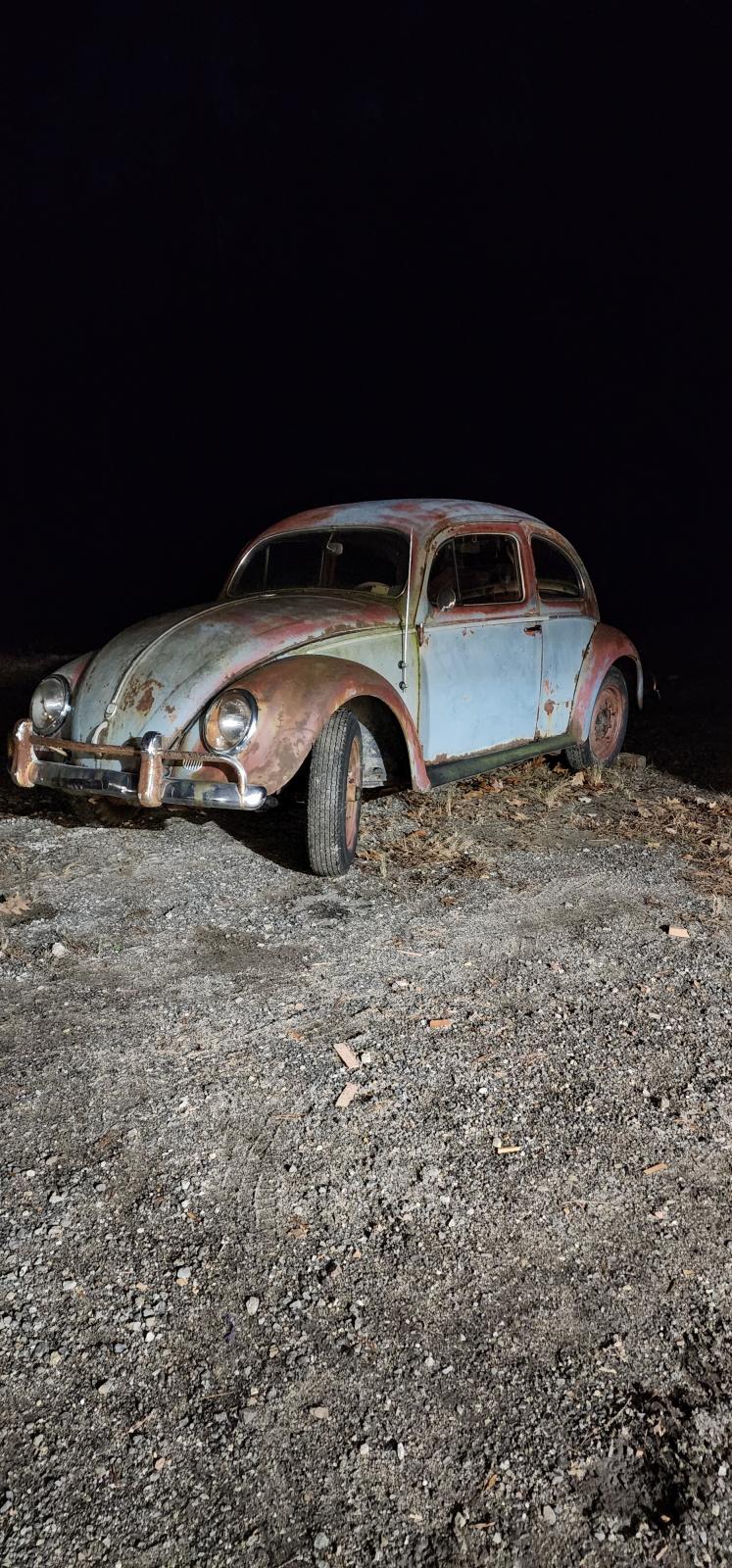

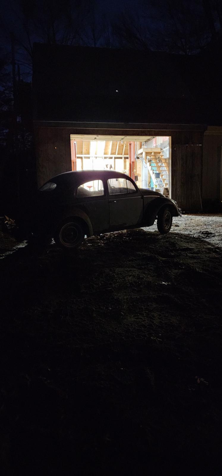

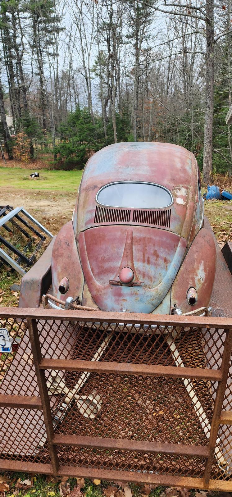

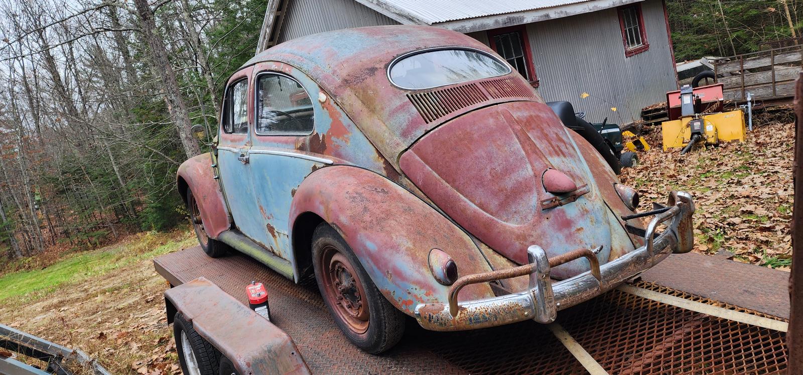

On Novemer 6 2022 the '55 Oval landed at my house.
After being in the automotive industry for the past 10 years full time I have a lot of experience and I feel as though I'm ready for the restoration!
The vehicle sat in my garage from November tell late May when I decided to tear into the project!
All good things take time right?

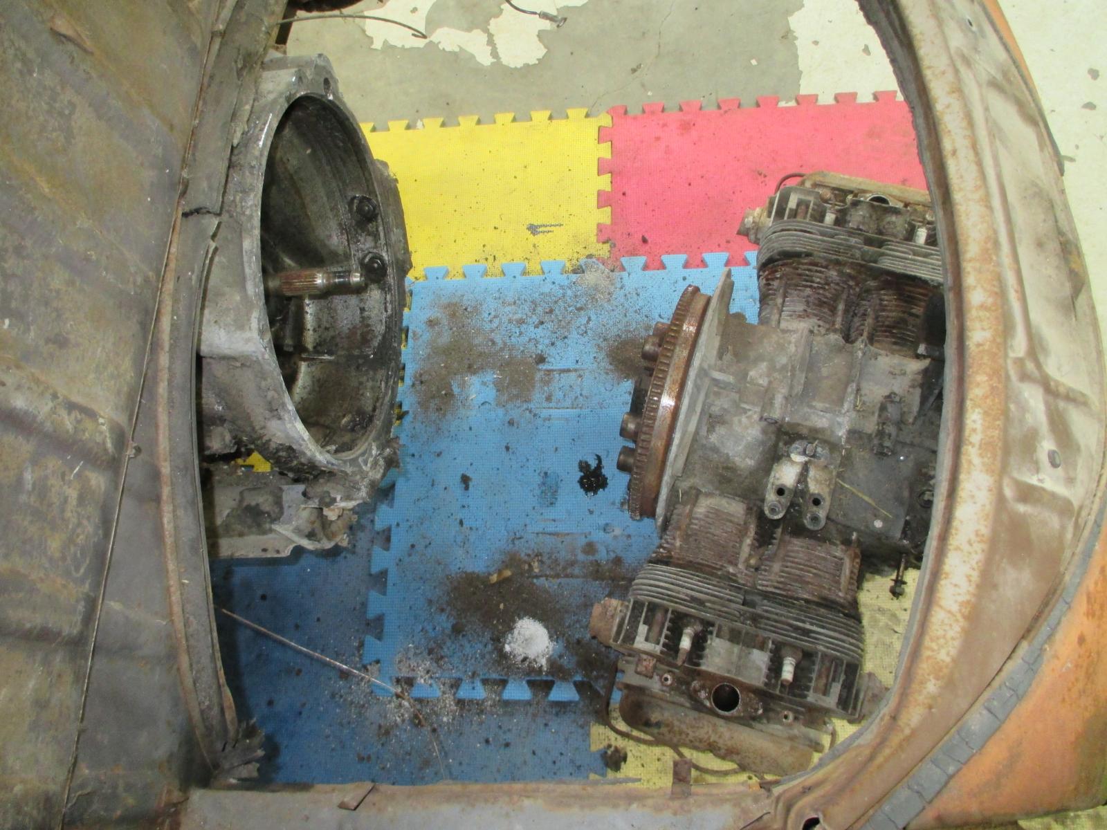

In excitement knowing the engine was running my father came over snd helped remove the engine so we could check out the clutch situation.
Once all the bell housing bolts were removed we attempted to sperate the engine from the transmission. But we were unable to detach the engine from the transmission because the clutch friction plate was seized on the input shaft....
After a few searches on this site for engines being stuck to the transmssion I determined that I had to detach the clutch pressure plate from the engine flywheel.
I proceeded to remove the 6 pressure plate bolts with a custom bent 14mm wrench through the starter hole in the transmission. Once the pressure plate bolts were removed the engine was then able to be removed from the vehicle.

If any ones made it this far here are some pictures. Pictures of the day I picked up the beetle to pictures of me pulling the engine (06-04-2023)

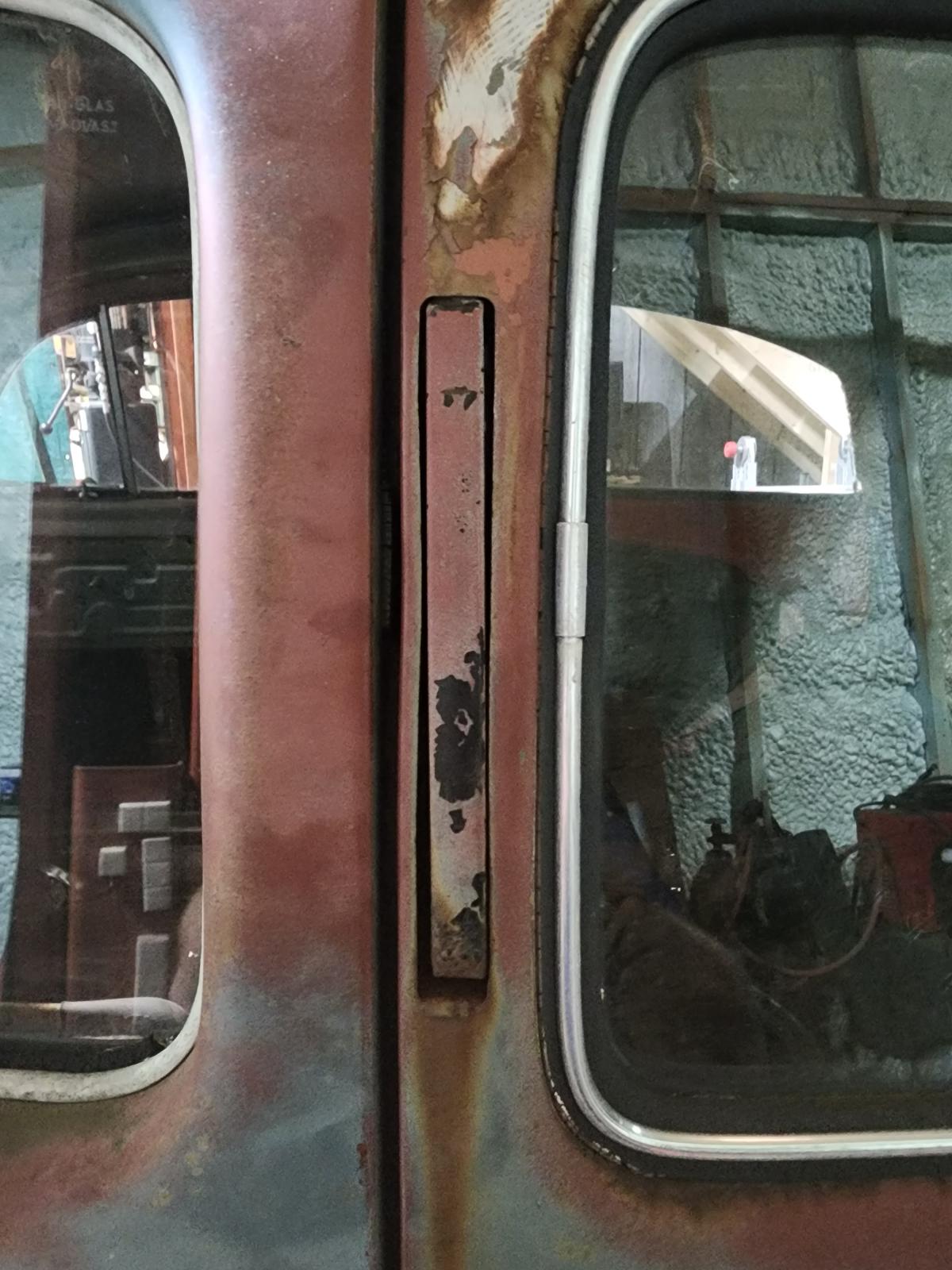

This is a nice example of a stock (near as anyone can tell), early 1955 semaphore, over rider, egg tail light bug. Pics are great and will help folks identify some of the details in the ever on-going discussions about what's correct on 1955 model bug...I particularly like the muffler. I've never seen one of those.
Thanks for jumping into the Samba project pool! Looking forward to the journey.

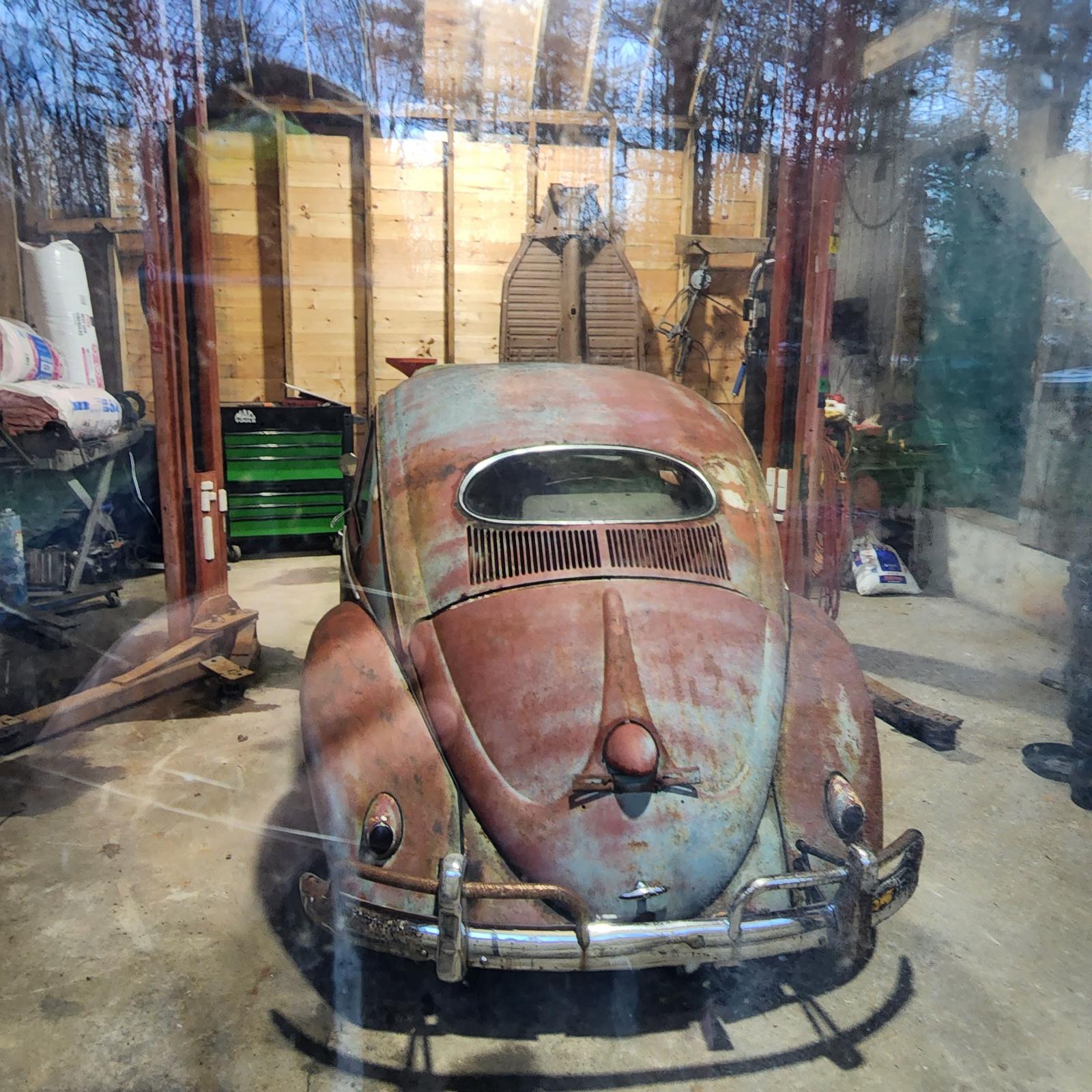

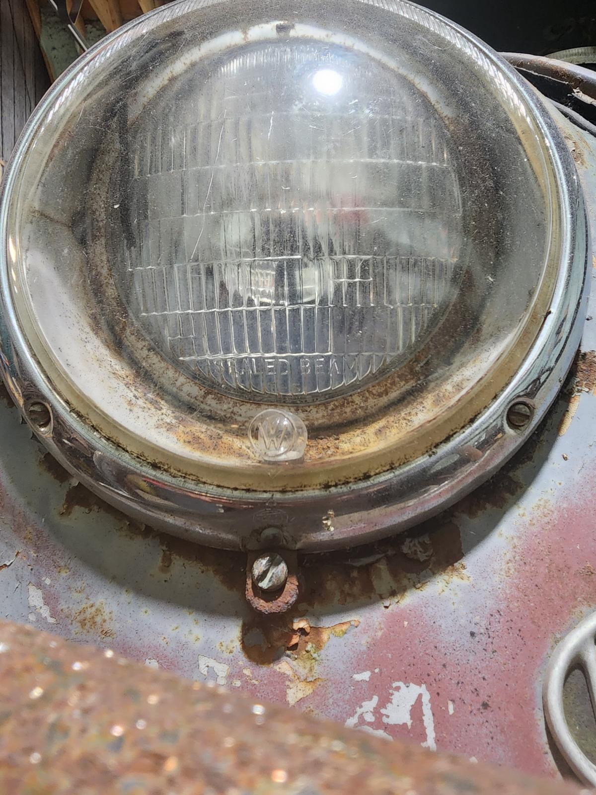

Just out in the garage moving stuff around and taking more pictures in better detail and adding them to the thread.
I still have so much to research but the knowledge on the platform is so vast and any insight or feed back into what's right and wrong on the engine would be geartly appreciated
Thinking about posting the picture of the engine on the "54 - '55 what's not correct" thread
I know the coil and hold down and the condenser are not the correct parts vintage wise but I just used them to verify the engine would indeed run before I progressed with the restoration process.
I installed the air cleaner back on the carburetor for this picture so the engine is in the same state as when It arrived at my house.

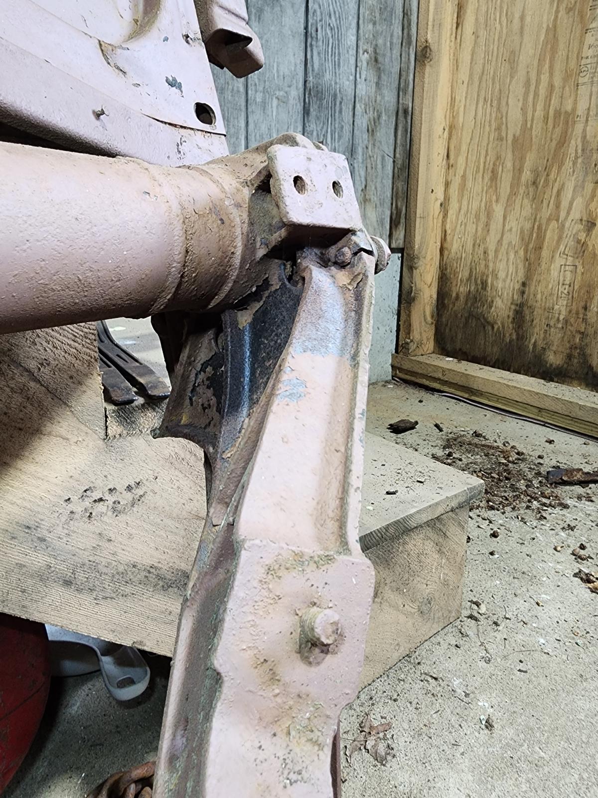

Below are pictures of the floor pan i have that i plan to swap all the parts to from the car as it sits to give me a solid engine and chassis platform.
Floor pan which has been stashed away for the car since the early '90s. There is damage to the passage side cast iron shock mount but other then that the pan has held up very nicely over the years. The pan sat outside leaned up against a tree. My grandfather acquired the floor pan from a local Vocational School that had rebuilt the floor pan.

And a another picture of the car sitting outside the garage before I moved it into the garage for the restoration project!

Wow, you were able to remove the pressure plate with the engine installed! Must have had access to the bolts from the starter hole.
I am impressed! One more trick in the books for old car fix'n.

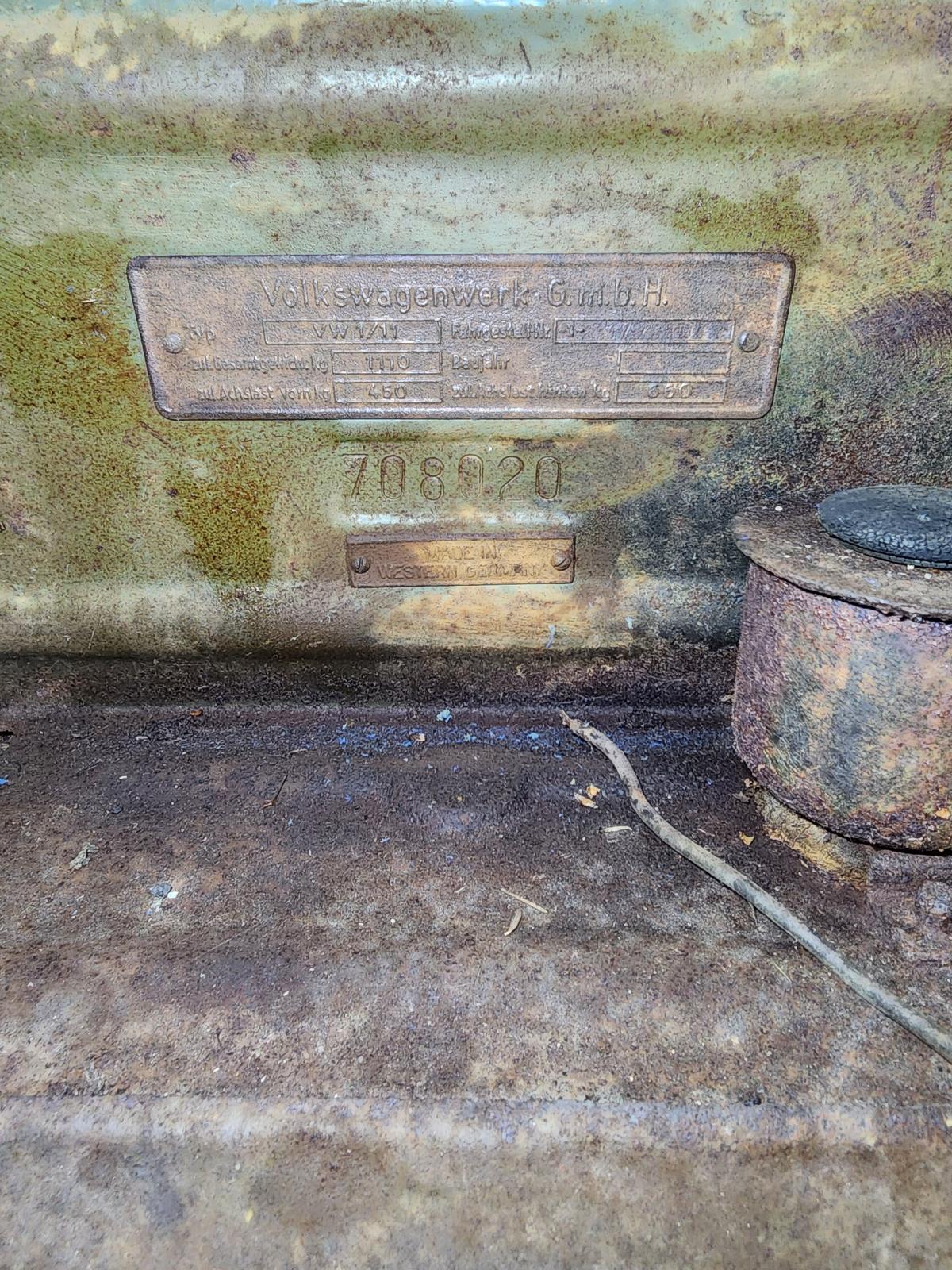

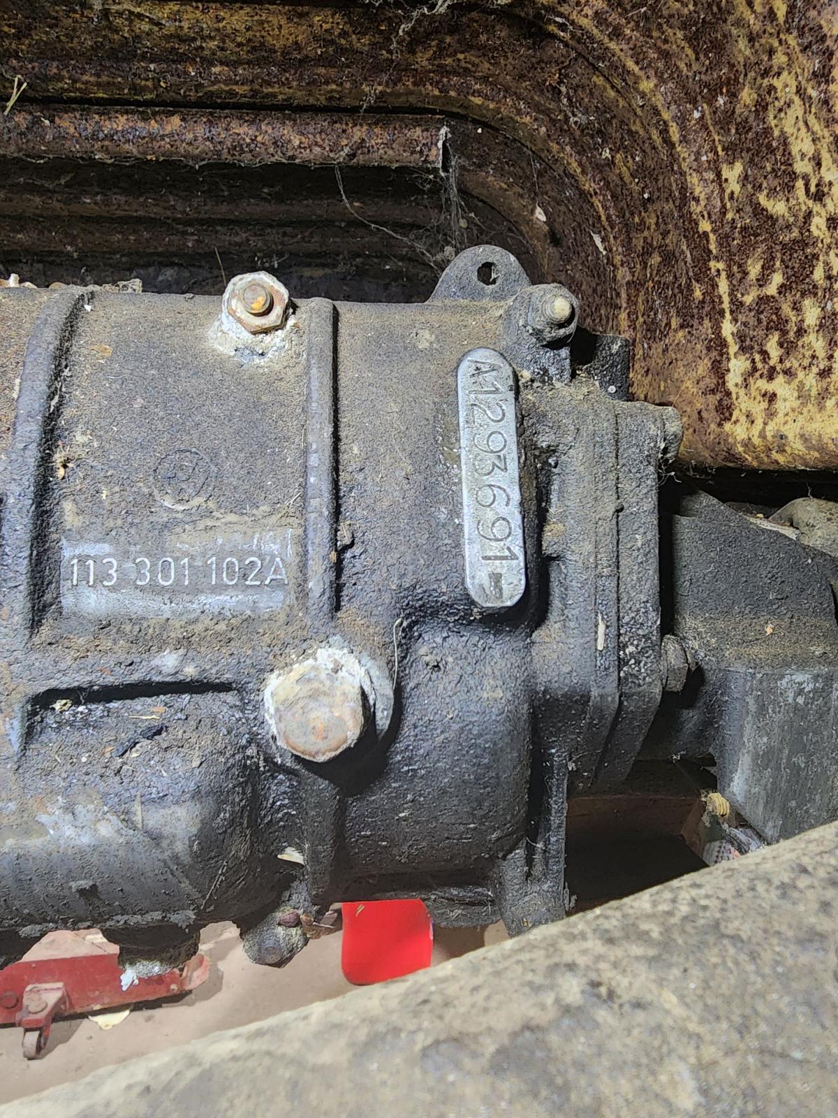

So I can't quite make out all the numbers on the car..
Here are pictures of the number.. will upload a picture of the current pan number tomorrow.
From what I could make out this is what I came up with:
Current Chassis/pan number -1-073340
Body number (just the number stamped under the vin plate) 708020
Vin plate number -1-0793404
Engine number -1-1103116-
New pan number -1-0899035
When the terms matching numbers they are all suppose to be the exact same? I thought I read somewhere on here that the numbers vary but usually all end up being from the same year but the month may vary not quite sure how that all works.
Current pan is in very poor shape due to the rust will up load pictures of its current state tomorrow as well.

Found a thread on here about pulling the engine and transmission as an assembly if the pressure plate and friction disc were stuck to the input shaft with a seized engine as well. Then once it was out you would then take the two lower studs out of the engine and actually rotate the transmission around with the engine stationary to get to the bolts through the starter hole. They had mentioned bending the boxed end of a 14mm wrench just right to be able to get on the bolts through the starter hole... fortunately the engine in this car was free and I could trun it over by hand and access the bolts through the starter hole.. not a fun job due to the lack of space to actually work the wrench but i managed to get 2 bolts out (long winded and turned hard from the corrosion) and the rest broke off in the flywheel... usually I'm upset about breaking a bolt off but in this case it was helpful as I was only able to get a 1/4 turn on the bolts through the starter hole which took forever to get the 2 bolts out I did. But the broken bolts twisted odd and I was onto the next.

How about a picture of the number on the current pan? Your numbers sound close enough that maybe they match but you can't read them correctly due to corrosion.
The VIN on the plate and the number on the pan should match. The body number will always be different as will the engine. The only way to know if the engine is original is to send off to the VW museum for a birth certificate. You provide the VIN and the engine number and they will confirm if the engine is original or not.

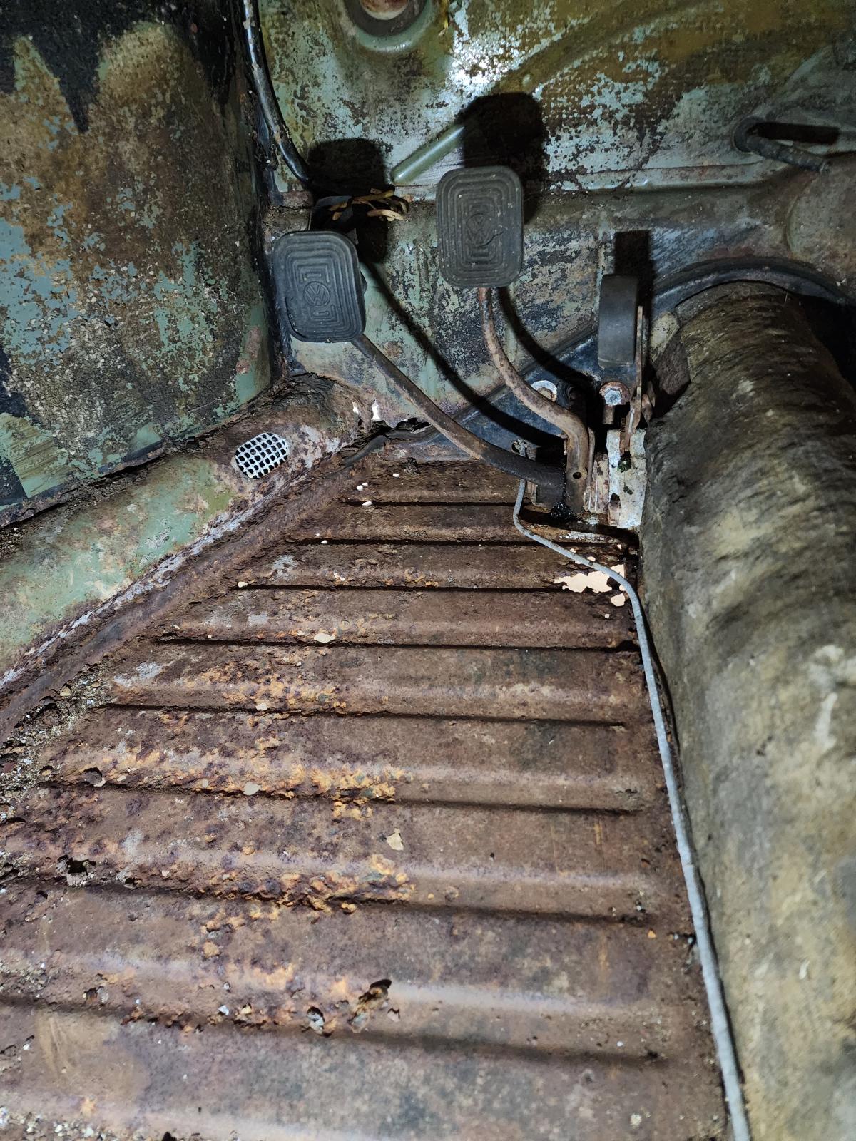

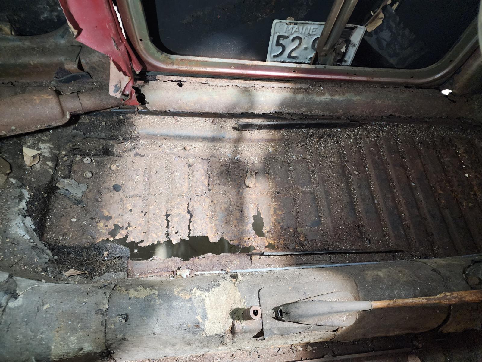

Here are the pictures of the pan number

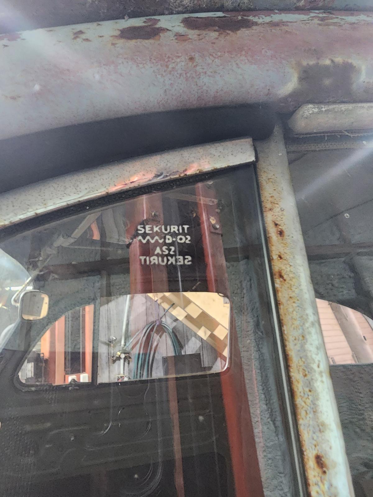

A few pictures on the extent of the tin worm cancer (rust)
And a sweet picture of a maine license plate that was in the car that was dated '55... who knows may be the original plate to the car 🤷‍♂️

Car and original pan are January 1955
Engine and replacement pan are June 1955

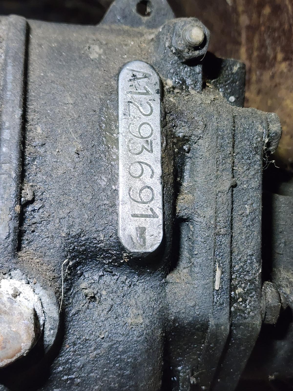

Check your transaxle number. It is on the right side, by the nose cone. If should be either A39XXXX or around A500000, depending on which car it is from.

WOW! That has some rust! I will be following along to see the progress. You are in for some FUN!

For you detail nuts (like me), this is the earliest documented car I'm aware of with a "Made in Western Germany" badge.

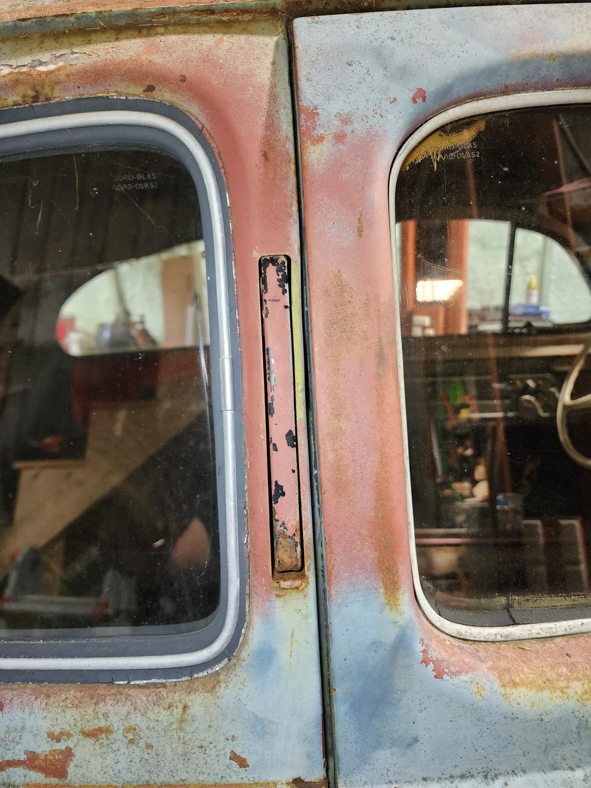

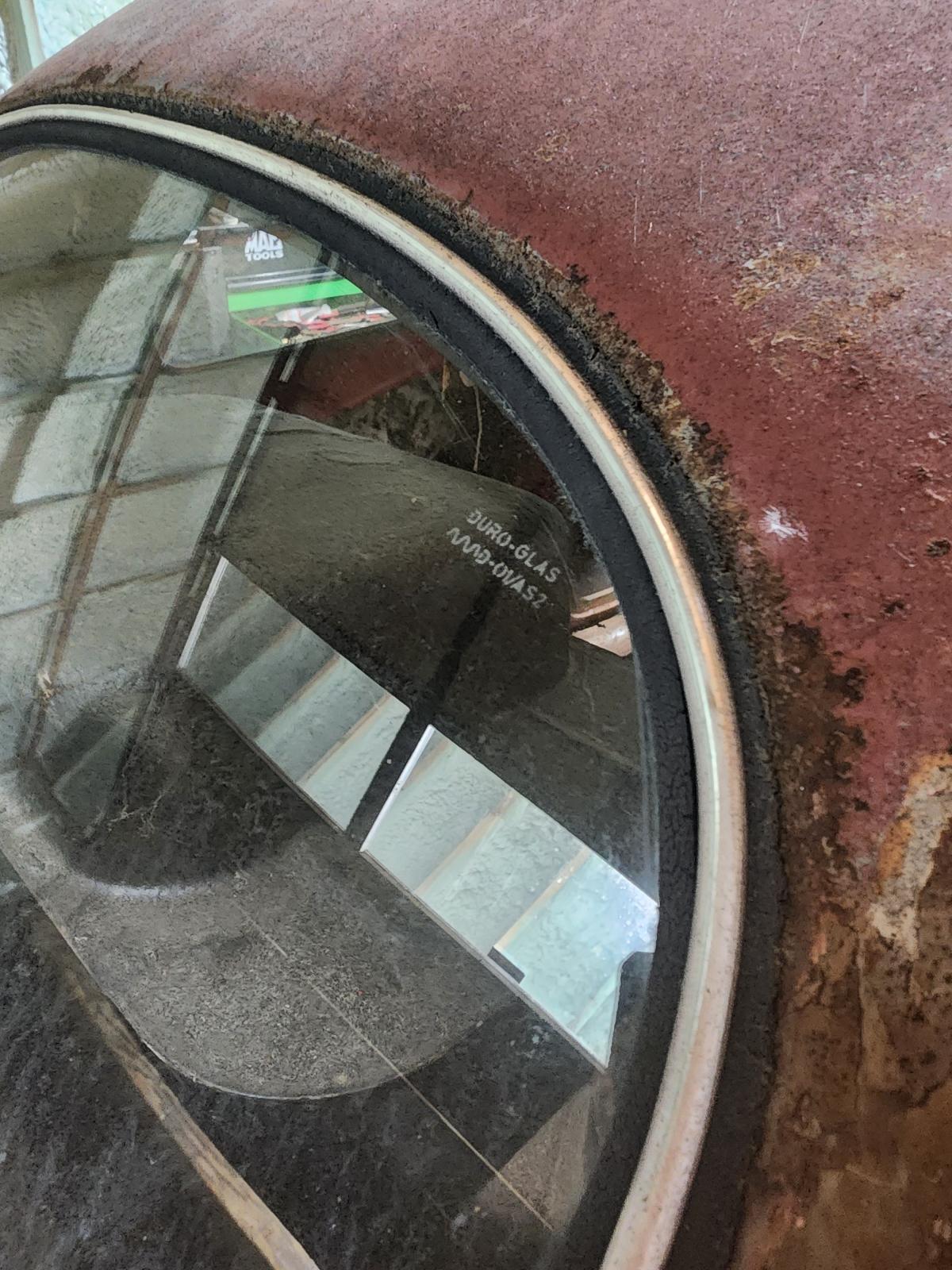

Side/rear glass should be Sekurit, not Duro-Glas.
Fender weld nuts should be the big, square type.
Semaphore arms should be painted Strato Silver inside and out, could be from either supplier (my black ones were from Hans Strobel, aka "SHO").
Sealed-beam headlights may be date-coded "53M."

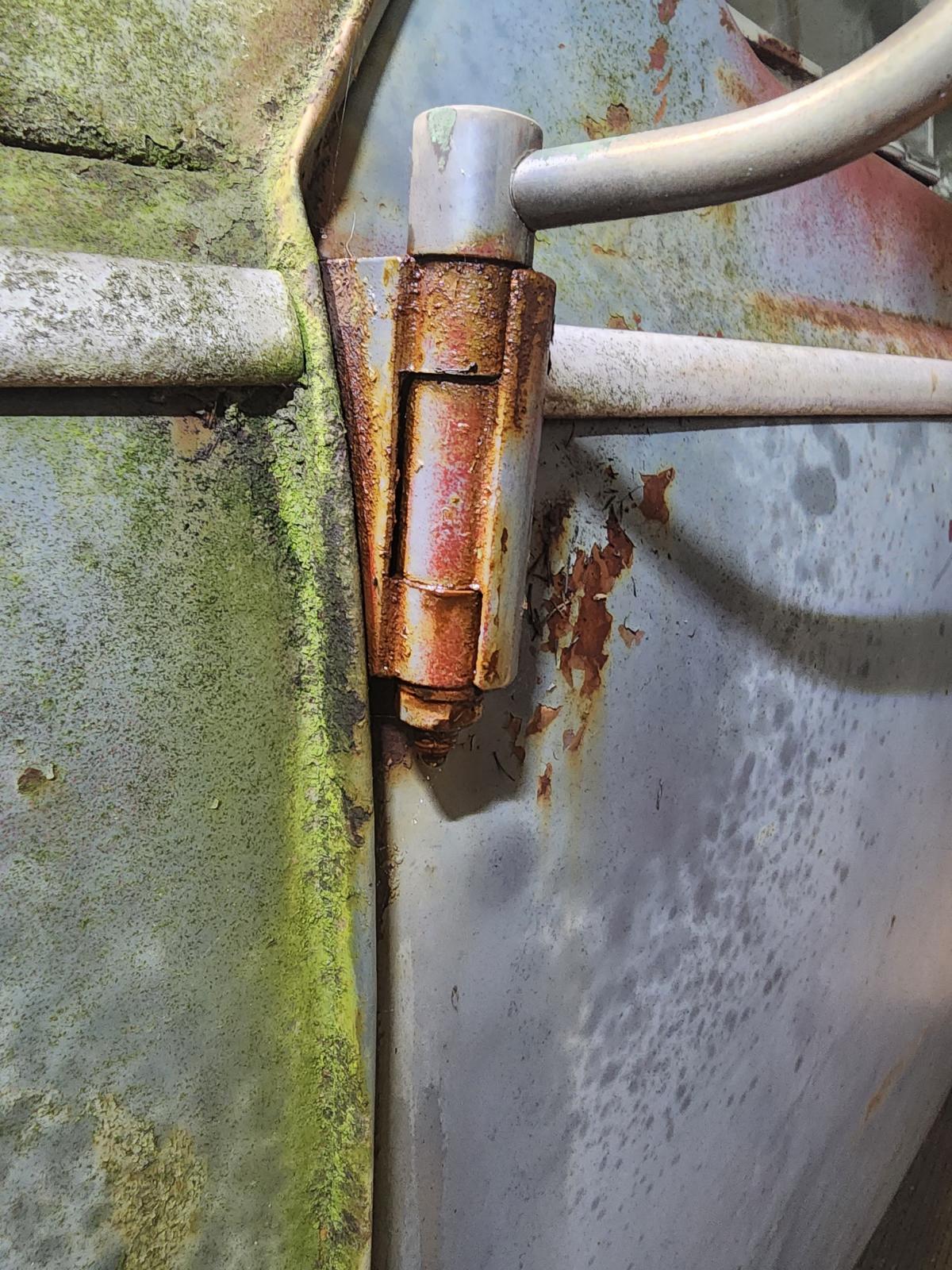

Door hinges will have oiling slots, not oiling holes.

It took me a good 3 hours to separate my engine and transmission but it sure was a good moment when it finally let go!

Got the transaxle number
Got another picture of the entire Vin plate. Still can't make out the number....
Took some pictures of the Semaphores. Haven't had much time this week to work out in the garage so I haven't looked into any of the lighting wiring yet but the Semaphores look to be intact. Hoping they aren't seized or damaged from the corrosion.
Pictures of the head lights. Outter glass are different 🤷‍♂️
Pictures of the glass.. you can see front door glass and rear side glass in the Semaphore pictures if you can zoom in.
Rear Oval glass
Front windshield glass
Drivers side 1/4 smokers window
Passenger side front 1/4 smokers window
Passenger door glass
Passenger rear side glass
Pictures of the door hinges.... didn't know there was different styles. Not sure what style the car has
