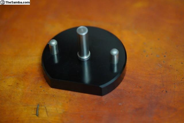

You set the preload with this:
https://www.thesamba.com/vw/classifieds/detail.php?id=2586960

I don't see such a tool in Europe, but I guess I can easily made using a piece of wood, 3 bolts and 2 nuts. I guess I'll be fine as long as the center bolt is 35mm outside the wood.
I guess, I'll first try to turn the engine so the rod is pointing outwards and then re-install the top plate.

I ship to Europe. It's around $20 for shipping. These are made from solid metal.
