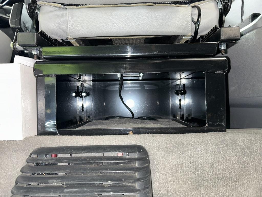

I have suggested CMC, unfortunately I have not bought their product. Could someone give up the dimensions of the space under CMC's open swivel base? It's not listed on their website and I've gotten crickets from their contact points.
I've been debating the loss of the rear face seats (or the two seats in general) and wonder if a compromise in utility can be met. The ever evolving space and shrinking size & costs of the lifepo4 vs. the space under that CMC swivel base.
If I can get a lifepo4 under either seats and continue to claim the flexibility of seating 7, our Swiss Army knife of a van would check most of the boxes. FYI this possible solution is was inspired by IdeaNerd's "bento box" application of GLS seats as "perhaps" a replacement of the rear facing seats of the MV

Since I have both types of bases, one with safe and one without I compared them and feel pretty confident they are based on the same core seat base. The safe model just closes the front and back openings. In the picture below the safe door attaches to the bottom cross member which is not on the open base. My open base is stuffed with auxiliary electrics so I measured the safe base.
14 inches front to back.
11.5 inches inside the bottom side rails, where nuts attach to bolts.
5 inches from carpet to bolts on top. You might get slightly more depending on your carpet, for instance cutting it out.

Thank you!
Life saver and/or a heartbreaker. Not likely to find a lifepo4 battery to fit, but one can dream in the meantime. I have noticed battery makers are open to different shapes and sizes, perhaps something built directly under a seat that is flat and wide (like our seats & butts) will make sense to them.
