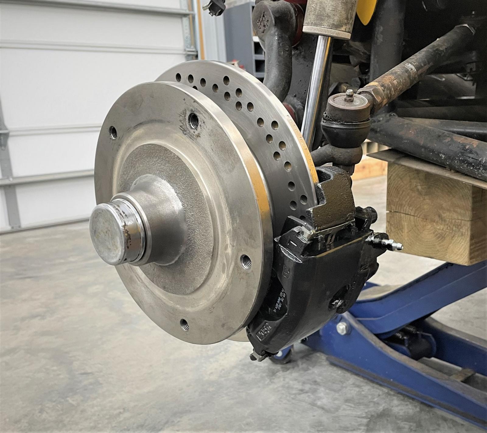

One of the very first improvements I made was the installation of front brakes. The rail already had drilled front rotors, so I purchased the EMPI front caliper brackets, along with calipers and pads for a VW Rabbit. I turned down a set of caliper slide pins for a '15 Jeep Grand Cherokee to mate it all up.
My first first-hand taste of EMPI's quality control: I had to file out the end of the slide on both brackets in order to install the pads.

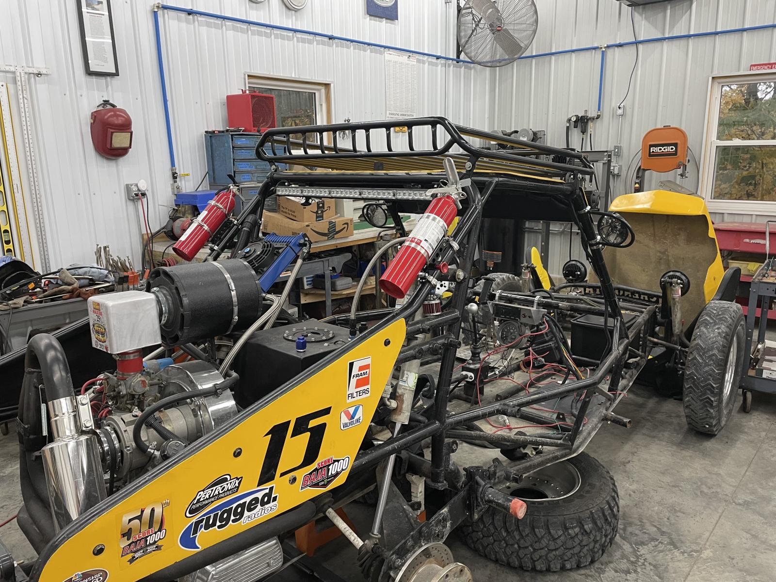

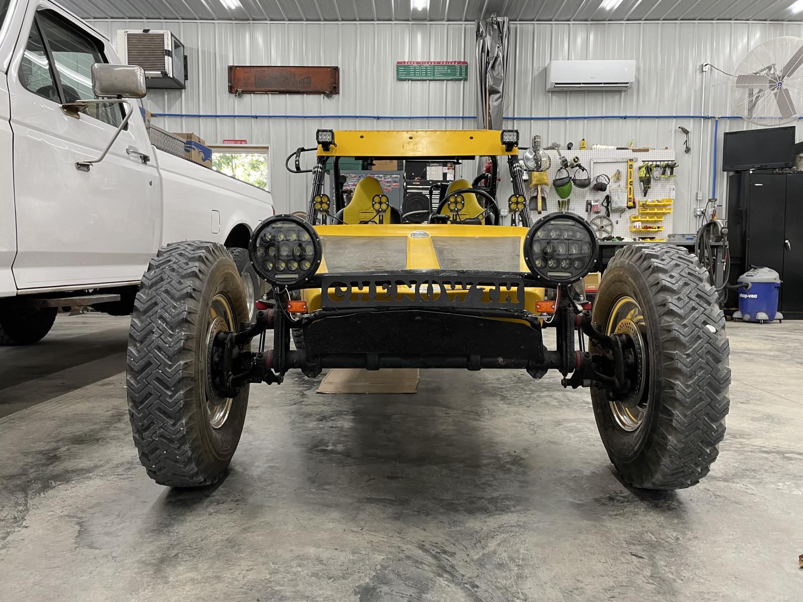

As I'm working to get this car street-legal, one of the next jobs was to add headlights and turn signals up front. I used the lights that the P.O. provided with the rail (as we know, every rail comes with a BIG box of additional parts), and whipped up some mounts.
I also added a GPS speedo, a passenger side rear view mirror, a second fire extinguisher, a shift bushing from fellow member jimmyhoffa (thanks Jim!)...and then I blew it all apart.
The battery and kill switch was mounted behind the passenger seat, and the seat was positioned well forward of the driver seat to accomodate this. It looked funky, and it cramped the passenger. I relocated the battery up front in a Moroso sealed box, and I'll be re-working the passenger seat mounting soon to place it in-line with the driver.
I sliced and diced a roof rack from HF to fit the rail properly, and moved the four yellow pod lights from the base of the windshield area to the new rack.
Some of the upcoming work includes installing 4-piston rear calipers, a hyd parking brake valve, an old Neal cutting brake, re-plumbing the fuel, clutch, and brake systems, re-wiring the vehicle entirely, producing mounts for the rear shocks to place them in double shear, raising the rear bump stop perches and installing actual bump stops on them, and who knows what else I'm not thinking of at the moment.

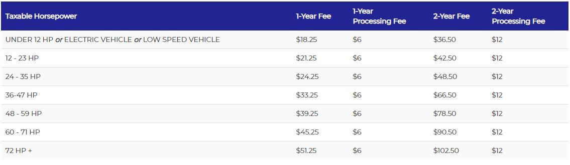

How much do you guys pay to register vehicles in Missouri?
racecougar
Joined: July 31, 2023
Posts: 242
Location: Imperial, MO
racecougar is offline
PostPosted: Fri Oct 27, 2023 11:55 am    Post subject: Re: Rod's Chenowth 4LWD Build Reply with quote
As far as registration/license fees go, it really depends on how you license it. The typical passenger car rates look like this:
If you license it as a historic vehicle, it's a one time fee of $31.25 for plates. This is the way to go, IMO. I run historic plates on 4 of my cars.
To title a special construction vehicle, it looks like it costs $31 for the form (Form 551) plus tax on any parts that you haven't already paid tax on. cbeck or jimmyhoffa, please correct me if I'm wrong.

Looks like the dept. of revenue main office in jefferson city also collected $29.
The local license offices would mail your paper work to jeff city. I just went to that office so any issues ( there were none) could be ironed out quickly, not weeks thru the snail mail.
So to recap
$31 form 551
$29 to dept. of rev
$12.5? For state safety inspection
$49.5 for 2 year plates.
$500 for sacrificial title.
