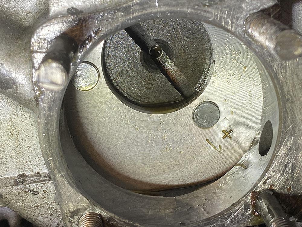

Would appreciate any info about a used long block I picked up to replace a punctured-case engine, 1600 Dual port. My experience level is that, with help from you guys, I built a 1600 dual port for my 71 S. Beetle. Made me feel confident enough to pick up a new project car.
This engine came out of a replica of a Porsche. I had a glance at the engine when it was in the car and the engine top side was modified with something I’m ignorant of; large black blower-looking thing, (turbo charger, super charger?).
- The oil pump is missing and i see +1 marked on the cam. Reading up, I see that indicates backlash. What is the effect of this and will it affect the choice of oil pump or distributor I put in?

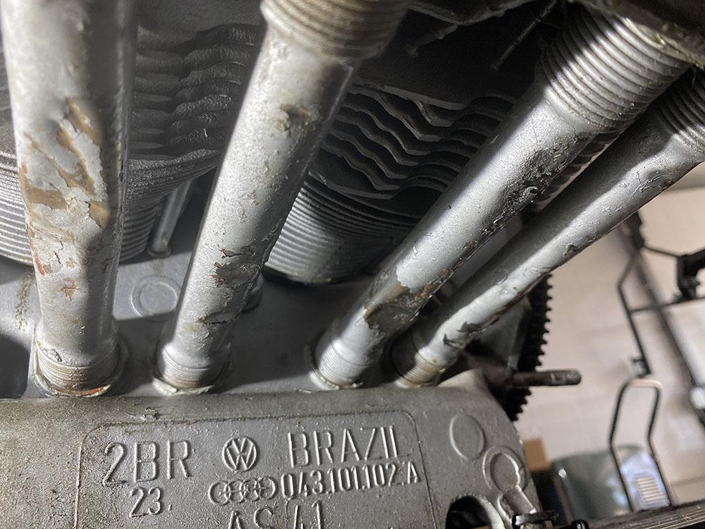

- there are no deflector tins under the head cylinders. Will I have to pull the heads off to install them?

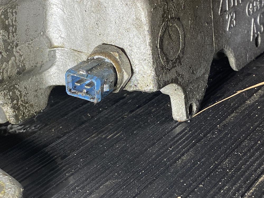

- looks like it has a sensor screwed into the case bottom front. Oil temp I assume.

No lower tins... no bueno. Heads have to come off, replace the dented push rod tubes.
Sender must be a oil temp.

is it possible to tell from the picture if this is a dished cam or flat cam?

3 bolt = flat
4 bolt = dished.
That one is flat

3 bolt = flat
4 bolt = dished.
That one is flat
Brian
Thank you
