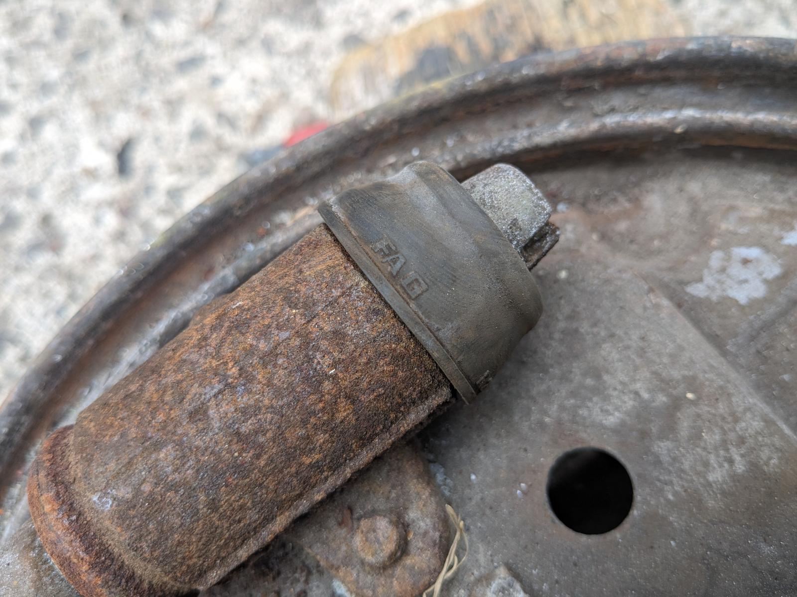

I found an old VW original cylinder the other day on a parts van.
Made by FAG. Been sitting for ages. Damn it didn't look half bad, I'm sure some new seals and polishing would get it going Laughing
The boots 211611461A were still in good shape!
The piston part number, which was nowhere to be found online bc it's NLA, 211611677C
It's sad to think the slightest parts were rebuildable back then.
Such a wastefull throw away society we live in now Mad

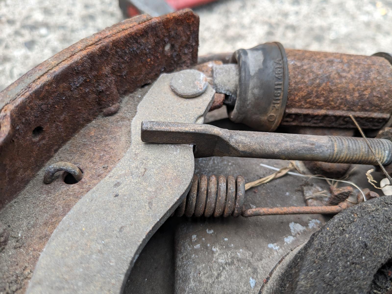

This photo shows a WRONG position of the adjuster forked end.
The long side of the fork go inside so it can bottom out in the shoe slot.
Mark
Mark
ALIKA T3 wrote:
THANK YOU THANK YOU!! For this little tidbit of precious info.
I have always slightly, wondered if I had my vanagon brakes assembled correctly, despite what i saw in the bentley...
I DID/HAVE!!
I have now printed this pic with your note, and added it to my bentley as proof positive.
Than you!
Mark
ALIKA T3 wrote:
Yeah, well, it's a parts van, so of course it was mounted wrong, they all are Crying or Very sad
