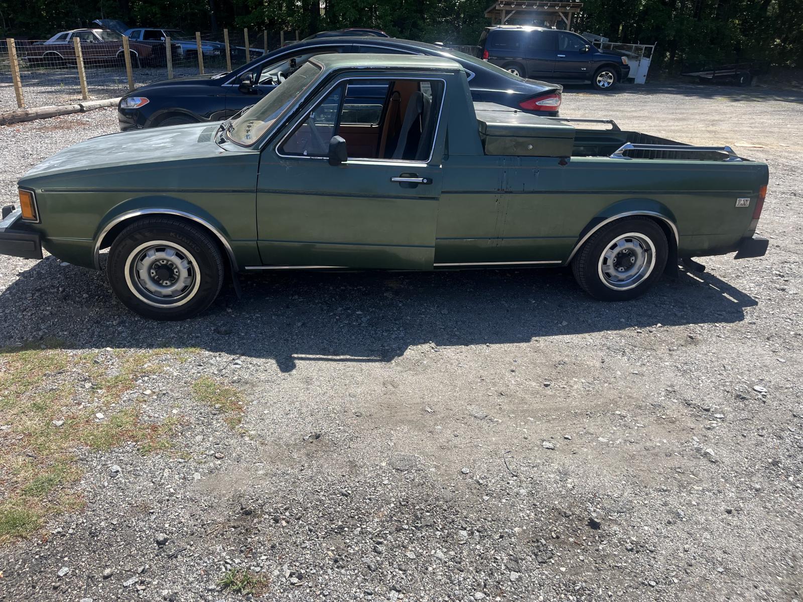

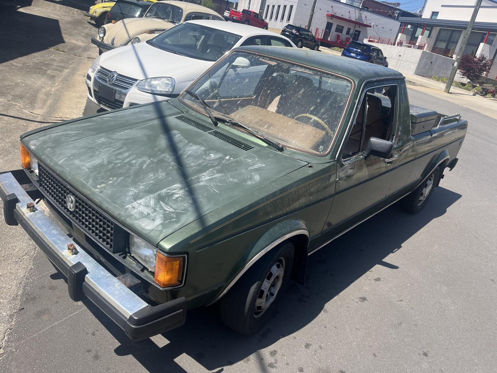

I was given the opportunity to buy this ‘81 Caddy with a turbo diesel in it, & needing a multitude of repairs. With fuel prices ticking up, I decided to save $20 a day in fuel & run up the clock in this while addressing it’s ailments a bit at a time.
First up, let’s get rid of the donuts of death.
And replaced them with a set of 1” wider steelies off a Jetta.
Since the front struts were pretty sloppy, I scrounged up a pair of Bilstein struts I had laying around & slipped a pair of H&R springs over them that I’ve had so long, I don’t remember how long, or what they came off of. Confused
Oh well, it’s a start.

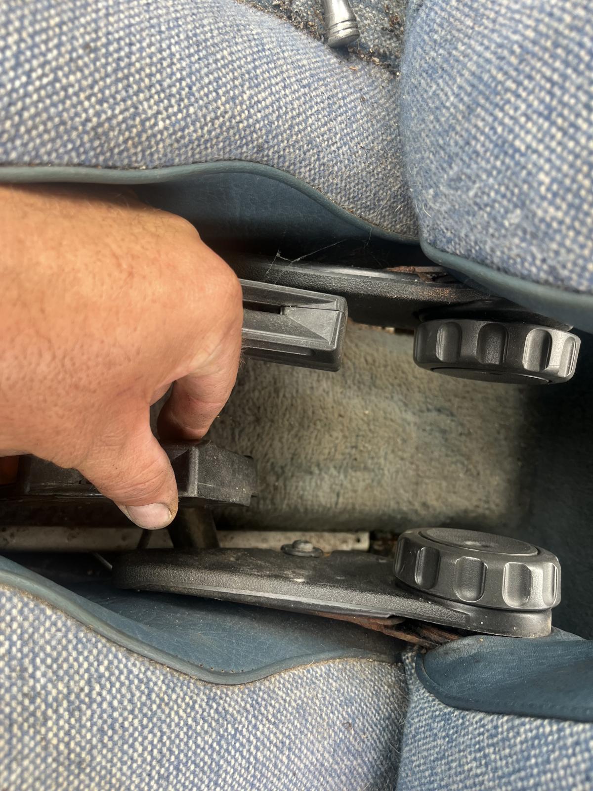

Now that the turn signals work, I thought it would be pertinent to get the seat belts working. First up, extract the remains of the originals.
Pilfer a pair from a donor car…
And bolt them into place.

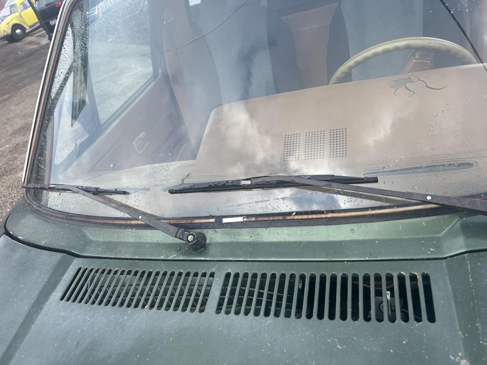

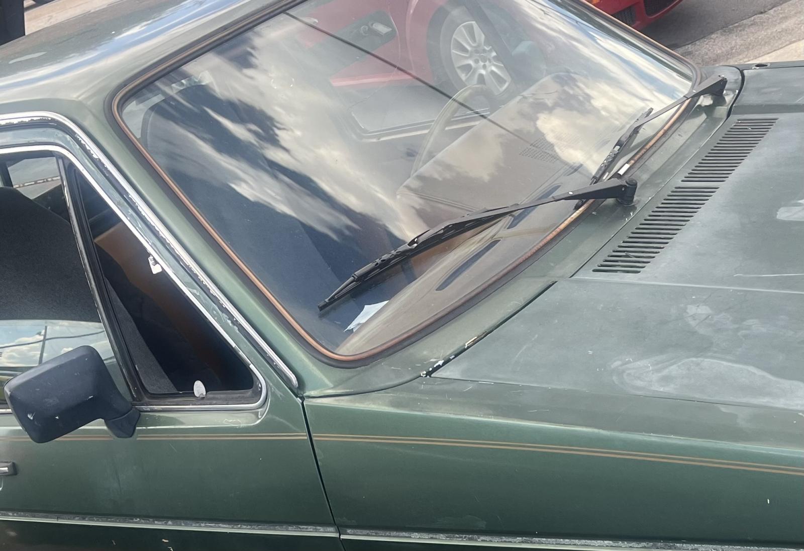

Another thing bugging me was the position of the wiper arms, I just wasn’t able to get them to align correctly, then it dawned on me & I swapped the arms & cinched them down.

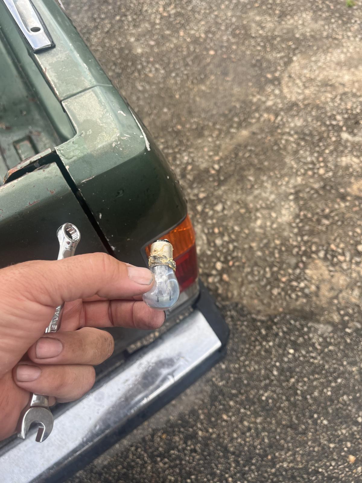

Additionally, someone informed me that my passenger side brake light wasn’t functioning correctly & I traced it down to a bad bulb.

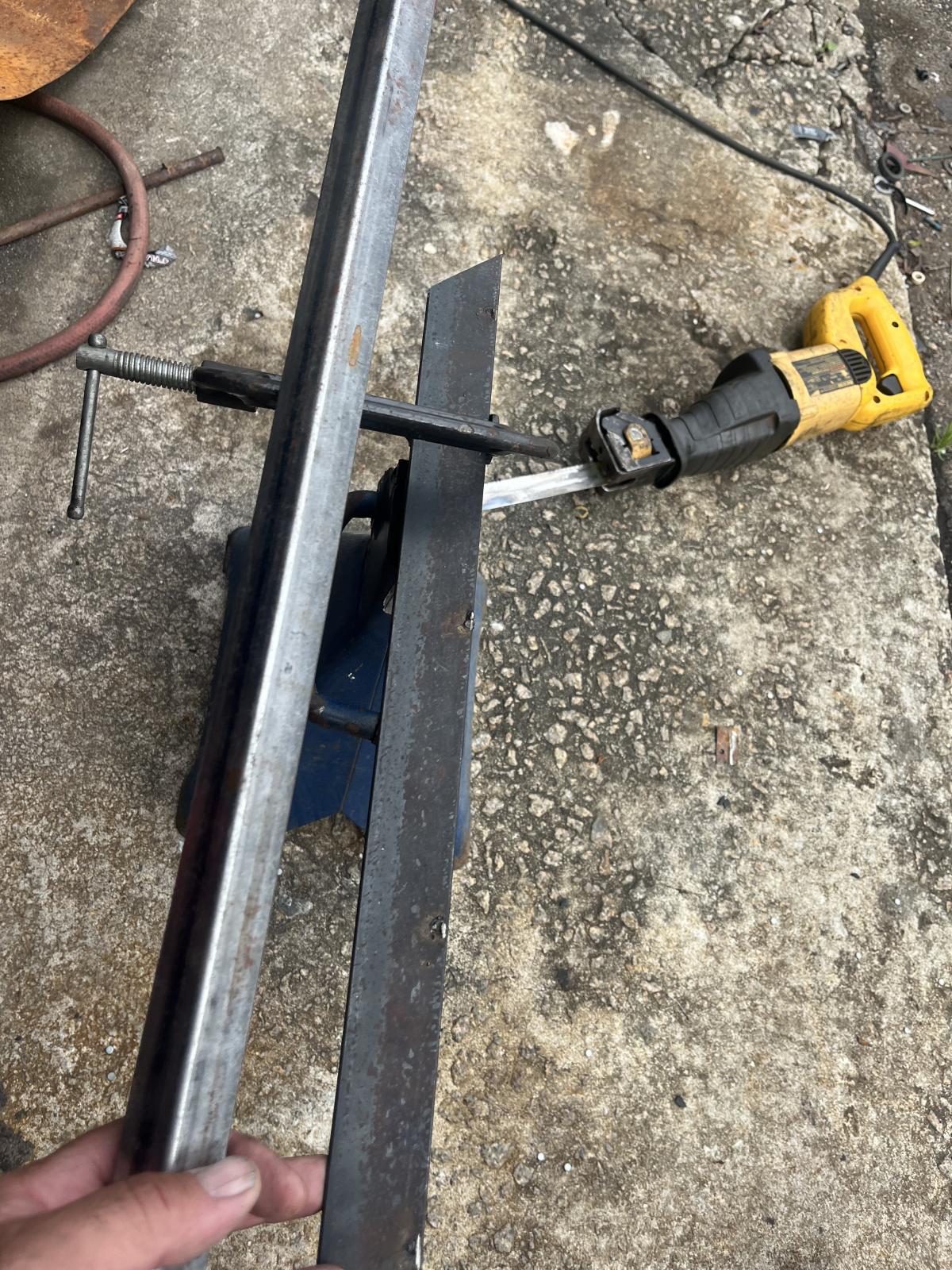

Having had a couple of MKI chassis fracture at the frame horns, & knowing my tendency to… ummm… let’s say “conserve forward momentum”, today’s project is to build a lower tie bar, so let’s turn this into one.
After a bit of trimming, drilling, & welding, I turned it into this.
I still need to fab up the triangulation legs, but this is a start.

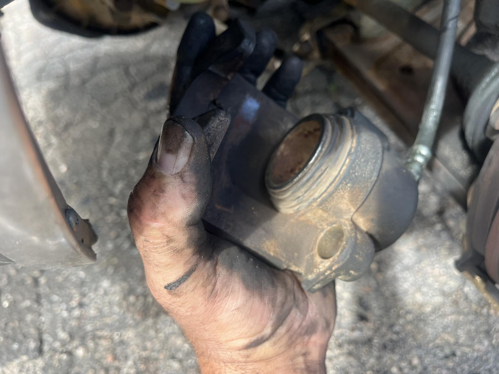

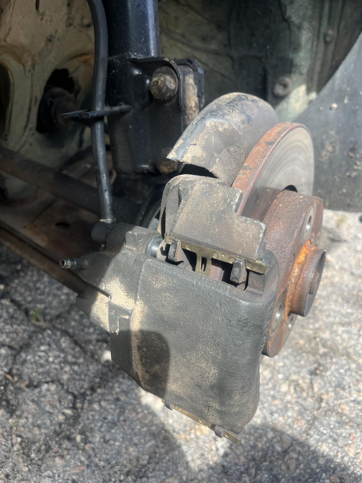

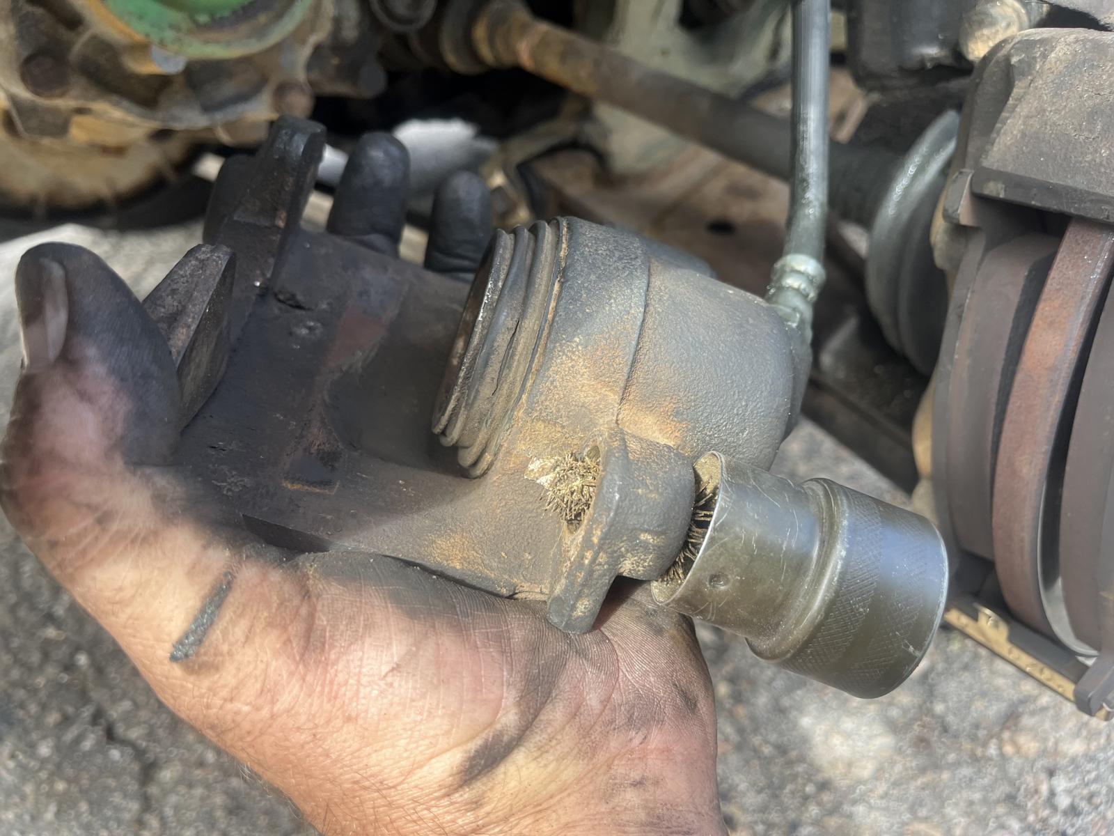

This morning I acquired the slide pin bushing kit.
It even came with the anti rattle shims.
So, let’s stuff them in.
First up is to install the shims.

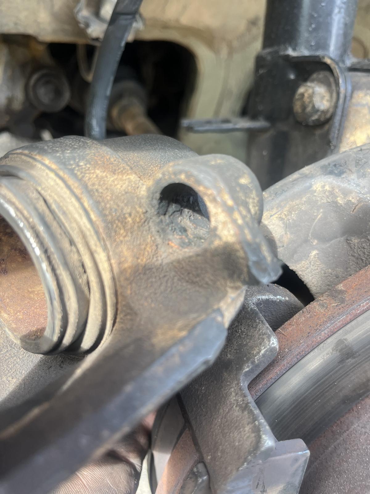

Next, the bushings. My technique is to fold them over onto themselves & slide them onto the bores.
However, instead of them popping back into shape once in, they just wouldn’t. After removing it, I realized that some asshat tried to fill the void with epoxy.
Huh I don’t remember that being a factory friction surface.
So after some scraping & a final cleaning with a battery post terminal cleaner…
I finally got the bushings in & the caliper bolted back up.

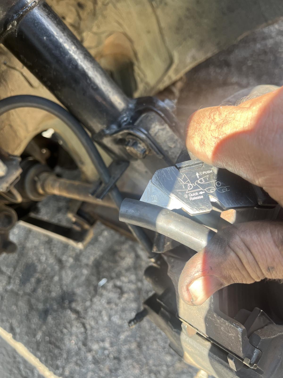

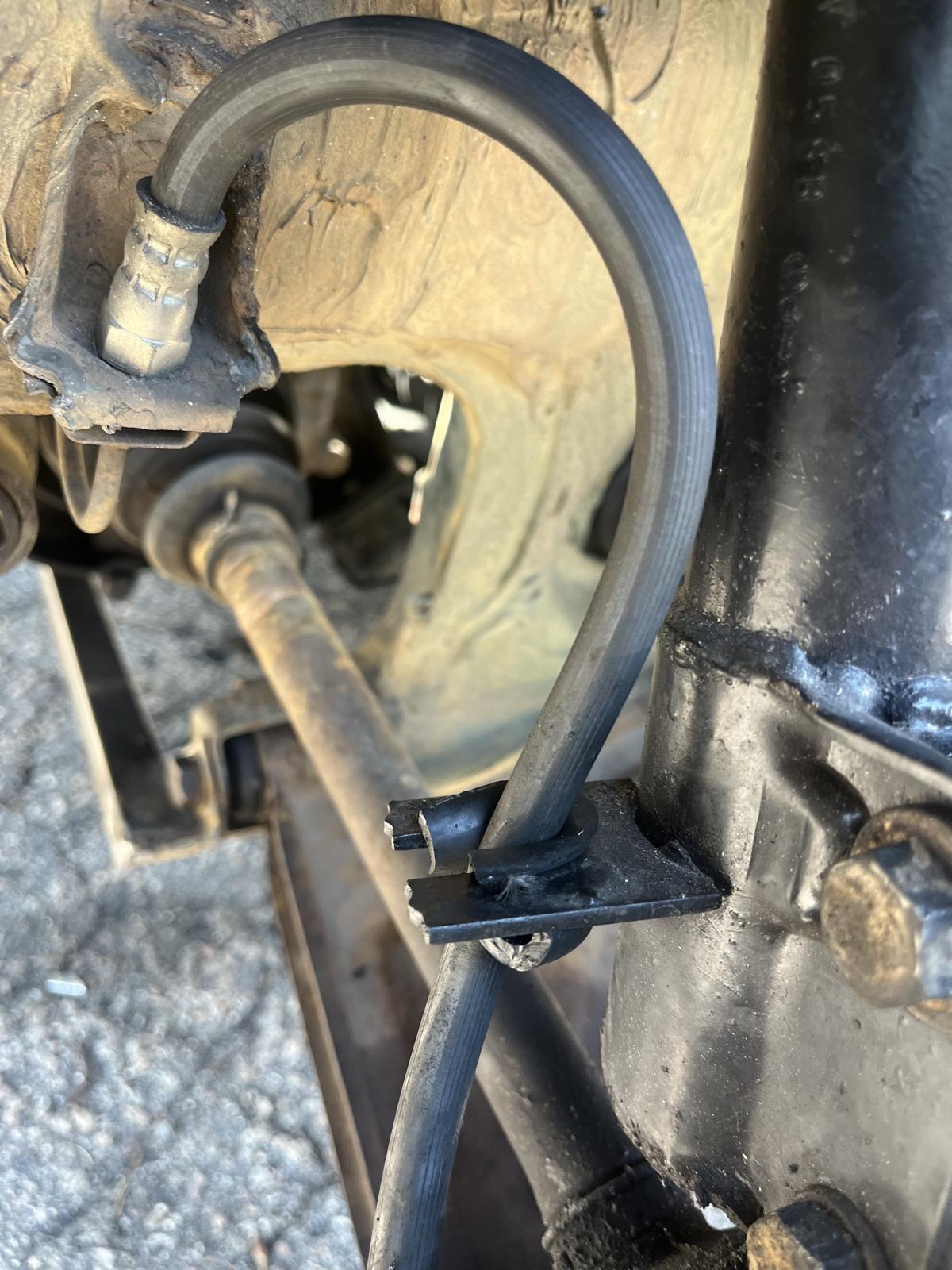

While there, I took a moment to half ass a grommet for the brake hose by cutting a slit into a piece of hose
And slipping it into the bracket before stuffing the hose back in.

I rubbed a couple minutes together & cut up a few more pieces of angle iron & clamped them to the chassis.
And then tacked the remainder of the square tubing in place.
After scrounging up another piece, I repeated the process on the other side & fused them together.
Once fully welded, I drilled holes through the chassis & brace & bolted it back in.

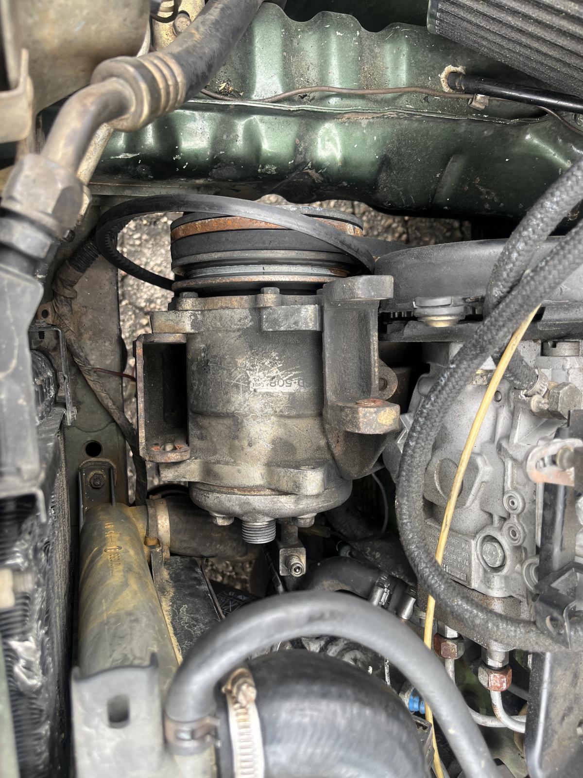

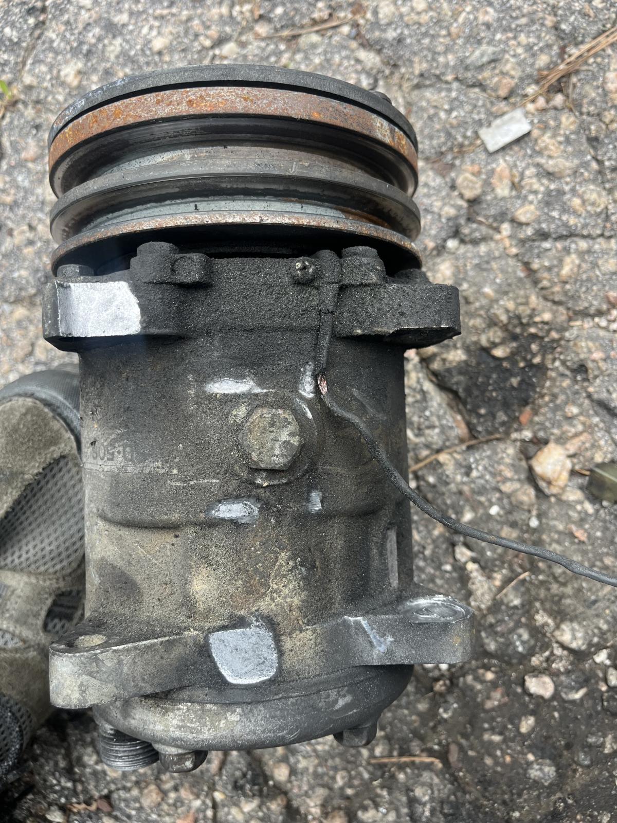

Well, as everyone knows, early diesels were noisy, & rattly, however, this one was ever so much more so. With a generator light that would flicker at idle, & light up solid if the roads were wet, I decided to address the drive belt issue.
With a too long A/C belt, compounded by the compressor missing several mounting bolts, today’s endeavors quickly went downhill & required removal of the alternator & A/C compressor.
This has obviously been an issue for a very long time.
As it turns out, one of the bolts had sheared off in the bracket & not having enough room to drill it out in place, & not having the desire to remove the bracket (which also requires removing the injection pump.), I cheated by heating up the bracket & & coaxing the sleeve out of the bracket.
Once out, I used a left handed bit & extracted the remnants from the sleeve.
And, well, after that I got a correct sized belt, & got so deep into putting everything back together & forgot to take more pics.
Oh, well, until next time.

Needing a new tires, I opted for a different look & I wrapped some new sneakers around a set 13x7 steelies that I banded a while ago.
