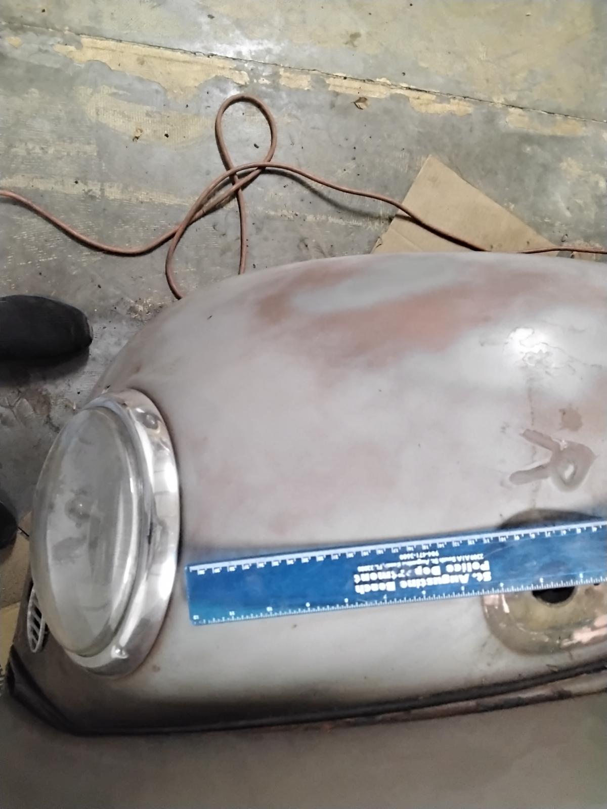

Mismatched front fenders,ugh! Hoping to swap one to match the other to avoid buying two. Just want a match, not fussy. Not sure on id after searching pics. Notable differences in signal hole size, curvature , spaces from bottom of horn grill to bottom lip. Any ideas as on years? Holes below horn grills are n
ot always present?
