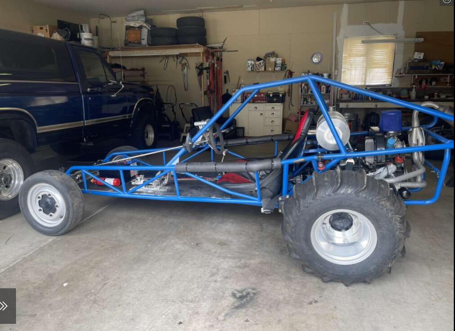

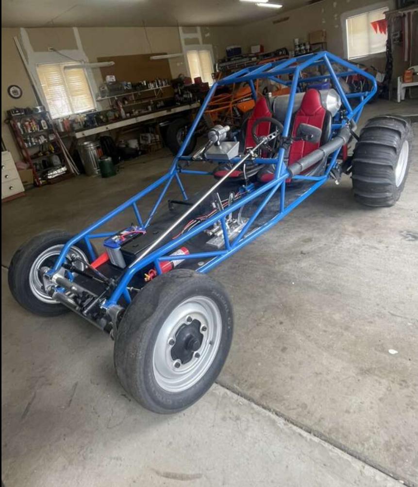

I was introduced to vw rails back in the early 80s day my uncle. Fast forward to 2023, I bought a ranger and brought it to St Anthony’s in Idaho. I was under gun’d and in a bit deep. Still had a blast with my 4 year old. He’s been talking about going back ever since.
Fast forward to Xmas ‘24. I found a rail in my price range and in good shape that I won’t have to wrench on too much out of the gate. It was built in 2019 by a builder in the rexburg area (close to st Anthony’s) and has a 1835 with fairly low hours, a mild cam, and doesn’t leak or burn oil. It does have oil in it, I checked. The guy I bought it from was very nice and we hit it off over the phone.
So I hoped in the truck and drove 7 hours down to Ogden UT to check it out. There’s no buggy’s closer than that to me. I had contacted the PO about a month earlier and he sent some videos and more pics. Anyway, I went down and did the deal, did a cold start up and test drive, all good. Got home fired it up on the trailer and the oil cooler blew. Lol. Actually a blessing, I was half tempted to stop by the dunes on my way home, I’d probably still be there with my blown motor! So I got some parts ordered, pulled it apart, installed the new doghouse oil cooler and did some snownuts in the yard with the little man.
Now I’m doing a few mods/additions/wiring to get it where I want it to be. And now the buggy!

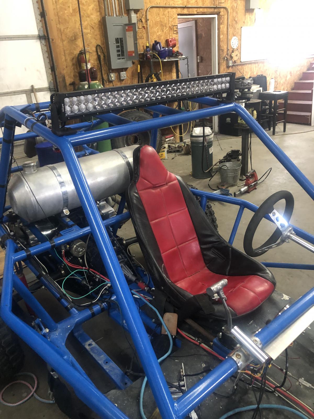

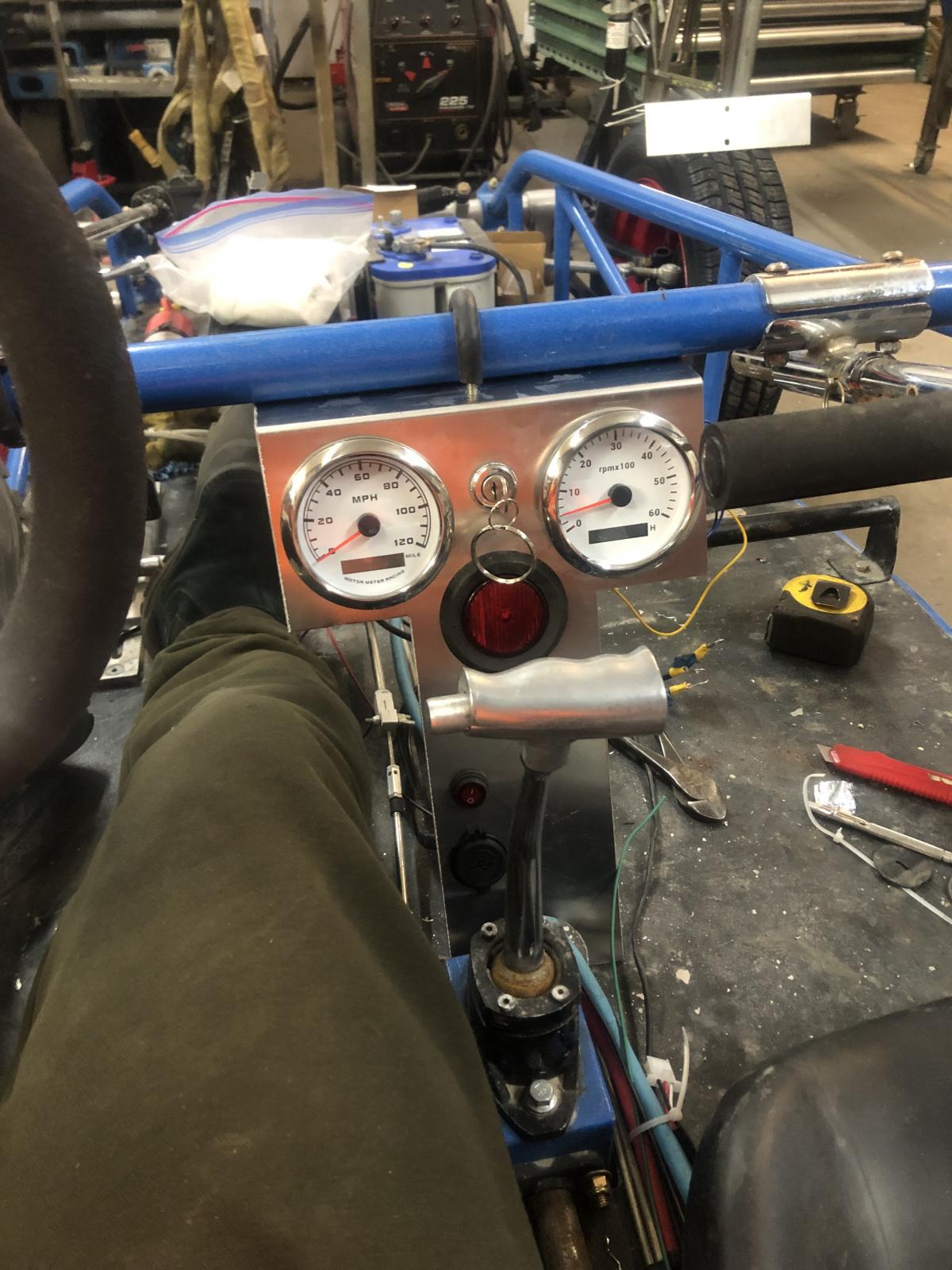

Or not, not sure how to post a pic here. Well it’s getting a gps Speedo, tach, oil pressure light, alt light and charging port, as well as a 32” light bar, stop/running light, aluminum roof, possibly some aluminum side panels and some new 4 point harnesses. I have a big brake and a plaz table so it should be pretty easily done. The console is just a test run, it will get shrunk up a bit and fully enclosed.
I think I did well for 4K. I know they can be had for less, but not this far north. And it was garaged, well maintained, came with good paddles and a set of off road tires as well as oil, filter, plugs, wires, and a few other random odds and ends. I’ve got a 20’ enclosed trailer, also thinking about fabricating one of them over the truck jobs so I can pull the Ranger as well.

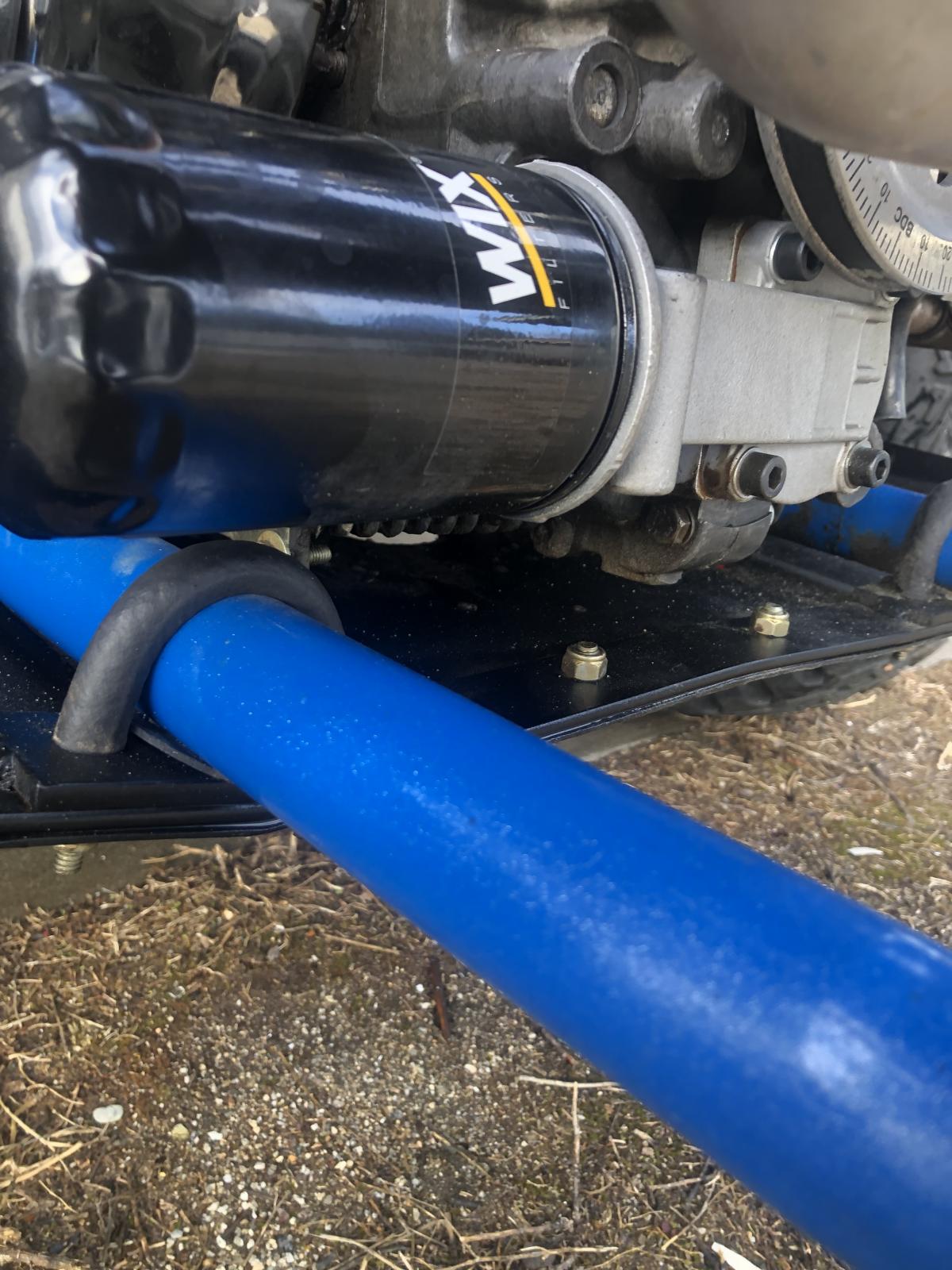

Do you need to change the filter screen when changing the oil? I have and external oil filter.

No, I run full flow filters too and only drop and clean the stock screen once or maybe twice after an engine rebuild. After that there is rarely anything to be found in it and it certainly does not need to be changed unless it gets damaged by pulling it in and out.

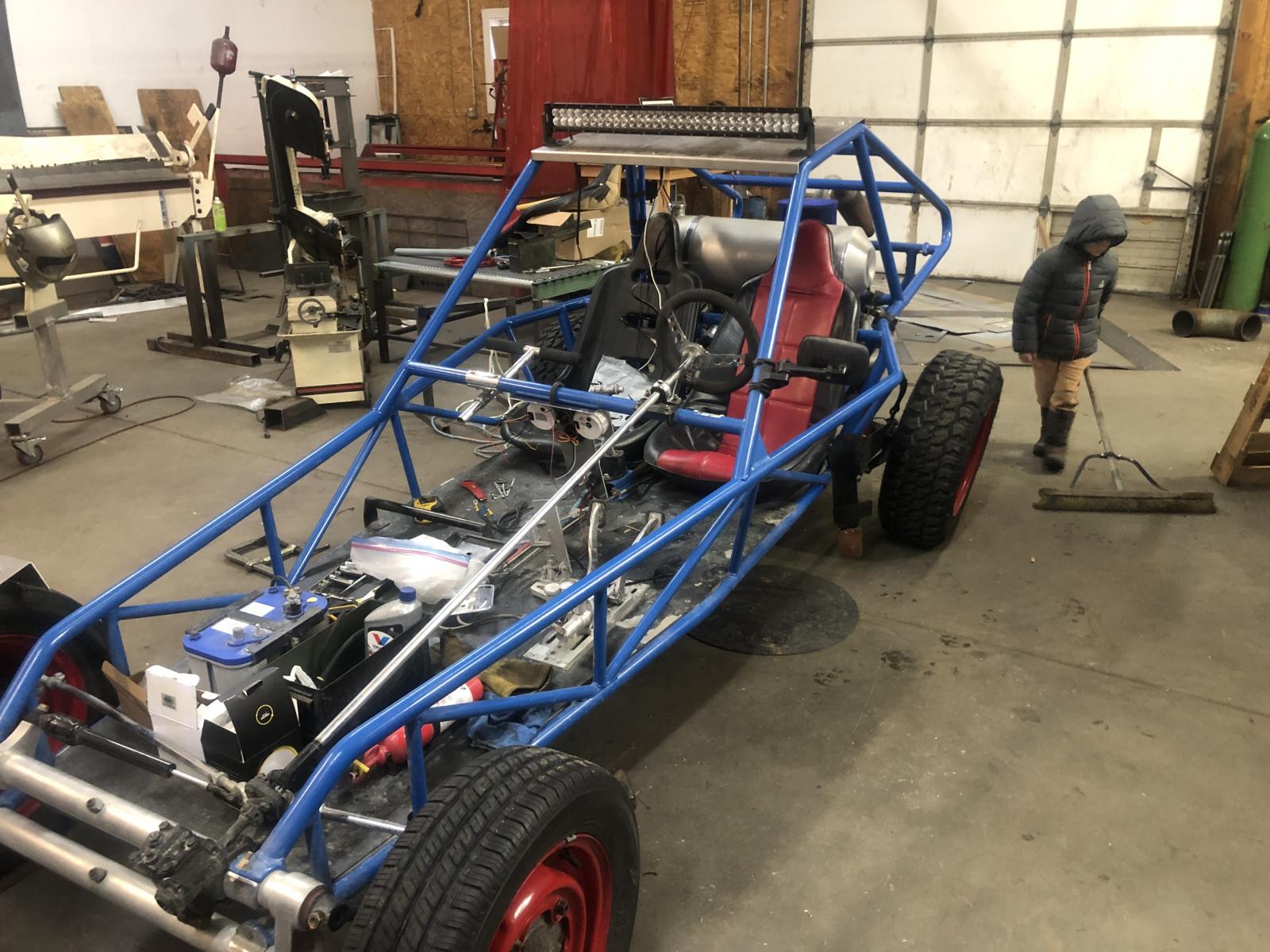

Got some aluminum in to the shop, should get some time later this week to fab some stuff.

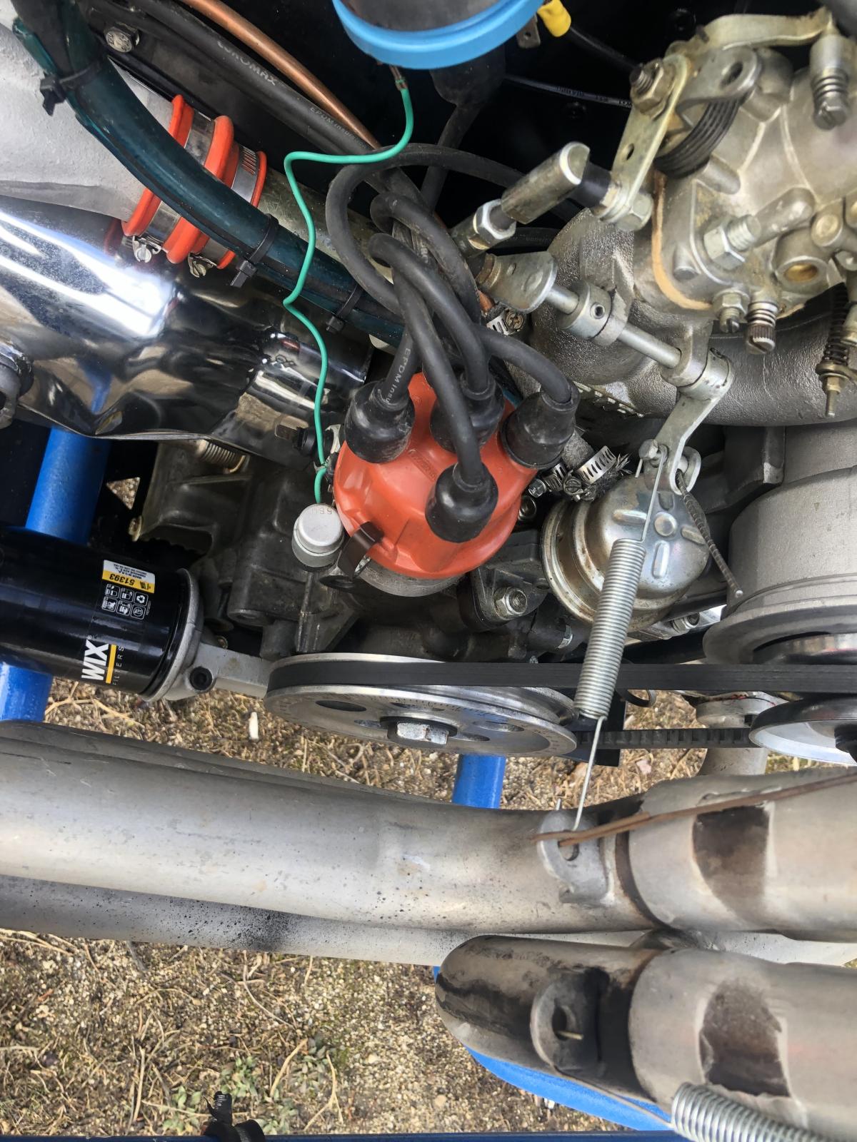

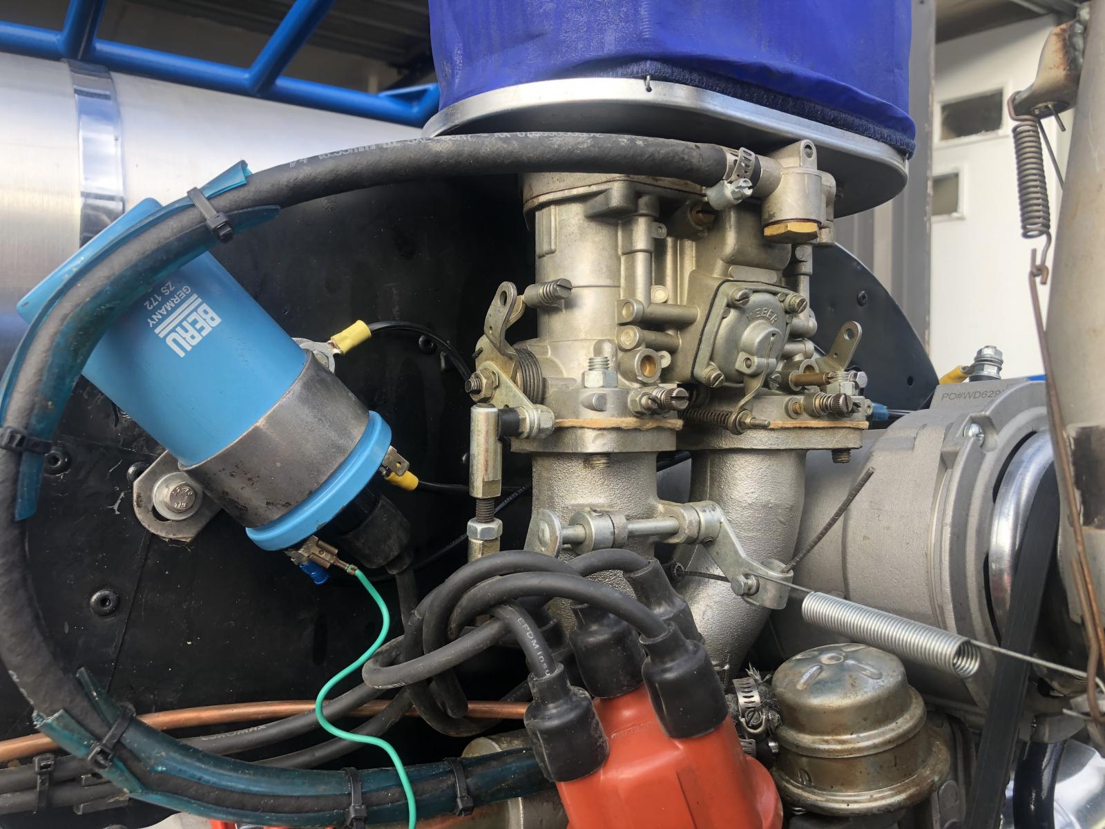

PostPosted: Tue Jan 07, 2025 10:37 pm    Post subject: Re: New guy, New rail, introduction, Pics Reply with quote

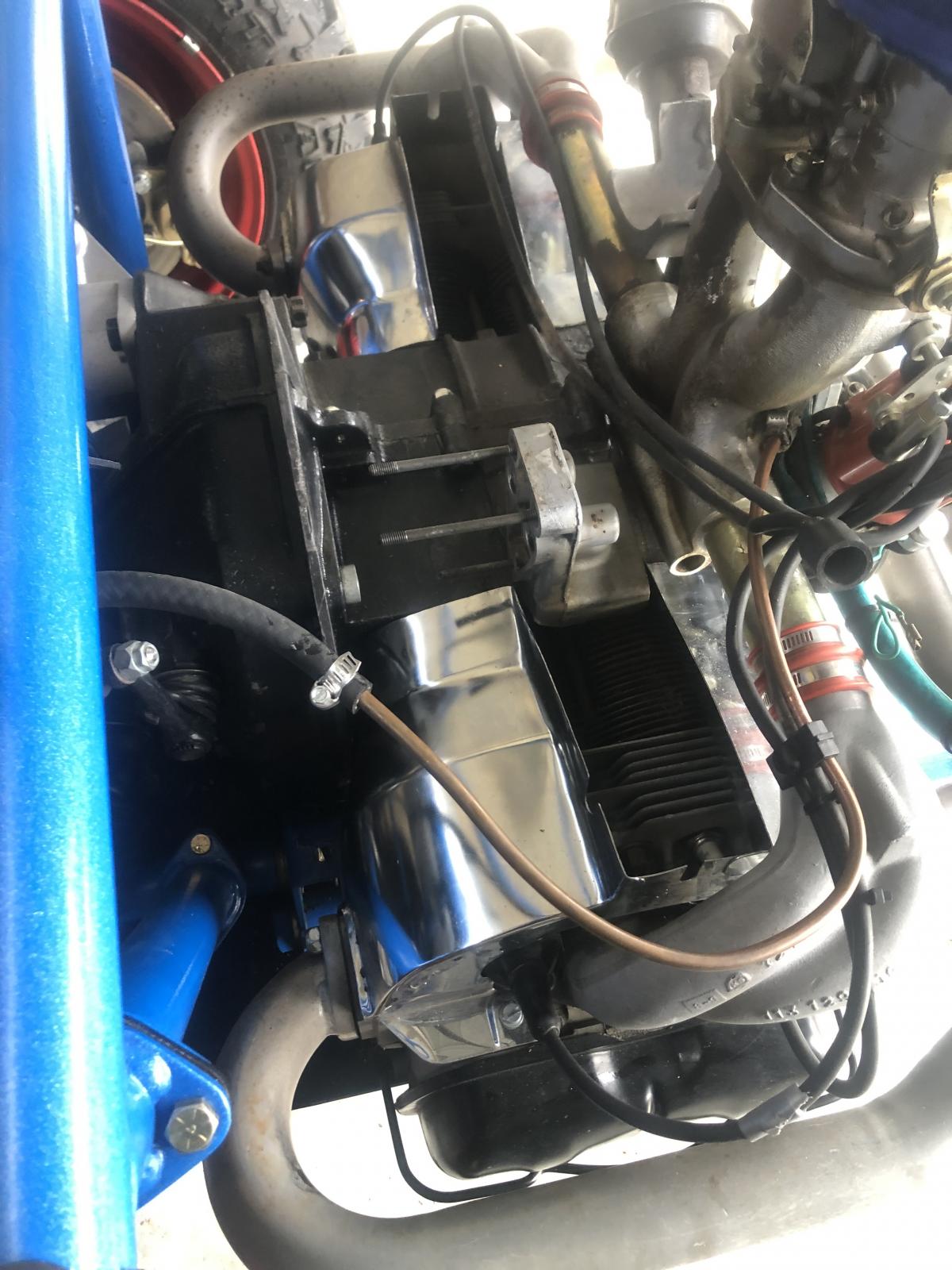

B
etter pic of carb and dizzy. Tried to clean up the plug wires but they were interfering with the linkage.

PostPosted: Wed Jan 08, 2025 7:16 am    Post subject: Re: New guy, New rail, introduction, Pics Reply with quote
I always like picking up a new buggy and seeing what ppl do and scratching your head trying to figure out why. like the rubber fuel line to metal line ( which looks like brake line ) then back to rubber. I get it if you were out an a rubber line got damaged but other than that why add a section of metal line especially a small one like that

PostPosted: Wed Jan 08, 2025 9:07 am    Post subject: Re: New guy, New rail, introduction, Pics Reply with quote
It’s actually copper line. I kinda get why they did it, to route it close to the fan shroud and have no rubbing issues, but it seems like one solid line would have less potential issues.
Got an aluminum air cleaner housing coming, the current stamped one looks a little cheap and feels sloppy.

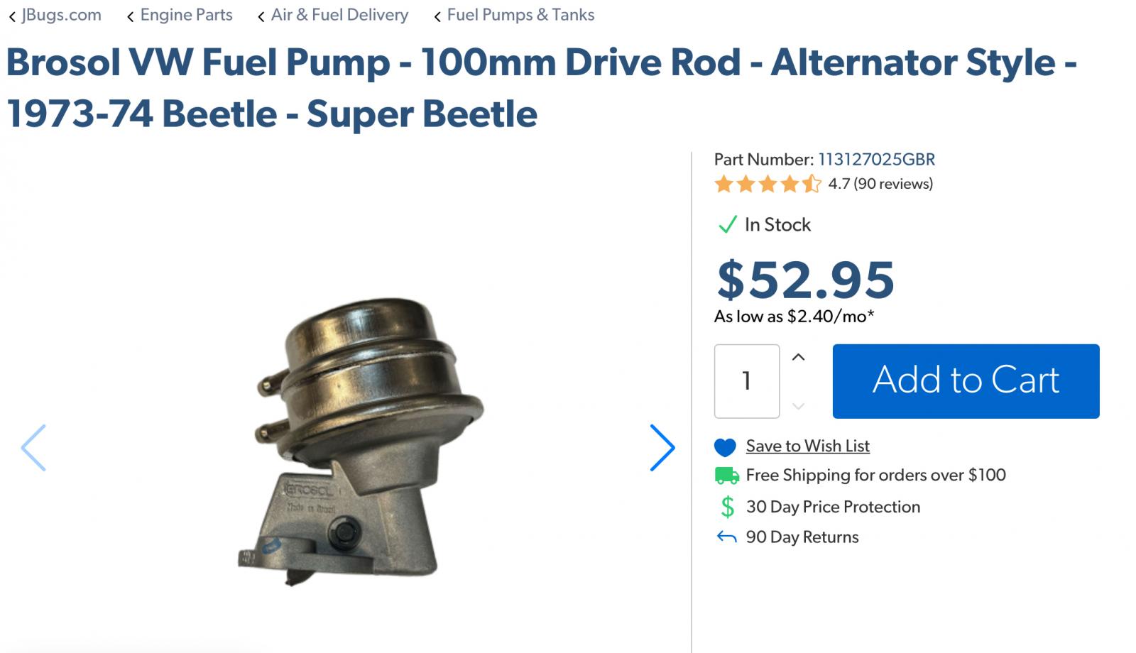

Anyone know what fuel pump I have there? Guessing alternator style. I’m putting a kit together for my Offroad adventures and would like a spare.
