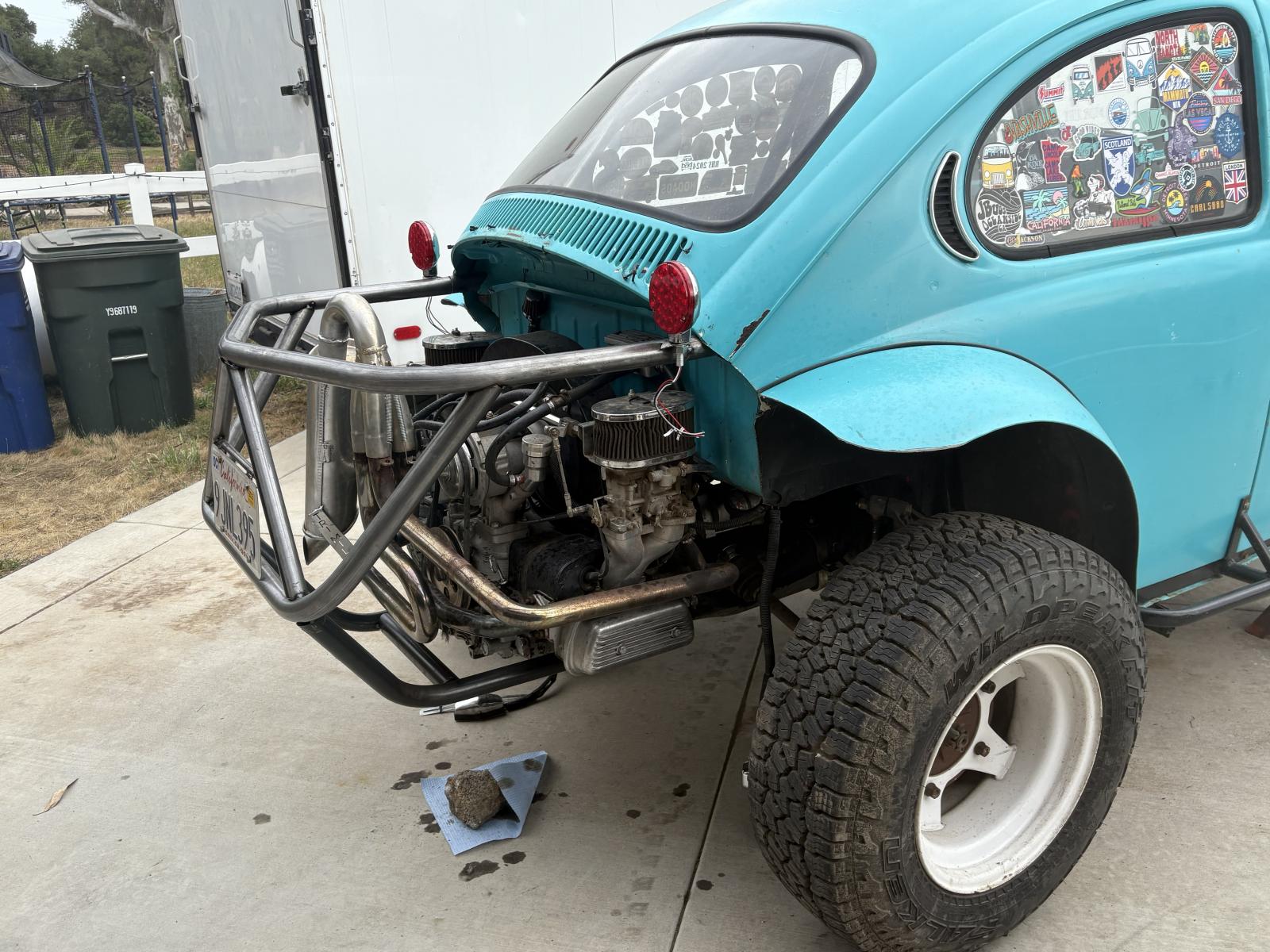

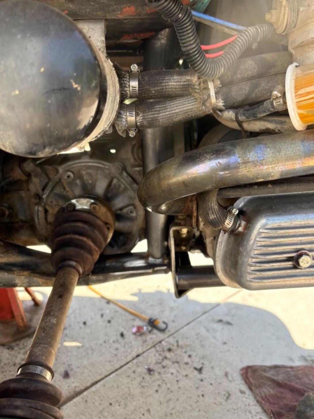

PostPosted: Mon Jun 16, 2025 7:48 am    Post subject: Re: Need Help with Suspension on my First Baja Bug Reply with quote
Avery,
Good to see your progression pics.
Honestly next I would work on getting that 3-rib in the car. It's going to take a decent amount of work in itself.
You'll need to address if you want the shift rod in or on top of the tunnel. A 10-degree mounting kit will get it in the tunnel for a cleaner install.
Unfortunately you've already built the engine cage. This also was one of the last things to complete.
The 10-degree trans kit gives you more rear ground clearance. Since the engine will be raised up a couple inches. With that kit there will be a large empty space between the sump and the lower tubes of your current cage.
If you go with the kit that puts the shift rod on top of the tunnel, the engine will likely stay in its current location. With no additional ground clearance achieved.
After that move on to rear trailing arms.
I recommend finishing one end of the car at a time. Since the back is more involved to that first.
Start thinking about your steering setup as well. You're not going to use the stock components if you go wider anyways.

My plan is to finish the majority of the cage this summer, daily it during the school year(I’m in college right now), and acquire all of the suspension components. Then next summer, start the suspension work!
I’m not sure how I want to mount the bus box yet, but I’m definitely going to use a Jamar box or similar to raise the shifter up to match the seats. So since I’ll have to cut a slot in the floor anyway, I’m not worried about it fitting in the tunnel.
For the engine cage, I was planing on just cutting out and replacing the lower bars when the time came. I wanted to have them in place while I’m driving it through out the rest of the year!
