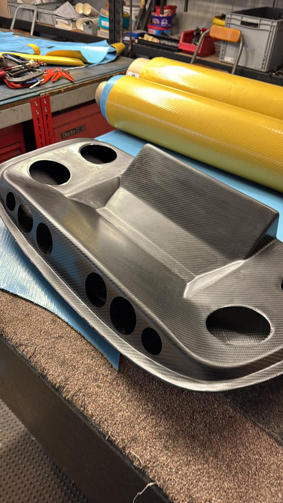

First carbon car made, just awaiting its shortened floorpan and then to choose the engine

Who is making these, how much do they weigh and what is the approximate cost--thanks Bob

Thanks for the interest
Made this myself, Cured in an autoclave using prepreg carbon fibre, I haven't weighed it yet but I can easily lift it on my own, its 1.4mm thick so really strong.
I already have the dash and engine cover made so just the doors and bonnet to do. I also have the speedster mould and should have the first one done fairly soon.
Price wise I'm not sure yet as I need to make the rest of the panels, its got to be more than the fibreglass car due to material costs but ill look at it when finished.
The quality is fantastic as its basically the ultimate process to make carbon fibre parts.

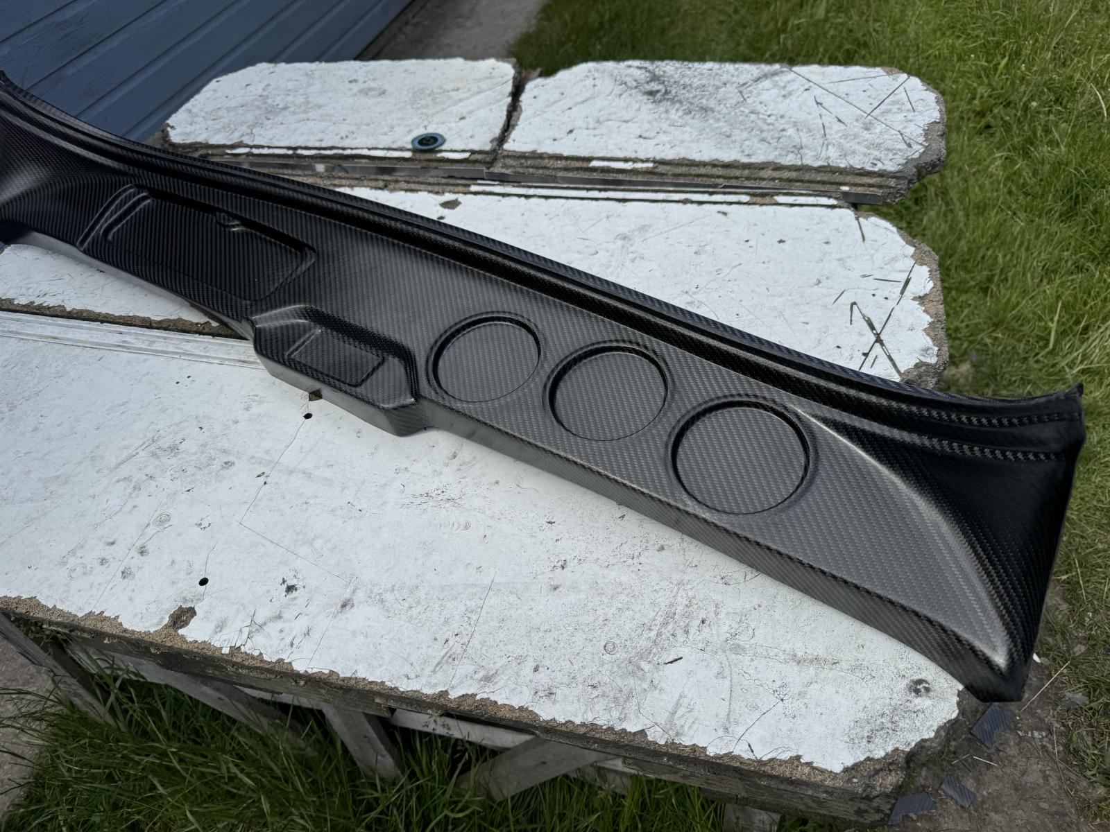

some other finished panels
