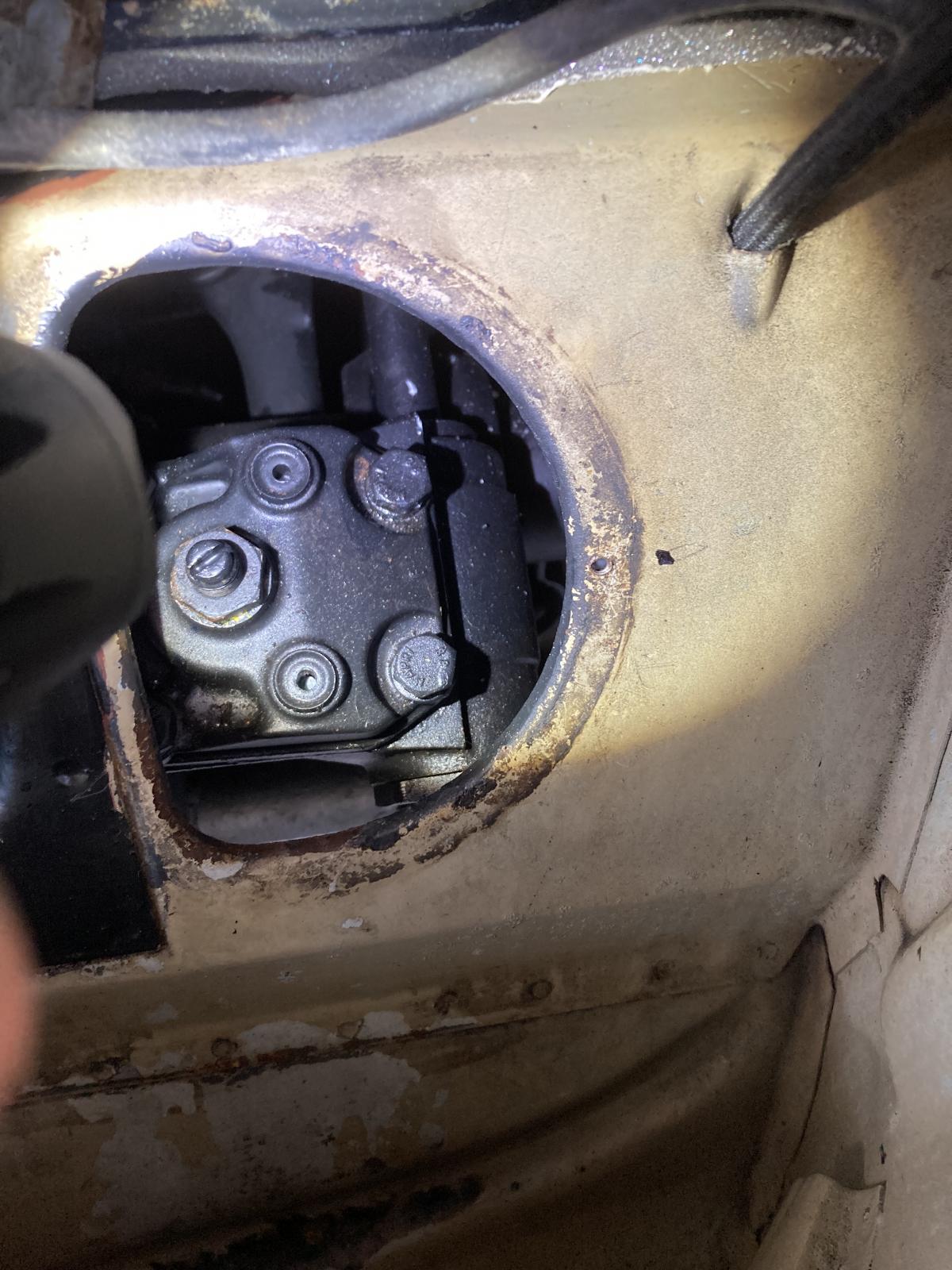

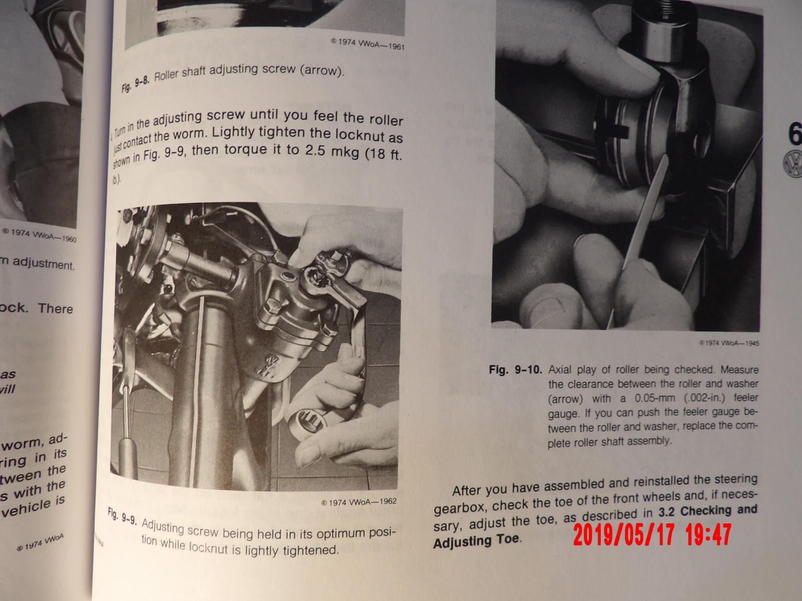

Luke59ragtop wrote:
...how do I tighten that up
Remove the spare tire...behind it you'll see two access covers. The steering box is under the one on the driver's side.
Loosen the large lock nut with a 17mm wrench, tighten the screw in the center just a little bit, then snug up the nut while holding the screw in position. This adjustment takes up the play between the roller and worm inside the box. Don't crank it down hard...tighten it just enough for the roller and worm to make good contact.
Two inches of play in the steering is not overly excessive...a slight adjustment should be all you need. Remember, this isn't rack & pinion steering...some amount of play when the wheel is centered is normal. If this adjustment doesn't take it up some, you'll need to dig deeper into the front end to find the cause.

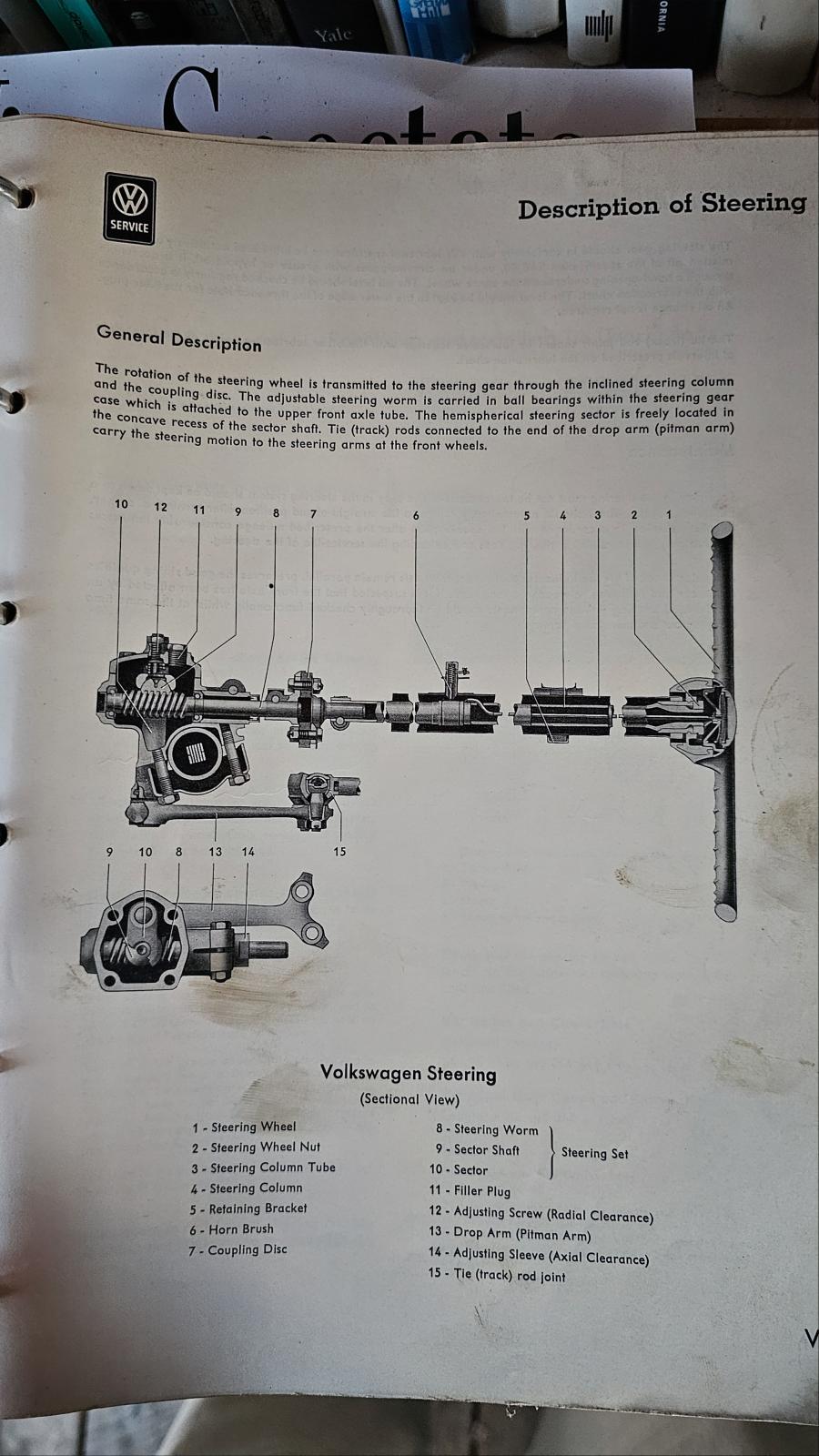

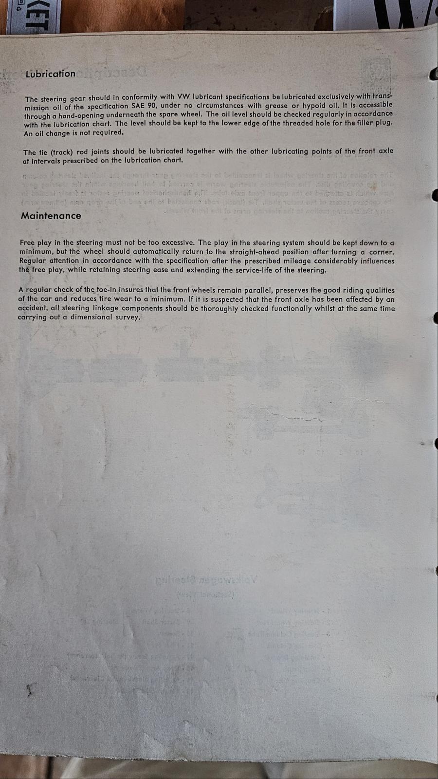

I just uploaded the 2 page portion of the '59 shop manual to my gallery.

Luke59ragtop
Joined: October 22, 2025
Posts: 14
Location: OR
Luke59ragtop is offline
PostPosted: Wed Oct 22, 2025 2:46 pm    Post subject: Re: 1959 VW ragtop that has play in the steering wheel Reply with quote
Bobs67vwagen wrote:
If the shop manual is a bit much for you right now. Get John Muirs VW repair for the complete idiot. He has a section on steering box adjustment and is written in a basic way that is easy to understand. Nice car those rag sunroofs are better than a convertible in my opinion.
Well thank you i just cancelled my order on Haynes repair manual 54 thru 79
Luke59ragtop
Posts: 14
Location: OR
Awsome thank you so much

rcooled wrote:
Nice looking car...welcome aboard.
Well thank you so much all new to me havent had one since high school.But yeah like a said i could feel the steering wheel move just a little bit before the car rolled while i was pushing it out of garage.

You can only determine steering wheel play when the wheels are pointed strait ahead. If you turn the steering wheel 1 turn left or right of strait ahead you will have lots of steering wheel play, this is normal and not felt when driving because the car is trying to return to going strait.

PostPosted: Fri Oct 24, 2025 3:22 am    Post subject: Re: 1959 VW ragtop that has play in the steering wheel Reply with quote
Your steering box looks to be a replacement. I only say this because your year bug would have a box that required oil to top off with one (1) bolt on top. Your box has the two (2) plugs on top that use grease to top off. Cornhead grease is what it's called. When I purchased my current '62 ragtop bug it had 4 or 5 inches of play on each side of the steering. After making other necessary fixes in the slop it still had some play. It was the original type that took oil. I purchased a new box. When I bought this box you could still get the TRW steering boxes brand new. I think I bought the last one from cip 1. Anyway , after all the upgrades it steered like brand new. This was about 6 or 7 years ago and the steering is still like new. I probably only put about 2 or 3 thousand miles a year on it though. Here's a link I used when I was doing the work on my Bug.
https://www.google.com/search?q=5+inches+of+play+o...#cobssid=s

PostPosted: Fri Oct 24, 2025 3:29 am    Post subject: Re: 1959 VW ragtop that has play in the steering wheel Reply with quote
^ I think that steering box pic was from rcooled not the op...

Whether you take it to a shop or do it yourself I recommend that you start by adjusting your steering box and make sure it’s full of oil. The older worm and sector box is nearly bulletproof and only worm and roller boxes are available new. If you swap to a new box you will also want to install a steering damper (if that hasn’t already been done.)

Before taking your beetle ANYWHERE, do this first. Get a helper to turn the steering wheel, while you slide under the front end to look for anything loose.
Had a body shop work on a Ghia once and when done the steering was loose. Turned out the dampener disc of the steering column was loosely bolted together. Loose as in the bolts could have lost the nuts off of them while driving on the road.
