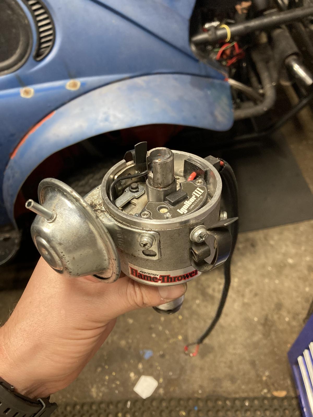

Add this thing to the junk pile.
Less than 1500 miles and it’s toast.
Pertronix coil tested good.
I was loaded up for a Rallycross event this weekend. Had just got gas and was heading back home. Spent months getting the car prepared for this weekend.
Then outa nowhere the car just died while waiting at a red light at the busiest intersection of town during commute time on Friday.
These two dudes were chilling on their porch smoking a joint when I broke down in front of their house. They helped me push the car onto the sidewalk. Super cool dudes.
My buddy towed me home with his 4Runner.
Missed the round 1 of the race today as I spent the day troubleshooting and tuning. Thankfully I had save the old crusty Bosch 009 points distributor and rusty black no name coil.
The car fired right up. Got the timing dialed in and drove great. It starts much quicker than the Pertronix did. I’m wondering if that was an indication it was having problems?
Not all is lost as I’ll be able to compete in round 2 tomorrow. No chance of winning as I missed round 1 but at least I can get the seat time.
I’m pretty upset because there’s so much hype around these things. We we’re literally just talking about the hit or miss quality of these units a couple weeks ago.
Now that I’ve experienced the death of one of these electronic units, I’ll never get another.
I’m pretty much convinced that I’ll be going back to points.
I could have had it back on the road in 30min if it were a points setup.
I learned a lot today.
Once this weekend is over it’s time to figure out what’s next.
I’m thinking a restored 034 svda?
While yes, the performance factor may not be as high, at least it will be reliable.
For me reliability more important than performance.

Pertronix got a good name for themselves by selling a simple bulletproof points replacement unit - the Ignitor 1. But just like points, if you left the car with the ignition on and the engine stopped, it could burn out the coil if the points were "closed".
So they created the Ignitor II - which detects that the engine is not running by measuring the time between ignition events and turns off if it is too long.
However, it seems that once the module has got hot at some time, it sometimes decides that cranking is too slow and turns off. And also can develop high speed faults giving misfires..
Then they created the Ignitor III that attempts to use the four lobes of the points cam with a sensor as timing references. The slopes of that cam are fairly gentle, and so it is difficult to get stable and accurate timing out of this kind of design. Leads to rough idling if the engine speed varies much between the lobes of the cam - which it does- and the effect builds up until it ends up with unstable idling.
