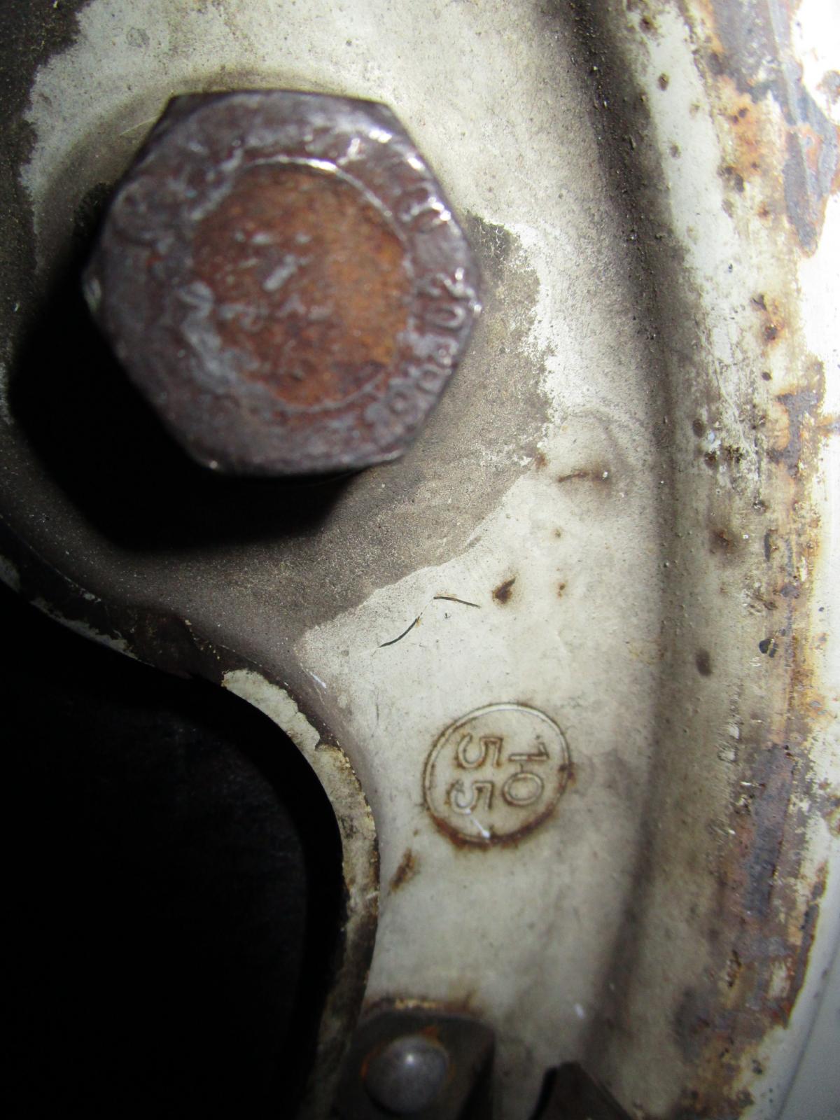

Same lug bolt fits 50-70 bus front and rear.
also later beetles. IIRC, my 69 bug uses the same bolt, but I think earlier bugs use a more slender bolt.
Basically, about every VW place should have some used ones kicking around.
If you want to get crazy og with the cosmetics, you might be looking for early part number lug bolts, which were used through early 56 . Early bolts have flat tops, later are dished.
Here's a blurry pic of my Jan 56 camper's early lug bolt:
