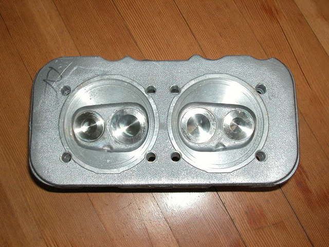

yes, I am using AMC/Raby 1800 heads in my Westy. You must check the CR as Scott has mentioned as the 2.0l chamber is slightly different size. Switching over to the early HE's also gives you better heat!

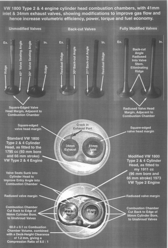

55~56 cc, is consistent with what my VW 1800 Type 2, cylinder-head combustion chambers were originally, before I increased them to 60·0 ± 0·1 cc, to give 8·0 : 1 compression ratio, with my 1911 cc, VW 17/1800 Type 2 & 4 modified hybrid engine. The factory-stock valve-diameters, are 41 mm inlet & 34 mm exhaust.

My Raby 1800 AMC heads with 42x36 valves
I am using 914 pistons set up for a 7.5 to 1 CR.
