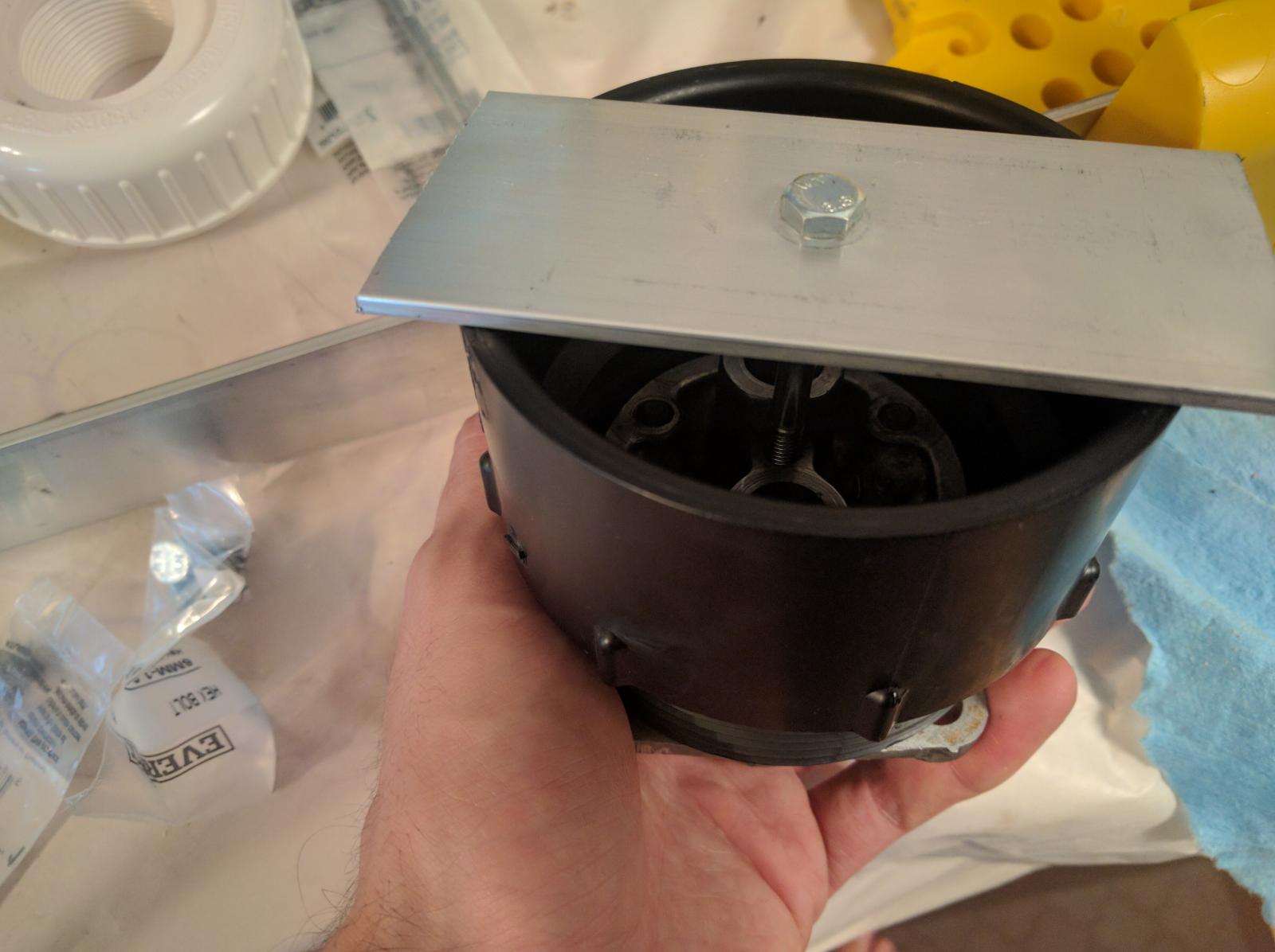

PostPosted: Thu Aug 25, 2016 10:55 am    Post subject: Type IV (4) oil pump tool Reply with quote
Note: to eleviate the risk of stripping the pump insert threads.
Put a nut on the threaded 6mm bolt, insert the bolt through the hole in the puller and screw the 6mm bolt all the way into the pump body.
Hold the 6mm bolt stationary and tighten the nut to pull the pump insert.
whip618 wrote:
I made this puller years ago, it works nicely especially when taking apart an old pump that is caked with old oil.
Phil
mrcool wrote:
3" pvc adapter, 1/4" aluminum stock, M6X1.0 60mm bolt.

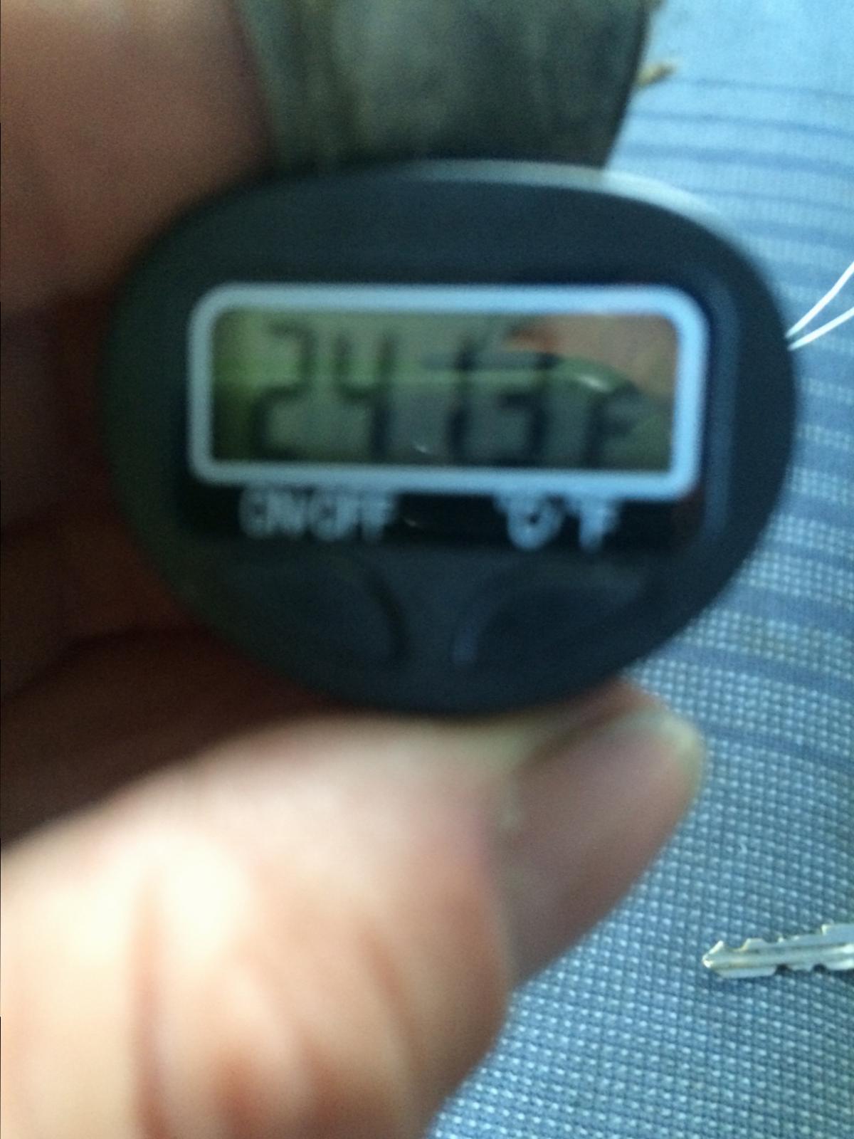

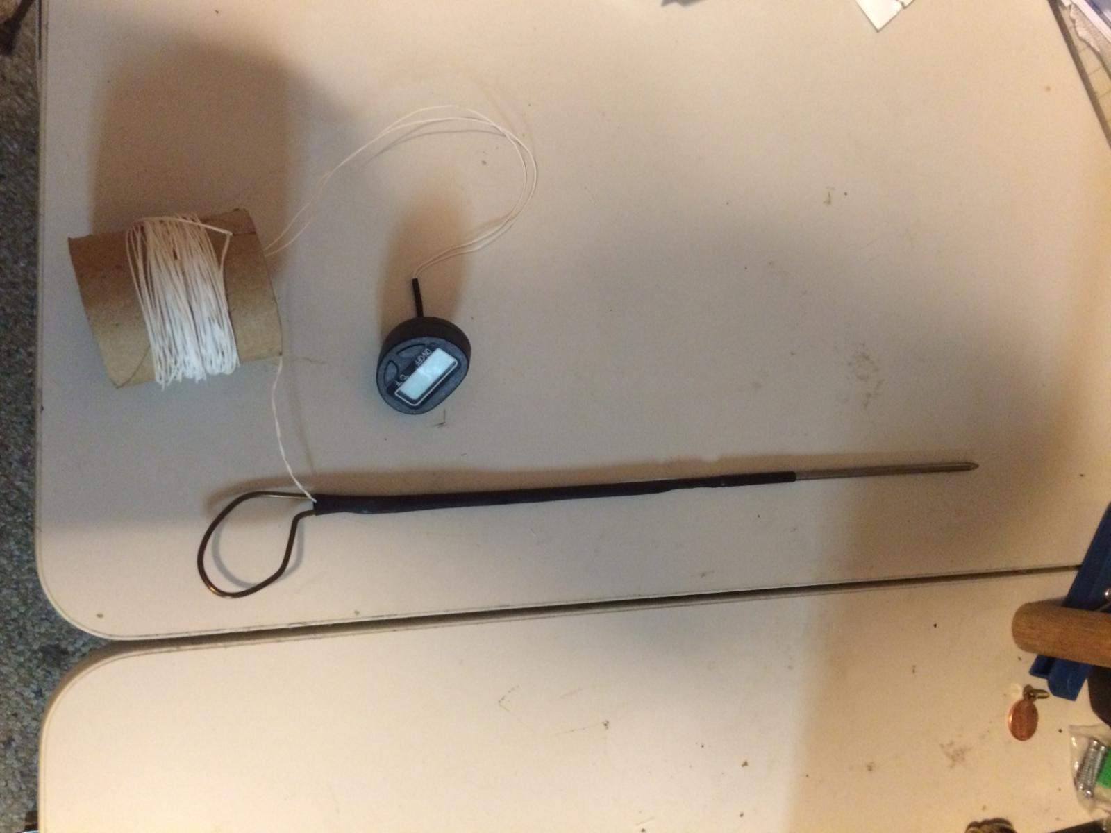

PostPosted: Sat Sep 24, 2016 1:58 pm    Post subject: Oil Dipstick Thermometer Reply with quote
A diagnostic tool I made out of a harbor freight food thermometer.
