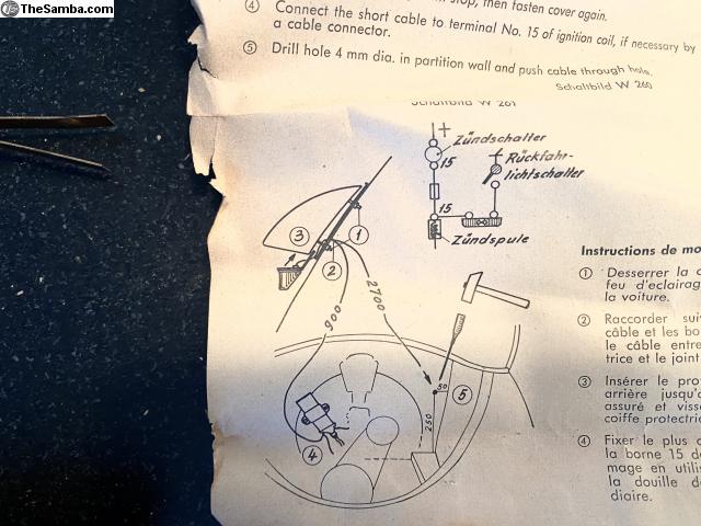

yes on the Jokon lights
and yes, it's a reverse switch. Tom brings up two of the common ones, this was the 3rd

PostPosted: Tue Nov 02, 2021 12:59 pm    Post subject: Re: 1966 Ocressa Beetle Reply with quote
here is the bug version complete with the switch and the little wiring diagram. it feeds off the coil
https://www.thesamba.com/vw/classifieds/detail.php?id=2436110

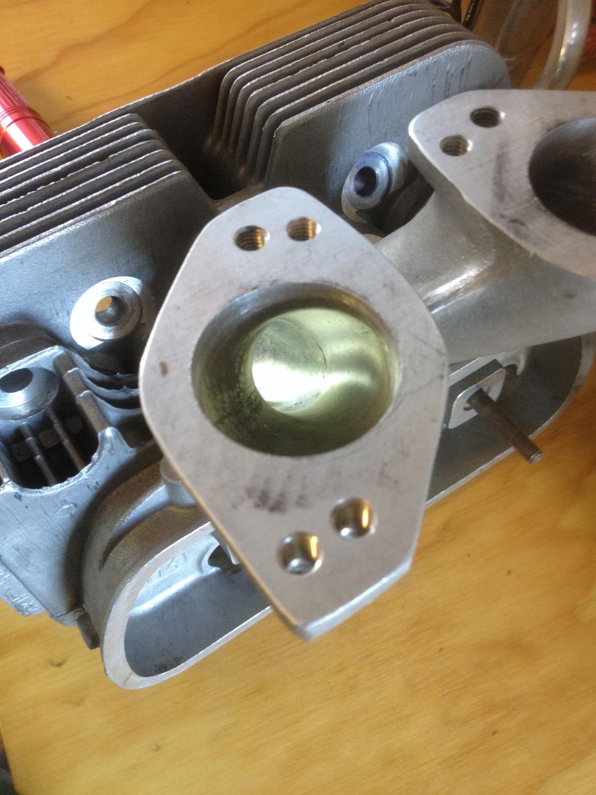

PostPosted: Wed Nov 03, 2021 9:32 am    Post subject: Re: 1966 Ocressa Beetle Reply with quote
Not nearly as exciting as the Okrasa motor, but here’s what’s going in while the Okrasa gets built. New case, 78 stroke Skat crank, old Rimco super rods, 90.5 Mahles, light flywheel, 044’s ported to old Gene Berg manifolds and a smattering of Berg stuff. It won’t be billetized. Working on tin fitment and other details prior to paint. Note to self, don’t leave blasted parts in a box on the shelf for years.

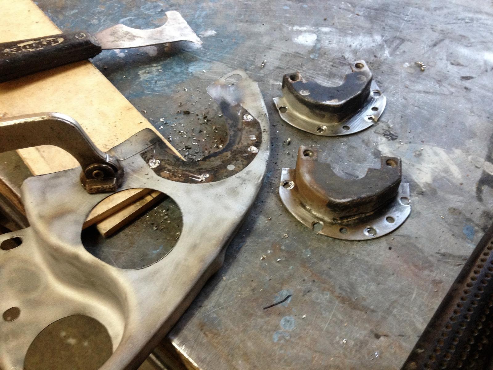

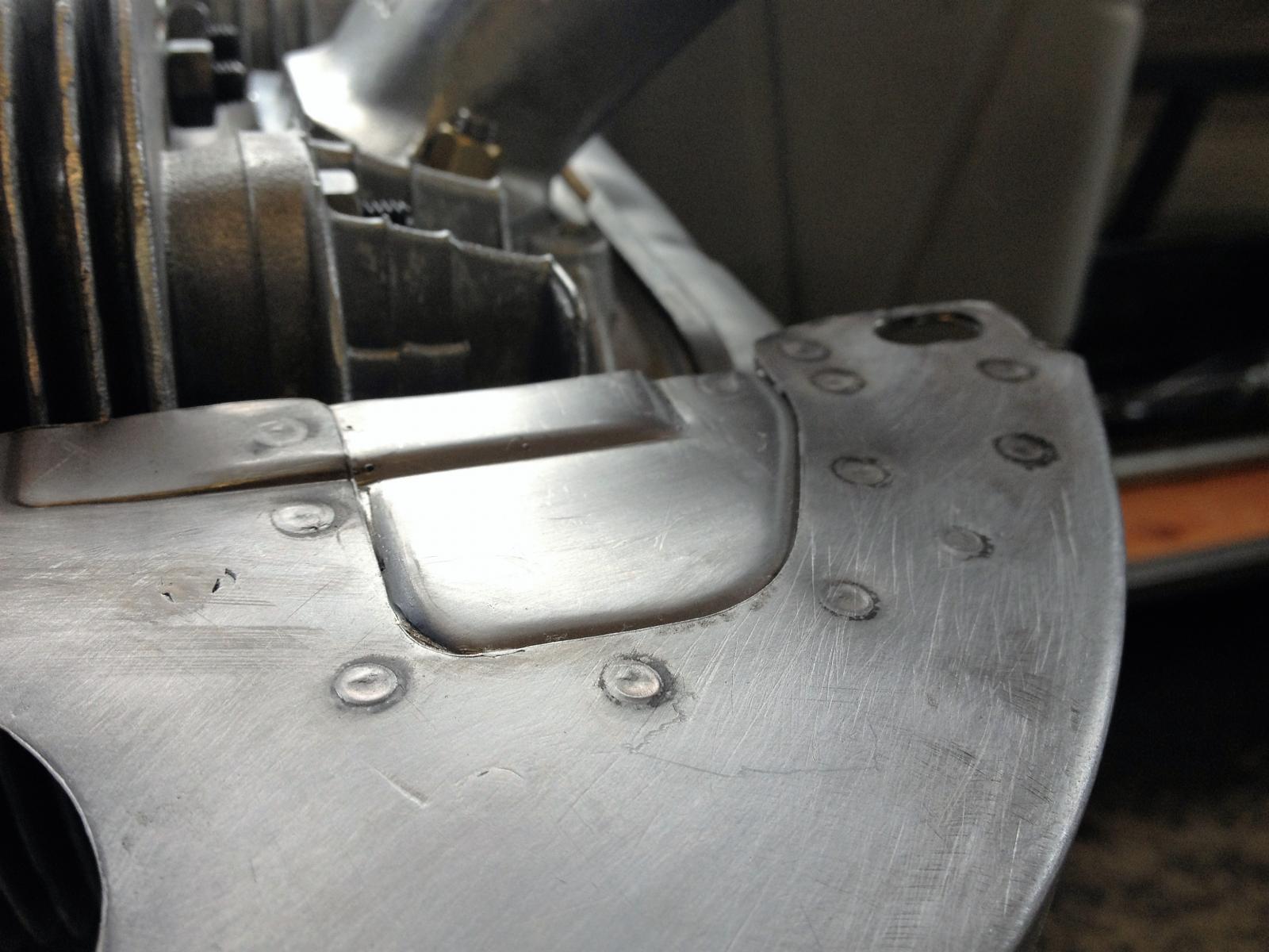

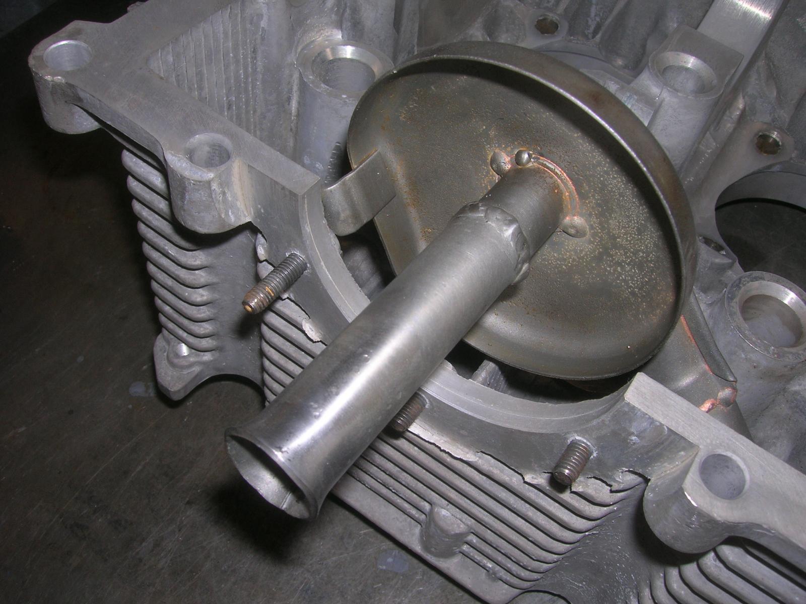

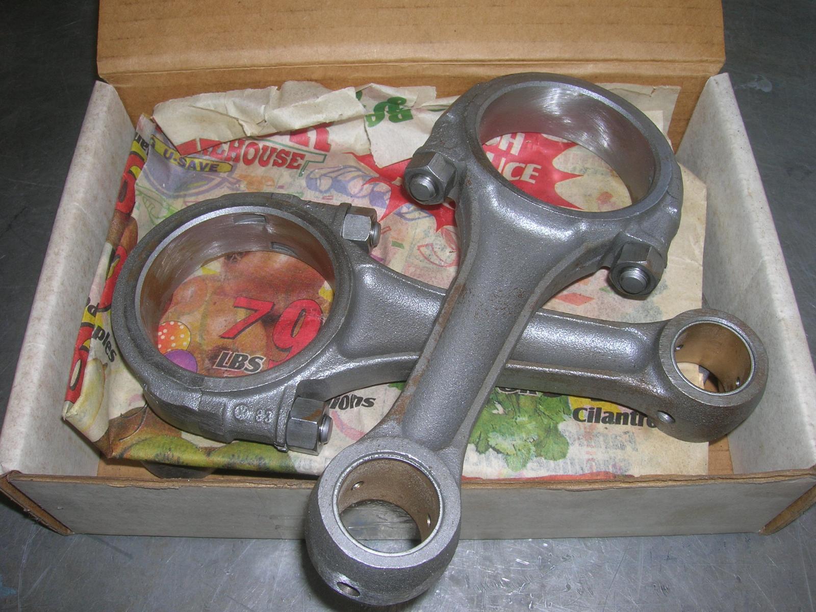

All the tin will be satin black. Factory-ish look.
Here’s some engine assembly photos.

PostPosted: Sat Nov 06, 2021 7:02 am    Post subject: Re: 1966 Ocressa Beetle Reply with quote
Wow nice work on the Breast Plate. I think the one speaker posted earlier was for a Public Address system, dude was a Ham/Short Wave nut. Smile
