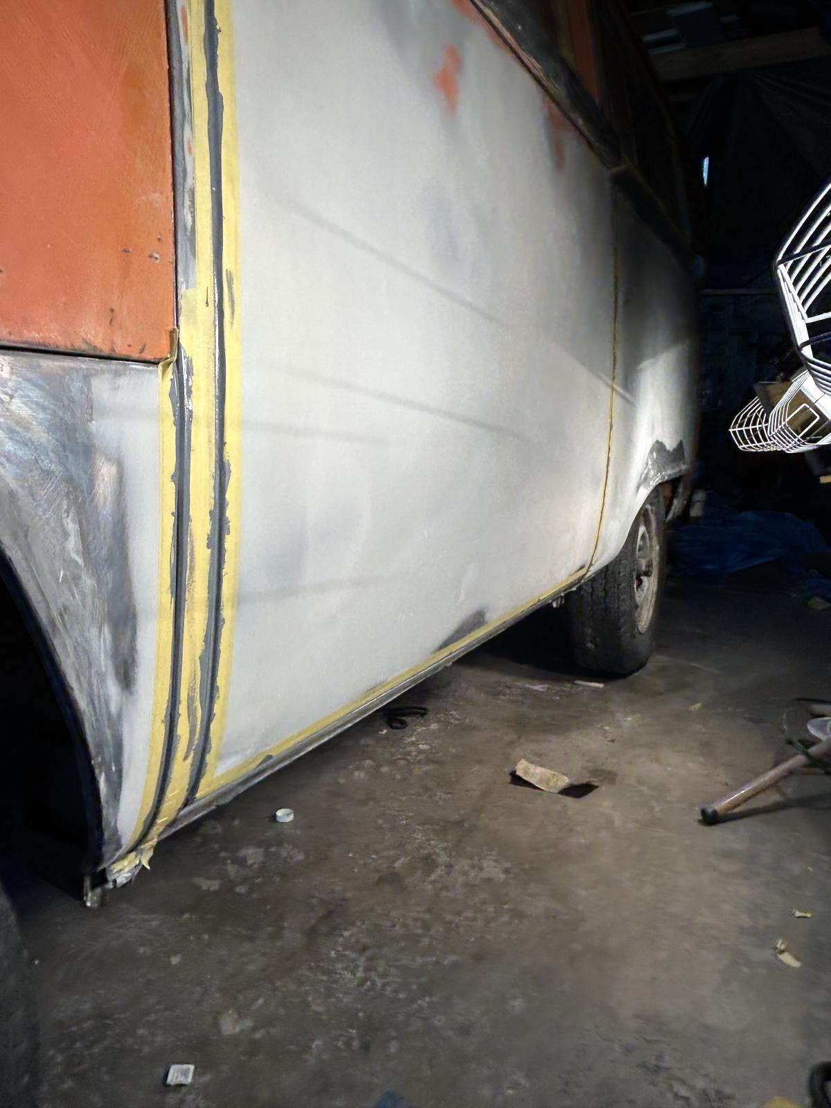

Moving along slowly. Hard to find the kind of time this work takes. Dragged the blaster out yesterday to chase out some rust pits and prep the seams for epoxy and seam sealer. Really adds to the time, but it’s worth it to not have it come back. Water tight and rust free matter more to me than how the paint ends up looking.
Shop gave me the wrong grit, so it was like shooting stones. Had some crushed walnut…too soft. Got it done with what I had on hand.
Rockers will need some more sanding and scuffing

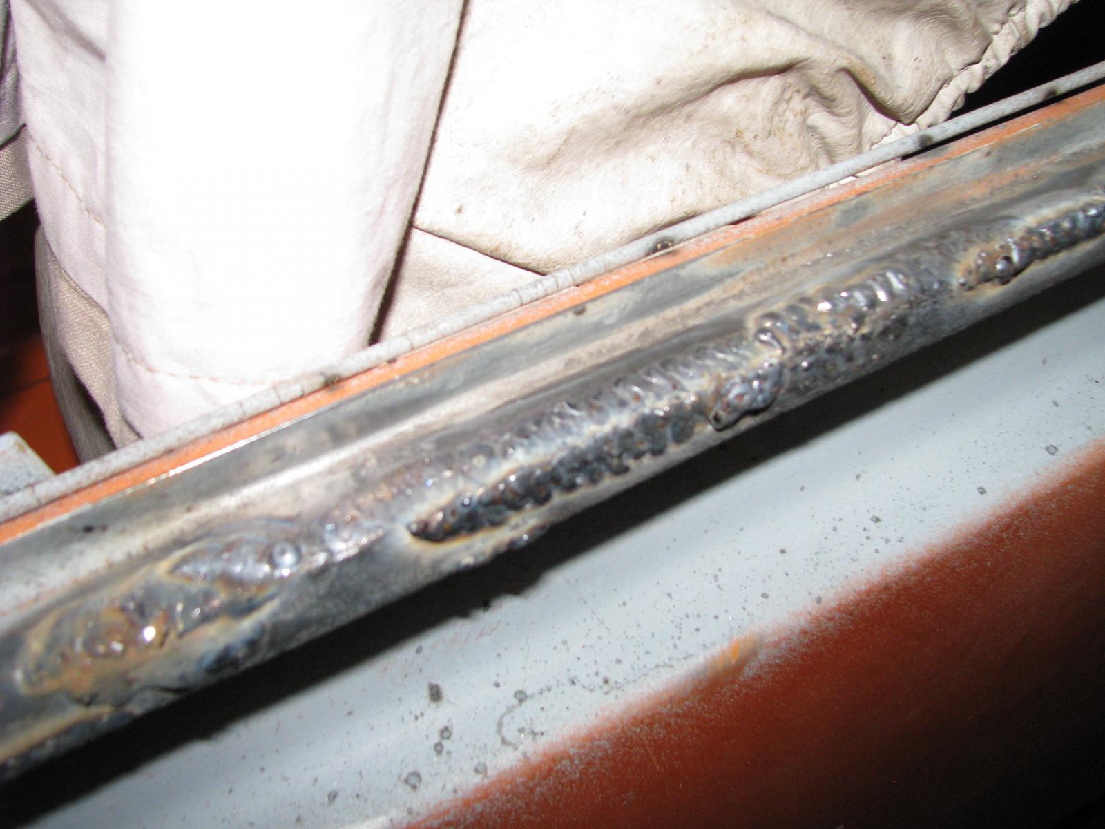

Body lines are a pet peeve. B-pillar got a little lumpy welding in a new section and fighting in the wheel arch. With different panels, plus stuff you make yourself, you gotta cheat a little to make it look like it all lines up.

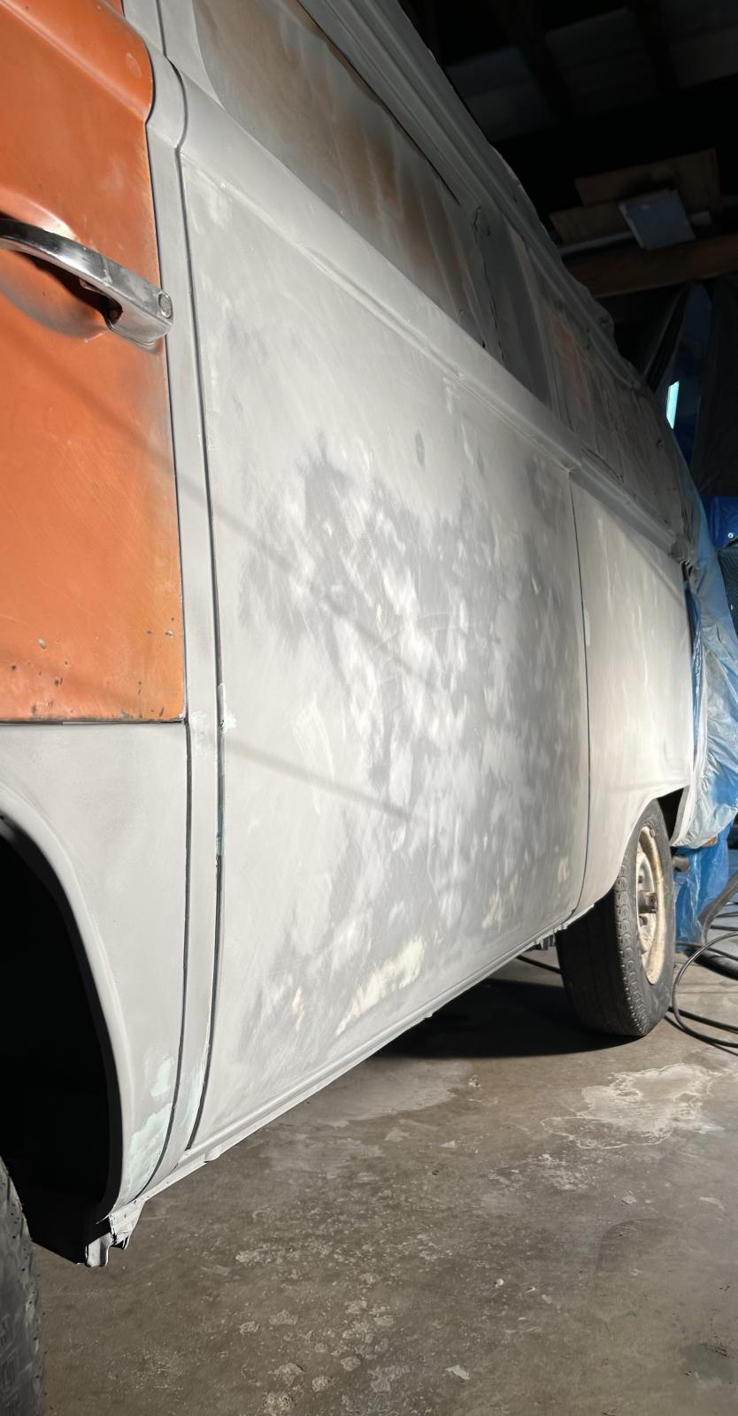

I know it looks exactly the same as in the last photos, but it’s getting there. Lots of pinholes to fill and straightening out the seams. The panel edges actually line up which they never did before from the factory…Those big panels are usually lower at the edges and higher in the middle, but straight and is the only thing I can work towards without it looking off. B-pillar looks better after some sanding and filling.
A couple more more spots to glaze, then it’s :
80/180 with the long board
220 on a shorter sanding block
Epoxy primer and seam sealer
A couple gun-fulls of high build
A few days for it to shrink
Wet sand with 600 grit
Paint!
This will probably be the last of the big panels I will be able to paint outside this spring, unless I get a lucky run of good weather. Lots I cannot get done in the garage in the winter with use of heaters and hot lights, but not paint on big panels.
Also getting better consumables. Scrounging whatever is on hand wastes a lot of time in hokey masking and overspray cleanup.

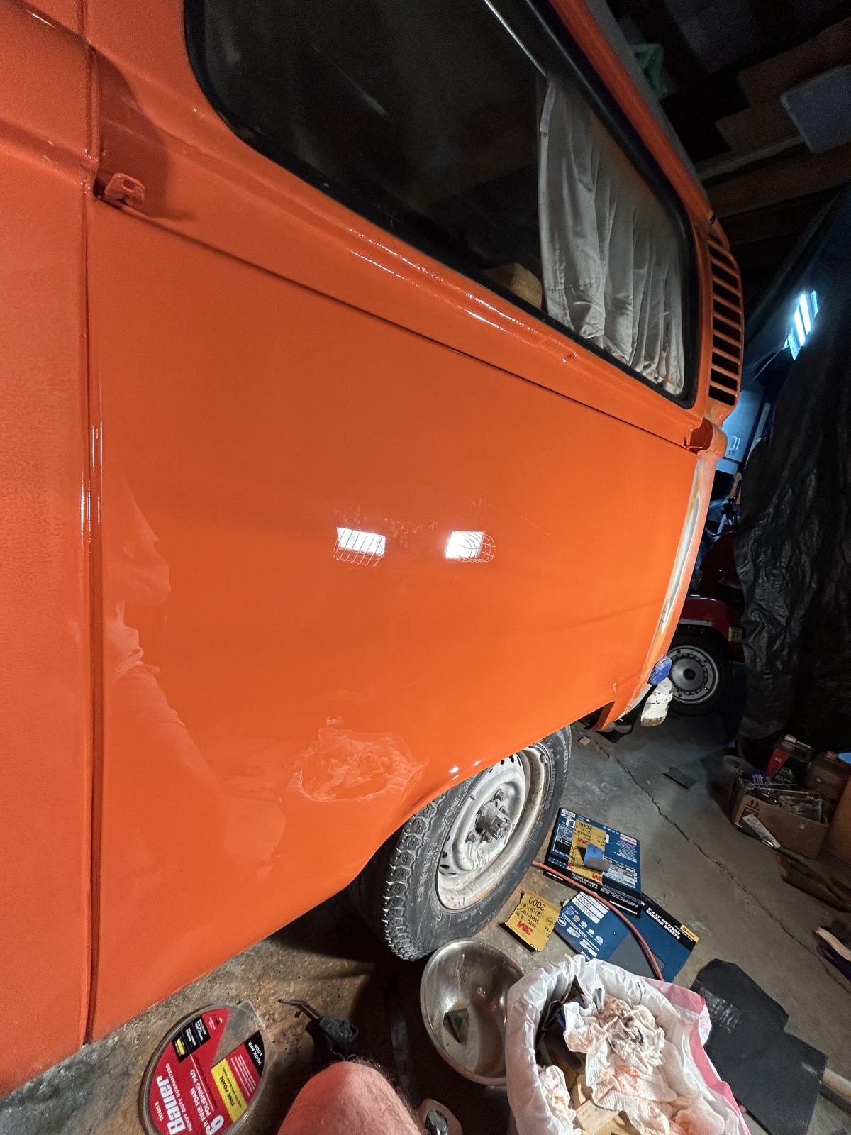

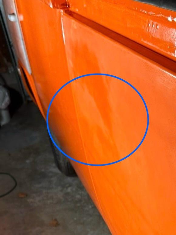

It was a shitty day to paint. Crazy wind that wouldn’t stop. But watchoo gonna do when it’s ready to go, sunny and 75* and you’ve called in sick to get it done. Shoot it!
It’s just a gentle breeze.
Some moderate peel. If I adjusted the gun to make it juicy, still got peel…with runs.
Balls! By t it’s on.
Color sanding should save it. There’s enough paint on it.
Window frames came out fine. Worst case scenario; wet sand and reshoot below the belt line.

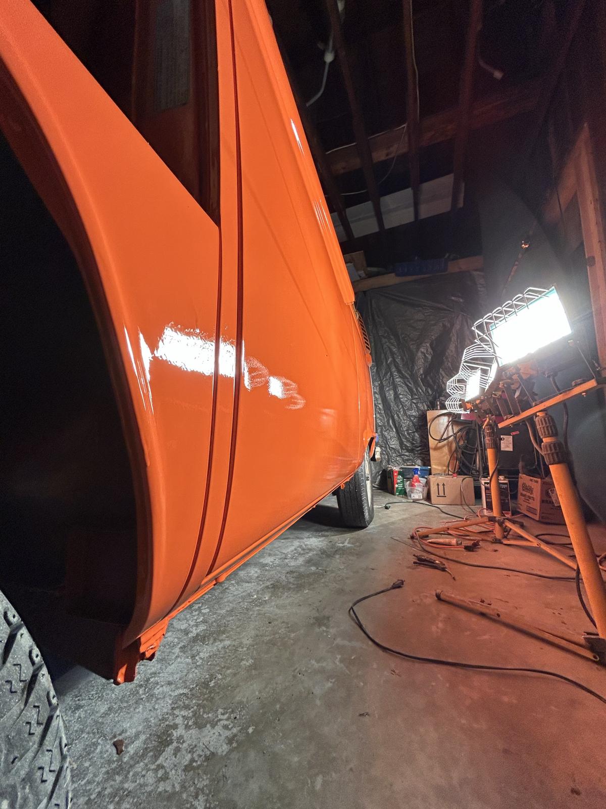

While painting, I ended up with a huge curtain run. Tried to use a trick I saw on YouTube of lifting off the run with masking tape. It made a bigger mess of heavy peel.
Started on this run. If sanding can salvage this, then the rest of it can be salvaged. I managed to get it flat without burning through. Got most of it flat, hit with the buffer and sanded some more. Usually, I’m too soft on the buffer afraid to burn through. But if you’re too dainty with it, the buffer doesn’t cut.
No point stressing about it. If it burns through, it’s easy enough to shoot another coat depending on how bad it is. It becomes a question of how much time it takes to fix little things vs spraying another coat. Also whether flaws in the paint will be noticeable or if you can live with them. Sometimes recoating just gives you another set of flaws to pick at. Most people looking at your bus will just see a shiny bus because they have better things to do than nitpick your paint. That is me once I start driving it again. I had this whole list of things on my scooter to touch up when I finished it. But once I started riding it, I stopped seeing them. Gonna finish up the cut and buff in the long side and move on to the next panel.
Run, be gone!
Starting to flatten out with no primer in sight

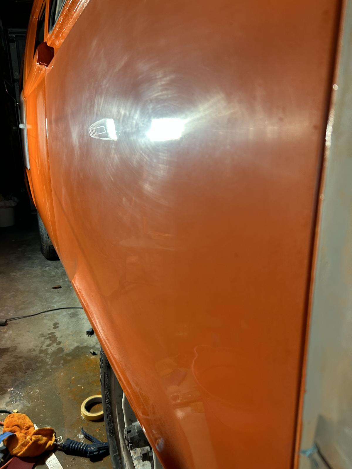

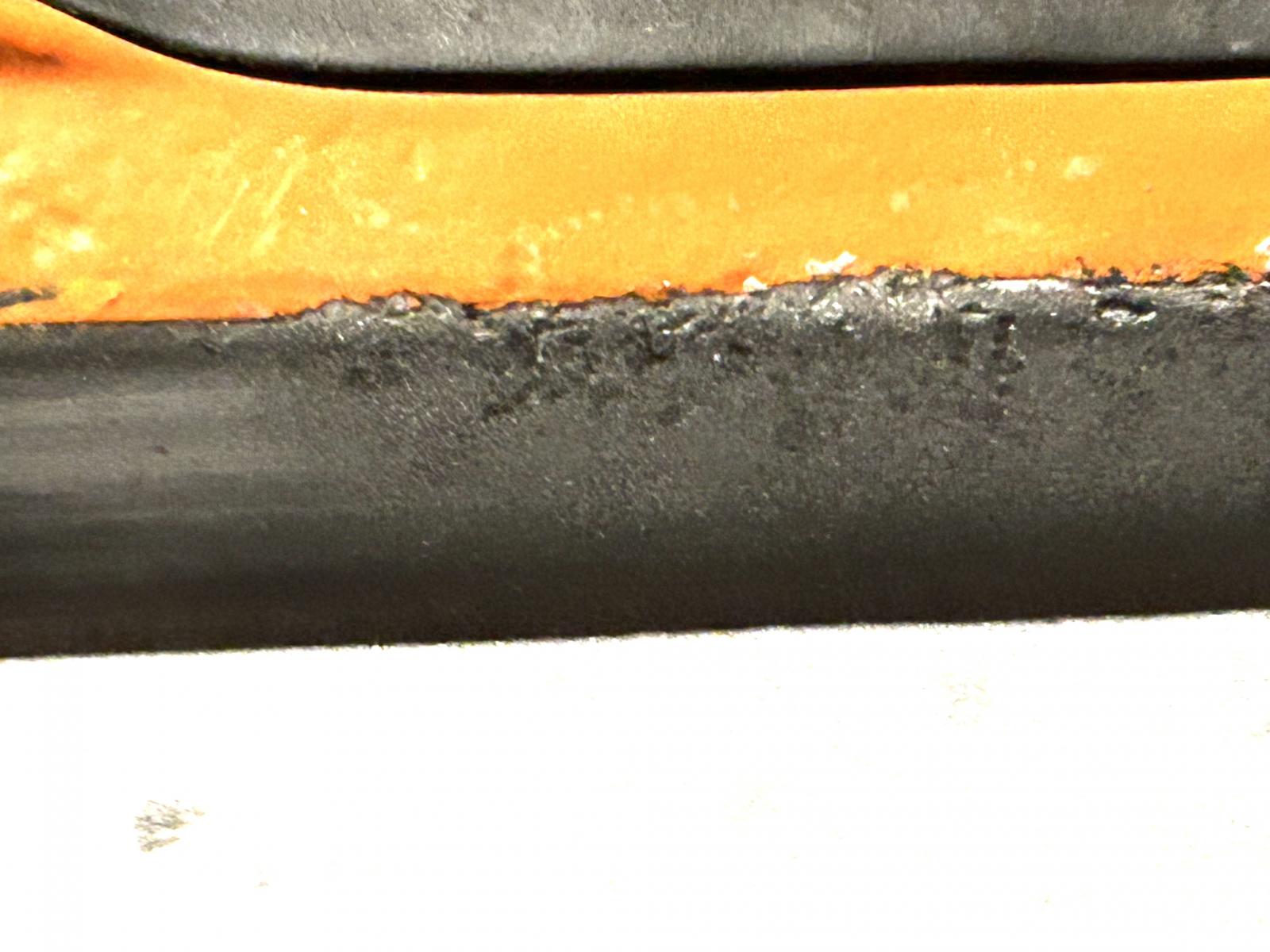

Couple evenings of sanding in the rear quarter, mostly with 2000-5000 grit…as low as 800 for the runs and getting trash out of the paint. It’s kind of been a test panel for trying out different techniques as I was expecting having to repaint it. Anything worse than the peel I started with, I wouldn’t bother trying to save it. If this survives buffing without burning through, I’ll be happy with it.
Here it is after being sanded out:
A more honest photo:
Hopefully buffing will remove these scratches…

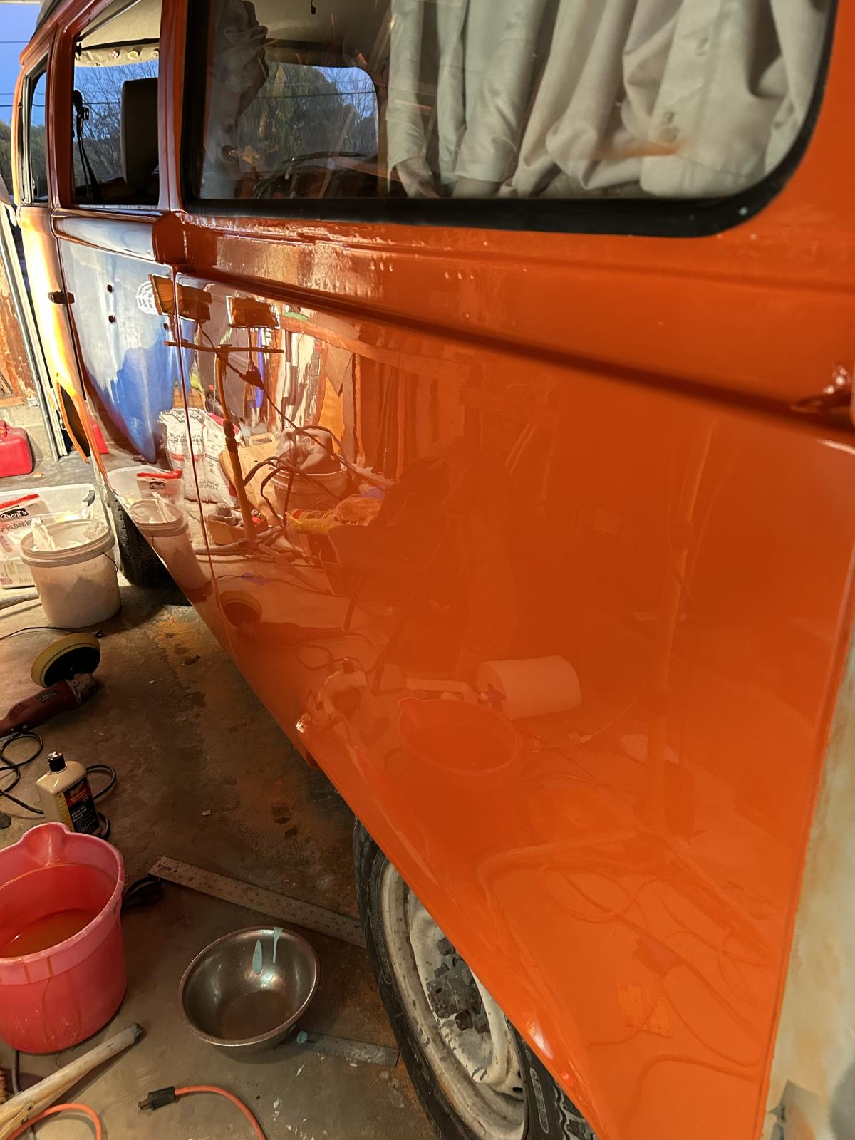

Paint! It drives me crazy. Sometimes it lays down perfectly. Other times it does crazy and unexpected things. This time it was pinholes left in the paint when the runs were sanded down…like grainy shadows of the run that was once there. So I looked it up, ‘cos I hadn’t seen it before. It’s called air entrapment which is a different thing from solvent popping. It’s caused by air bubbles remaining in the paint from putting on too much at too low pressure or moving the gun too slowly. I think in my case the wind also didn’t help.
https://youtu.be/ETf3O-14bmU?si=iEeebcxe0_X7dg3A
Learned a lot about buffing though. You have to buff with compound for awhile before getting out sanding scratches. The panel came out good, but there were porous spots left behind wherever there was a run. Also with the orange, when spraying too heavy, the yellow solids tends to drop out of the paint. Luckily, I only got this on the rear quarter where I tried to pile on the paint over the run. Hard to pick up on camera, but you can see it right where the lights are reflected.
I enjoy doing this partly because I like learning how to do new things and improving my skills. I might try out touching up and blending these spots just to see how it goes. Nice thing about having an iffy panel is that you can try stuff out without worrying that you’ll mess it up. Easiest would be to scuff and reshoot another coat on the 1/4. At this point, I’m going to move on to the other panels I have left.
One more thing. Sanding out every spec of peel is not necessary unless you want that wall of gloss look. All production cars have orange peel and reproducing different types and grades of peel is its own special thing in the restoration world. How much texture to leave in the panel is up to you.

These are the last photos of the long side. I promise. This is how it came out after sanding and buffing. There are definitely some flaws in the paint, mostly from painting outside in windy weather. I may circle back and fix some of the them later on, but it’s time to move on to the other quarter. Can’t say I’m unhappy with it. If the rest of the bus comes out like this, I will have no complaints. Half the bus is in paint at this point and I feel like I can make good progress over the winter.
A big thanks to Clatter for his excellent thread on prep/painting and color sanding under adverse conditions. His thoughtful and detailed responses to my questions have helped me a ton. One of the best lessons from his thread is that if the paint goes to shit, you can fix it or do it again. Way better than kicking yourself for screwing up. Giving yourself permission to make mistakes makes it a lot less stressful.
