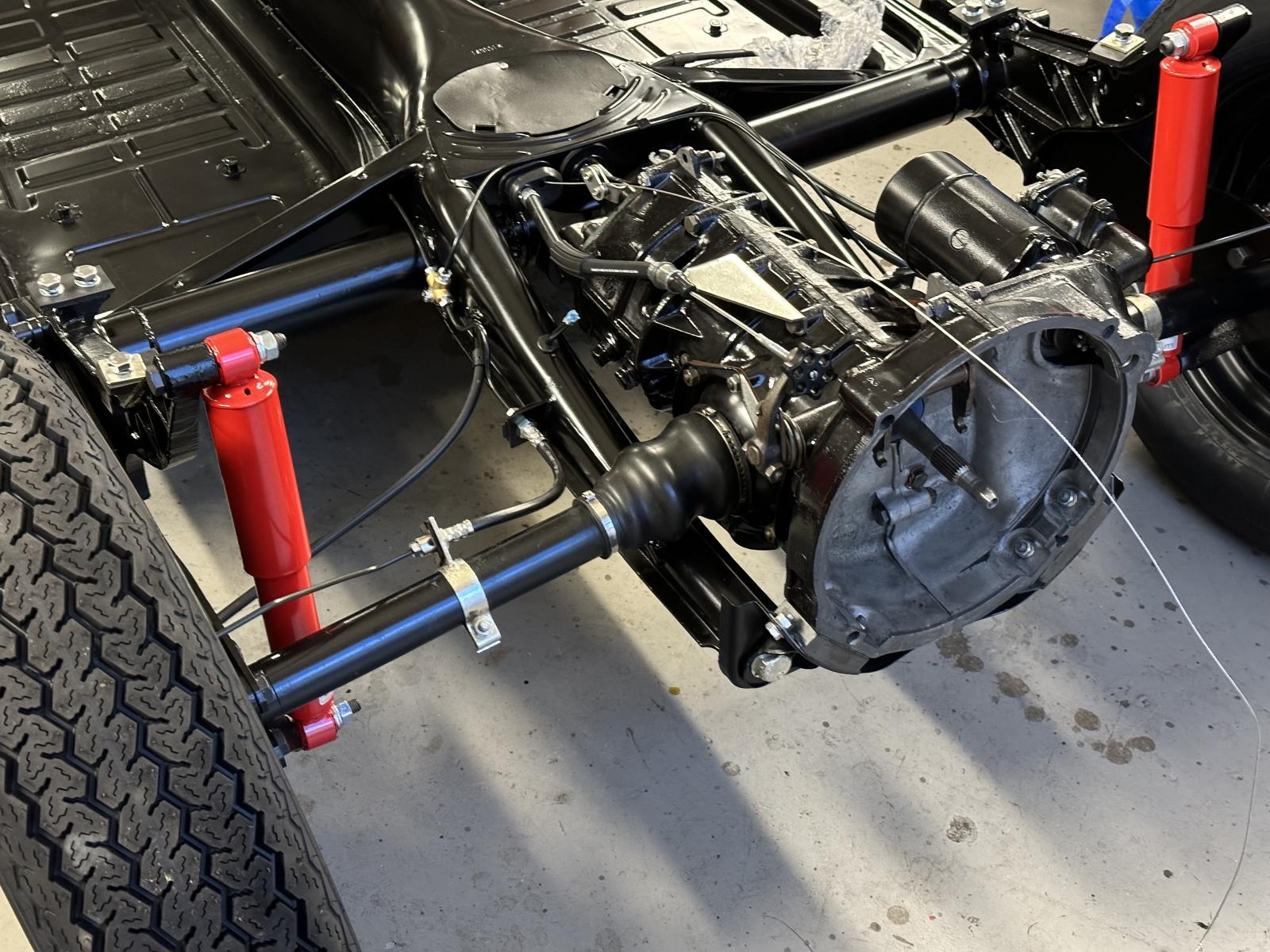

PostPosted: Mon May 15, 2023 3:17 am    Post subject: Re: 1959 Beetle Restoration Project Reply with quote
Project Update:
It's been a while since posting. The good news is the car is back from the body shop and I will start the assembly process. The pan is nearly done as well. I know several of you asked me to take photos of the body in the sun, but we have had nothing but constant rain in Vienna since I got the car back. Once we get some decent weather I'll post more pictures.
Arrival day:
Some shots of the pan:
I still have a few more things to do the pan--install the seal, bleed the brakes, final torque adjustments, bend safety plates into place, install heater cables, transaxle gear oil, etc. Some will notice the changes I made to the pan--updated accelerator from Classic Bug Parts, accelerator cable guide on the transaxle from Butty's bits, "6-shooter" clutch cable adjuster from Airkewld, newer master cylinder, updated torsion arm covers from CSP, etc... I will do a full write up on the pan once it's done and will list the parts and procedures I used to get it done. I was wondering what straps people used on their axle boots? The one's I ham using seem a bit narrow and I was thinking wider straps would be better. Any suggestions?
Finally, given I have access to a lift, I am thinking of installing the motor and just lowering the whole body onto the completed pan like they did at the factory... Anyone else do it this way? Any tips or tricks to make the process go smoothly?

PostPosted: Mon Jul 24, 2023 3:22 am    Post subject: Re: 1959 Beetle Restoration Project Reply with quote
jbannon wrote:
Project Update:
First, great job and fantastic attention to detail. That's going to be a beautiful car.
My high school best friend had a '59 and that's what got me into VWs back in 1966, so - I love '59s. Very Happy
I think those Oetiker style axle boot straps are fine. That's how they were installed from the factory. I've never used them on replacement axle boots because they are such a pain to get on when laying on your back under a dirty old VW.
Did that starter come with the car? The way the solenoid is clocked makes it look (in the pictures at least) like a Porsche 356 A style starter.

Thanks for the reply and feedback. It’s greatly appreciated.
Per your question regarding the starter, that is the one that came with the car. I am always amazed how you guys can spot these differences! I’ll take a closer look next time I’m in the shop and provide more details in a future post.

PostPosted: Mon Jul 24, 2023 8:08 am    Post subject: Re: 1959 Beetle Restoration Project Reply with quote
After looking at my starter and comparing it to your pictures, it is definitely a 356A style Bosche starter. I was probably a popular standard style in the '50s, used on a lot of cars, but they are absolutely needed on Porsches.
