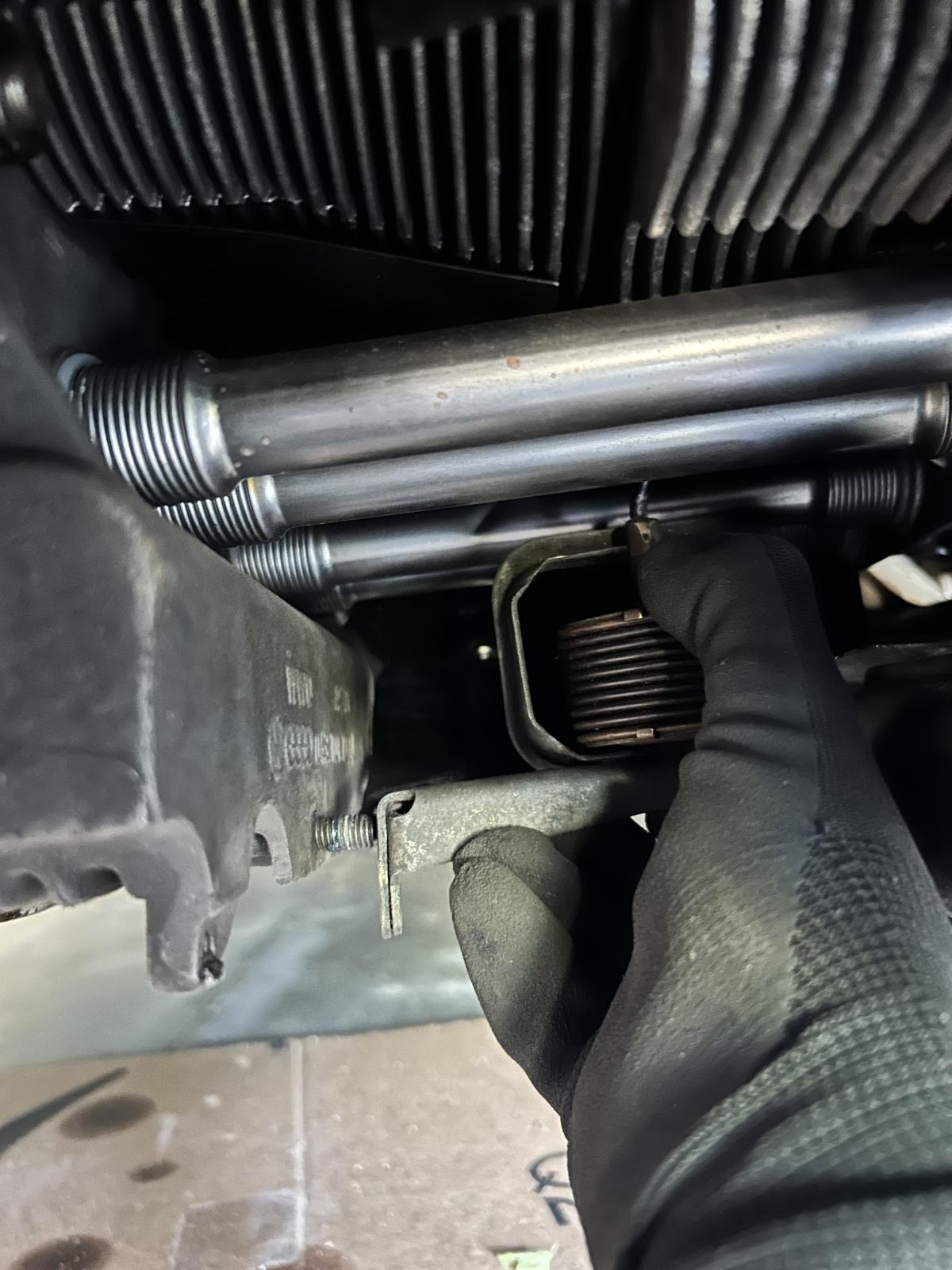

Well here's the next conundrum - I'm already out of adjustment on my thermostat. If I disconnect the bracket and pull the whole thing downward until it stops (flaps closed, I assume), here's where I end up. As you can see, I'm outside of the range of the slot on the bracket. Not really sure where to go from here aside from pulling the whole fan shroud to adjust it. I suppose I could try and introduce a new bend in the rod which would shorten it, seems risky though.
'77 FI Bahama Blue Type 1

If the bracket won't slide down far enough to get full flap closure the problem is the U link on the RH flap where the rod attaches, unfortunately it requires removing the shroud to fix. The U gets bent when someone trys to lift the shroud without removing the thermostat first ("why won't this thing come off?"... yank yank YanK), the bend screws up the leverage ratio or in other words moves the fulcrum.
Disconnecting the thermostat and hitting the highway won't make it warmer, it'll keep it from ever warming up properly. For now set it as low as you can and tolerate the clacking valves, at least if they are making noise you know they aren't tightening up and burning.

Ugh that’s what I was afraid of. I filed out the hole on the Tstat bracket to allow it to sit lower, I believe I’m getting full flap closure now. I also switched out to 15w40, that seems to have warmed things up slightly, but hasn’t made an order of magnitude difference. I’m still struggling with oil not getting up to temp, which I don’t like. Cooling TOO well was definitely not a problem I anticipated having when rebuilding. I’m running a basically stock engine with a spin on filter mount, the type people say sits too close to the exhaust and frequently makes the oil too hot! I’ve heard of people running smaller crank pulleys to slow the fan down a bit, I may look into that. Otherwise I don’t really understand. What could be causing me to have such ridiculously cool oil? Is it possible one of my relief valves is malfunctioning and constantly sending oil through the oil cooler when it’s not up to temp? How would I test that?
