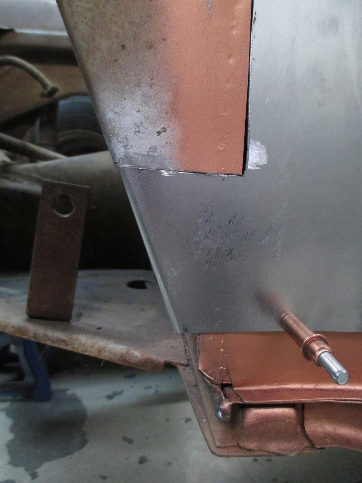

You can use epoxy putty, the stuff off of Home Depot’s shelf. You knead it together and press it in. More like pack it in. I typically take the point of a razor blade and scrap out the fissure, so the area is clean down to fresh base material, then fill the opening by forcing the epoxy into the opening with a wood shim.
Once cured, sand, prime and paint! Works a treat!

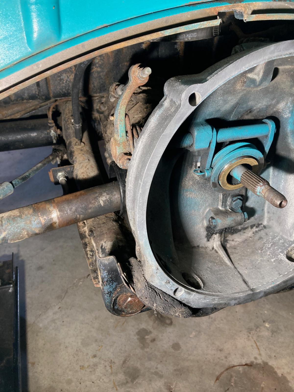

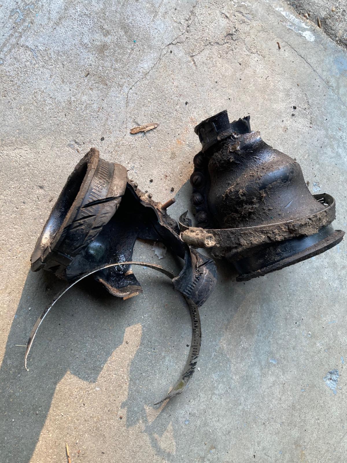

Tackled the axle boots with a Dremel cutting disk.
The car was last driven a couple of years ago and interested in checking the oil quality. When the body is lifted this whole sticky mess will be cleaned up along with the standard blue over-spray.
