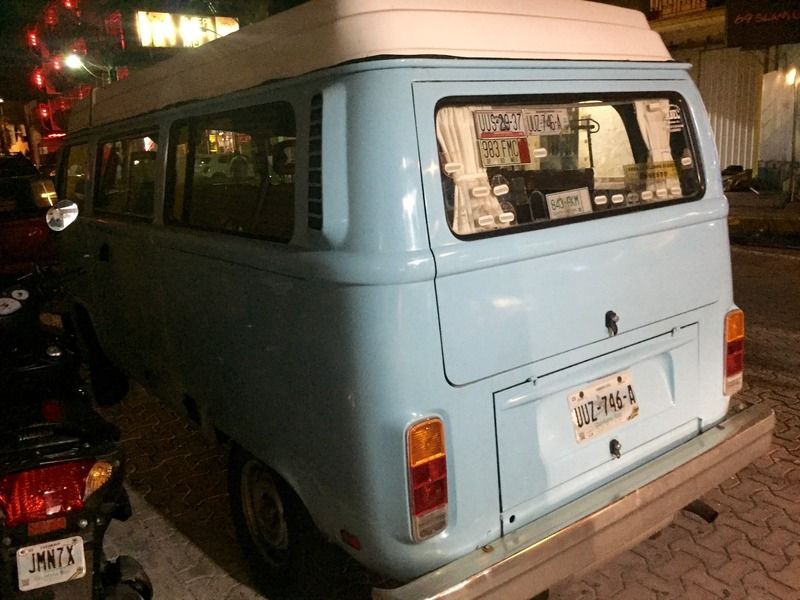

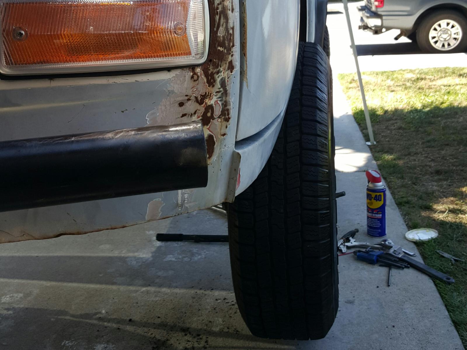

I was curious to see what a bay would look like with one of them bumpers. Thanks for sharing

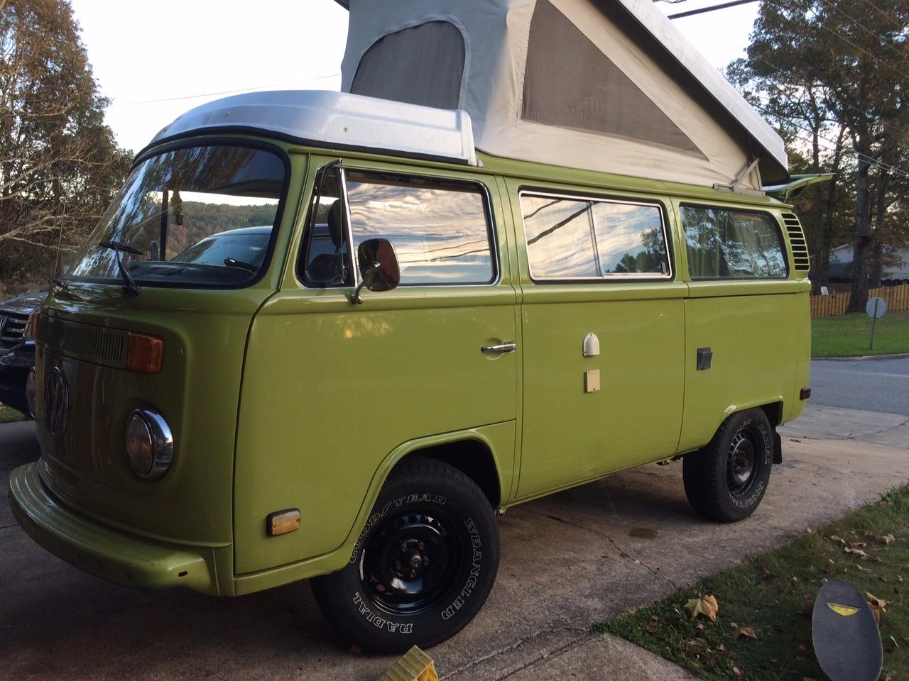

I think this is the biggest tire that will fit without a lift.
What size are they?

PostPosted: Wed Dec 16, 2015 2:28 pm    Post subject: Re: Off road modifications for your bus Reply with quote
OG Velvet wrote:
What size are they?
235/75/15 on some Passat steels.

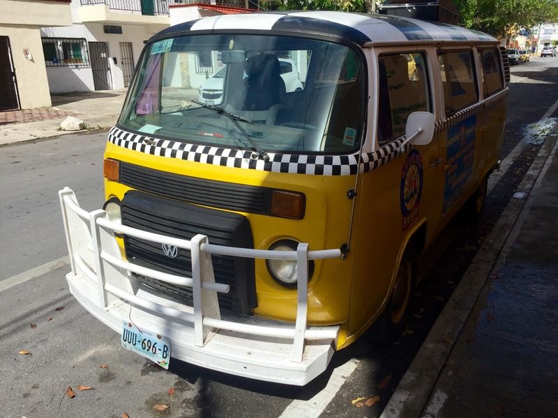

I have been down in Mexico for a few weeks now and nearly every bus i come across has had a modified rear bumper. Mostly they tend to use stronger bumpers from other vehicles to keep their busses safe. Each year the number of busses running around down here seems to thin out, it's crazy how fast the ocean most can eat even new cars.
This front bumper was a little over the top but pretty resourceful.
1973 Campmobile http://www.thesamba.com/vw/forum/viewtopic.php?t=524511&postdays=0&postorder=asc&start=0

forn wrote:
OG Velvet wrote:
What size are they?
Wow... them's some BIG tires!
I'm running 215/65/16's and I thought those were the biggest diameter / width set-up you could put on a non-lifted bus. The tire calculator site says your 235/75/15's are 1.88 inches taller and 3/4 of an inch wider than the geolanders I'm running. You must notice some rubbing at times, cause I rub just a wee little bit when I turn into or out of a steeply inclined driveway:

PostPosted: Mon Dec 21, 2015 6:08 pm    Post subject: Re: Off road modifications for your bus Reply with quote
Offset matters for fitting wheels/tires. Check this out, ET45 Passat steelies with 235/75R15 vs your "effectively" ET29 (wheel+spacer) BMW steelies with 215/65R16:
http://www.willtheyfit.com/index.php?width=235&...29#content
Aw come on, don't make me study Crying or Very sad What does it say?

tristessa
Joined: April 07, 2004
Posts: 3993
Location: Portland, OR
tristessa is offline
PostPosted: Mon Dec 21, 2015 8:38 pm    Post subject: Re: Off road modifications for your bus Reply with quote
Click on the lnk and look at the pretty pikshurz...

PostPosted: Mon Dec 21, 2015 8:41 pm    Post subject: Re: Off road modifications for your bus Reply with quote
So the 235/75/15's are pushing the tire more out? Or I should say the Passat rim.

PostPosted: Mon Dec 21, 2015 10:05 pm    Post subject: Re: Off road modifications for your bus Reply with quote
The rim pushes the tire to the outside of the car allowing a wider tire which won't rub as much

tristessa
Posts: 3993
PostPosted: Tue Dec 22, 2015 12:21 pm    Post subject: Re: Off road modifications for your bus Reply with quote
That visualization is for 235/75R15 on ET45 Passat vs. Nepenthe's 215/65R16 on ET47 BMW with 18MM adapters (effective ET29). If he had better offset he might be able to go bigger on his 16's without rubbing. If you look at 215/75R15 on the 15x6 ET45 Passat wheels vs. 185R14 on 14x5.5 ET39 Bus wheels, the extra width on the 15x6 is almost totally tucked inward (0.3MM more poke, pfft) because of the offset difference.
http://www.willtheyfit.com/index.php?width=215&...39#content
I'm gonna pick up a 235/75R15 at Pick & Pull to play with next weekend...

PostPosted: Tue Dec 22, 2015 11:13 pm    Post subject: Re: Off road modifications for your bus Reply with quote
Some wheel spacers might get you where you need to be. Not sure how thick you can go without needing longer wheel studs, maybe 10mm. Studs need at least 6 revolutions to tighten securely.
How's your Bus performance all around with that setup? Do you have any rubbing anywhere?
I like that setup, those tires look burly on a Bus...I think I'm getting past the idea of needing hubcaps in favor of that stout look...I'd really like to know more about real world performance and drawbacks. And I presume that setup resolves the concern over adequate load rating for a loaded Westy.
