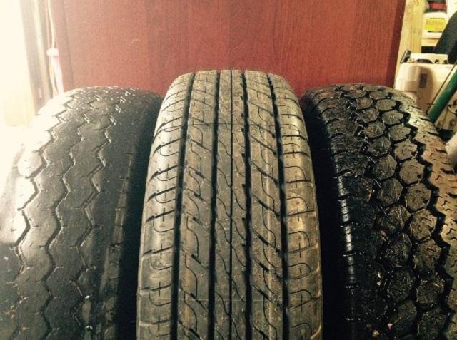

UNTIL! I went in search of load rated tires in the size I was wanting, 205/65-16.
This was during the pandemic, so, things MIGHT be different now, but I had VERY few choices I was willing to entertain.
I've posted about these before but it's worth repeating in this quote. Great load rating, very reasonably priced.
That tire between two in the stock 14" size, a worn Wynstar on the left and a replacement spare Nexen.
Here mounted to a 16" Mercedes CLK alloy that needed only to have the lug holes drilled out.
No Wildpeak inifo for you, but I was considering them for my big van project that I sold before it reached the new tire stage.

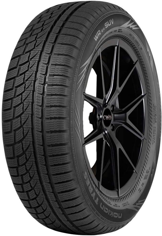

PostPosted: Thu Jun 06, 2024 8:04 am    Post subject: Re: What TIRES fit? The ultimate tire thread! Reply with quote
Any feedback on these Nokian? https://www.amazon.com/NOKIAN-100H-All-Season-Radial-Tire-215/dp/B07ND44TVX
There's a set of these new near me for a great price. Thinking they might be good for a cross country trip where 99% of travel is on pavement. Load rating seems adequate at 1764lbs.
