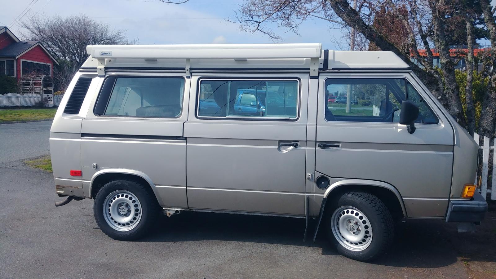

Crooked Designer wrote:
Dono Be wrote:
Here is a before and after pic... side by side of my new 215/65/16 on the 16"x7.5" Mercedes rims
Thanks for all the info on here.
Dono
2 questions.. 1. Stock height / full westy? 2. Any rubbing on front wheel at full turn? I'm looking to go from 15's to 16's and am trying to figure out tire size and this is my lead option, so would be very helpful to hear your experience so far.
Thanks!
Hey...yes just a bit of a rib when the van has a passenger up front and braking and approaching a driveway during the turn. No other problems but I have the spacers for this spring revamp.
Old Stock springs and sits at 27" (was 25" with 195/70/14)
Working on a 1988 T25 Vanagon Westfalia...Loved and lost A 1966 VW Sundial Camper, A 1966 Transporter, and Three 1967 VW Beetles.
