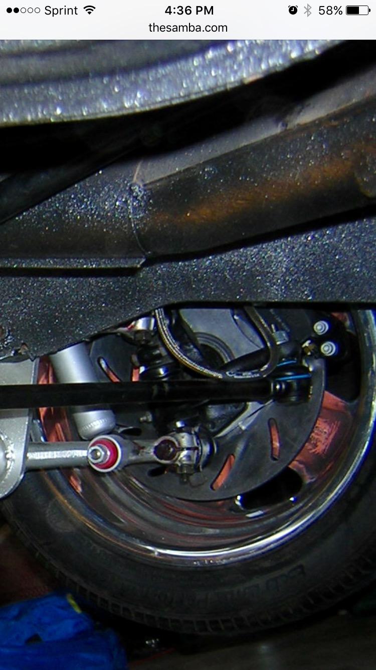

Hello fellers,
It’s been a while since I last posted something on The Samba. I have a 59 mango bus with Wolfgang IRS in the rear. The front has a Wagenswest 4in narrow.
My question is why is it such a hassle to get it probably aligned??? Took it to a local shop and they just made it worse. Went to another shop and they didn’t even want to take a stab at it.

You know what they say, if you want something done right, do it yourself.
Alignment is not a mysterious process, just takes time and concentration. The bently manual has all the info, and it should still apply even with a lowered beam.

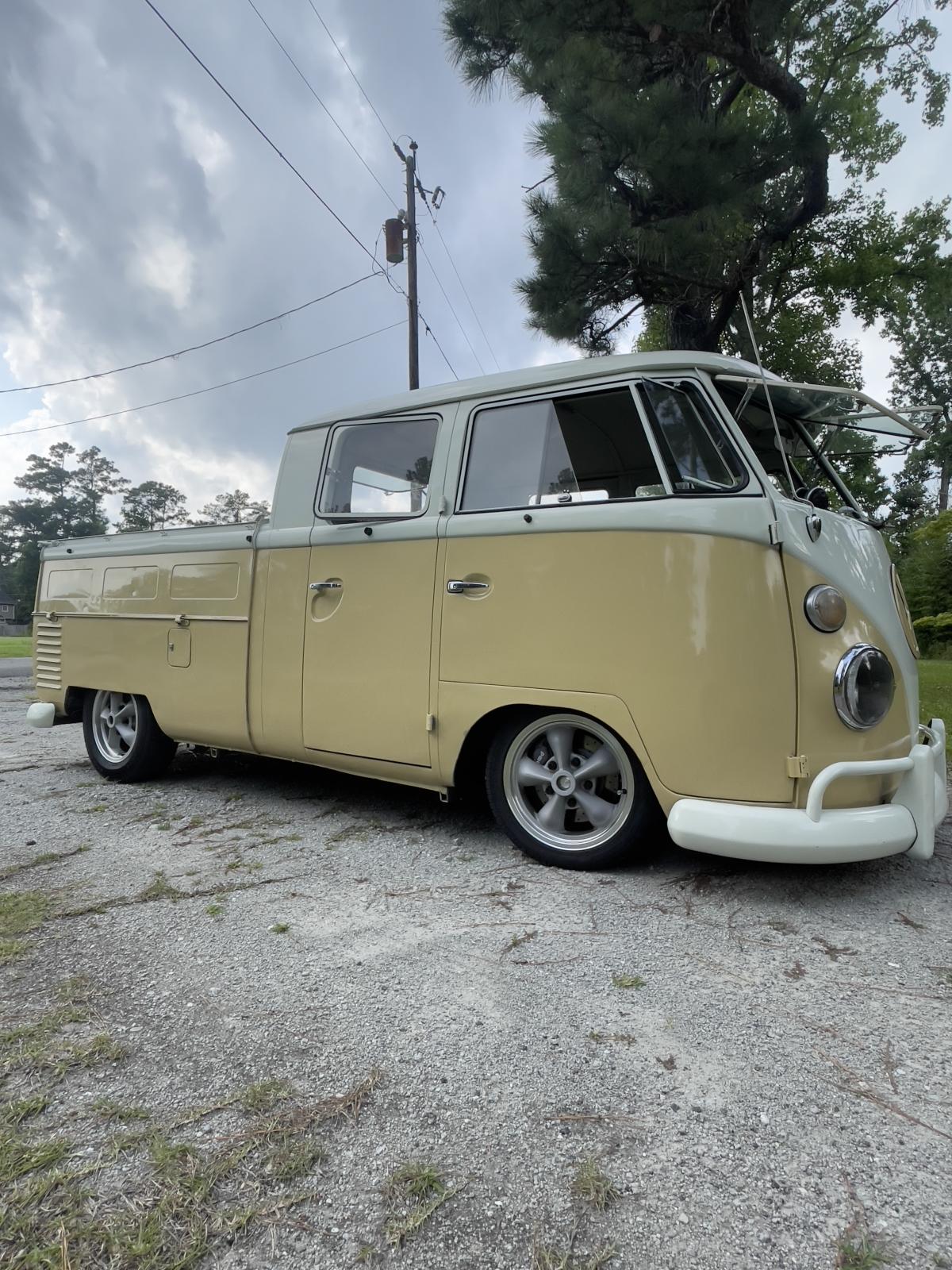

62 Double Cab. I drive it 300-500 miles per week
CB beam narrowed to 4”
64-67 arms and spindles
Dubfab 4” welded spindles
Wagens West 944 vented / Wilwood 4 piston front discs
15x5’a 175/50R15
68 long axle/long spline trans
Vintage Vdubs adjustable offset spring plates
Wagens West 944 vented / Wilwood 4 piston rear discs
15x6’s 205/60R15
-Shaggy
56 Oval Window 2175 turbo

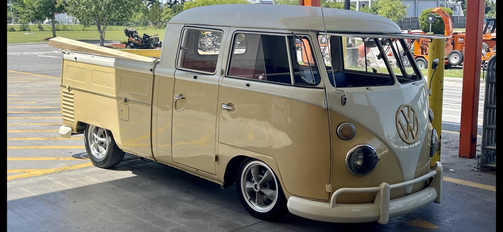

Gorgeous Doka! Mine will look very similar when it gets done in 20 years. Nate is working on my suspension kit as I type this. I can't wait until it's delivered! I built a 2017 CB Performance engine to go in it, too. My goal is to daily it.
Anyway, nice build!

I switched to a 205/50R15 and bumped the front up about 3/4”. Rear wheels are at -1* camber. Fewer steering box scrapes for my daily driver.

Which tire size feels better with the gearing?

I liked the 205/60 better. It felt like it pulled harder through the gears and would run 75 Mph, comfortably cruising at a little over 60. Now 55 Mph is about 3300 RPM and 65 is the top end. I have a 4.37 trans with a stock 1600 that has Kadrons and a header.

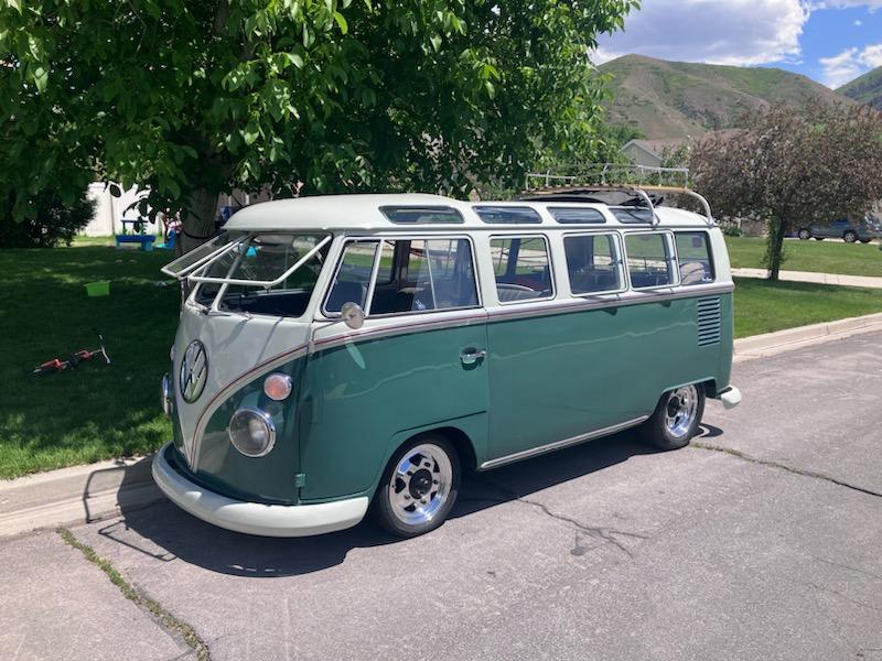

Had to try out something a little different for a minute on my dad's bus. Street weight ERCO Star Cutouts.
The front tires are tiny, but the front wheels are only a 3.5". 145/65 15s and 215/65 15s in the rear.
