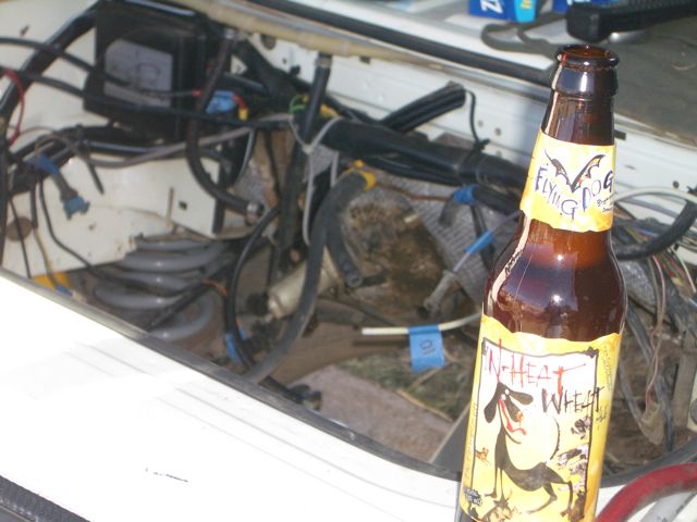

ranchero wrote:
Day 2 progress report...
Started working on the van about 12:30pm.
Finished about 6.
Step 1: Coffee
Step 2: Success!
Step 3: Beer.
I have been following this thread and would like to say congratulations and thanks for all the photo's. However I would like to point out that this is the best three step program for anyone doing anything. The results are always positive and it always seems to work. Just imagine if the rest of the world could follow this three step program most of our problems would have already been solved. THANKS!
I guess that makes me a Swissicain

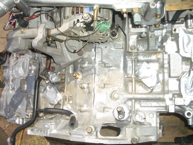

ranchero wrote:
OK, I can't tell from the Subie manual for the SOHC EJ25. On my 98 DOHC outback, the sensor is just behind and under the #4 intake runner on the block.
This is a 2001 (SOHC) EJ25. In the photo below Is the knock sensor location in the block at the lower left of the photo at the bend in the rubber coolant line? The hole is threaded. I had wondered before about what that hole was for, but assumed it was related to mounting of some bracket.
not that it matters much now but...
isnt duct tape a bad idea for that? as it leaves a gooey residue? wouldnt a painters tape or gaffers tape have been better>

PostPosted: Wed Jun 11, 2008 11:17 am    Post subject: Reply with quote
possibly, a quick wipe with a rag and acetone/thinner will remove it.

Yank the loose part out. Bend it, cut it or do whatever to get it out. Seal up with some kind of seal from the car parts store or gas station. Done, I would hope.

Sorry to hear of your troubles but I'm glad you were able to put your finger on it so quickly. You're pretty close to Small Car... could you get stateside without the muffler and have them meet you to put it on? Or if you can get to Tacoma they could install it in their shop. I bought their muffler too... I hope this isn't typical.
