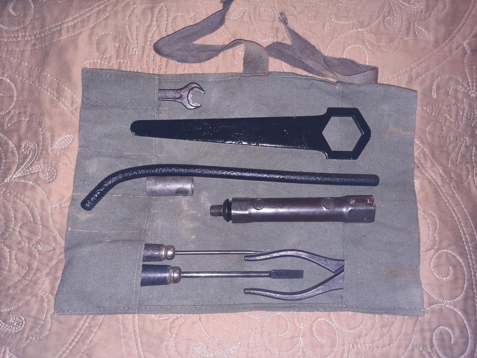

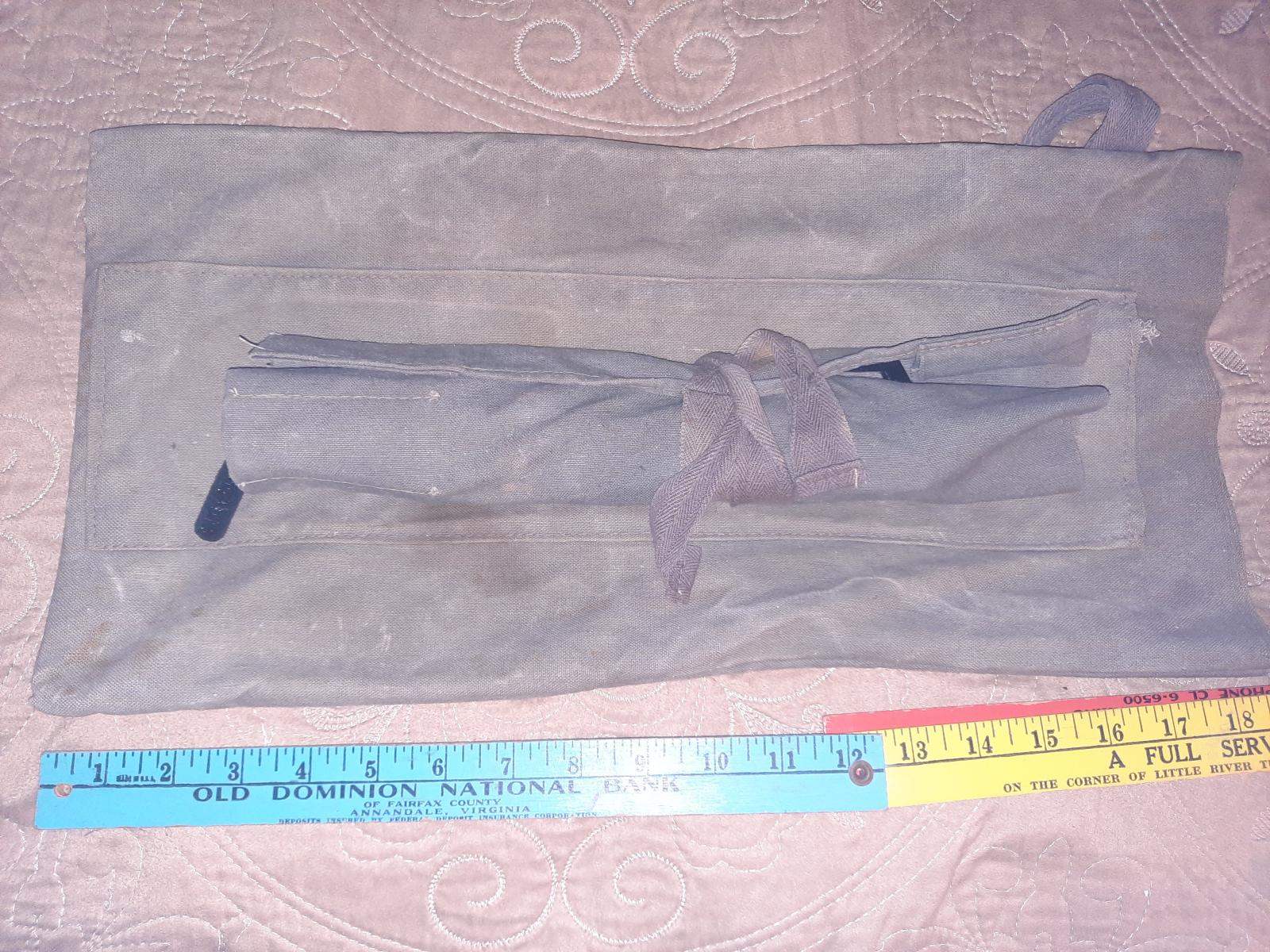

here is my most recent kit . a 5 and 1 pocket green canvas . i was hoping it would go nicely with a green canvas jack bag i have . i de rusted and cleaned this fabric all up ....... bet here is more of what im showing , someone here said to keep fan belt in the pocket , i put one in and it fits .........then some one said they thought the jack bag pocket was to keep the took kit in ???
Hmmmm oh it wont fit in that pocket i thought , but it does , it fits pretty nicely in n out ......... the complete tool kit fits in that pocket ...i can thro the fan belt in the big pocket .........i has hoping these two pieces would go well together ..
sorry the one pic is so washed out but it shows the took kit over the pocket to see size ....

PostPosted: Wed Mar 13, 2024 3:22 pm    Post subject: Re: Volkswagen factory supplied tool kits Reply with quote
i have had my eye on this canvas here in thesamba classifieds at least a few years . i talked to Corey the seller about it and he cleaned it up some but it still sat in the classifieds .... well i broke down and bought it .........it was UGLY !!! so i gave it my best de rust n detergent hand wash i could TWICE !!! you can actually see some blue n green in it now Smile
its a 4 and 2 pocket so oval time period . the tool rod is repo for the time being . hub cap puller is new but the rest are all period original tools ....
here is how i got it
and after my de rust treatment , its quite a vw treasure in my eyes now .

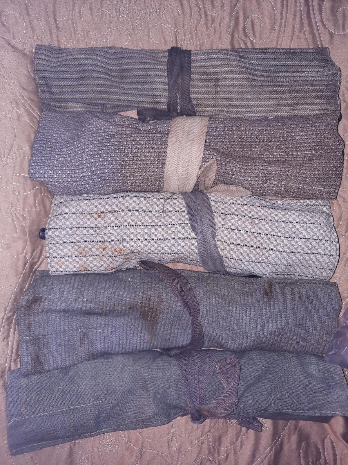

nothing too special . i used this same rust stain remover on the green canvas cover i did a week or two back . i used the whole bottle on it , when done soaking after about 1/2 hour i poured it back in the bottle . then i just use DAWN LIQUID dish soap for the final wash in a tub with warm soapy water ......on this most recent one , i did the same treatment TWICE and i used a small nylon brush rubbing on the stains ......the used soapy water was like MUD afterwards .....it could prolly use a 3rd cleaning but i didnt want to harm the fabric and called it good enough ......... i have done something similar to all my fabric tool kit rolls .......
here is the green one before i got started on it .

PostPosted: Thu Mar 14, 2024 10:18 am    Post subject: Re: Volkswagen factory supplied tool kits Reply with quote
i have sold a few over the years , here are my fabric tool kits today ......

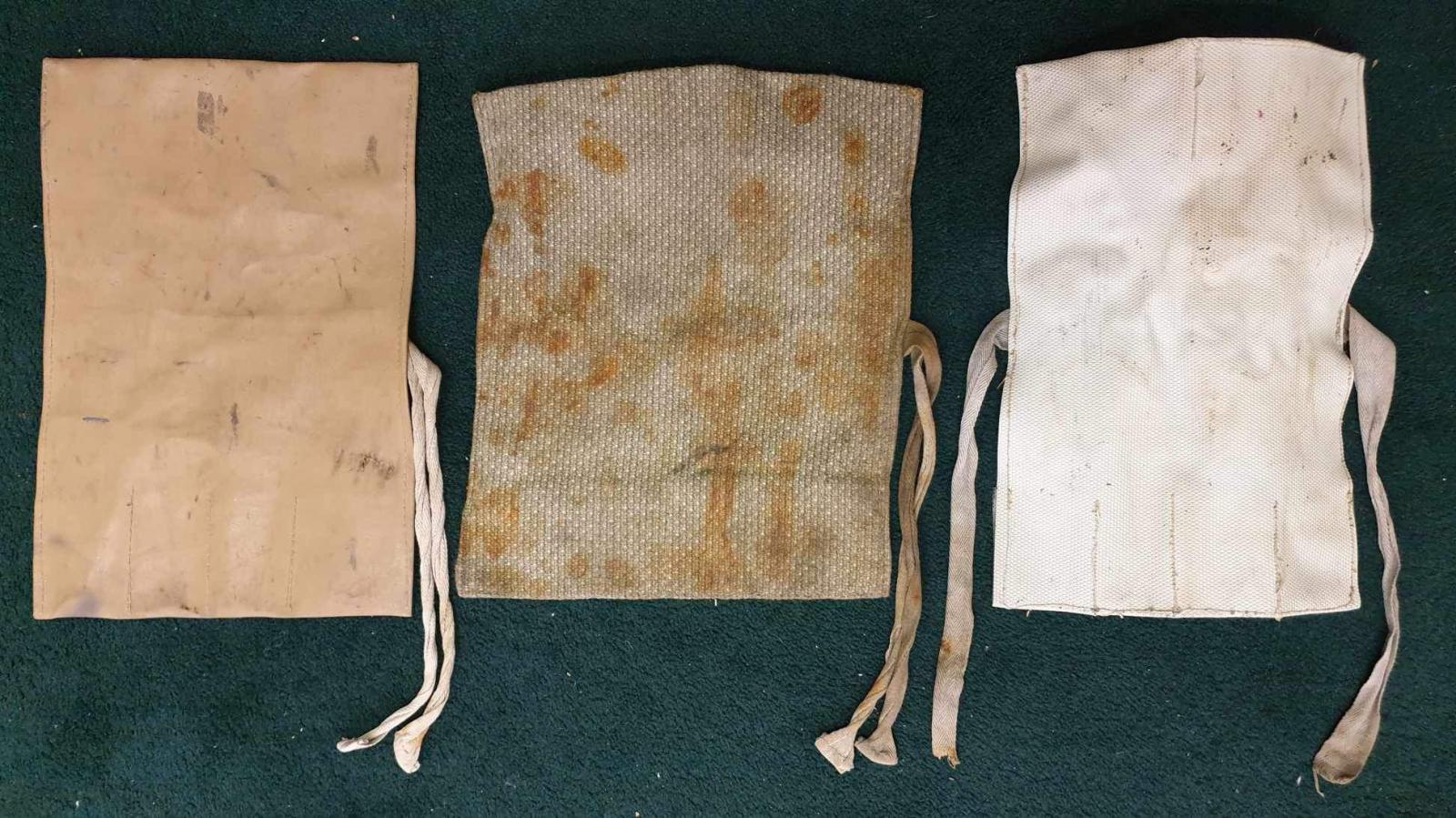

PostPosted: Sat Mar 16, 2024 4:42 pm    Post subject: Re: Volkswagen factory supplied tool kits Reply with quote
Here are 3 of my original tool rolls
I’m thinking they are:
L>R
59> 4/1 pocket tool roll, Mango bus seat vinyl
56/7 5/1 pocket tool roll, Oval green dotted cloth (Polar Silver)
58/9 4/2 pocket tool roll, Beetle/Ghia green waffle vinyl
The waffle roll has a tie L&R…not both on the left
-StockRocks-
