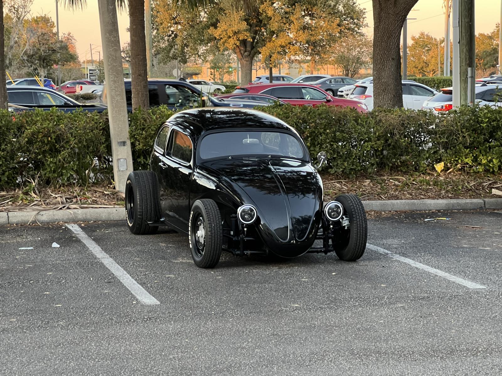

Goose65
Joined: May 16, 2010
Posts: 100
Location: Central FL.
Goose65 is offline
PostPosted: Mon Jan 20, 2025 12:42 pm    Post subject: Re: Goose's 65' Oval VOLKSROD (Haters KEEP OUT!) Reply with quote
1965 Volksrod "Venom"
1915cc
4" Chop
8" Extension
Digital Gauges
Vintage Speed Black Mamba Shifter
Side Exit Exhaust
55' Oval Graft
