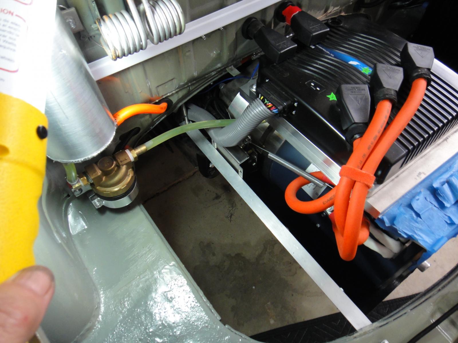

Worked on the intake vents. Removed the grill and POR15 the inside area. Made some block off's to keep the air and moisture out of my vent tubes. Cleaned up the grill and it looks like crap. I may paint it black.
Fab'ed up my motor splash guard and set it in place. Waiting on ABS panels to finish the boot area and put the deck lid on.
Added some more stuff to the back, side panels, more floor cover

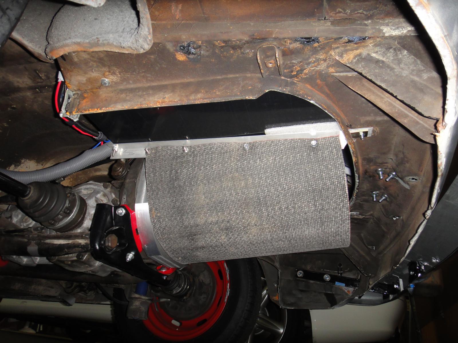

It hangs below the motor and protects it from road grime. It also helps keep the boot area clean. Here's a few shots from below.
and the same area above.

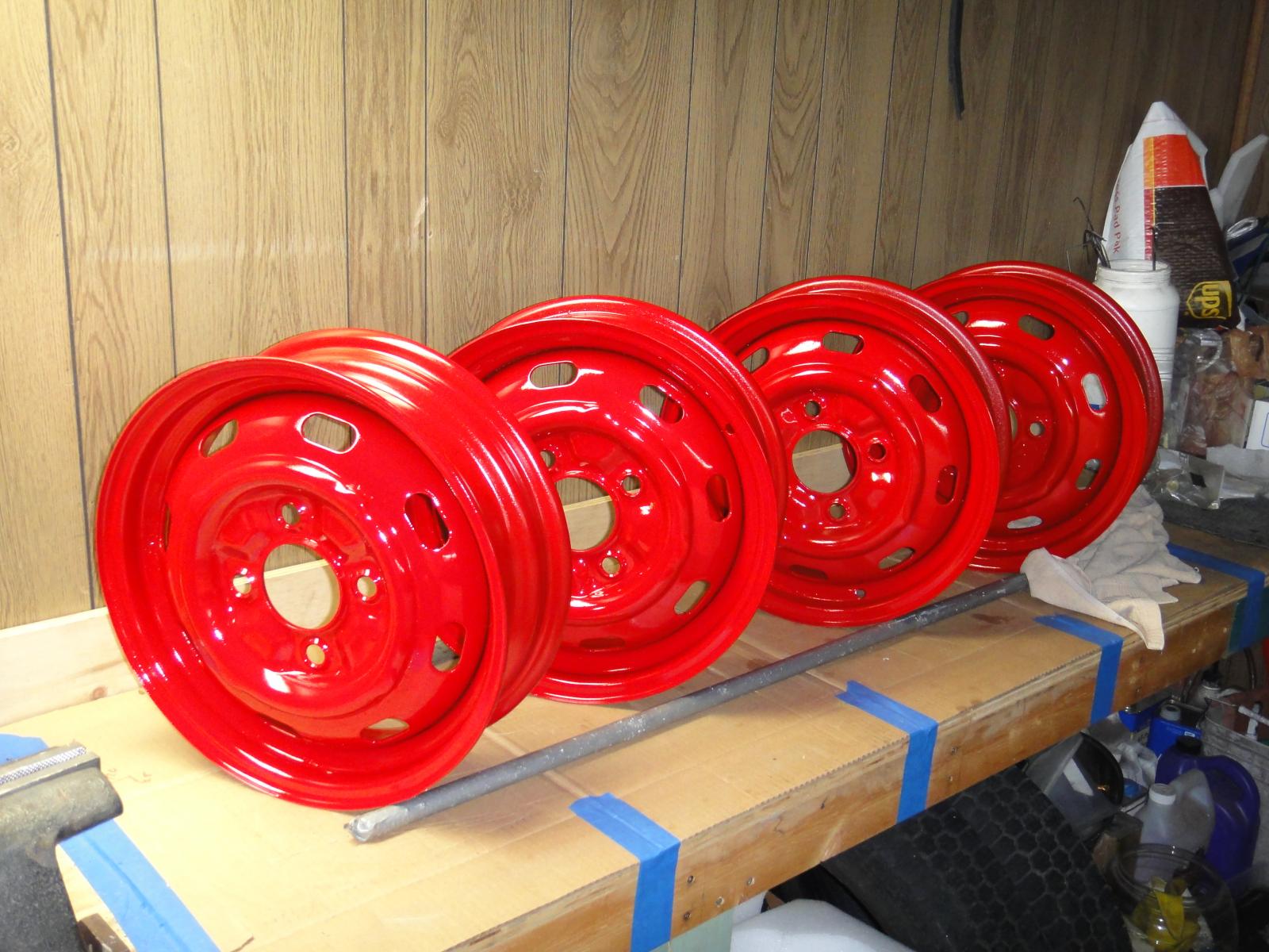

Finally...the wheels are in Very Happy Laughing . They were sandblasted and painted Cocoa Cola Red today. I'll let them set a day and get the tires mounted Thursday.
I'm going to paint the top to match in a few weeks. Still waiting on the rear sway bar and a few bumper parts to get the project on the road. Looks like I have a shot a driving it this week.

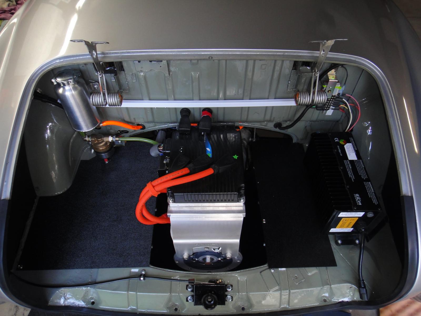

Doing finishing work and have the boot engine compartment all complete. Got the boot lid back on as well.

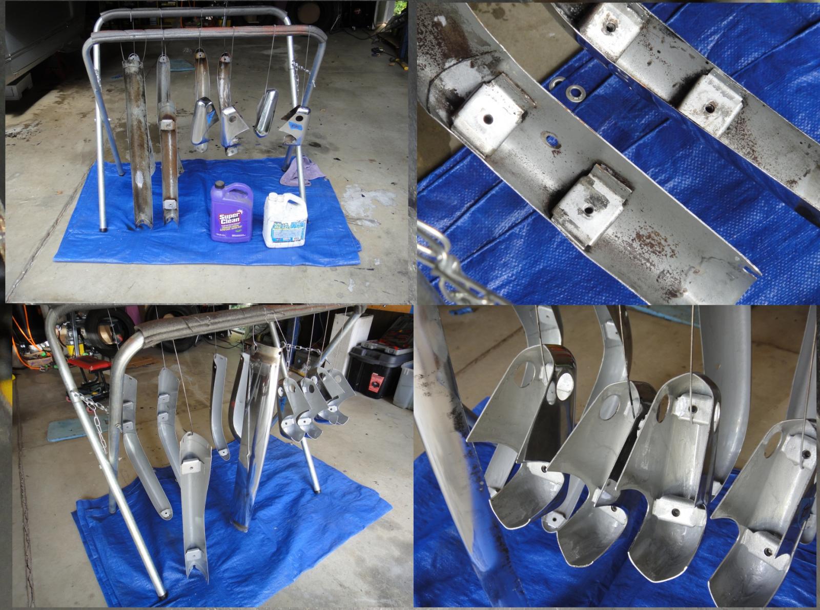

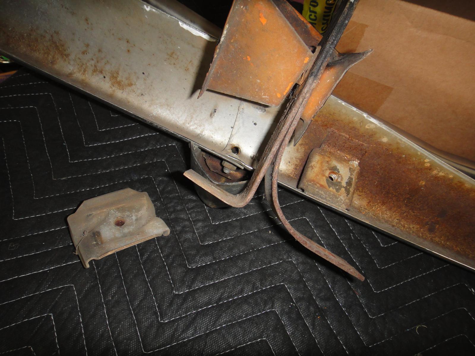

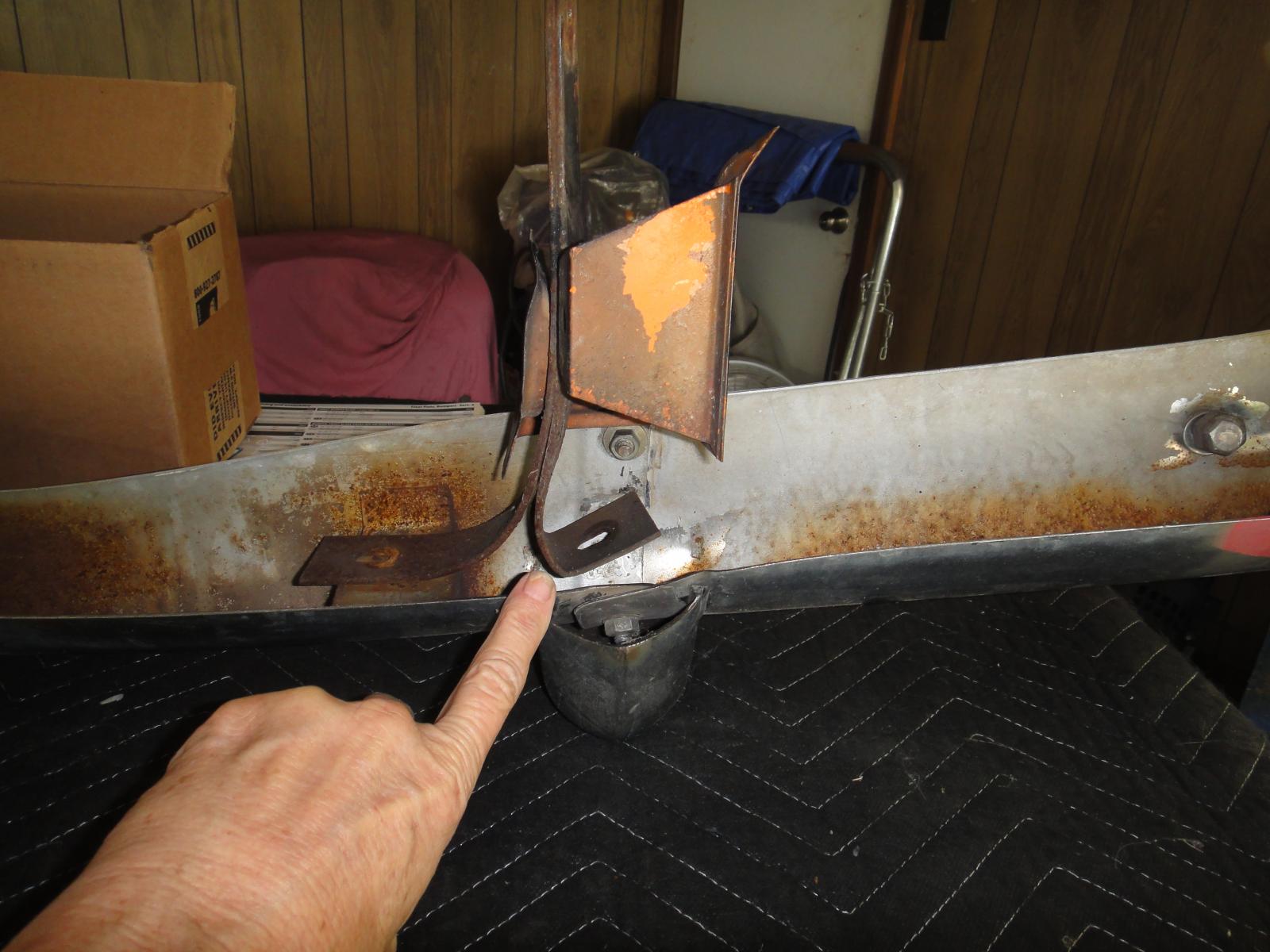

This week I have been working on the bumpers. Here are some shots of the before:
To restore the inside of the bumpers,I wire brushed all the surfaces and sprayed with MetalReady. I then hit the surface with a green scuff pad and blew off the residue. I then covered it in silver POR15. For the chrome restoration, I used crumpled aluminum foil and water with a little dish washing soap. It cleaned them up beautifully. I don't know how it works but it does.
I had to do a lot of anvil and hammer work on the brackets to get them back and I pounded out as many bumps in the blades as I could. They look fine for a daily driver

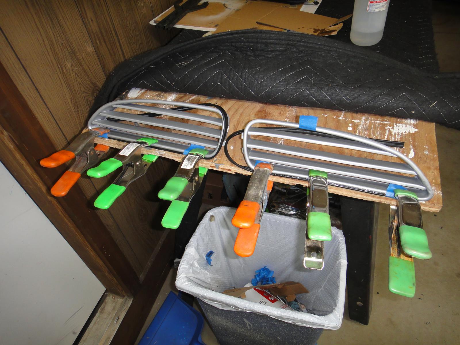

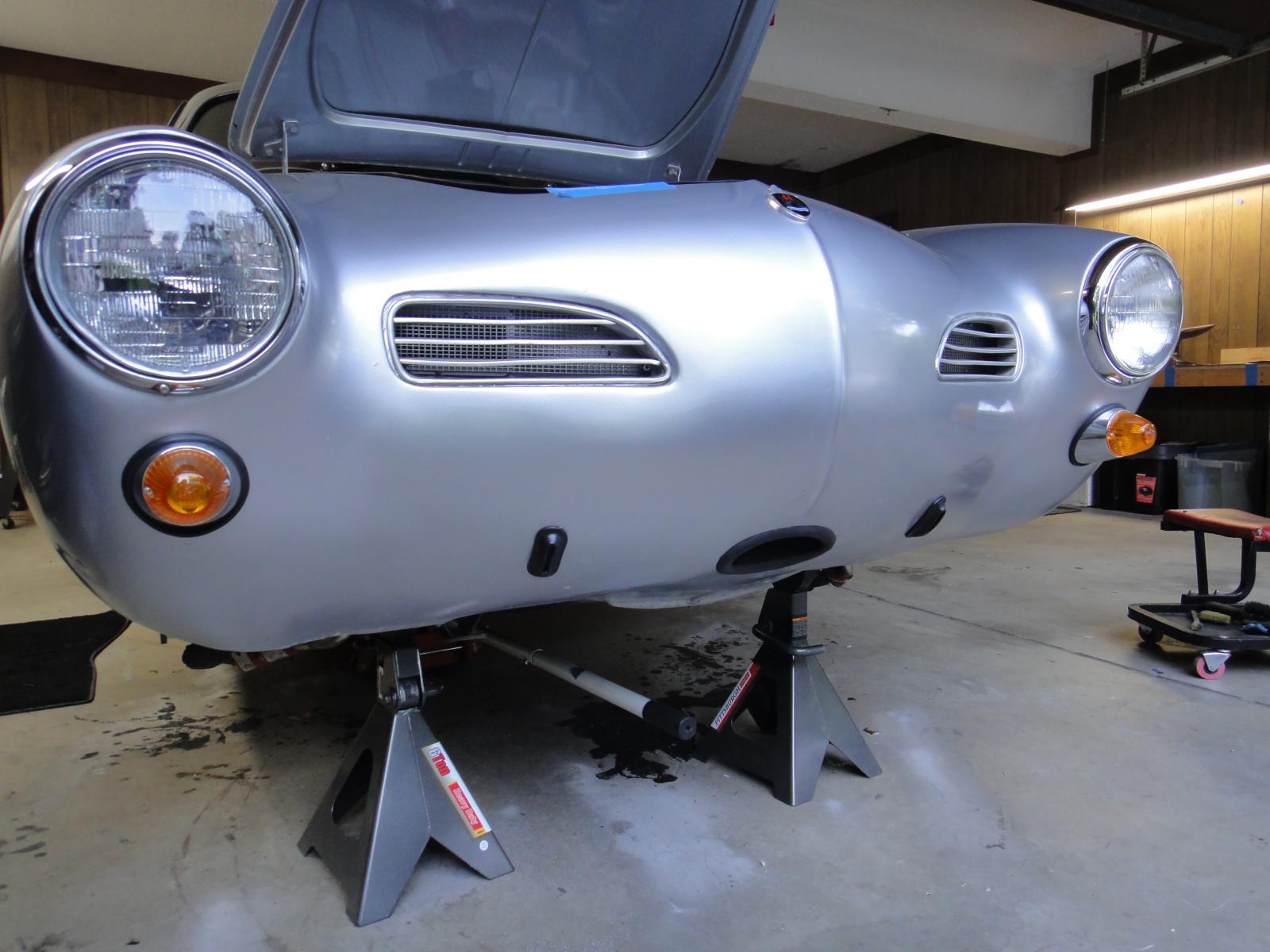

Need some help please. Below is a photo of the 71 Ghia Fresh Air Inlet and weather strip. The cross section of the strip has a flat side and a groved side. The grove is off center, with a 70/30 ratio split, a long and short thing.
I assume the flat side goes against the body a the grove side takes the grills front edge. Is that correct?
Does the long portion of the grooved side face inwards our outwards from the body.
Any help or photos would be greatly appreciated.

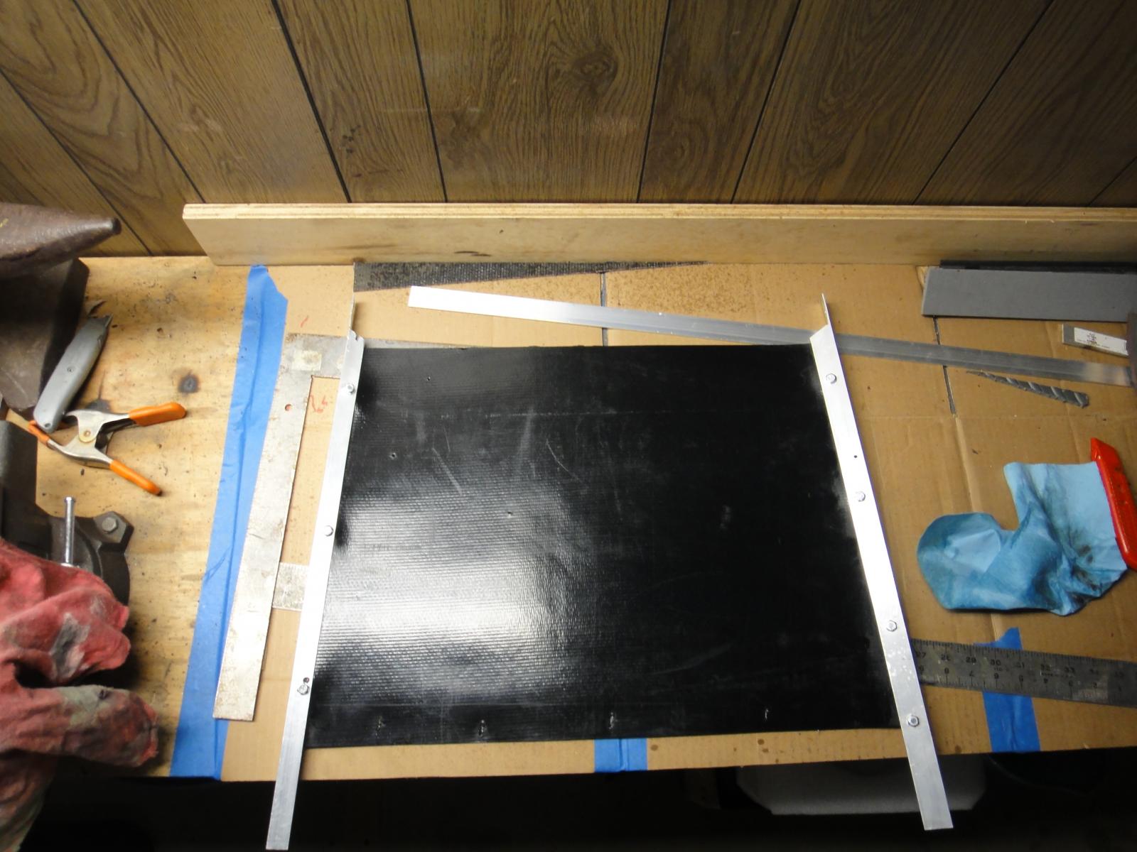

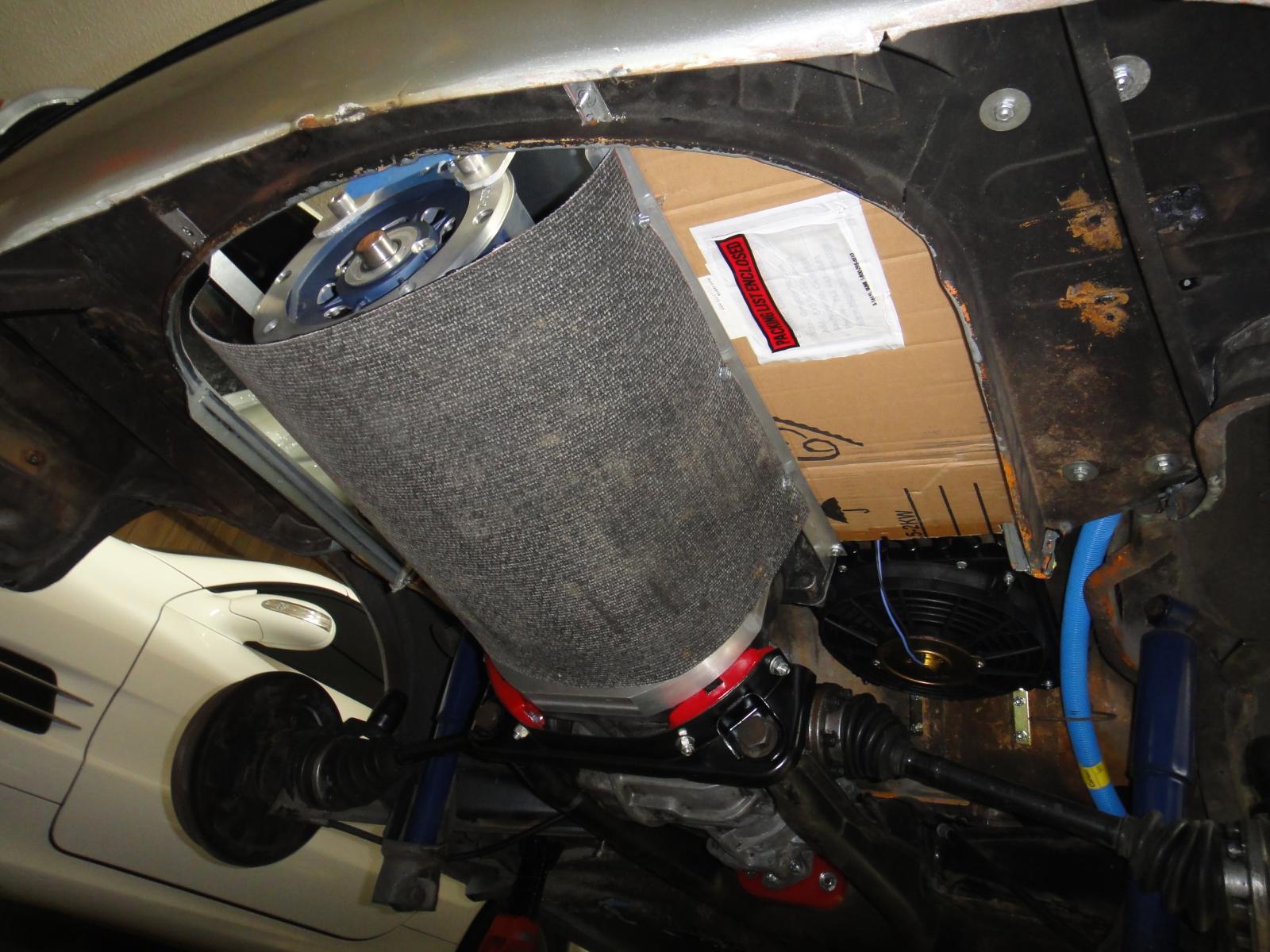

Here is how I did it.
These are shots of the completed splash guard. Now I need a rain tray to protect the top side.

Awesome build thread...and then tested my individual cells to find one cell was at basically 0 volts which is big trouble for the Lithium batteries.
Thank you Mark for your input. I have cooked my first cell. It was showing zero volts. I removed it last night and it is bloated Very Happy ... TOAST. I am not using a battery management system in my build. I have about 40 miles on it now and I have not bottom balanced it yet. I keep it charged up to 3.34v per cell and never let the voltage get below 2.9v per cell.
I'm taking a chance doing this but I just hate the idea of bottom balancing the cells, it will take 7-10 days at least and I don't want to do it until fall.
I took it out on the interstate last night and top speed is 79mph on the flats. Running at 5000 rpm it is solid. Very pleased with the ride, tracks like its on rails.

How loud is that cooling fan at highway speeds ?
Cars Currently Owned:
1970 Karmann Ghia Coupe
1973 Karmann Ghia Coupe - Project car for sale
1970 Karmann Ghia Convertible (Body off restoration)
Timing is everything
KGCoupe
Joined: July 01, 2005
Posts: 3580
Location: Putting the "ill" and "annoy" in Illinois
KGCoupe is offline
PostPosted: Wed Aug 05, 2015 8:00 am    Post subject: Reply with quote
Who have expected an electric car to be fitted with a blower? Shocked
... granted, judging by the sound of it, it does appear to be a leaf blower.
Wink
I will admit that when you first started this thread, I never expected that I would like a Karmann Ghia converted to elctric power.
However, having now seen the completed project in action I will readily admit that I think it is very cool indeed!
I particularly like the way that you chose to go with a bare, minimalistic and utilitarian approach to the interior styling.
Most impressive of all is your attention to detail and the overall neatness of the conversion.
Congratulations on a job very well done!
... now, can anything be done to either quiet down that blower fan or perhaps have it make that "fweem" sound that is so characteristic to old VWs? Smile
