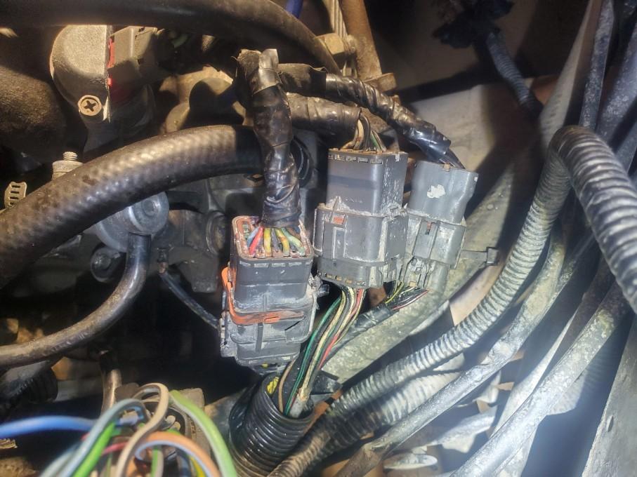

Finished changing my engine connectors out for Deutsch style ones.
One of the old ones had broken and PO had ziptied it together, but moisture still made it inside and light oxidation was setting in. Figured that as long as I was changing one, I'd update all three to a more serviceable connector -at least for me. Also packed the connectors with anti-oxodizing zinc paste from OxGard.
Before
After
1986 VW 3-knob Syncro Tintop w/ 1992? Suby Legacy 2.2L (KEP install)

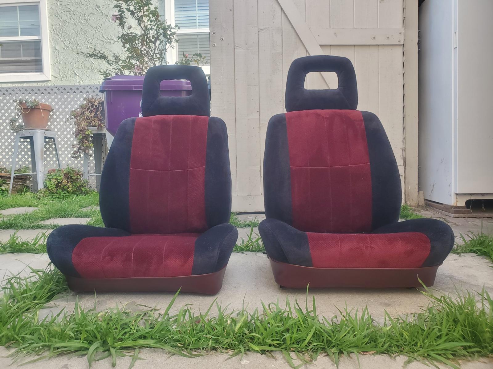

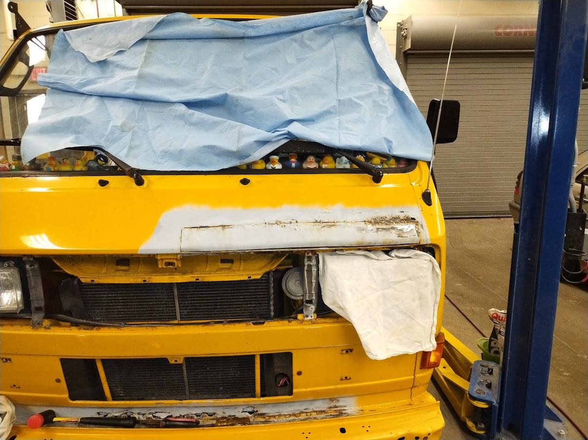

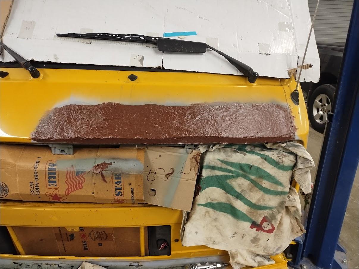

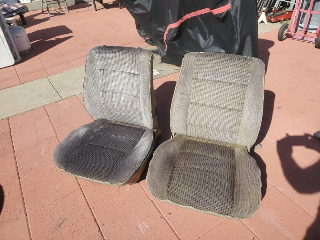

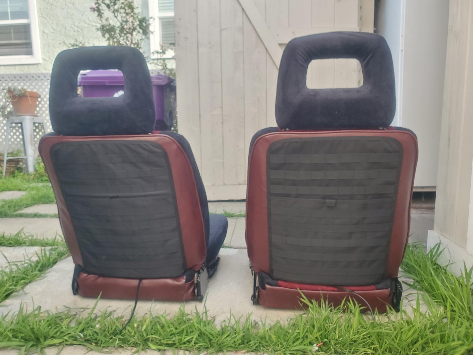

PostPosted: Mon May 12, 2025 7:40 am    Post subject: Re: What did YOU do to your van today? Reply with quote
Over the last few months, took an auto body & paint adult continuing education night class at the local HS. Worked on Ducky's nose rust - definitely learned a lot! Now to put the front end back together. School is out for summer!
1988 DOKA Transporter
1989 Twin Slider Syncro
1984 Green Machine 4x4
alohah3
Joined: July 31, 2012
Posts: 24
Location: Alexandria, VA
alohah3 is offline
PostPosted: Mon May 12, 2025 7:41 am    Post subject: Re: What did YOU do to your van today? Reply with quote
Before
After
Hi,
sounds as would it make to my TODO-List. Could you link your Tools/The Connectors -- but just if you have this info at hand. Would make my life a little easier, so i do not want to bother you to much with that (IMHO) worthwile Upgrade-desire ....
Thanks
peb
T3svx Dehler 2+2 Whitestar ....
T3svx ... sonst nix!
BigPapaV
Joined: February 05, 2023
Posts: 73
Location: Long Beach, CA
BigPapaV is offline
PostPosted: Mon May 12, 2025 10:55 pm    Post subject: Re: What did YOU do to your van today? Reply with quote
DehlerPEB wrote:
Hi,
Thanks
peb
Hi peb, no problem. Here's the links for the tools / connectors:
Diagonal cutters - any work, I got mine from Ace, local hardware shop
Strippers - KNIPEX Tools 13 72 8 Forged Wire... https://www.amazon.com/dp/B08L8D54FB?ref=ppx_pop_mob_ap_share
DT connectors (standard, 20 to 12 awg) - used one piece 8 pin and one piece 12 pin for the EJ22 harness
338 pcs DT Deustch Connector... https://www.amazon.com/dp/B09S3N51GM?ref=ppx_pop_mob_ap_share
DTM connector (mini, 22 to 20 awg) - used one piece 12 pin
JRready ST6360 Deutsch DTM... https://www.amazon.com/dp/B0C7JYKKZ7?ref=ppx_pop_mob_ap_share
OxGard paste
Gardner Bender OX-800 8OZ...
https://www.amazon.com/dp/B000BOCBCA?ref=ppx_pop_mob_ap_share

Got my seats and rear pad back from upholstery shop, super happy with how they turned out.
I had them add seat heaters and change the sewing pattern to mimic my Volvo 240 seats, that's also why the vinyl doesn't come all the way up to seat edge. Haven't installed yet to check foam stiffness, but it's a "40 grade" whatever that means. They put the same in my recently redone Volvo seats and it's great.
Also had them sew a molle panel straight to the seat back for added utility. I don't have jump seats nor mid-row seats installed.
Not sure if I like how the fuzzy head rests came out but at least the vinyl tears are covered up.
Rear seats would've been done, but I asked them to add seat heaters to them after they were closed up. d'oh!
Before
