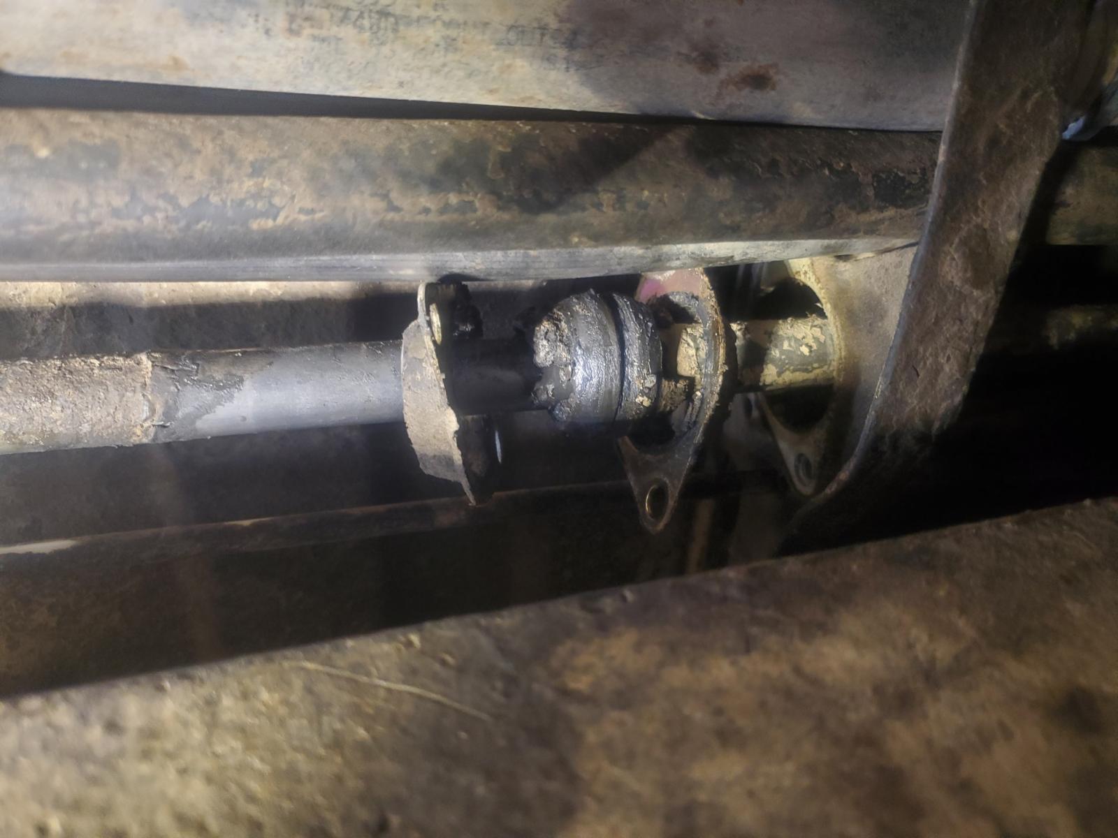

Pulled off the whole shifting linkage.
Bushings are worn, but looks like some work was done on the ends at one point since the plastic ears are in good shape and there's a GoWesty 90 degree elbow. Maybe the u-joint was also replaced? Will see after cleaning tomorrow.

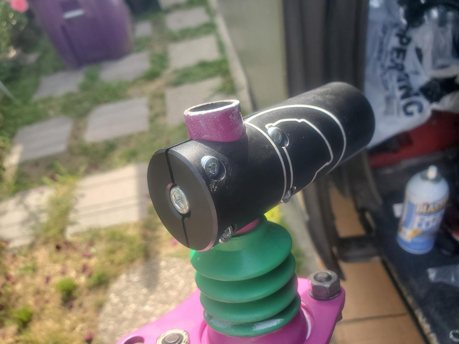

Started reinstalling my now safety purple shift linkage. Was hot out, so going was slow and steady.
Got the front half in, and then realized I'd forgotten the little tube clamp somewhere at my work. d'oh! Hopefully I find it Monday. By then I wasn't feeling it anymore, so started washing the area under the rear seats with soapy water, slow and steady.
GoWesty's new elbow lever seems pretty solid. Installed with blue Loctite.
