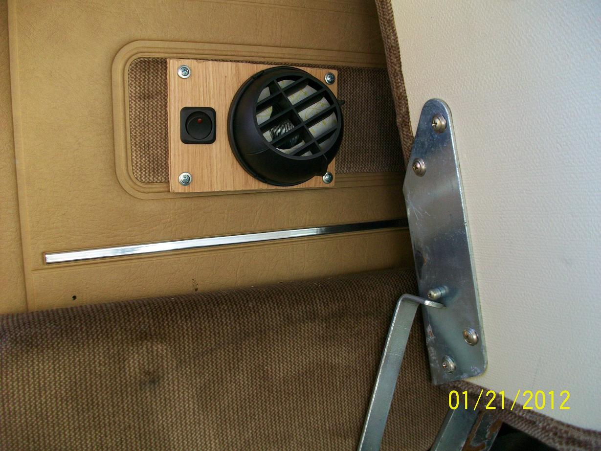

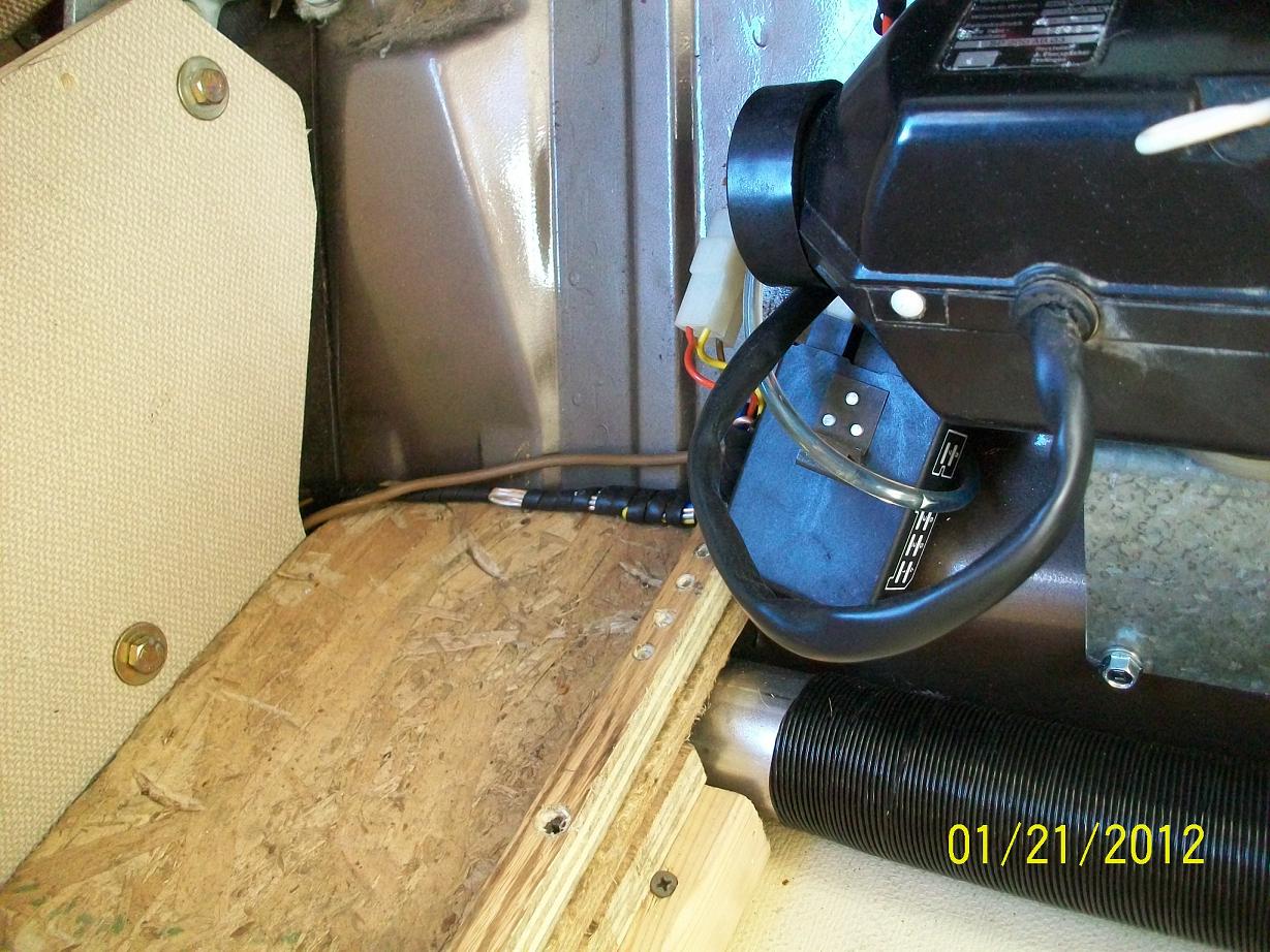

and here's our Diesel heater install from a previous post
https://www.thesamba.com/vw/forum/viewtopic.php?p=5815543#5815543
we've now switched the Espar D1 over to a CDH as the Espar wasn't operating reliably for mom's use and the CDH has a key fob remote so I can preheat her camper while she's @ the campfire..
so in the images below just swap out the D1 for a CDH and everything else is the same.. we also fit the AUX batter on the board that covers the T-junction.
*and to note I have (2) NOS Espar D1s on the shelf in the shop new in the 1984 shrinkwrap. that are now obsoleted by the CDHs that have flooded the economy heater market.
danfromsyr wrote:
OK so here's finally our install images.
there were a few things we were after on this install.
#1 minimize lost space
#2 minimize extra holes in the body metal
#3 keep ALL of the ESPAR unit & pump INSIDE the vehicle, it's too valuable to lose to corrosion.
#4 while these are very nice they are still only ~6k BTUs so keep the heat output where it can be most enjoyed. direct access for cold hands, bodies and feet.
the T-fitting and ventout the face of the seat was a afterthought but I'm very pleased with it's help in minimizing concerns of mom blocking the heater with bedding. though in the images you can see a cardboard insert where I'm trying to get a 60/40 balance to the heat.. the upper one was initially intended to be the primary outlet.. if I had access to a heat vent that was able to close I'd be more happy but it's easy to block the upper duct if the feet need more heat.
it was a little BFH & cutting to get the paper duct past the lower corner of the seat base & hinges, but not too much to feel destructive. just regular "installer" adjustments were needed.
I had to raise the AUX battery on the wood platform anyways, so then I figured to add the T-fitting under it.
in my images we do take care to not allow the seat belt to drape on th hot exhaust. the hot exhaust makes another 90* turn with some galvanized EMT to exit by the DS rear wheel well. Diesel fumes are stinky & mom's nose is sensitive.
I'd like to make a nicer panel to mount the vent in the sidepanel but I had that laminate flooring scrap readily available.
the plan is to completely box in the heater & Aux battery with a Pegboard panel to keep gear out of both of them.
while it is a noisy sucker, it does provide very frugal heat. and mom's not keen on running any heater all night, no where anyways..
we chose the Diesel heater for mom's for a few reasons
#1 we already had it.
#2 we can know exactly how much fuel is in the tank with a quick look w/o opening anything
#3 we can refill it at any hour of the night with Diesel or Kero even from Walmart @ 3am if needed. we carry a 1L MSR bottle with Kero in it which is good for 8~10hrs of operation anyways as a backup.

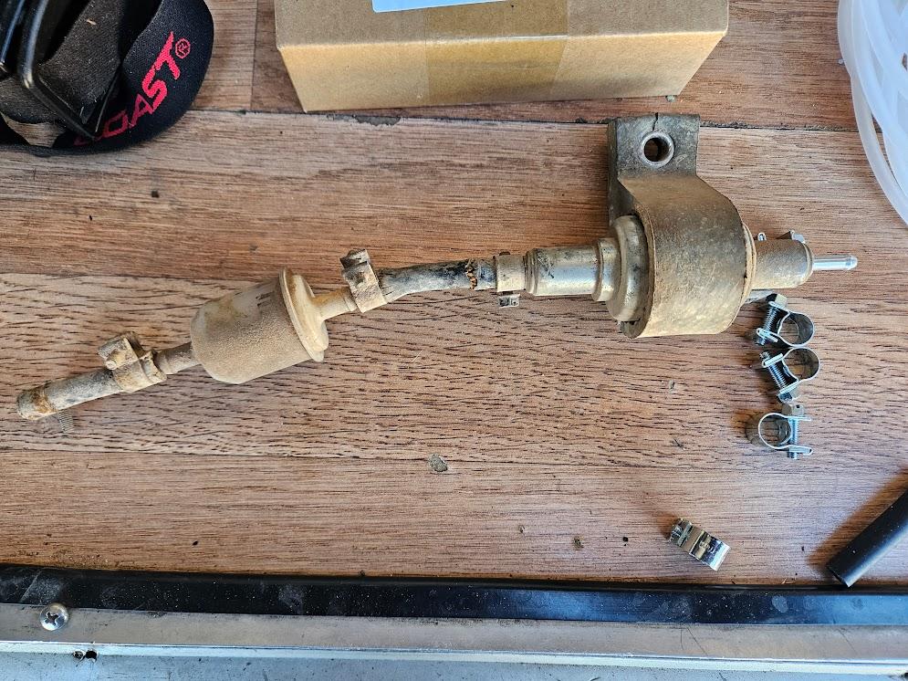

My six year-old CDH worked perfectly forever, until suddenly it stopped getting fuel.
I pulled the line off and found it was blocked. Further inspection found a pretty haggard setup.
Life under my van ain't easy.
I replaced all the lines, new filter, primed it and got a mouthful of kerosene (I use Klean Heat Kerosene instead of diesel) but she won't fire.
Considering I've never serviced it, outside of a fresh Webasto glow plug and pump a few years ago, it might be time to take it apart. Or chuck it and throw another one in.

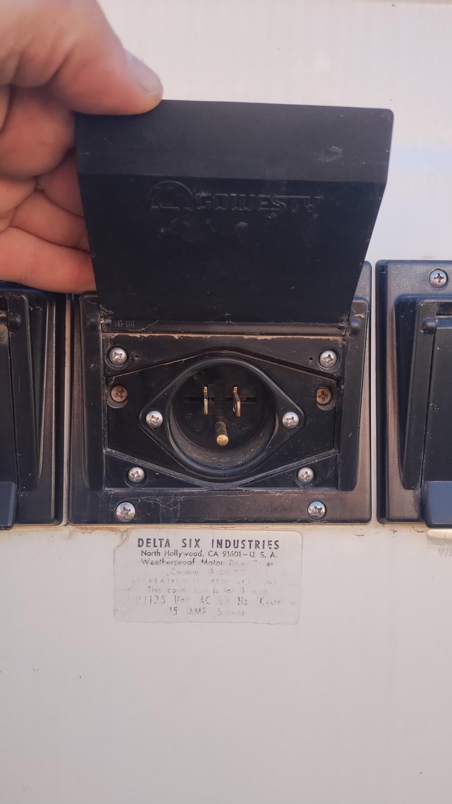

On the exterior power port of the US van, is there a cord that comes out or is it just a male plug inside the port door?
I'm thinking I may leave a couple feet of cord for my plug but I'm hoping you can post a pic of that powerport.

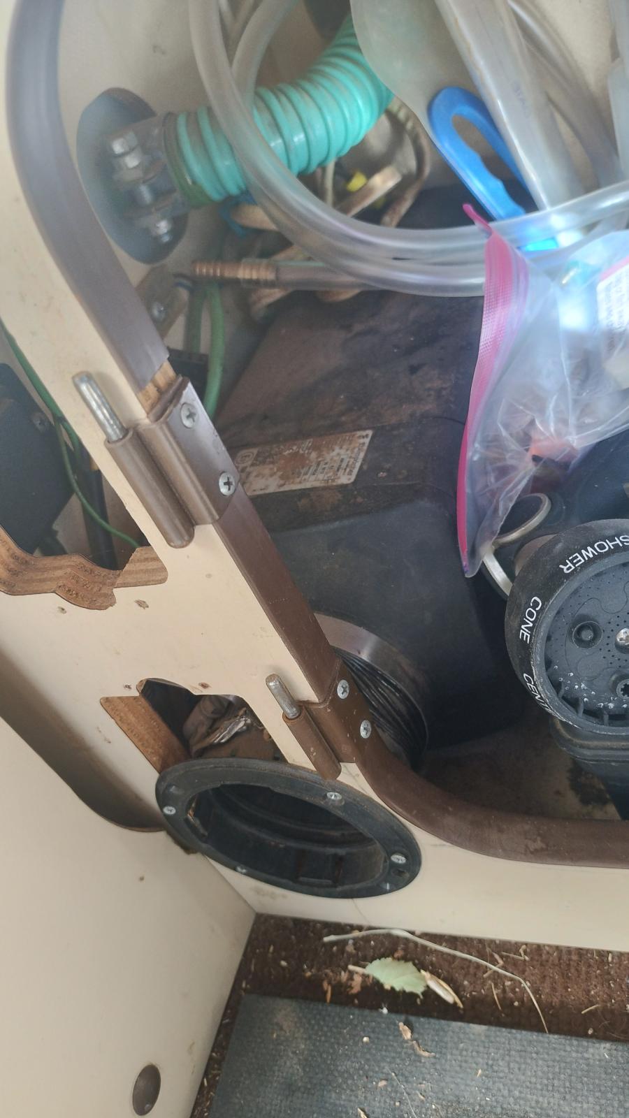

So I decided to install the cord again and I when I pulled the cord back into the van....
AAAHHHH..... I HATE THIS FREAKING THING.
I think only the polite Canadian Westfalias have the cord still....
That is what is inside The Telltale Canadian lower port of the vanagan up here.
I'm going to pull the cord, cut it short with the plug and maybe leave a couple feet.

Here's the plug in the US Westy...I bet you can get one.
I love being able to use what ever extension cord I can find. And many extensions cords are designed for packability which will take up way less space than your monstrosity and you can pack the separate one anywhere or leave it at home.
Look how much storage space you can gain!

Not cheap, but you may prefer to fit one of these: https://gowesty.com/products/gowesty-110-volt-electrical-hook-up-box?variant=41426710003877
Jim Crowther
1984 1.9l EJ22 Westy Wolfsburg Edition
Vespa GTS 300
vanis13
Joined: August 15, 2010
Posts: 4442
vanis13 is offline
PostPosted: Fri Jan 17, 2025 11:29 am    Post subject: Re: The official Chinese Diesel Heater thread (Webasto Knockoff) Reply with quote
at $60 not bad since a simple mass-produced special electrical outlet can be $20-$100
