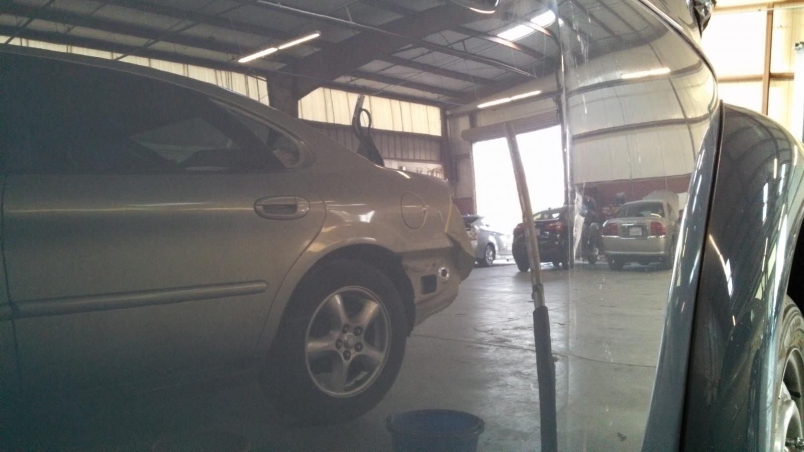

The rear apron was pop riveted in...which was nice as the owner wanted the exhaust cut outs welded up and smoothed. So same procedure as before, make some templates, tack weld around the perimeter and grind it smooth. I will ad a couple of drain holes to each side just to make sure any water does not get trapped.

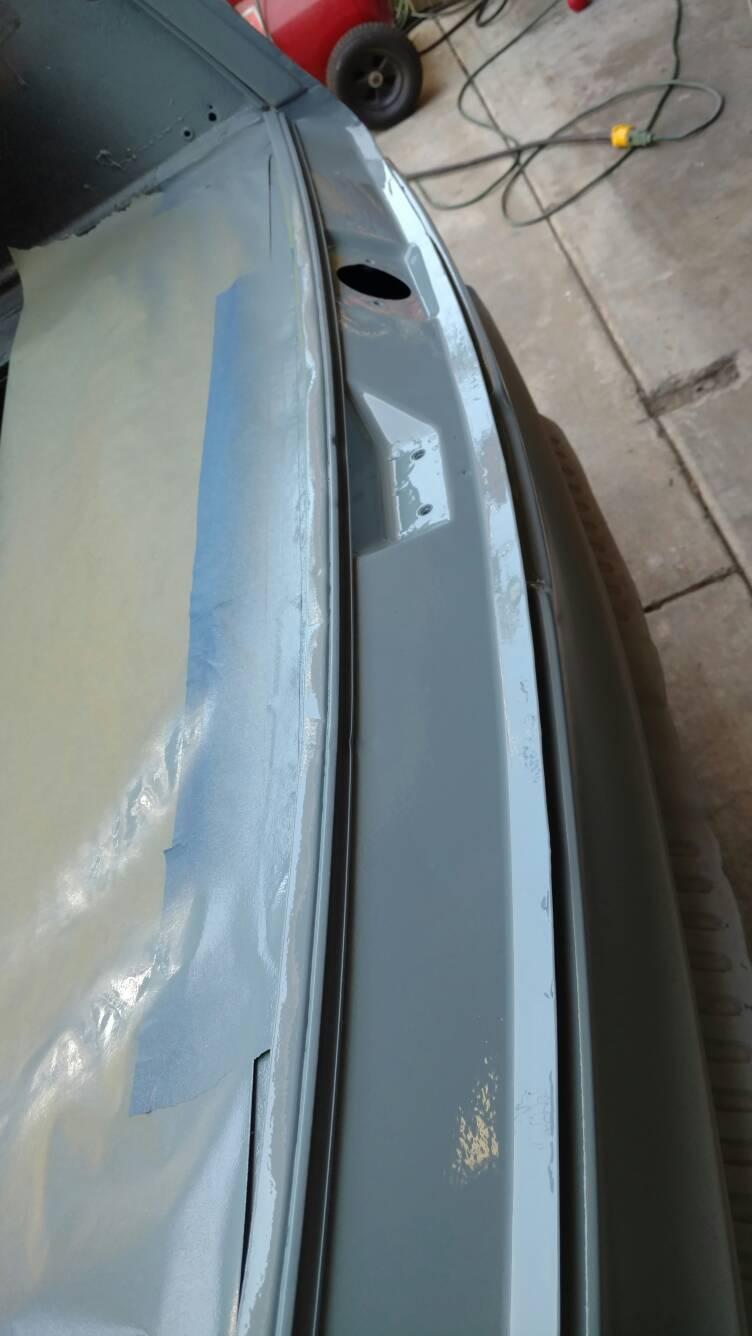

One side is finished just for reference. It looks as though there is a huge dent in the middle of the apron.....But, its just the reflection from the flash....its actually smooth.

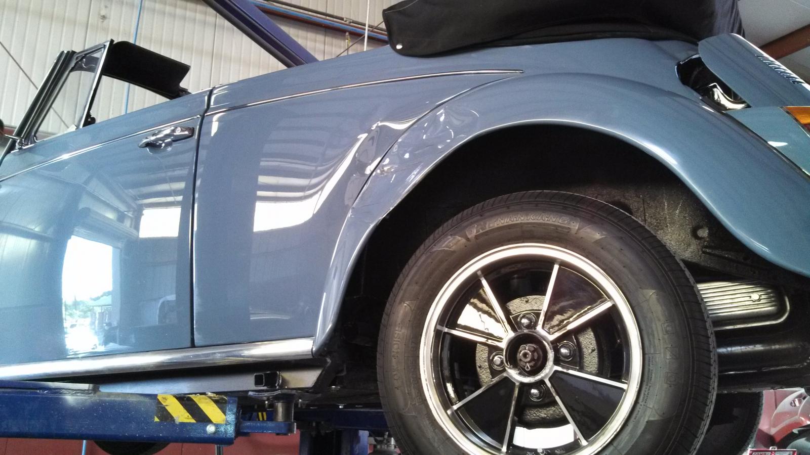

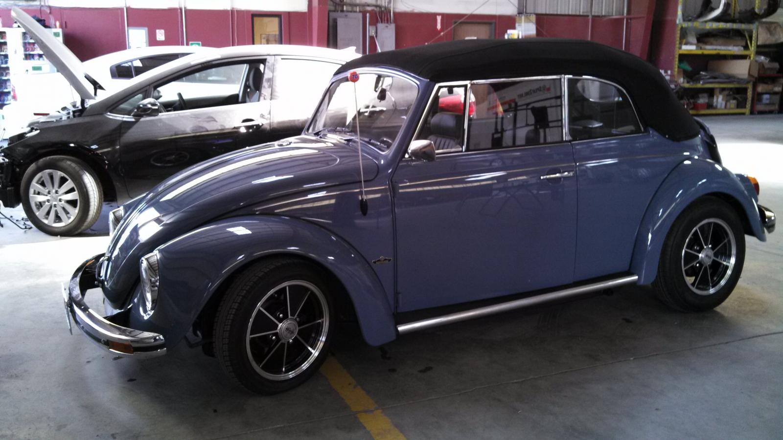

Sorry all, Life has been busy.......Here is the completed bug from that last part of this thread.

Sorry, it is a picture of a picture. It makes the color look way bright because of the camera flash.

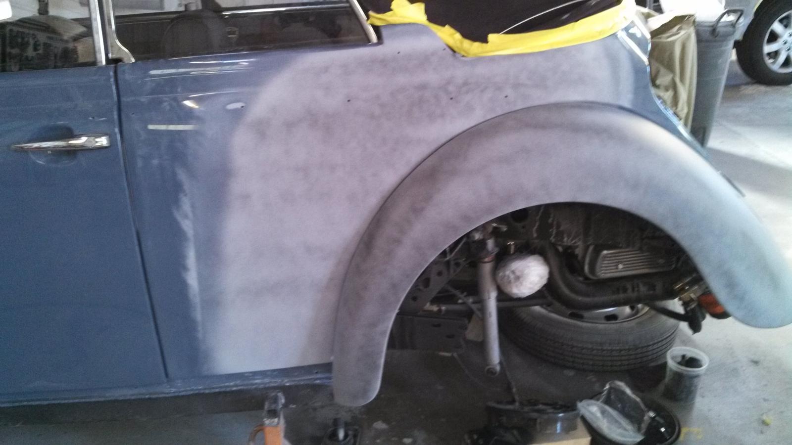

This shot is of the bug after i fixed it the second time. Someone side swiped the driver's side and took out the quarter panel, rear fender and bumper.

Here is the damage.....quarter panel, fender, trailing arm Etc.
The repair with a German fender.....
All finished..............

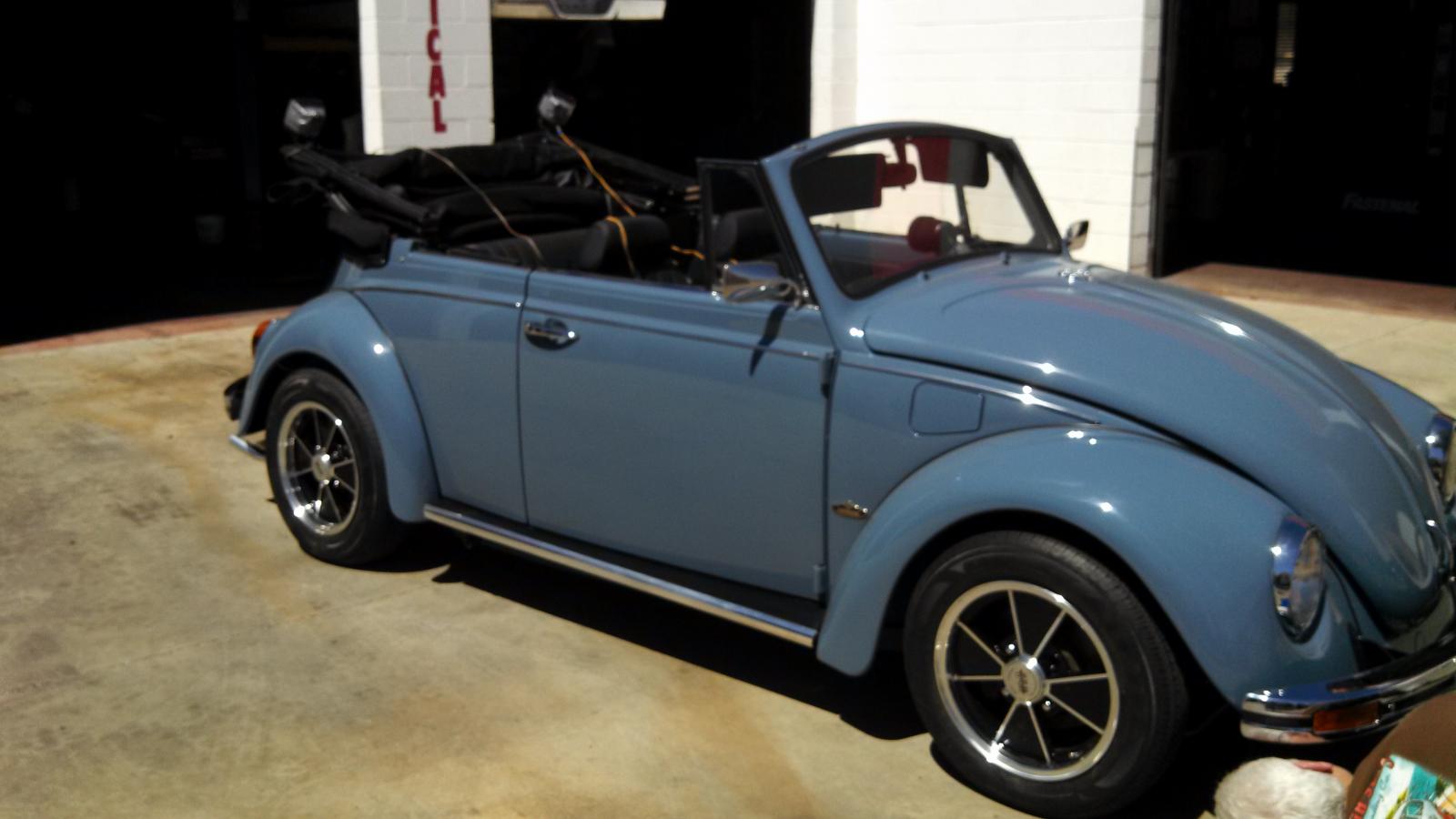

As you can see i worked pretty hard on making this car straight and the paint nice and flat....the hard work pays off in the end.
