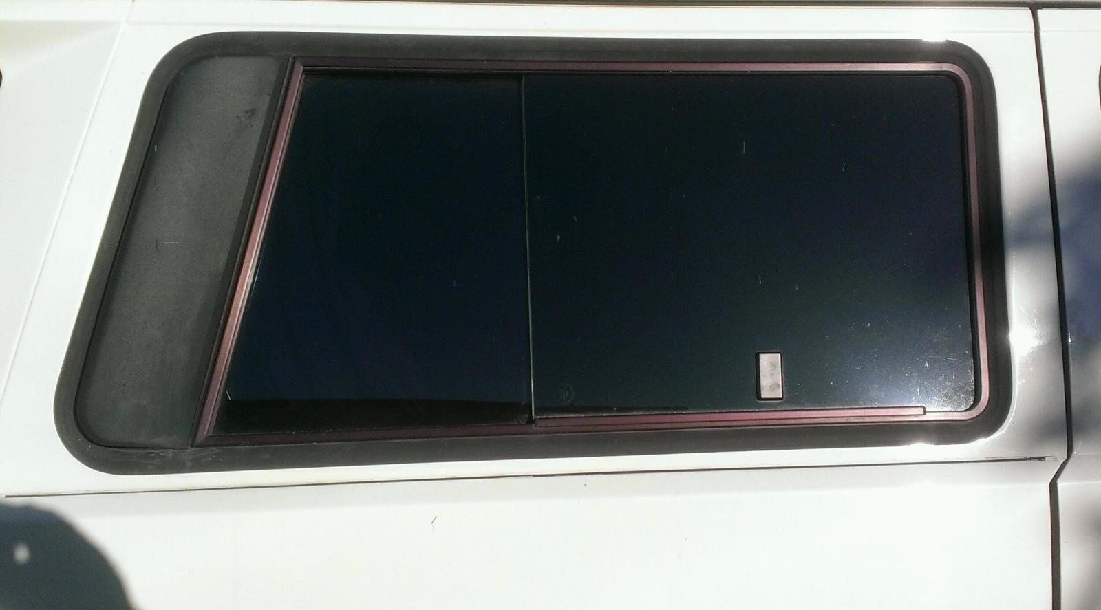

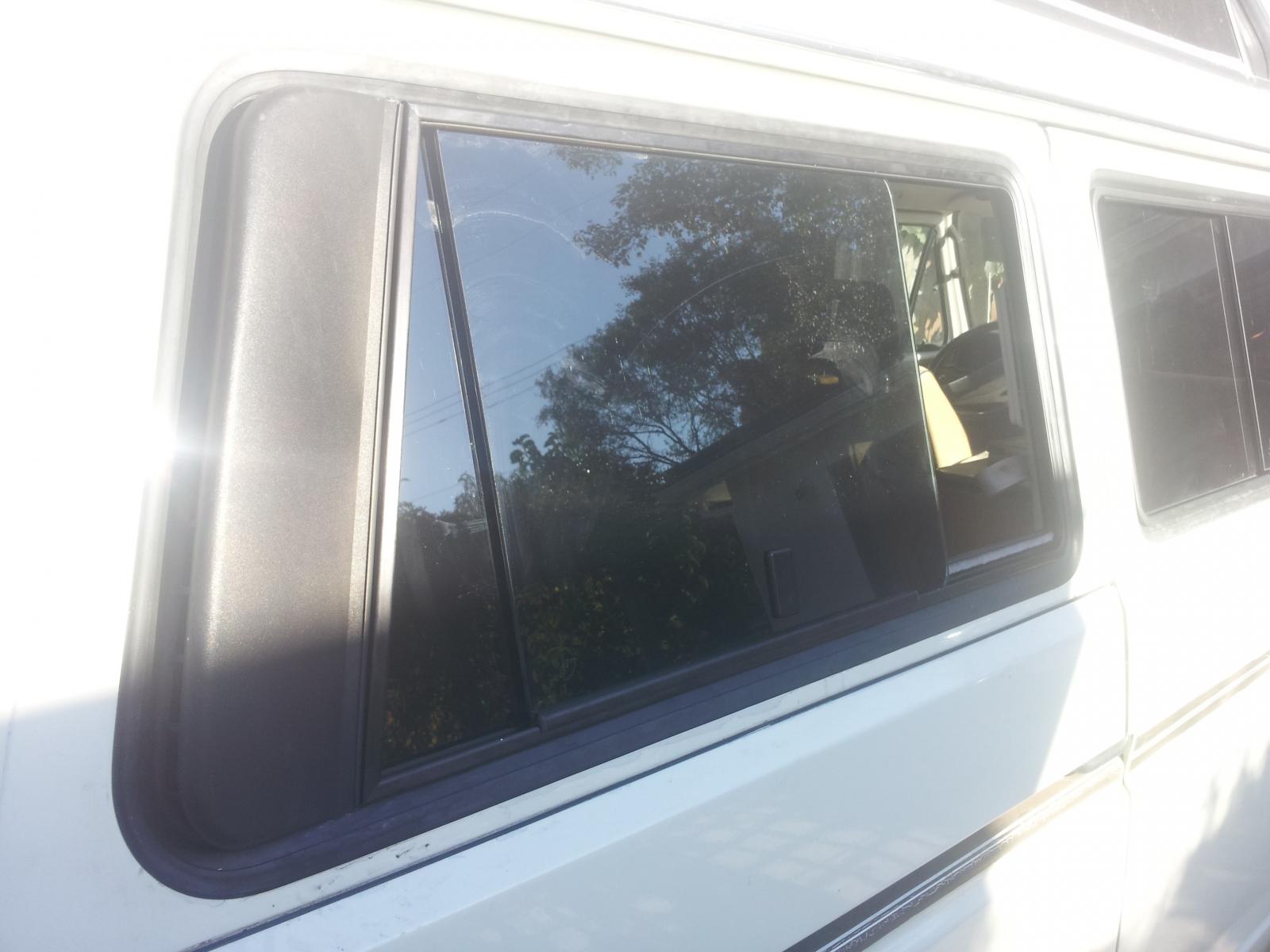

I made these. Not super hard. I had some glass made that was tempered and had the locking latch located back so the westy screens work.
Back passengers like them

They look just like the westy slliders when closed. I could get a picture, but you probably have seen them a million times.
It was a little trick to make the beveled cuts and re-bend the leading upper radius. I first attempted making them without the rear air vent from the late model vanagons, but it was much easer use the plastic air vent.
I had to make some new patterns for the glass which was very expensive. I think I paid over 100 for the two pieces. I build 3 sets, one for each side of my adventurewagon and one for a friend.
With anodizing, tint, and glass I probably was in it over $500.

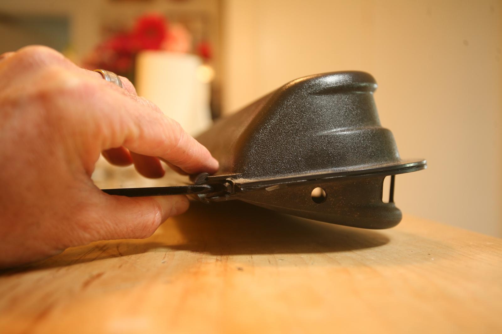

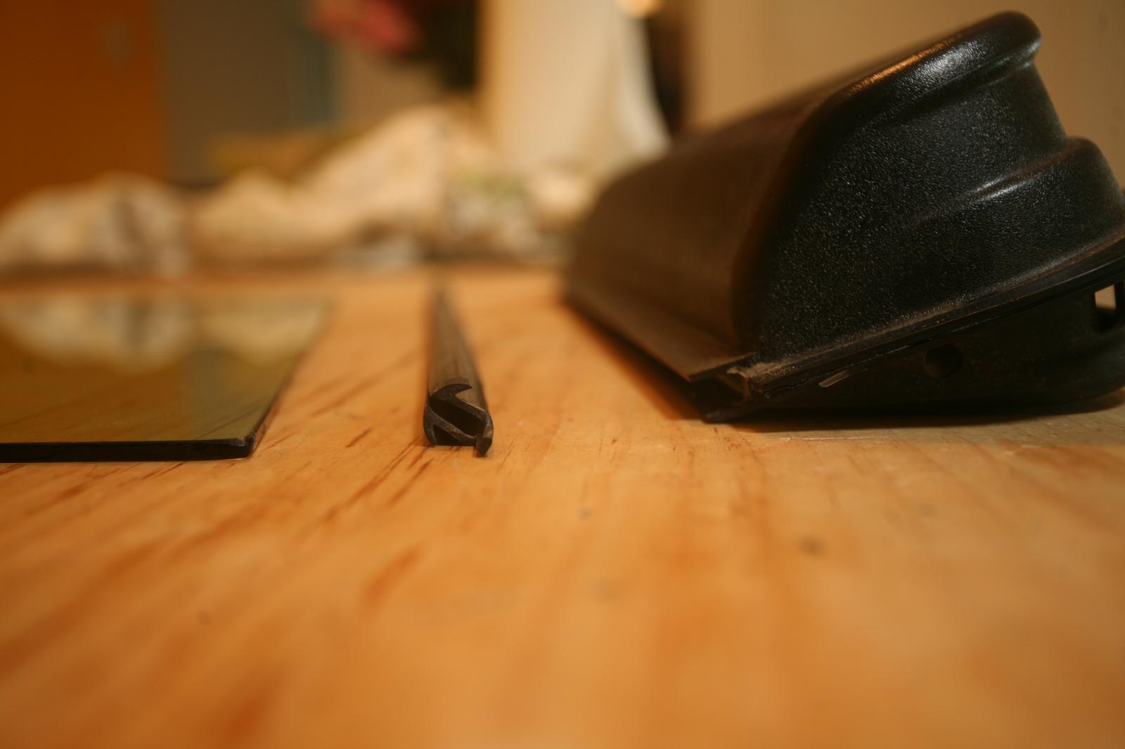

I uploaded some photos for you, and whom ever might find them helpful, that illustrate the relationship between the glass, rubber seal, and the plastic rear vent.
Besides the ones I have placed into this forum, there are more in my photo feed at this link:
Hope it helps.

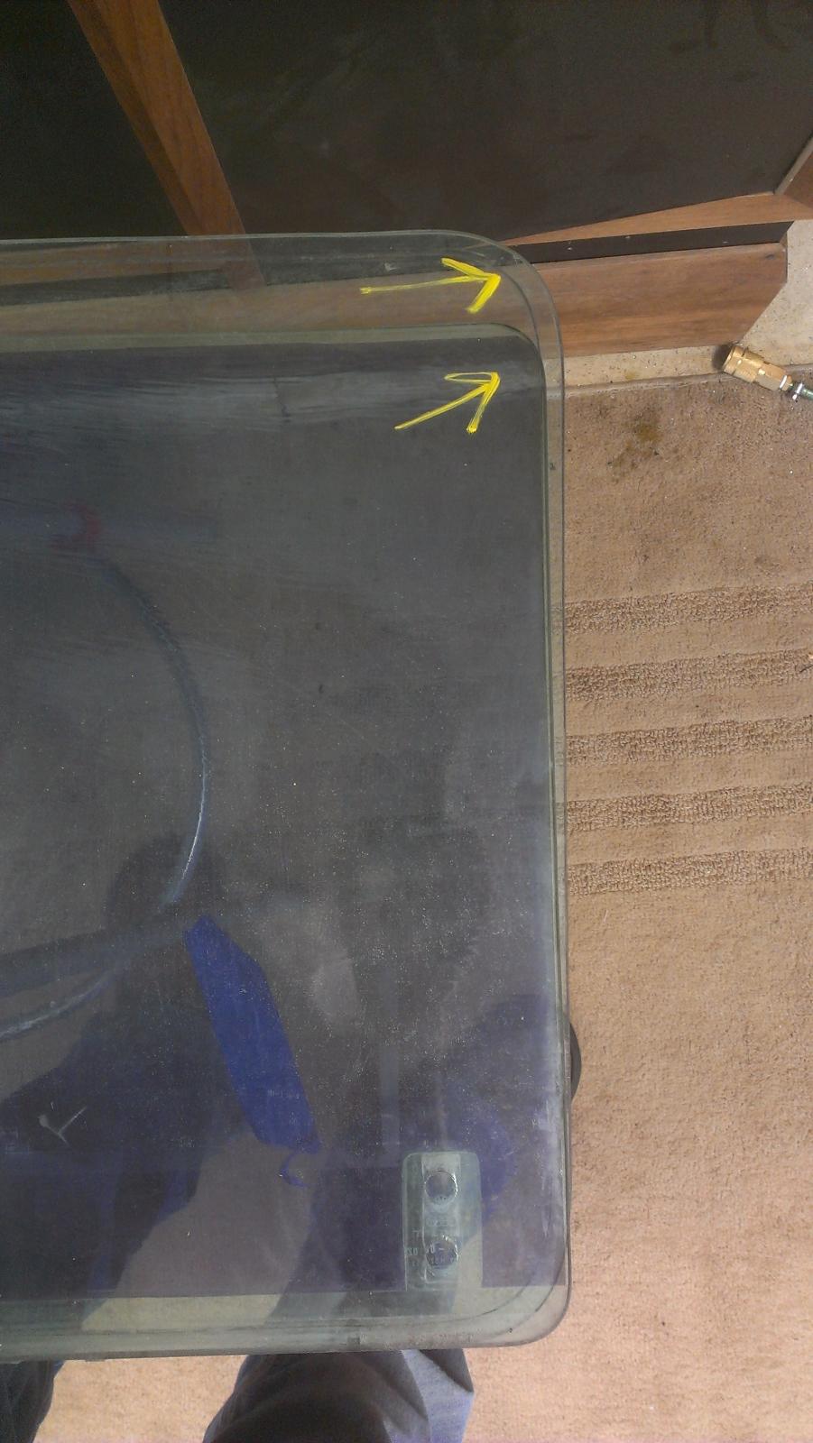

This is a picture of the difference in the leading upper corner from the rear window to the middle door window. I had to bend the frame a little to get the proper shape.
If you use the middle window operable glass, the glass will not seat completely in the weatherstripping channel. It might make some wind noise.
You will also not be able to use a westy screen.
Here is a photo of it closed.
It opens about 8". This was the max I could go and still use the stock screen.
I think this is the most you could get regardless of where the lock latch is located.
David Marquis's photo of the rear vent receiving he glass is how the stock solid window is placed. I found that the fixed piece of the slider was not in plane with the vent channel. I used an extra piece of another window frame to make the rear vertical portion of the frame.
Over all, I am very happy with them. The time to make these is significant, and I dont think vanagon owners would be willing to pay to have someone make them. They aren't too hard to do though.

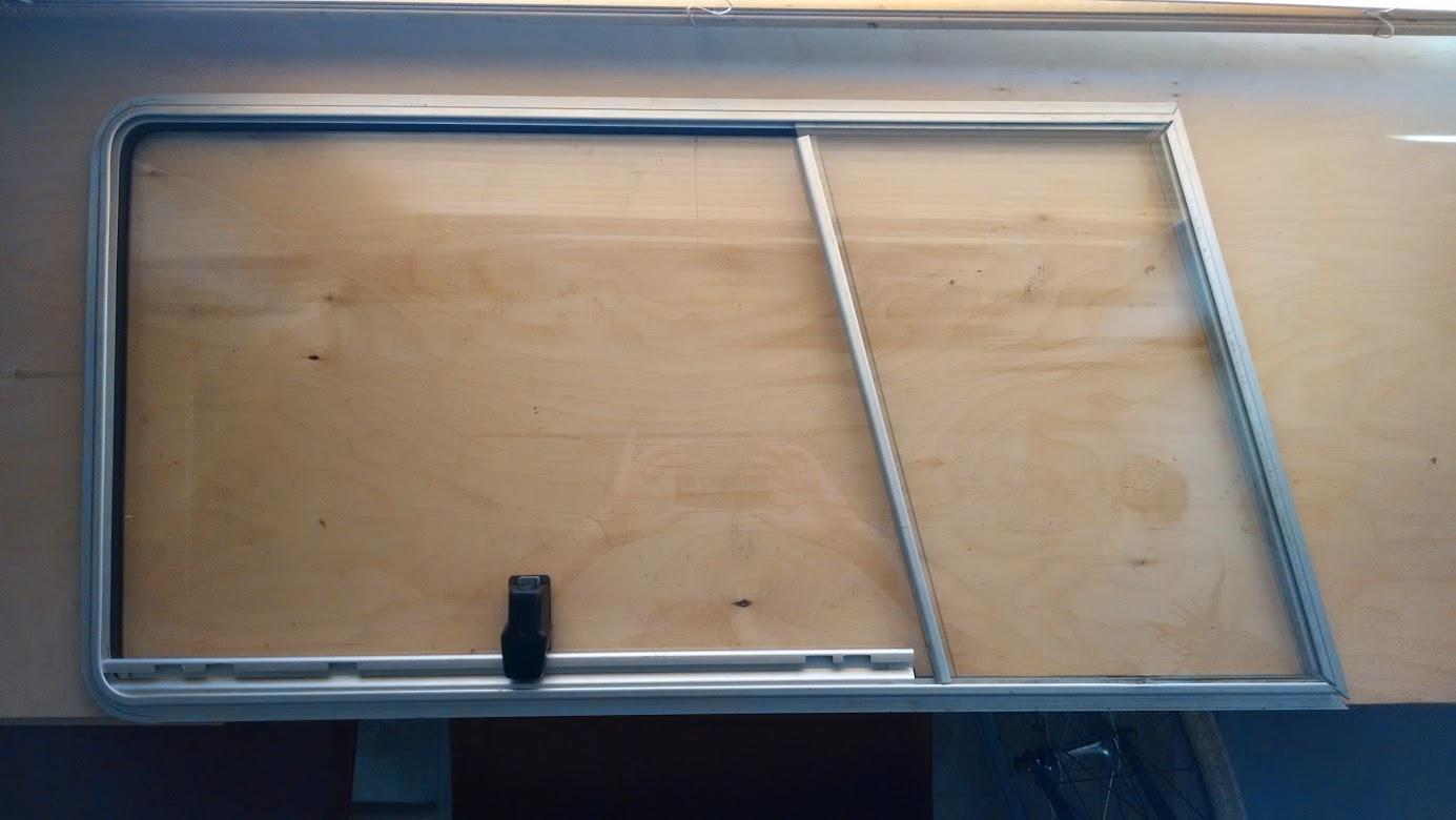

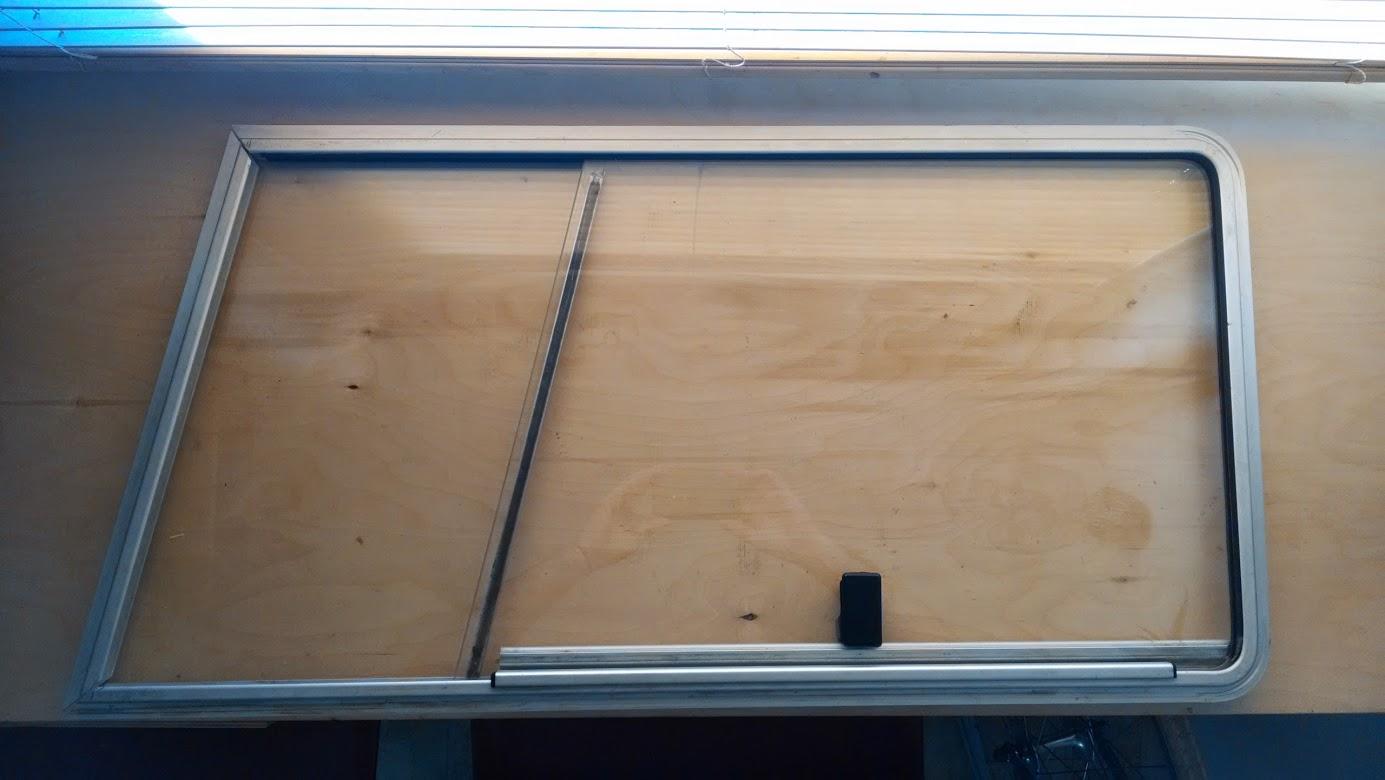

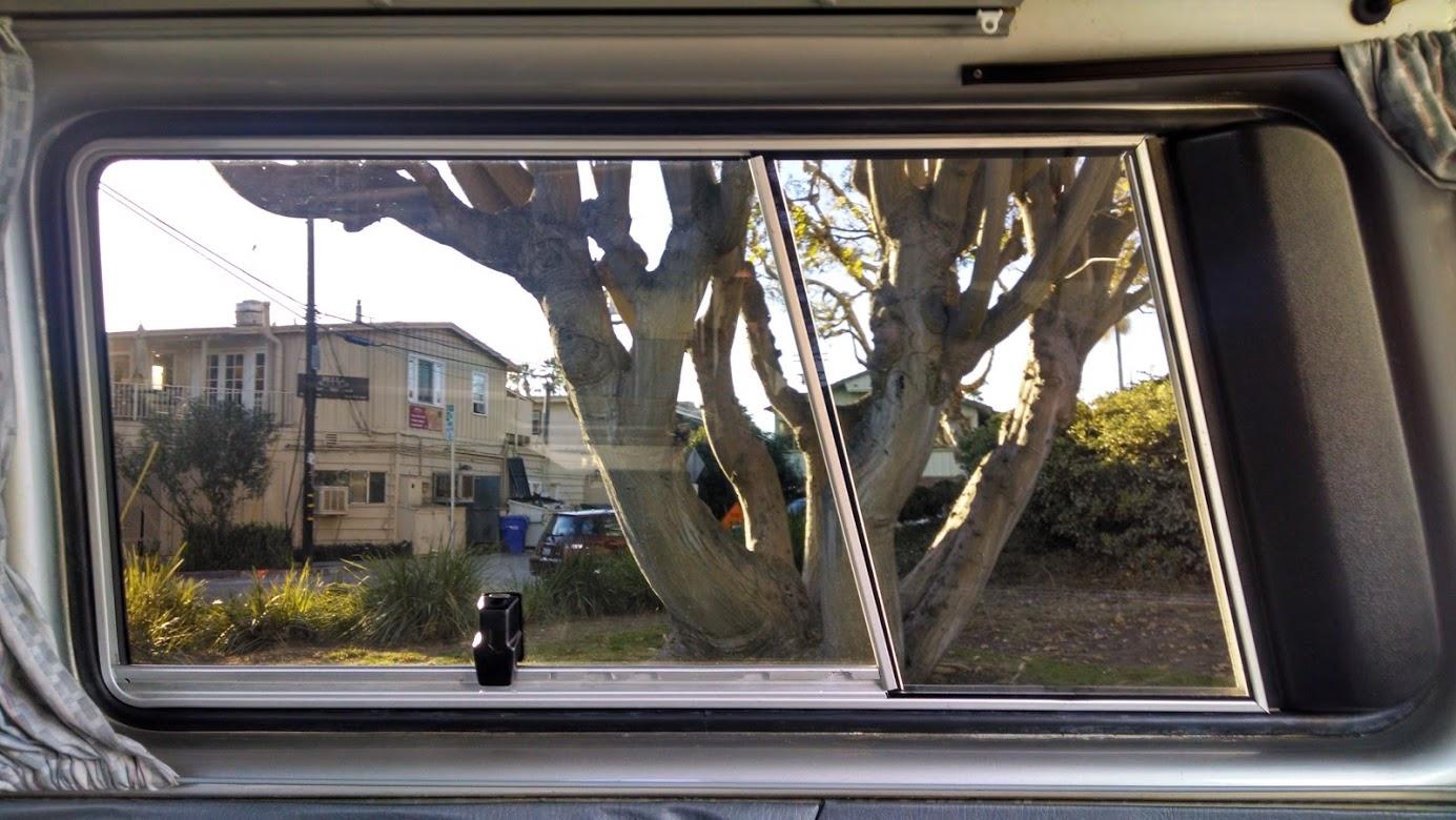

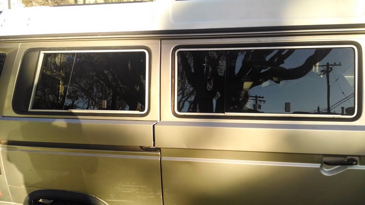

Here's some shots of the sliding rear windows I made. Very easy to do as long as you have the rear vent. To make the back portion of the frame you'll need a piece of a second frame (you can get 4 of the back sections out of each spare frame)
I figured out the possible latch placements and set mine up for the biggest screened opening (9.5 inches) I cut a set of GoWesty screens down to fit. With a stock screen the maximum opening is 8 inches. With no screen it could open to 14 inches.

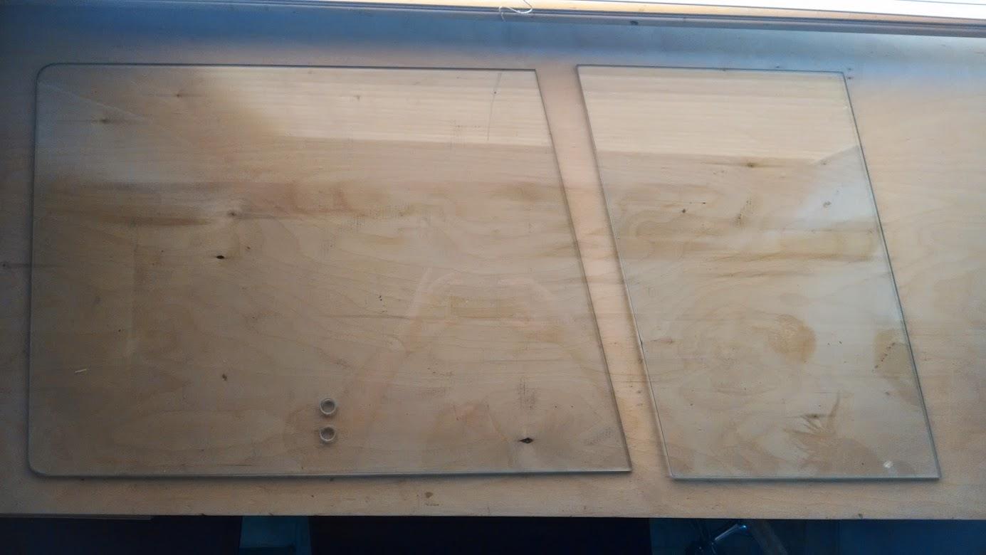

The only dicey part is getting the glass right. For anyone interested in a set of glass I'm happy to help, send me a pm.
