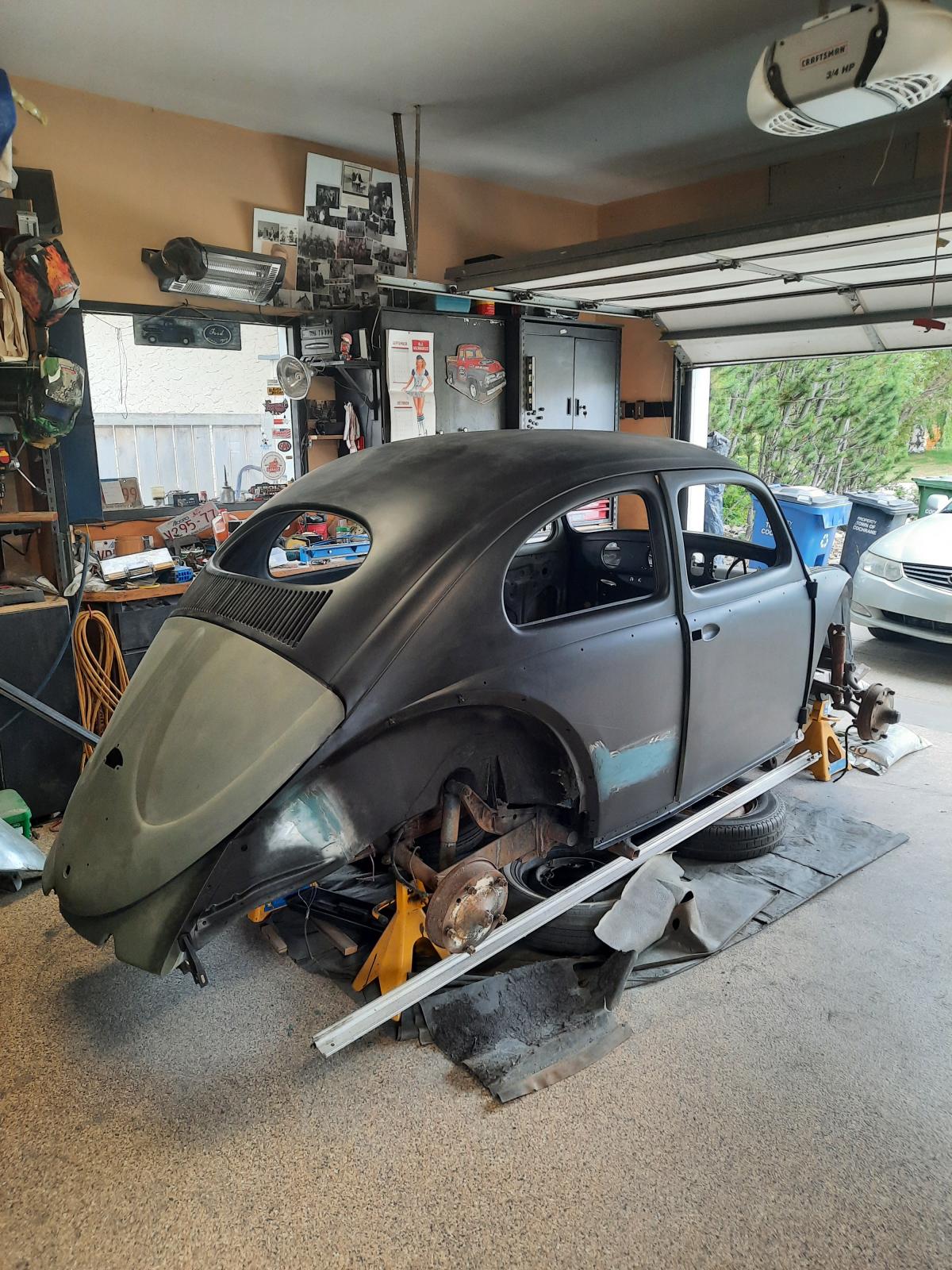

Location: Calgary, AB Canada
tomsbuggered is offline
PostPosted: Mon Aug 05, 2024 8:07 am    Post subject: Re: TP's 56 Oval Project Reply with quote
I found the evasive rear apron; it was exactly where I put it. 🤣 Having it in hand enabled me to mock up and weld in the rear section.
June 1956 VW Oval Beetle
tomsbuggered
Joined: October 16, 2014
Posts: 443
PostPosted: Sat Aug 10, 2024 11:29 am    Post subject: Re: TP's 56 Oval Project Reply with quote
Front "firewall" repair around Napoleon Hat.
Panels fabricated and ready to install, which probably requires body off pan to fit.
VW_Jimbo Premium Member
Joined: May 22, 2016
Posts: 11406
VW_Jimbo is offline
PostPosted: Sun Aug 11, 2024 8:52 am    Post subject: Re: TP's 56 Oval Project Reply with quote
If the body does not change with those pieces cut out, you can do it like that. Get a piece of poster board or some card stock. Then cut a template from it. Make it fit the spot and then transfer that over to the body panel. Cut, install, mark, remove, trim, reinstall, tack, check, stitch, cool rag, psssst, stitch……!
You got this!
Jimbo
TDCTDI wrote:
67rustavenger wrote:
tomsbuggered
Posts: 443
PostPosted: Fri Aug 16, 2024 10:04 pm    Post subject: Re: TP's 56 Oval Project Reply with quote
I have the inner and outer firewall panels fitted and tacked. I'll lift the body from the pan and finish welding them in then. I received my order for the spare tire tray panel so I'm going to concentrate on installing it. It seems ill fitting so I'll make a template to get it accurate.
My plan is to install an IRS, I scored yesterday., from what I believe to be from a 1971 Beetle.
Worked at separating the transaxle, axles and rear trailing arms and cleaning up everything.
