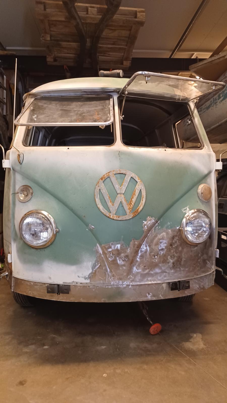

I have got my T1 foreward a bitt again this is where we stand.

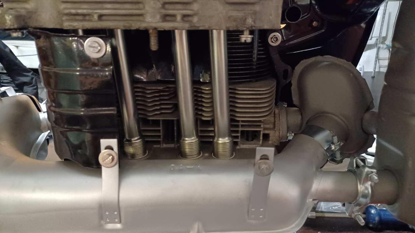

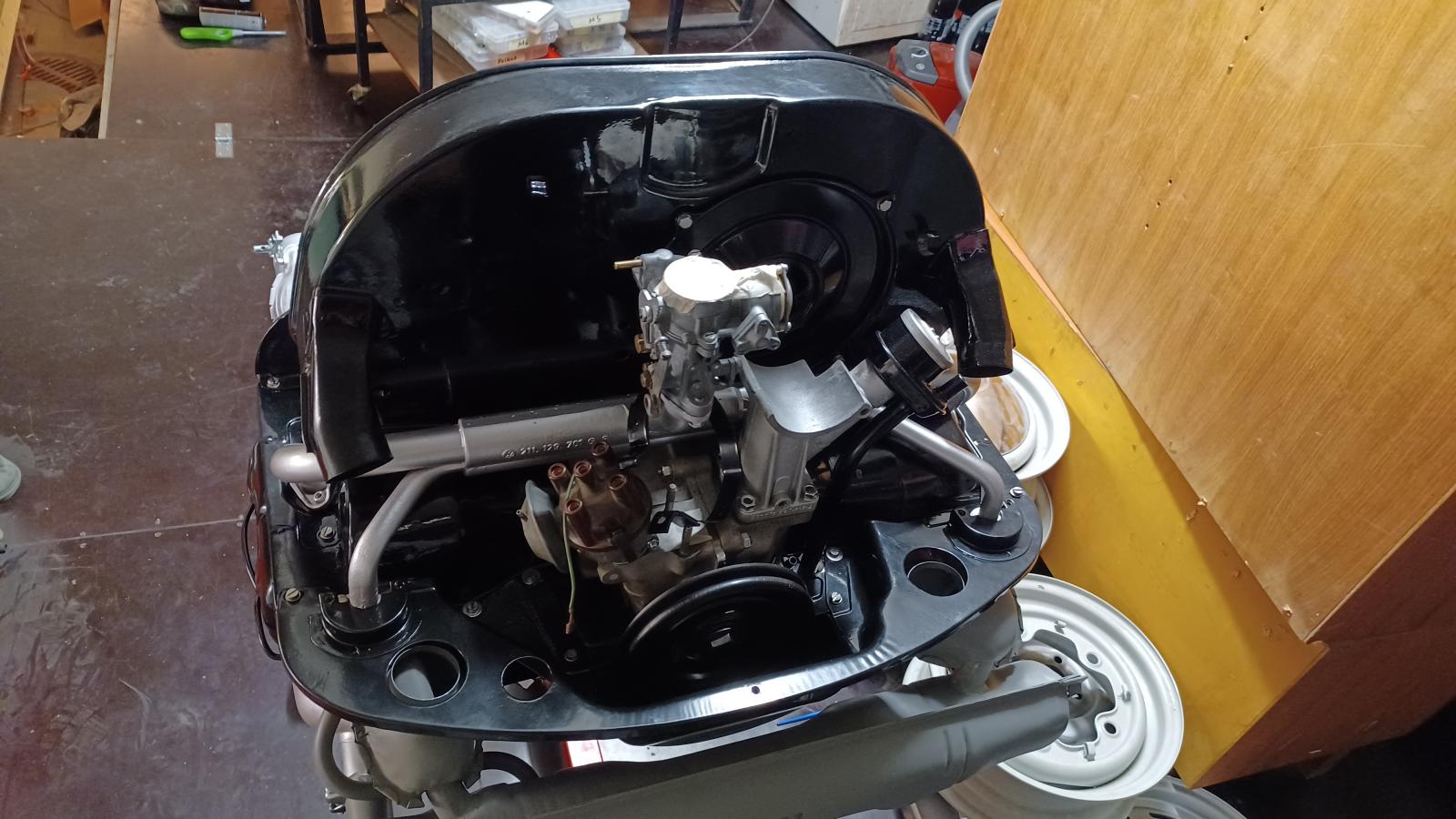

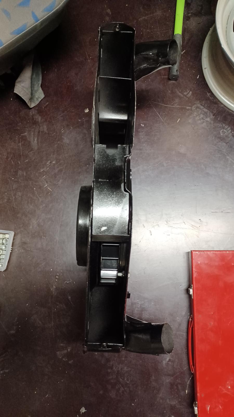

I have worked on My 65 again . What comes to the engine its almost there, I still need to overhaul the generator and then I,m still lacking the plate under the thermostate the flaps inside the fan housing the thermostate and the thermostate bracket. Any suggestions whoo sells them? What comes to the thermostate Ibhave heard rumors that the OEM is hard to find and the aftermarket is bad. According to some the aftermarket fails in closed position in comparison the OEM fails in open position witch is much safer.

I´m still wondering should I disasemble the exhaust with the heatexchangers and all, and cermic coat it. The paint that is on the new parts, feels pretty much like it would perisch the moment I start the engine. Has anybody any experiense with ceramIck coating the heatexchangers and what happens to the flapmechanism if one does that, will it glue togather or will it be just fine?

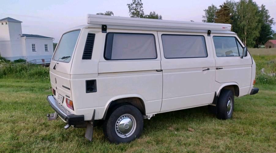

I bought a Fiamma F45 S 300 cm to use on my van`s I have an slight issue with it ratling when driving on more bumpy roads. Does some one know how to remedy that it is mounted solidly on the car it is is the markise it self that seem to ratle.

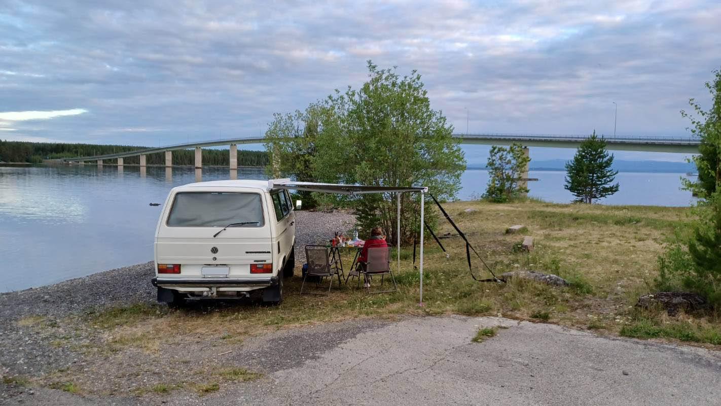

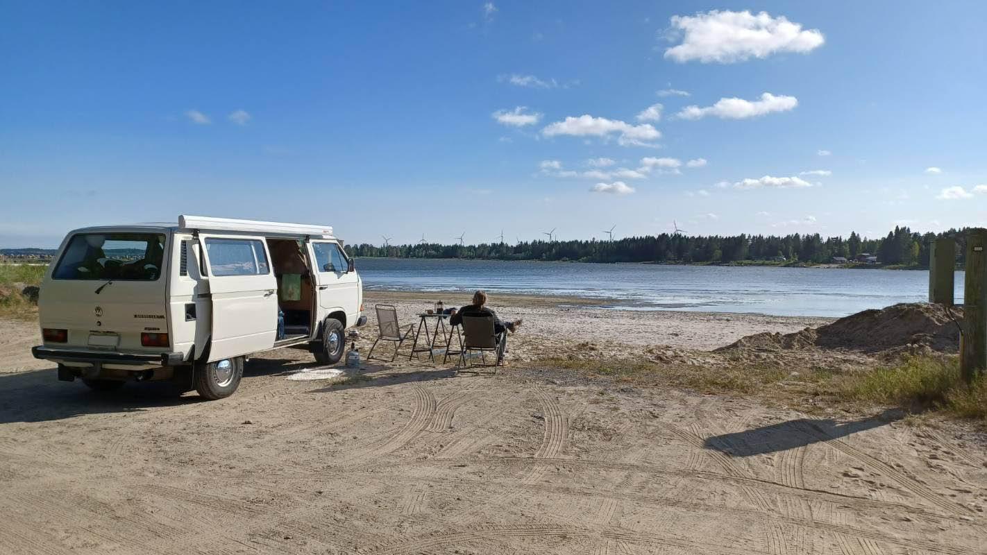

I had my sommer trip this yearfrom Helsinki to Lahti then Tampere Vaas Umaja sweden down the Högakusten then to Tronheim Norwy and down the norwegian coast a bit then through Geiranger to Grisslehamn from ther to Åland then Turku and back home to Helsinki
Everything went fin until Åland where I got an Electric gremlin the main plus diapeared and I had to connect it directly from the battery to the ignition switch to gwt home
Gotta think a third mounting bracket is needed for that length awning.

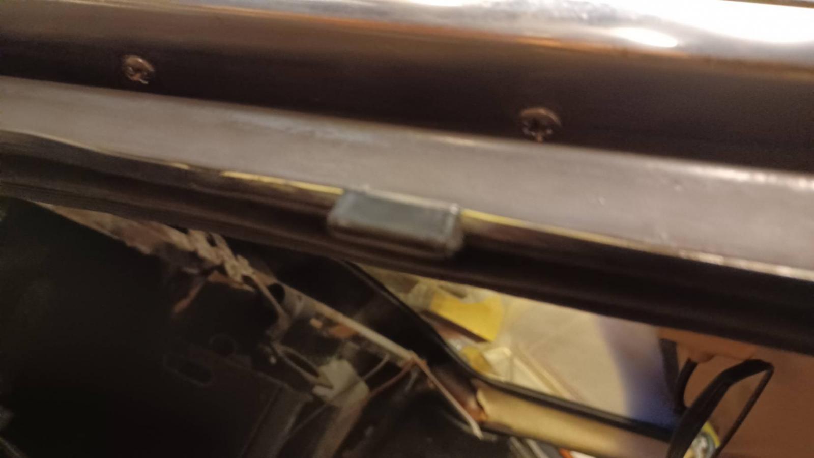

I have been test assembling all and fitting everything from safariwindows to antennas and door seals on my spliti. The door seals that are on the market are realy bad. I have a couple ofsets fromdifferent manufacturers and all of them SUCK. I have got the side dor seal installed using the door side from one set and the car side from an other. One set was so bad thatI throw it imidiatelyinthe trash. So two and a half complet sets and one opening fitted. I would have made beter results by going to my lockal rubber company and bought everything there by the meeter(Feet if your that pervers).
By the way how should the rear hatch seal actually run around the hand resess?

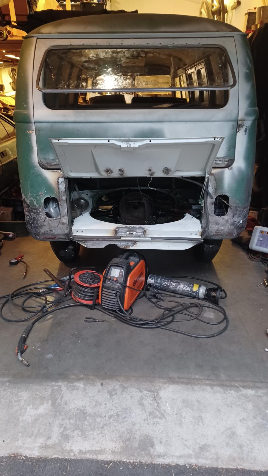

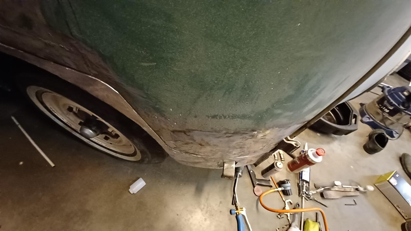

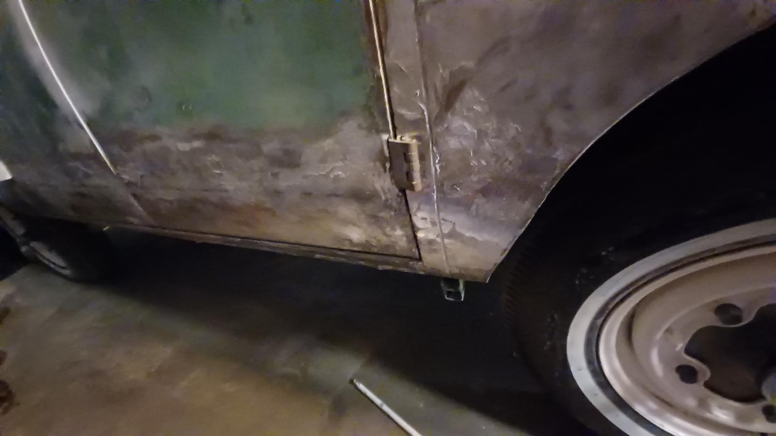

I have been learning tinning on this car. I have tinned previouslybbut just small details now I decided to tinn most of the dents and weld seems mostly because the T1 is so thin sheet letal that I´m worried that if I would use filler on som of the dent they might crack as the body buckles justvby pushing it in the garage or when leaning on it so I want to keep the filler thin.
Eyeball the gutter from back-to front.
The rain gutter is curved.
If all 3 mounts are the same - you need to space ~15mm outboard on the front and rear mounts.

PostPosted: Mon Oct 02, 2023 9:18 am    Post subject: Re: Osku's Vans Reply with quote
Yes your right I assumed it would be straight but a slight curve there is estimating and eyeballing 15mm a bit over a half inch in historic dimensions based on some kings tumb.
