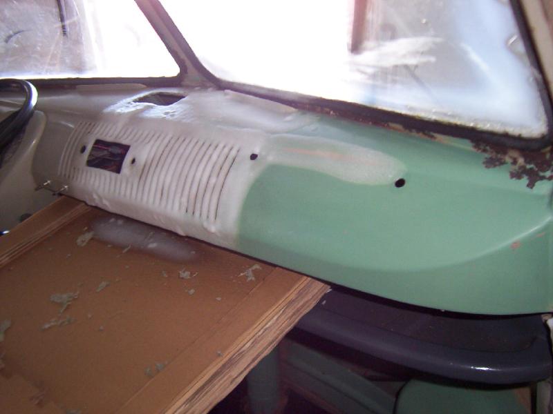

I used 0000 steel wool and some kind of 409 degreaser on the OG dash paint on the DD and it came out sweet. I just kept a roll of paper towels handy and got all the gunk off before respaying and rebuffiing.

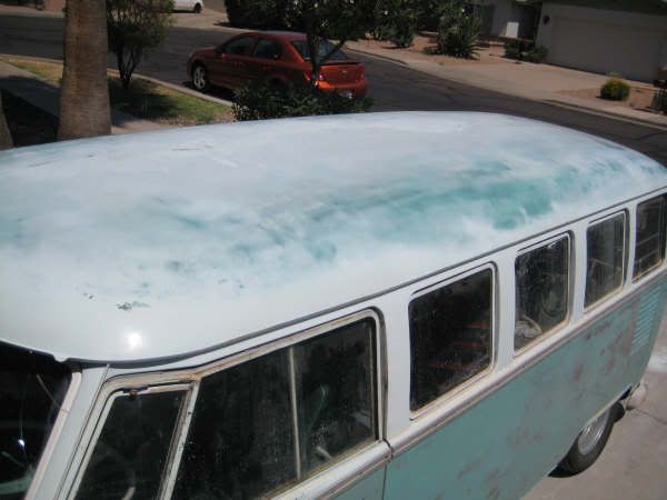

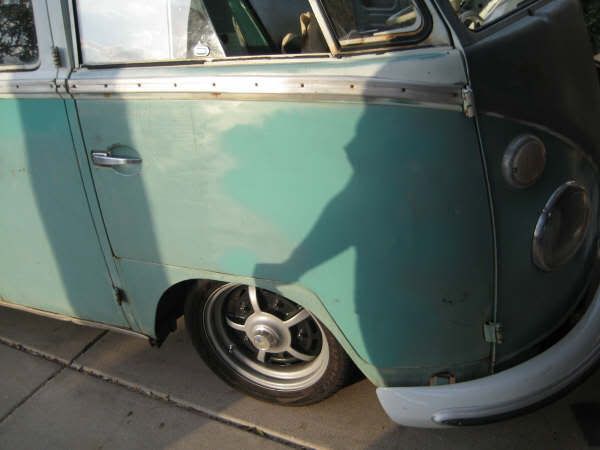

I just did the "skim" treatment to my ride and it shines nice! I used graffiti remover, oven cleaner, jasco paint remover, and for the surface rust i use steel wool and clr. I left the jasco paint remover on too long and it went to bare metal, sucks but sh*@ happens

The Skim treatment

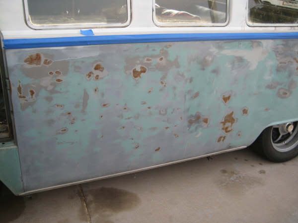

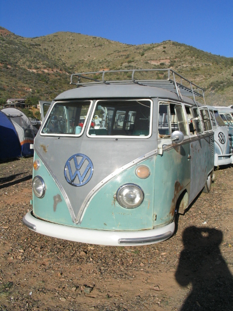

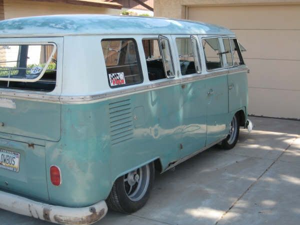

PostPosted: Sat Jun 16, 2007 7:50 pm    Post subject: Reply with quote

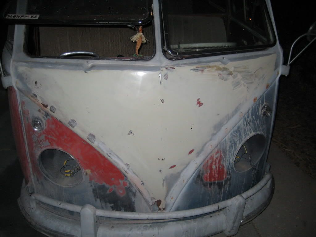

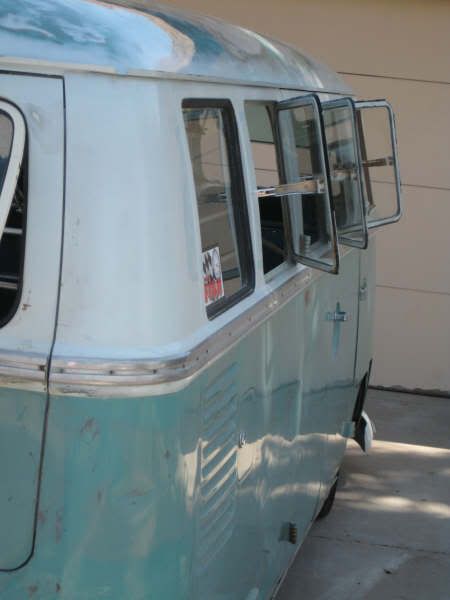

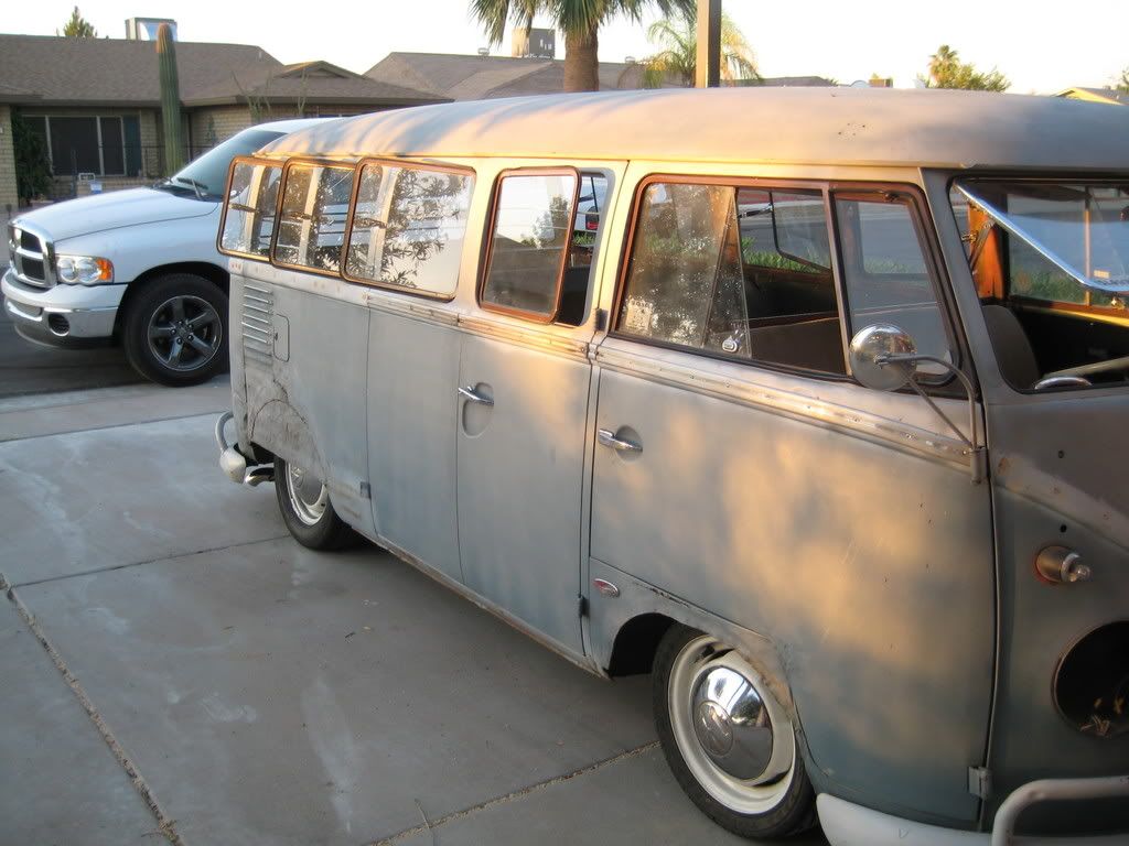

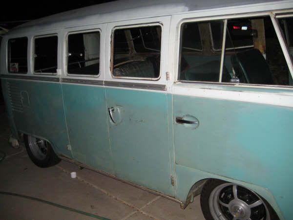

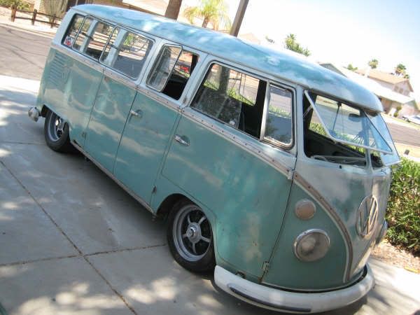

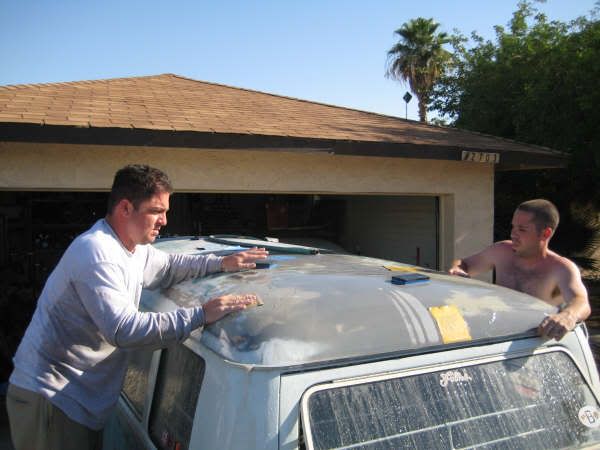

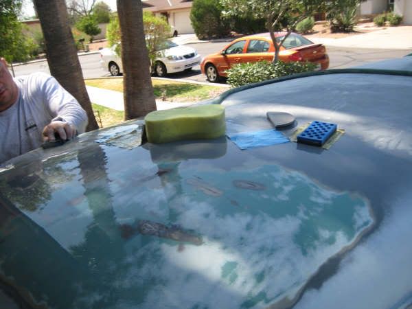

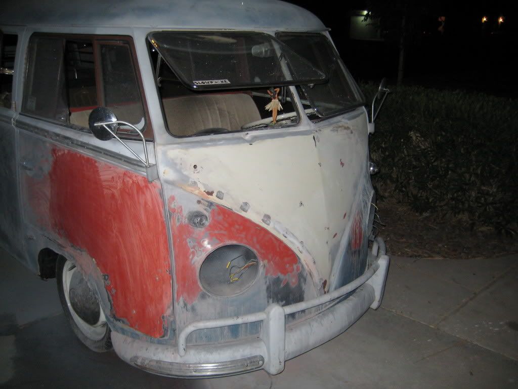

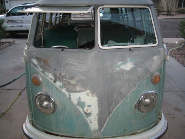

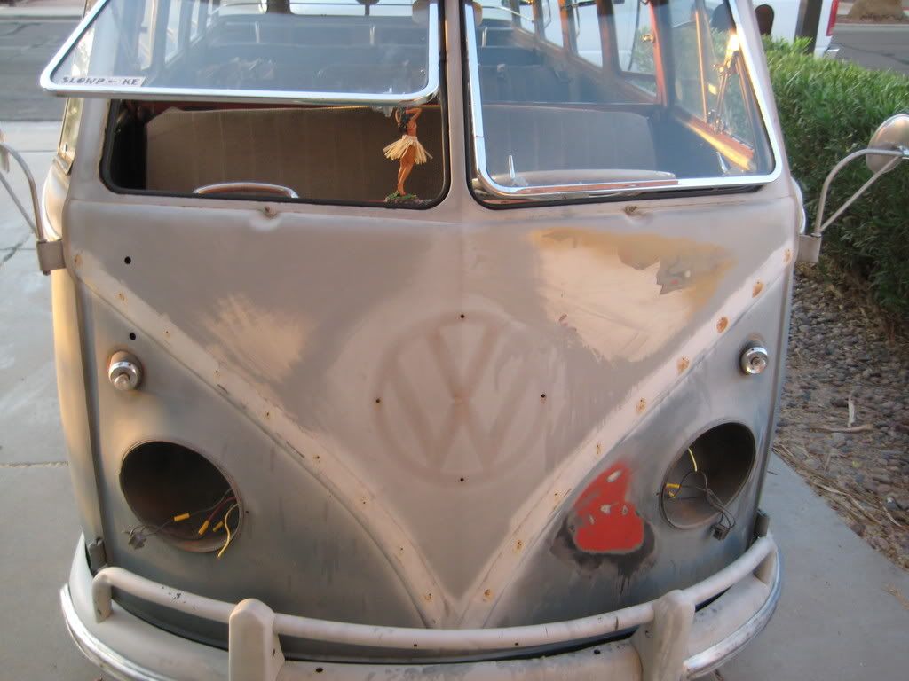

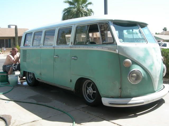

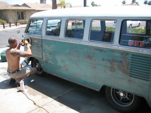

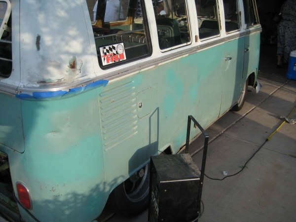

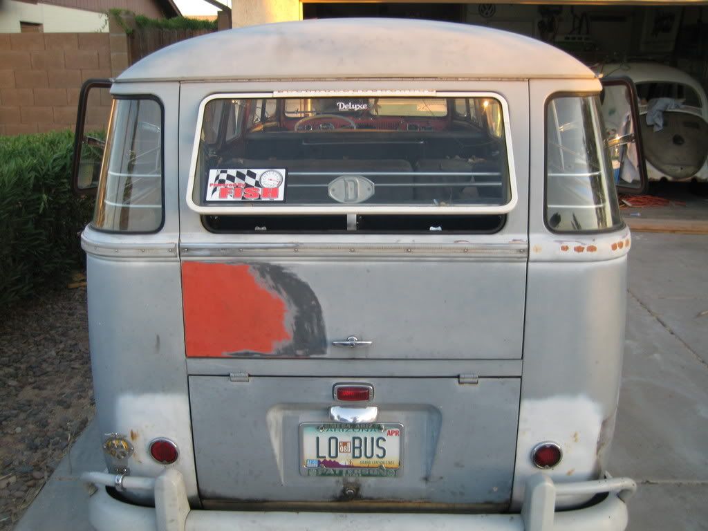

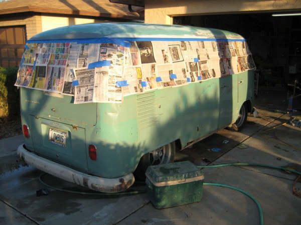

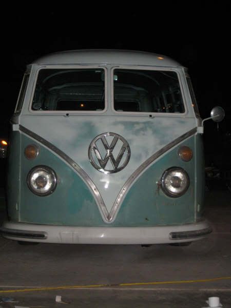

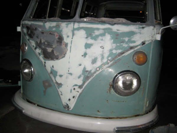

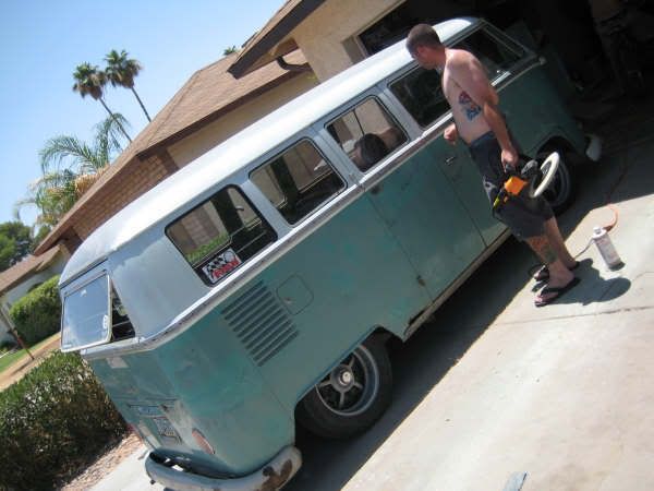

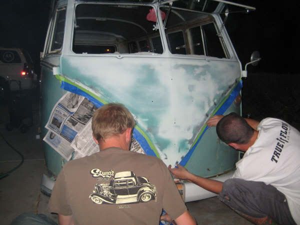

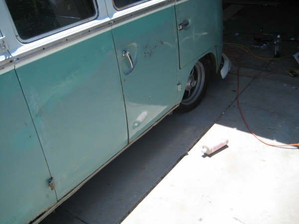

I did as much as I could for the day and a half I was in Phoenix and we got it pretty good. After removing all the primer we threw down on the sides etc. Heres half way thru the process. Between Max, Jay and myself, we worked on it until 1 hour before they took me to the airport to fly home and I took these after pics right before I left.
before
During
and he will have to post the afters since they worked on it all day after I flew home to Texas.
**Edit** He just sent me these..
GFK
1953 Kabriolet
1959 Lowlight Ghia vert

You have any pics? Just remember the warmer it is outside the faster those chemicals go to work on that paint so keep some fresh water or a running hose near by to neutralize the stripping process. It will take off good original paint. When in doubt use fine sand paper Cool

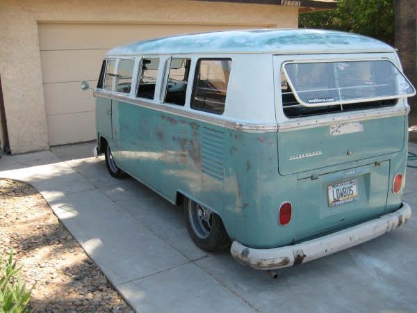

On his bus, we went to the local auto paint store with the color code for blue-white and turkis. They made us 6 rattle cans in single stage in 20 minutes.
Basically we only used paint where it was needed. Somebody previously thought it would be a good idea to hit every knick and scratch with a D.A. so it had burrs all over it.
after final color sand and buff, the colors blended pretty well for coming right out of the spray can like that.
Next he plans on restoring his bumpers the same way. Good for him.

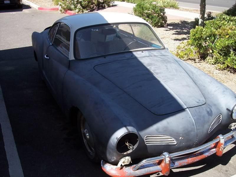

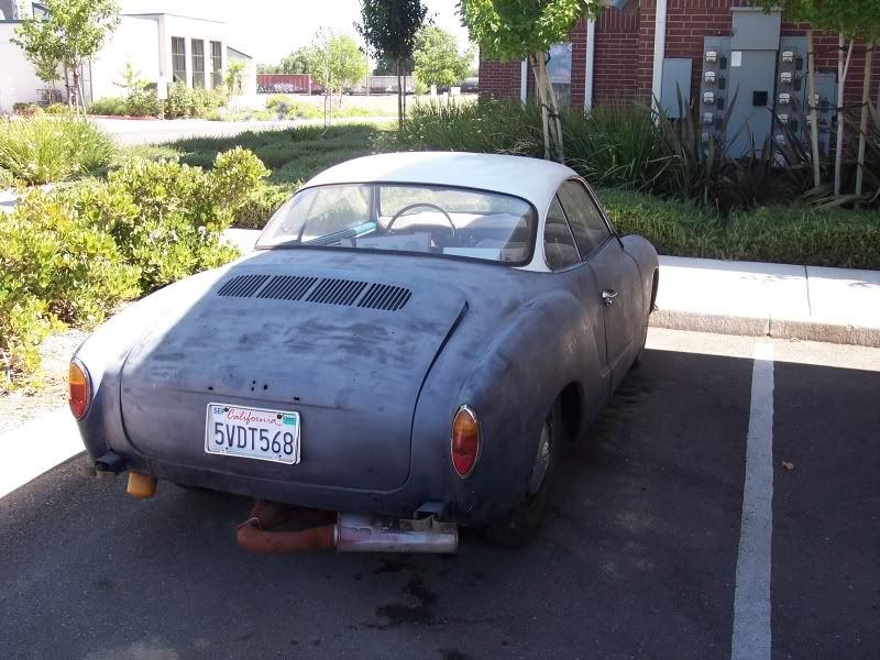

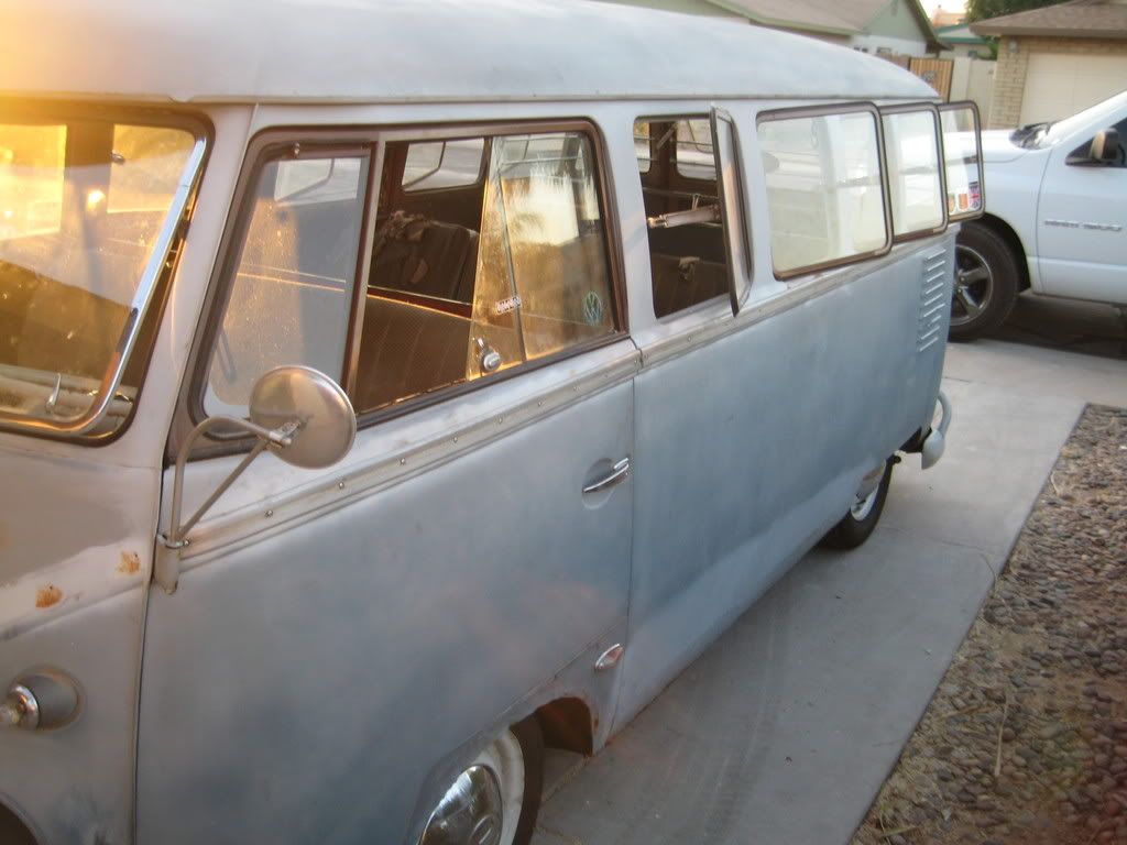

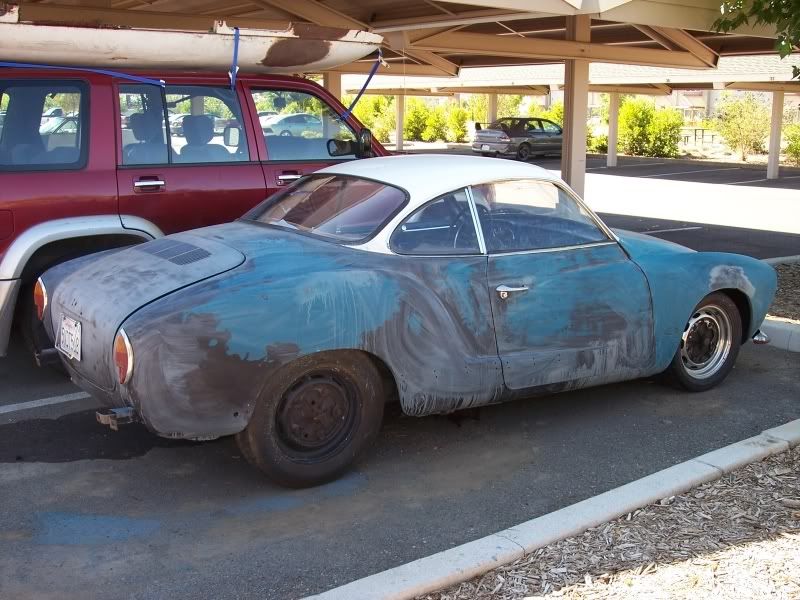

Just started doing some stripping on mine:
before
after
The OG paint was sanded real good prior to the primer. It is extremely thin.

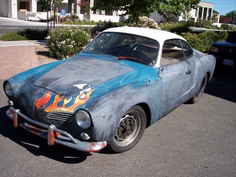

PostPosted: Mon Jul 02, 2007 1:39 pm    Post subject: Reply with quote

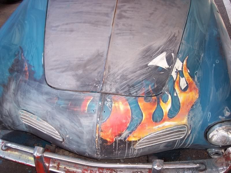

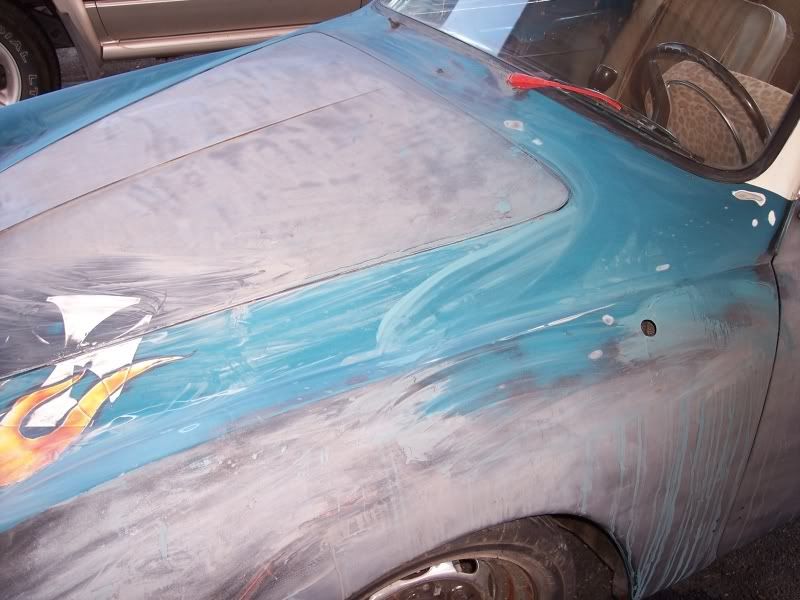

im striping primer off my '66 here, this thread has given me some ideas
ive just been using 800 grit wetsanding
like the bus roof on the Trooper? Laughing
