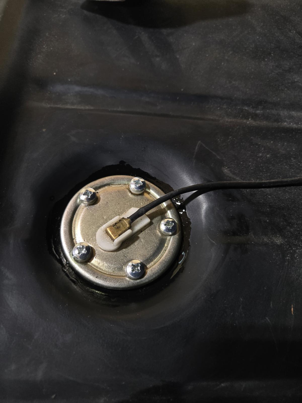

Took Kubel around to discover the fuel guage stopped working. Rolling Eyes No biggy. Since it seemed okay I took it to get some non-ethanol.
It was just still running super hot. I could not even touch the dipstick without a rag. I had put in the missing rear tin this morning (I am missing industrial tins but that would not make it this hot.)
Then it gave me a slow low battery start at the gas station. Shocked
Got home to discover this - which has plagued me my entire VW owning career. Why am I not surprised.
I always try to not overfill but I had no idea the contents of the tank.

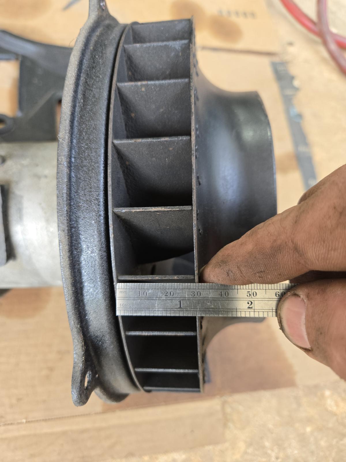

It has been a few minutes as we continue with some residential maintenance.

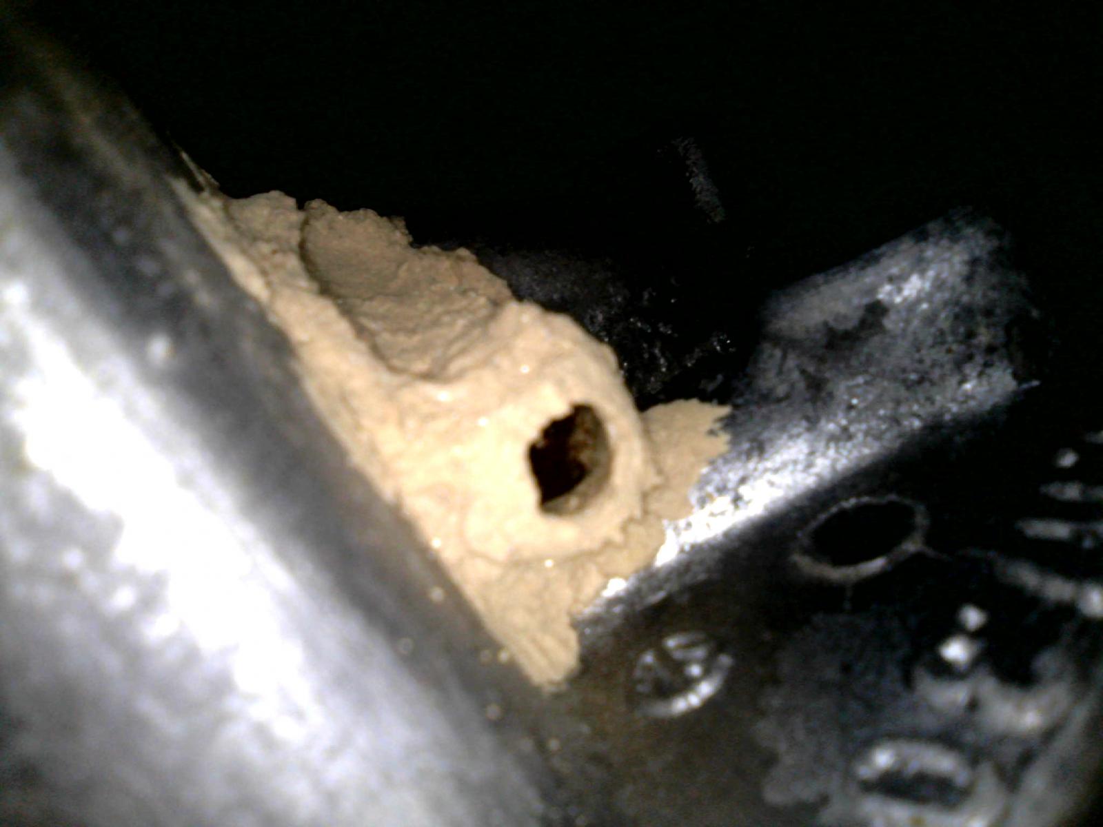

For thise I spoke to at KubelTreffen we surmised my overheating could be cause by debris inside my fanshroud or cooling tins.
Anyone thing this is enough to make me run super hot? Like in the 400-450° area?
This was in the fins on the left side of the shroud.
About the size of 2-3 fingers.

I cleaned it out and got it all put back together.
Things got in the way so I was unable to start it and see if that fixed my issue.

Ran it today and it seemed much cooler and did not smell super hot. Shot it with the laser and it showed cooler. I have not driven it yet but I have high hopes. I was able to hold onto the dipstick so I've got that going for me. The exhaust flanges were pretty hot. I am sure when I put the bigger Tri-Mill on there that could help a little.

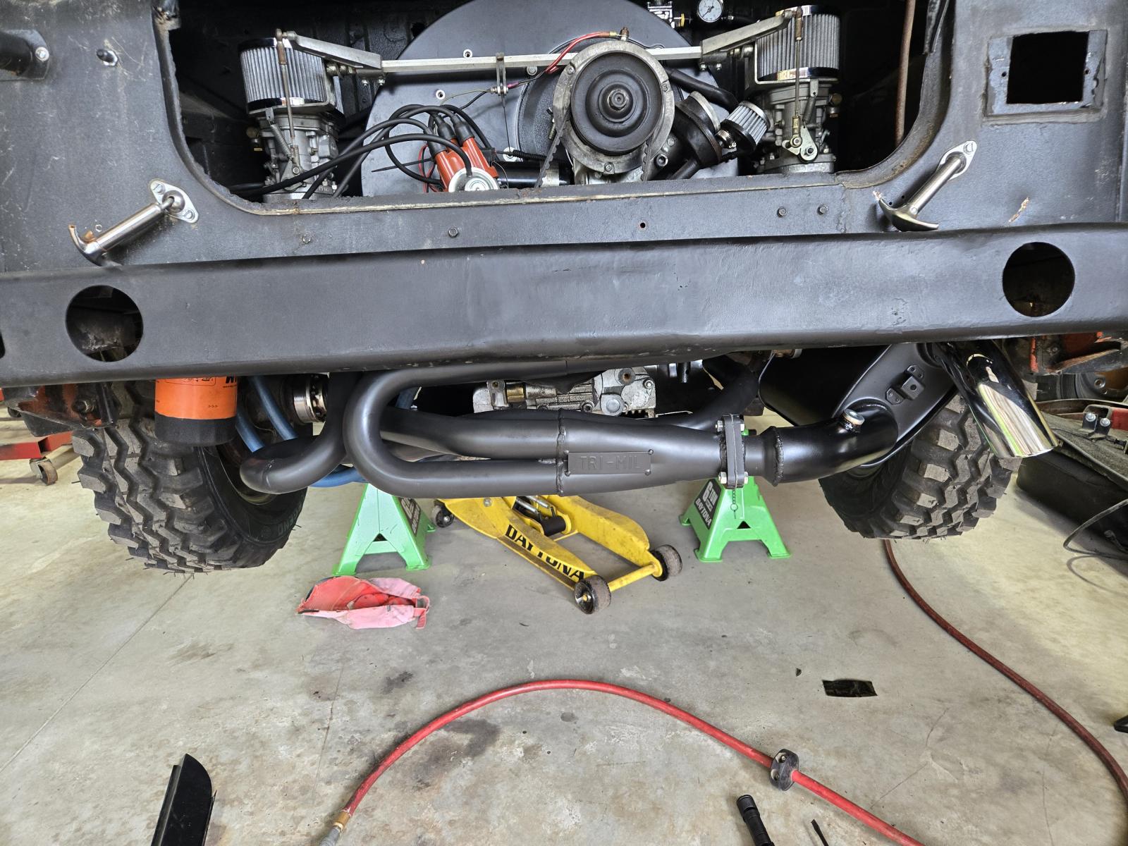

PostPosted: Mon Aug 04, 2025 4:19 pm    Post subject: Re: North GA 1973 Veteran's Addition Reply with quote
I bought this exhaust a while ago and decided to throw it on today. The old one was pretty beat up and was in the back seat of the car when I got it. I am hoping the large size will help the engine breathe a bit.
For anyone looking to put on a Tri-Mil, it does require some trimming to the front tins and tucks up pretty high toward the pushrod tubes. I am not really thrilled about how tight to the engine it is as it allows no room for industrial tins. The welds were so thick it was sort of hard to get the hardware tight on the flanges. New copper nuts on now.
Looks clean though.

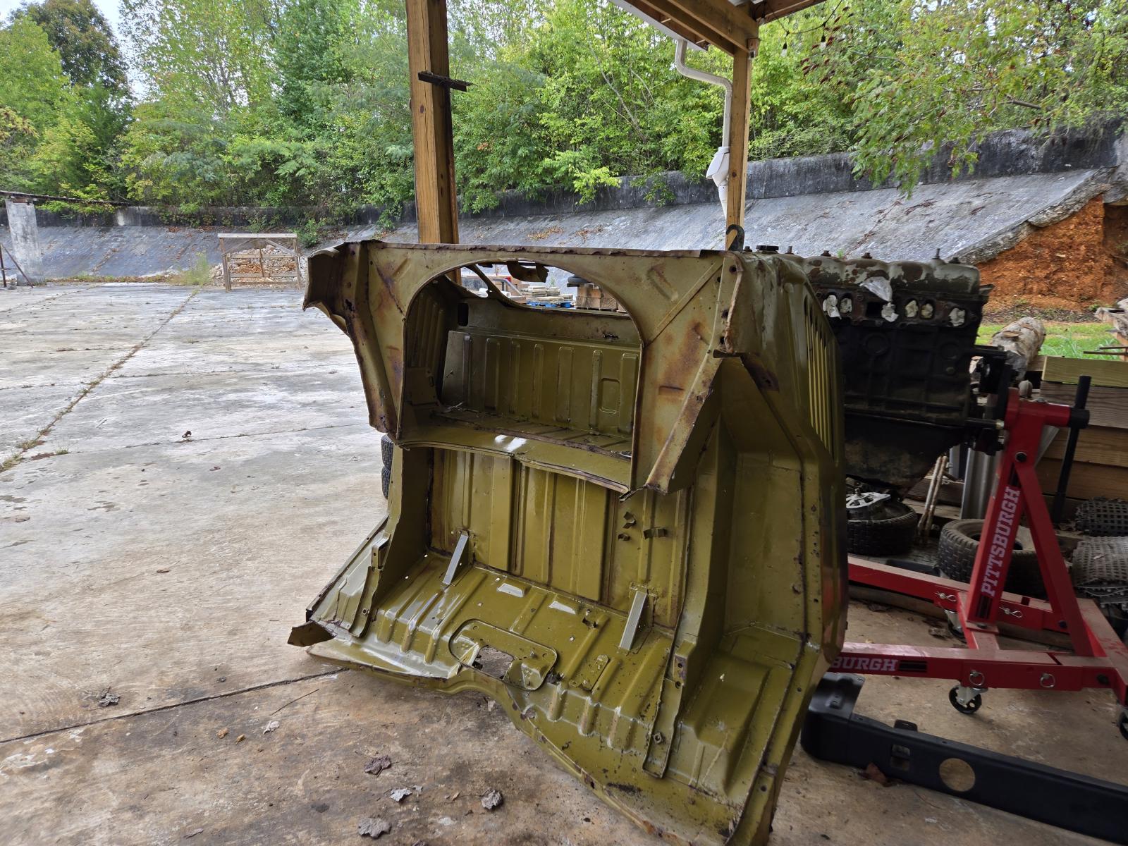

Still overheating.
Engine is coming out to pull all the tins.
I am sooo frustrated.

Rats on the overheating man! What's the giveaway (what's telling you it's hot now)?
Also,
I put a trimil on mine earlier this year, I noticed that dern muffler was rather hot (I was running dual 73 mufflers before, now I have the 1 muffler runs across under the bumper, I decided to exhaust wrap a majority of the "muffler" portion just to help cut down on the heat that I felt.
Seems to have helped keep the "felt" temp down a bit, the bumper even the engine lid would get right warm without it.
Plus I had a bad feeling i'd end up hitting the muffler and roasting myself somehow, so trying to be safe.
Unknown if that muffler is got anything to do with the "hot" problem but i'm sure you feel the radiant heat from it for sure.
I've been loosely following along, that was your major recent change right?
Stay on it man you'll get it, sorry it's being a mutha. Hope you find the culprit.

Head temps and oil temps are still too hot.
After a short drive I could not touch the dipstick without burning my hand. Shot it with the laser and it is still 300 to 400° F head temps. Dipstick was 200.
The bumper was too hot to touch as well. Everything is so hot the paint is peeling off the alternator stand.
I thought the trimil would help as it has the larger tubing than the old empi header.
Not knowing the full history odf this car, I should have pulled the engine forst thing. Oh well.

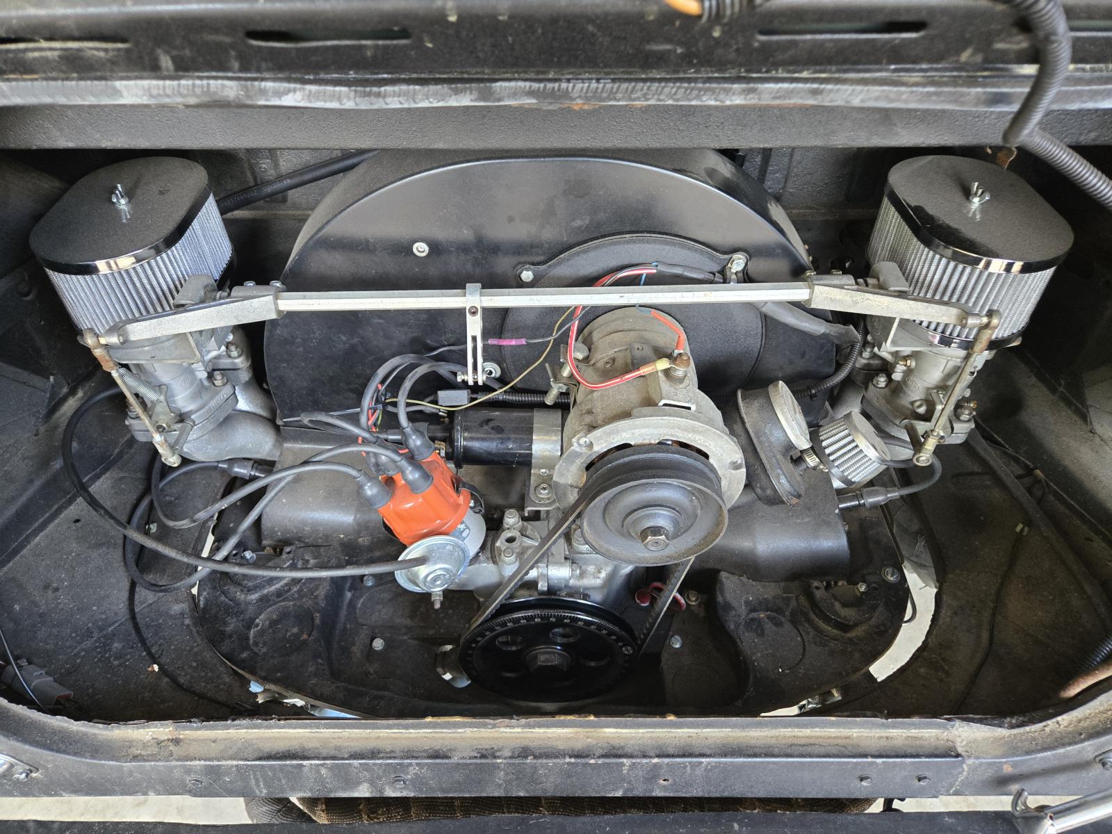

PostPosted: Fri Sep 26, 2025 11:34 am    Post subject: Re: North GA 1973 Veteran's Addition Reply with quote
Replace the engine seal, missing in this picture. No gaps allowed. This brought the temp down for my Thing.
doublecanister
Joined: September 23, 2008
Posts: 1222
Location: Richmond, Va
doublecanister is offline
PostPosted: Fri Sep 26, 2025 1:31 pm    Post subject: Re: North GA 1973 Veteran's Addition Reply with quote
Good catch vws-microcars4jim!
Yeah fixing that can make a difference, easier with engine out but i've heard you can do with engine in.
OR
as a test, you "could" try stuffing it with something to fill the gap, but it'd need to be flame retardant material...temporary as a test but yeah, that gap should not exist.
I replaced my gasket when I had the engine out, wasn't "too bad to do" but I did have to work the gap it fits in as a prev owner engine removal mangled the gap that holds the gasket by the transmission, not bad but enough I had to fix.
I am aware that is missing. Unfortunately some PO hacked up the rear apron in a way that there is no place to attach it for about a 3rd of the way around.
I actually have another rear clip and may go ahead and cut all that messed up stuff out and replace it while the engine is out so I can add the seal. But I don't think it is going to bring the temps down 100°.
I really thought getting that dirt dauber out of there would have fixed it.
I need to break the tins down and ensure they are properly installed and there is no debris in there. This car has no baffles so there's that.
Think again. Seal up every hole and gap, including that odd rectangular hole on the back of your car. They are all pulling in exhaust-temp air to your fan. You will overheat even at 50F air temp according to countless forum posts throughout this site. Do a search using keywords "overheating, engine seal". If that isn't enough, I read in the Gene Berg book of technical articles that just a small tear in the engine seal will raise meaurable engine temperature by 12F. And you don't have one at all. A 100-degree drop is concievable. Berg also stated that aftermarket fan shrouds will increase temps by 50F as none of them have the internal deflectors/baffles that a stock shroud has. So get a stock shroud while the engine is out. That right side gap in your tin is going to cause overheating no matter what you do, so fix that for sure. Hope this helps you.
Jim

PO had a 30mm fan in the dog house shroud!
I can't believe I figured this sht out!!
Has to be the main culprit.

So I pulled the engine and discovered incorrect hardware and a missing upper engine mount bolt.
Pulled the tins and everything is clear and clean. I can see where there had been some other dirt daubers. Little bastards.
So now on to addressing the holes and missing engine seal channels.
You can see the mess I am dealing with.
Fortunately the car came with this.
I am going to do a removeable valance/apron mod while it is out and I am awaiting a new fan and some other stuff I discovered broken or missing.
