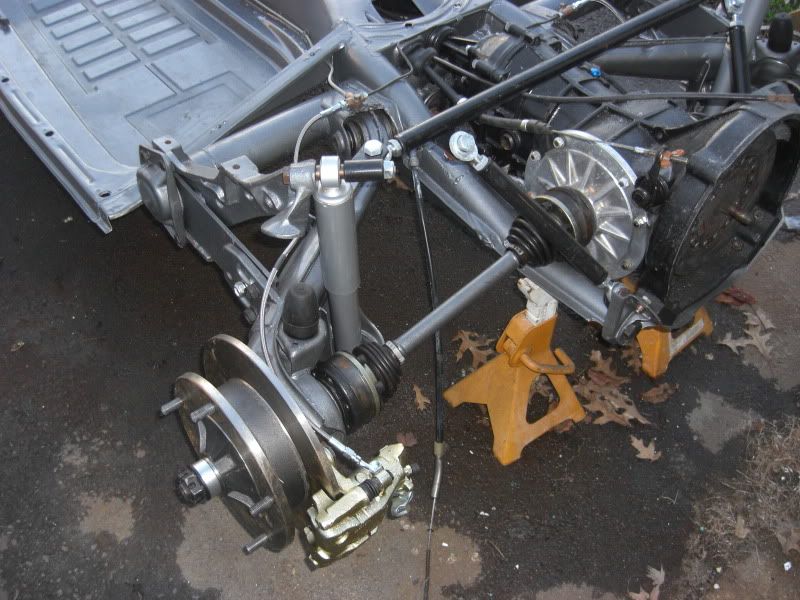

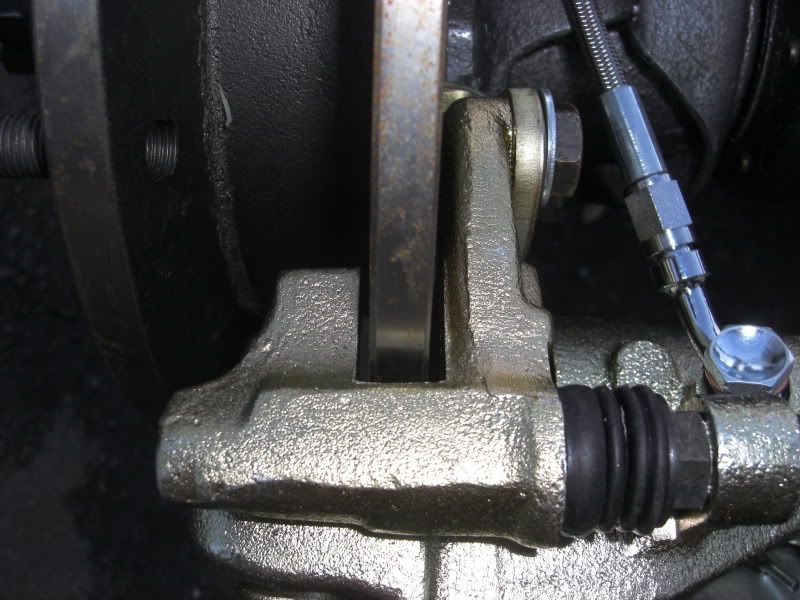

I bought the wide 5, rear empi brakes from Action Imports and installed a couple weeks ago. Everything went smoothly. I bled the brakes and the pedal pressure is solid. I am using braided lines all the way around. Here is a pic of how the disc lines up with the caliper.
The camera angle is off a bit, but the disc lines up just about dead center. There are no spacers between the caliper and the mount. Also, I didn't see any flexing when my son pumped the brakes. The next test is on the road, if I ever get this thing done Very Happy
