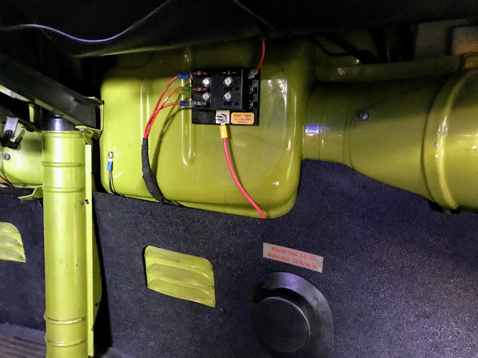

PostPosted: Sun Oct 22, 2017 8:14 am    Post subject: Re: Adding a second battery..how to...with photos FAQ Reply with quote
Thank you, after a lot of reading I understand it all a bit better now. Installed my aux battery on the driver's side of the engine compartment and from there I ran two 10 gauge wires up to the front - one under the dash and one in the cabinet. From there I installed two new fuse blocks I picked up from Auto Zone and tapped into those to power all my accesories: radio, LED lights, some USB ports, and a couple of 12V power sockets.
I also moved over the power to my Westy overhead light and dome light so that they don't run on the starter battery anymore.
For the radio, I used the GoWesty toggle switch so that it can be powered off the key (like normal) or switched to run from the aux battery with no key in.

PostPosted: Sun Oct 22, 2017 8:47 am    Post subject: Re: Adding a second battery..how to...with photos FAQ Reply with quote
looks good. i am in the middle of doing this myself. hope mine comes out as well

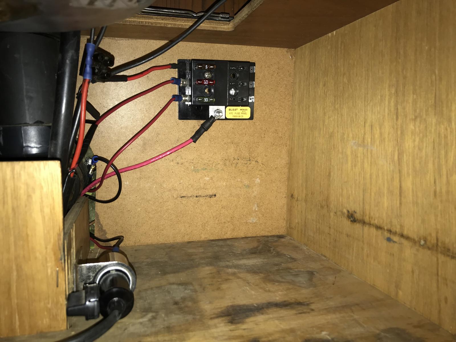

PostPosted: Wed Oct 25, 2017 5:36 am    Post subject: Re: Adding a second battery..how to...with photos FAQ Reply with quote
ok, for whatever it's worth this is how mine came out. everything is under the jump seat because i have a refrigeration unit in the spare battery tray.
running: fridge, interior lights, fan, stereo, and water pump. battery gauge is kinda cheesy but it was free and i needed it to cover a hole made by po
