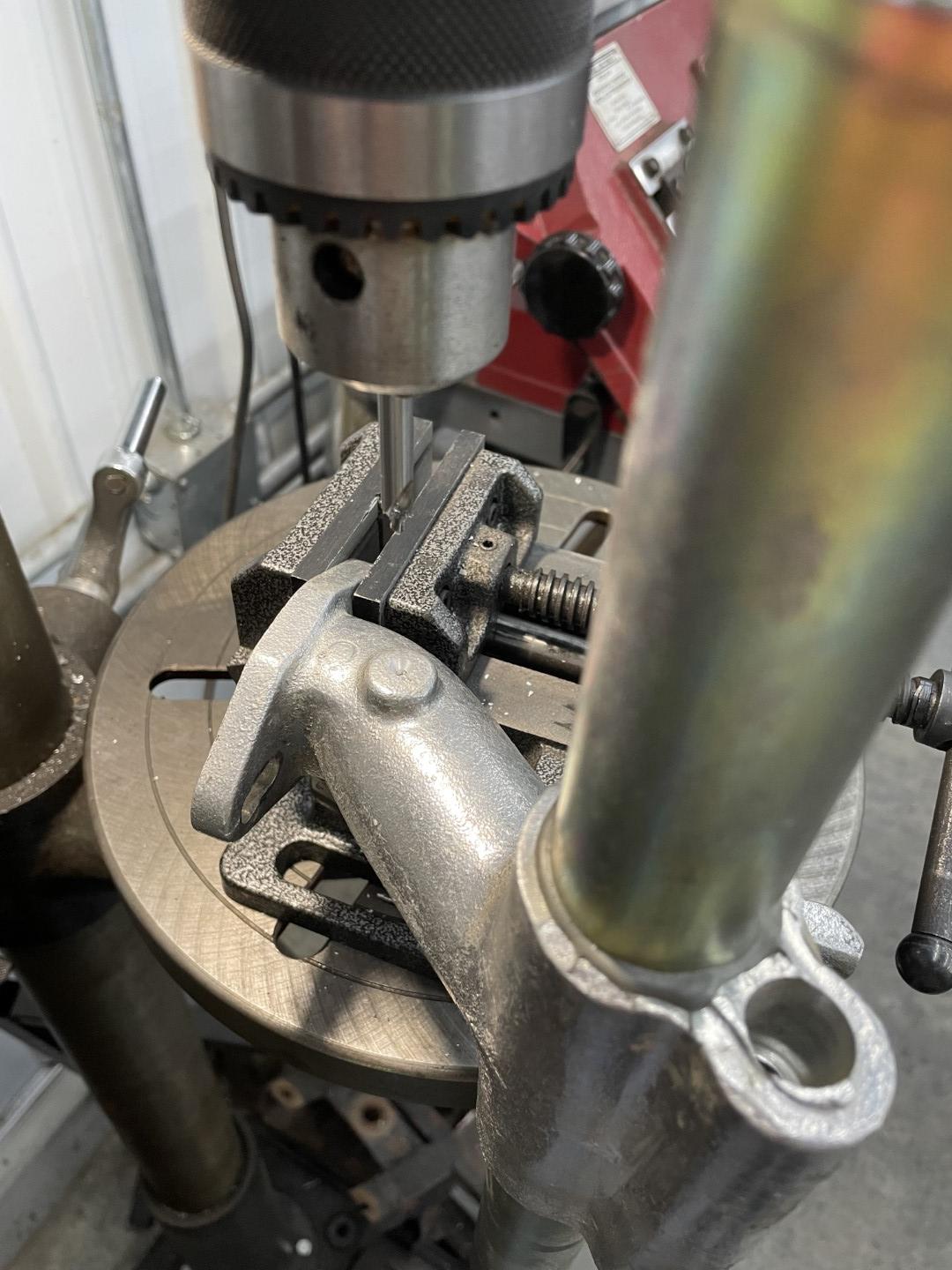

In the interest of science, I'm going to pull the intake manifold and drill/tap this boss to temporarily connect a vacuum gauge. I'm interested to see if the little H30/31 carb is holding me back, or if it's the rest of the combination (heads/cam/CR/displacement).

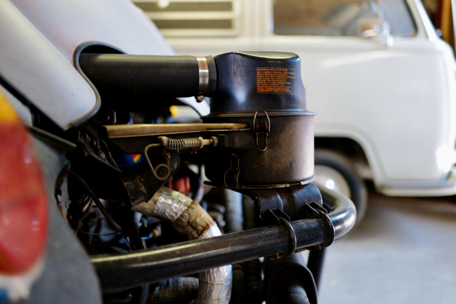

The single barrel carb and the Donaldson air filter is definitely restricting your potential.
A single Weber IDF 40 is the way to go. You can run an air box and still run your donaldson filter, but in your area, you aren't really in the dry dusty conditions that warrant that much filtration. You'd be better off with a large K&N filter and an outerwear or UNI foam wrap.

OTC Filters (formerly R2C filters) work well and are cleanable.
Yes the best are the Donaldson style are the best so far as the incoming spins dropping most of the dirt out before it can get to filter.
The Donaldson ones I use, actually have two separate paper elements inside each housing.
I use one for each IDF type carburetor.

My buddy has been driving this baja for 40+ years in Moab. He uses two bus air filters.
