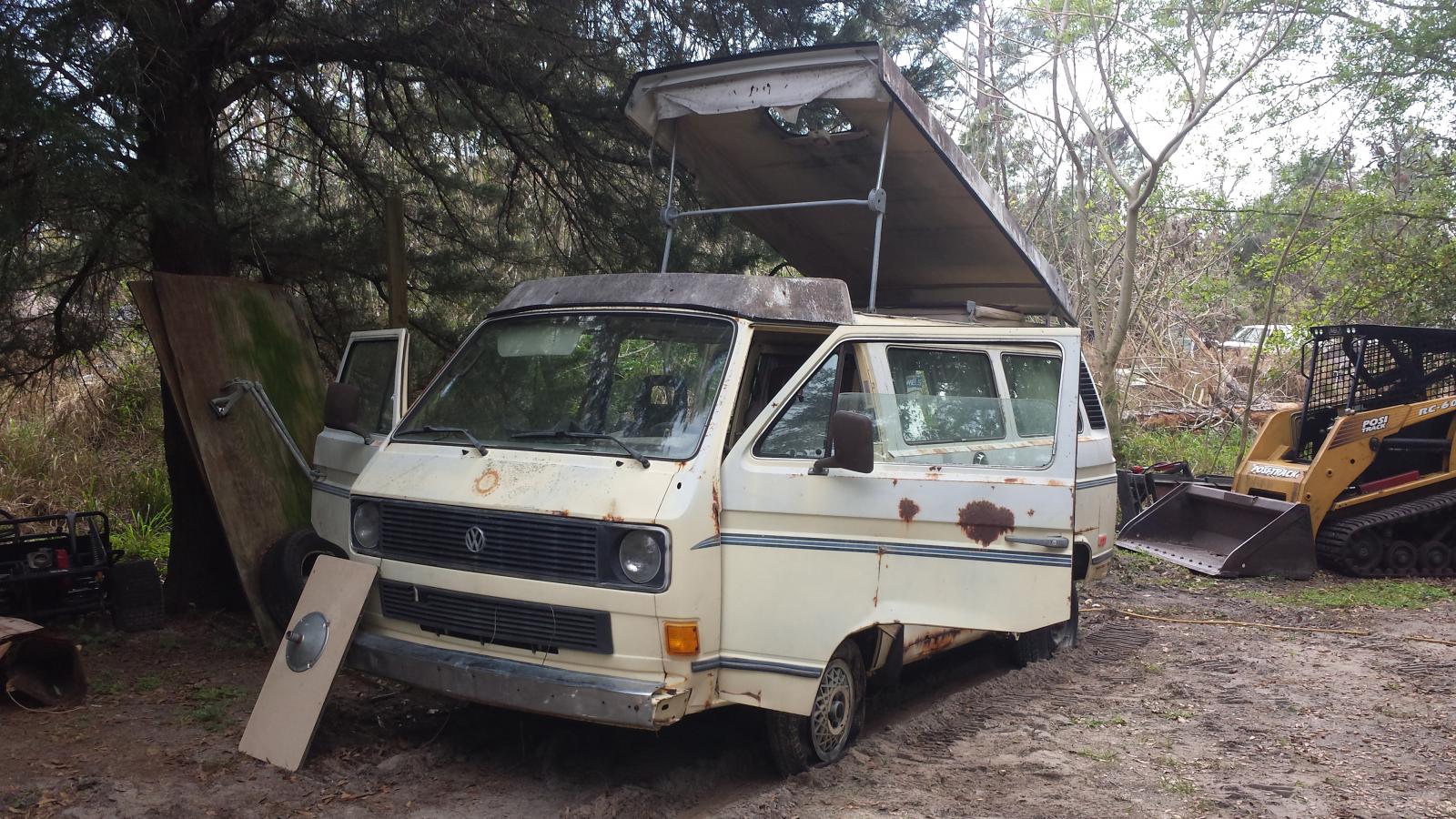

Ok, well as I mentioned I pick up a rugged Westy for my donor parts.. I'm thinking that paint will buff won't it.. Laughing
It was pretty nasty inside and I'm not sure what I can salvage, but I was mainly after the pop top parts. This van sat on CL until the ad expired because they wanted too much for it. I saved the number and contacted them a month or so later and got a decent deal on it.
At some point, someone loved this poor old Westy, but sadly that was 10 or 15 years before they left it parked on a storage lot where it became the beat up toy. Such a shame to see a complete intact van left to this kind of neglect. It only had about 130k miles on it, assuming the odometer was still working.
Going through the van and cleaning it up enough to work on, I suspect this guy was probably parked in pretty good shape. It still had both tables in it, the jack was in the factory bag.. However years of neglect left it's toll, it will have to live out it's days as a parts donor..
Oddly enough the pop top assembly works better on this beat up thing than my previous Westy did.

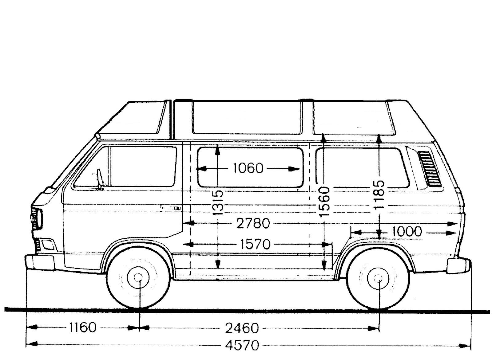

How about the Joker 5 from the early 80s. A bit higher in the rear, but the same luggage tray in the front:
1991 VW Multivan syncro 1,9 TD
OddN
Joined: August 19, 2010
Posts: 690
Location: Northern Norway
OddN is offline
PostPosted: Fri Mar 13, 2015 3:01 pm    Post subject: Reply with quote
Or maybe the Reimo roof that Dai has on the syncro:

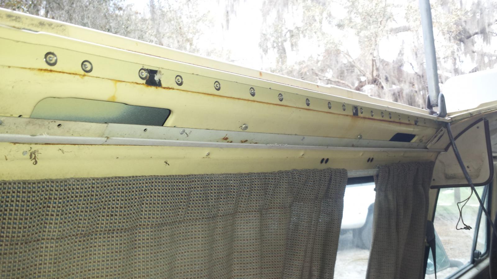

Continuing on..
I've cleaned up the Westy so I can at least work inside it with out too much smells and grime. I also removed some of the cabinets, most of which are pretty bad with the water damage/rot and wont be salvageable for much more than hardware. The van does have a complete drive train though so I'll likely try to get it running and make some money back from the parts.
Today I've started the process of every Tin Top's right of passage whom wants to grow up to become a pop top some day..
I'm using a cordless drill inside because it's easier to get into the odd angles. I've also been using a simple puddy knife to check and make sure the welds are cut out. Works pretty well and doesn't distort the sheet metal.
I'm still undecided which route I'll take when it come to transferring the roof section to my tin top, but I figure any way I go, I'll still have to drill out all the spot welds on the inside.

Just a lil update. I managed to drill about 95% of all the spot welds which remained on the donor roof. In fact I was able to do each drip rail in roughly an hour per side.
Due to this, I've decided I'll go forward with the drip rail roof swap as the drilling of the spot welds was not as bad as I expected. I'm not however going to get into the windshield section as I'll just splice the roof somewhere under the luggage rack most likely.

I have a dilemma which I haven't resolved yet.. I've cut the roof top off the donor Westy..
However I still haven't decided how I want to do the swap..I can't decide if I want to attack it at the drip rails or do the over lap method. I see the benifit and draw backs to each method and I'm stuck debating which way to go, because once I start either method, it's too late to change my mind.
One issue, which tugs at me, as far as the drip rail method, is that I had a hell of a time getting the rear secton of the donor roof seperated from the inner supports. There were welds and spot welds which were impossible to get to, with out removing a large section of the built in rear supports.
I don't think the tin top roof is tied in the same way as the Westy roof, due to it not being supported on the inside around the inner panels. None of the conversion topics seem to cover the removal of the tin top in very much detail, it's always kind of skipped over.
As it sits now, if I do the drip rail method, the donor roof it about 90% ready.. Would just need to remove a few brackets which I've left for now. If I do the overlap method, I'll have to trim it down quite a bit.
