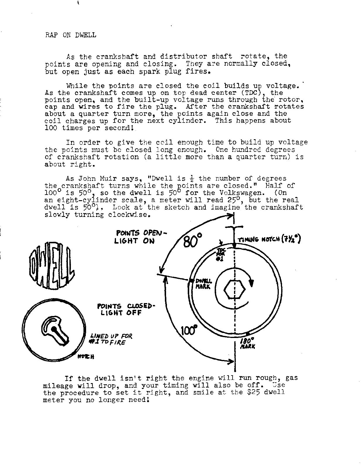

I agree that spring loaded point set with a window on the cap was brilliant! Made it a 10 second instead of 15 minute job. More accurate, too.
The thing about using dwell angle instead of gap is that as soon as you get a little 'tit" built up on one of the points, the feeler gauge method will set them too far apart.
Many years ago I made a Muir-style write-up on setting points without a dwell meter (for the Type 1 engine):

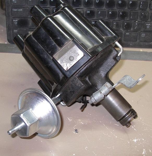

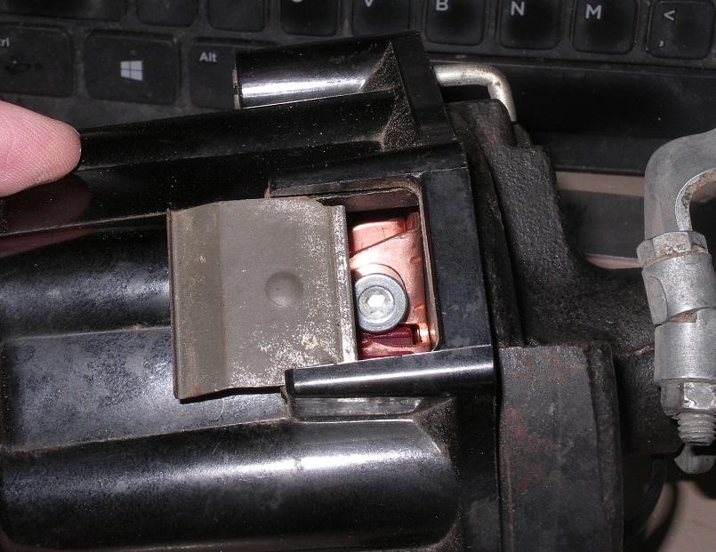

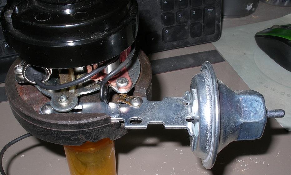

Here is a odd ball VW distributor I bought off of a member here, It uses GM Delco parts, The cap is like those used on V8 GM vehicles but it it only has terminals, the others bosses are there but cut flat and not drilled. It uses a standard rotor from a V8 and the same points and condenser, the vacuum advance canister that was on it was hard and did not work so I replaced it with a Moroso adjustable unit. It has the window in the side for adjusting the points, I put a set of Corvette points in it. the only thing I don't like about it is it has no O-ring groove in it, it has enough meat to turn one but I don't have a lathe yet.
It uses GM counter weights so you can buy aftermarket weights and springs to tune it. Its a pretty cool unit it is Cast Iron and weighs a ton, I have not been able to find another cap so I may buy a GM cap and cut the terminals off and drill out the metal bits and fill the holes with epoxy if I ever need too.

PostPosted: Mon Jul 15, 2019 5:41 pm    Post subject: Re: Setting dwell angle? Reply with quote
Casey
Just because you can does not mean you should

PostPosted: Mon Jul 15, 2019 6:12 pm    Post subject: Re: Setting dwell angle? Reply with quote
The Davis DWI uses a modified GM HEI distributor.

PostPosted: Mon Jul 15, 2019 7:50 pm    Post subject: Re: Setting dwell angle? Reply with quote
bsairhead wrote:
Casey
I don't understand what you mean, are you saying its junk? are you saying there no use for it? have you ever seen another one like it? I bought it to put in my collection of VW distributors, I will probably never use it.
I thought maybe somebody here might be interested to see something they have not seen and will probably never see again, I like to see weird one off and limited production and performance parts for VW's because not much of it is left. People throw it away or it sits in a box getting rained on until it is no longer useful to any one.
Casey

KTPhil Premium Member
Joined: April 06, 2006
Posts: 35643
Location: Conejo Valley, CA
KTPhil is offline
PostPosted: Mon Jul 15, 2019 10:22 pm    Post subject: Re: Setting dwell angle? Reply with quote
Have you fitted it to a VW engine? It looks so big and heavy I'd be a little wary. I'm not sure if it interferes with nearby parts like the fuel pump. But it's a cool idea! Thanks for sharing.
