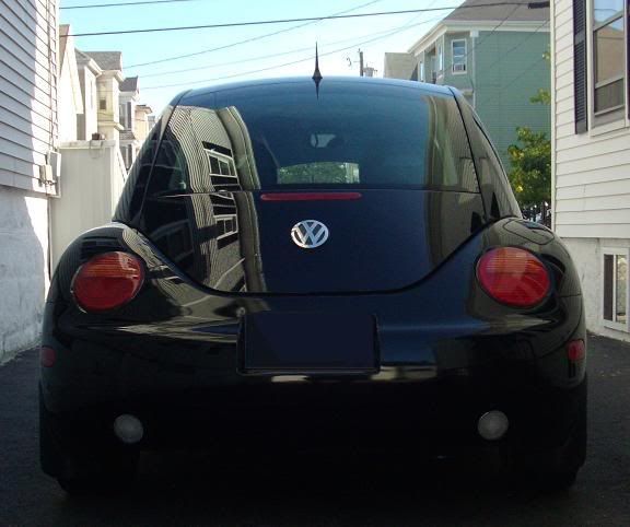

bongon247 is offline
PostPosted: Sat Oct 10, 2009 2:49 pm    Post subject: Reply with quote
because you think so?
my '68 is lowered 2" in the front + 145's stock in the rear... and it'll out handle your new beetle...
i stop more quickly, much more agile in the corners, and i fail to see how any of this makes me more dangerous...
please explain...
