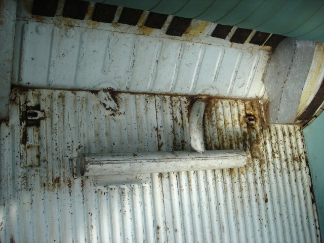

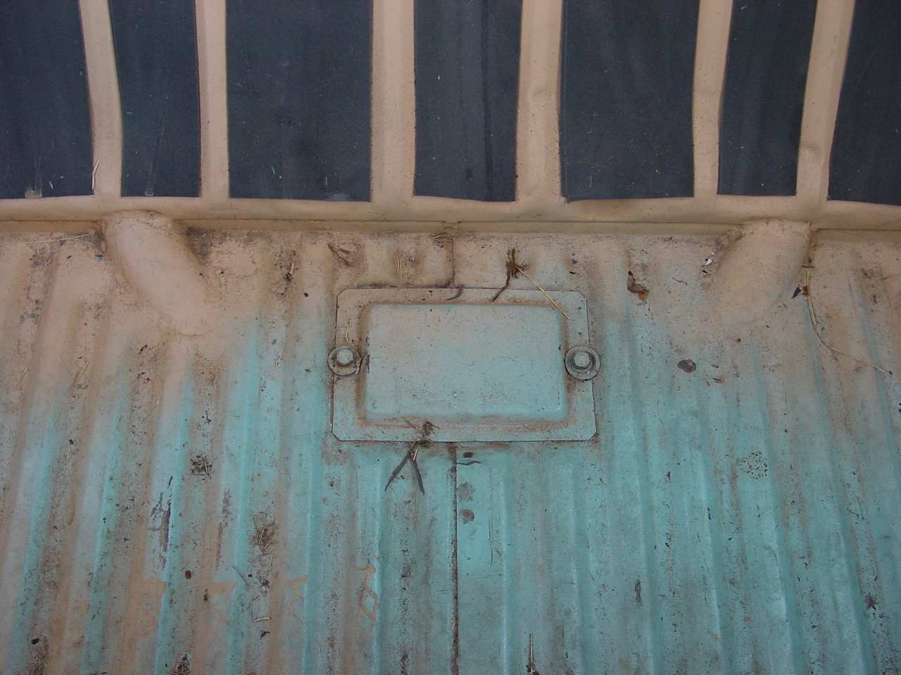

nize wrote:
Has anyone got a god picture of how the pressing for the heater tubes looks in the part I am making? I have nothing left to look at Smile
Heater tube only cuts into the very lower edge
Appears seam welded all way round the tube
Same positioning if running a heater log or not
Click for larger images.
BD (cuts in below where ribs are close together):
Ribbing differs on non-BD:
-StockRocks-

RockStock wrote:
Thanks alot! Then it is nothing major. I can fix those cuts later on. Thats good!
