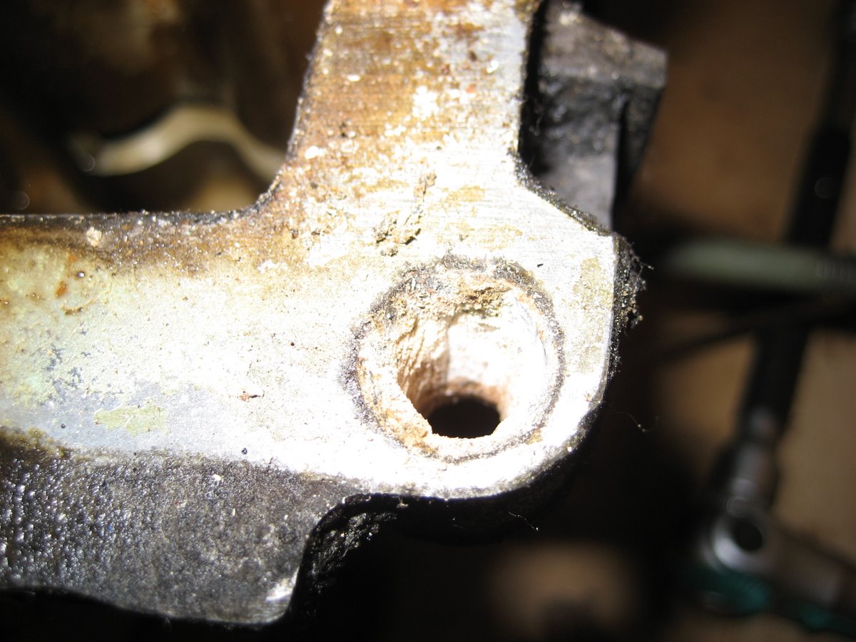

PostPosted: Thu Dec 16, 2010 4:52 am    Post subject: Reply with quote
One of the bolt holes for the case (the hole at the bottom of the transmission-mount side) is very badly corroded. The aluminium is turned to almost 1/8" of white crud. All the other bolt holes look very nice.
Any idea what happened here? Should I drill this out cleanly and reinforce it with a steel insert?
Thanks!
