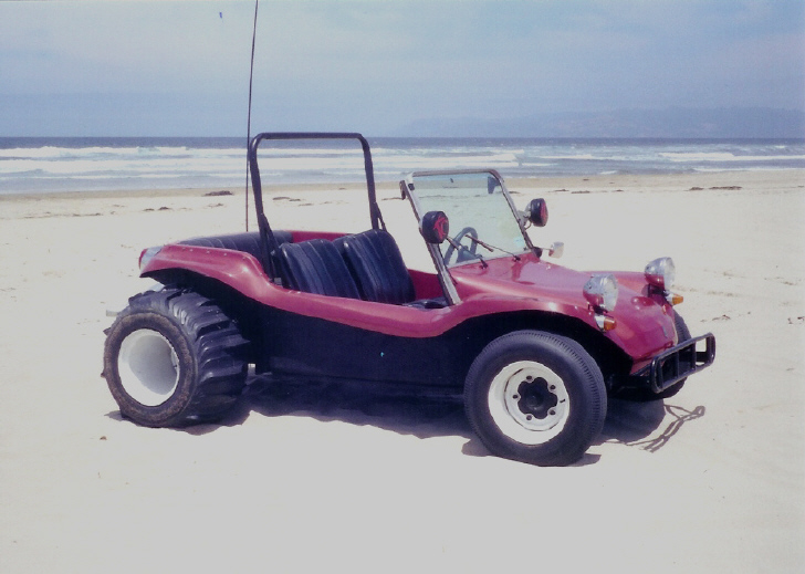

Running these Padla Trak "stagger cut" for 36 years in the sand on our Manx. They are 16.50-15 mounted on 18" rims. We run a 1835cc with a very low end cam which gives us a very strong and responsive first gear and with this size tire that is what you need for good all-around performance in the dunes.
What I have learned in all our years and different sand tires is wider is better as it gives you more floatation and bite in the sand. But you have to match the power and weight of your Baja or buggy to the tire as you can easily overmatch them with too wide of sand tire.

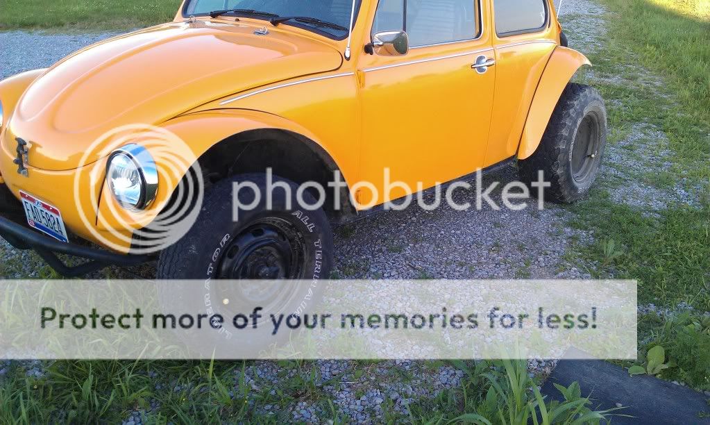

made a switch.
Still stock 4.5 inch front wheels, but with 205/75 15 Liberator All terrains.
No issues so far.
rear tires LOOK a LOT smaller in the pic, but in reality they about a 1/2 inch taller than the fronts.
