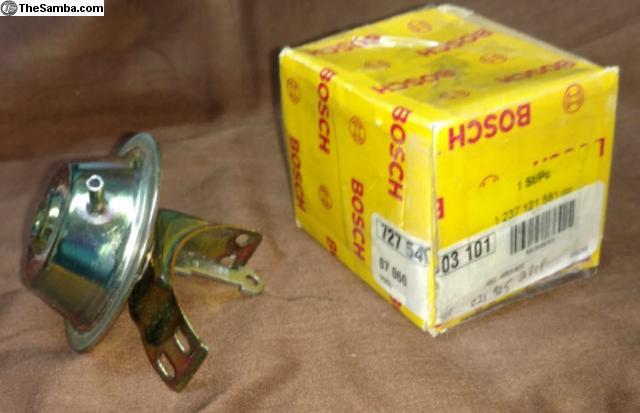

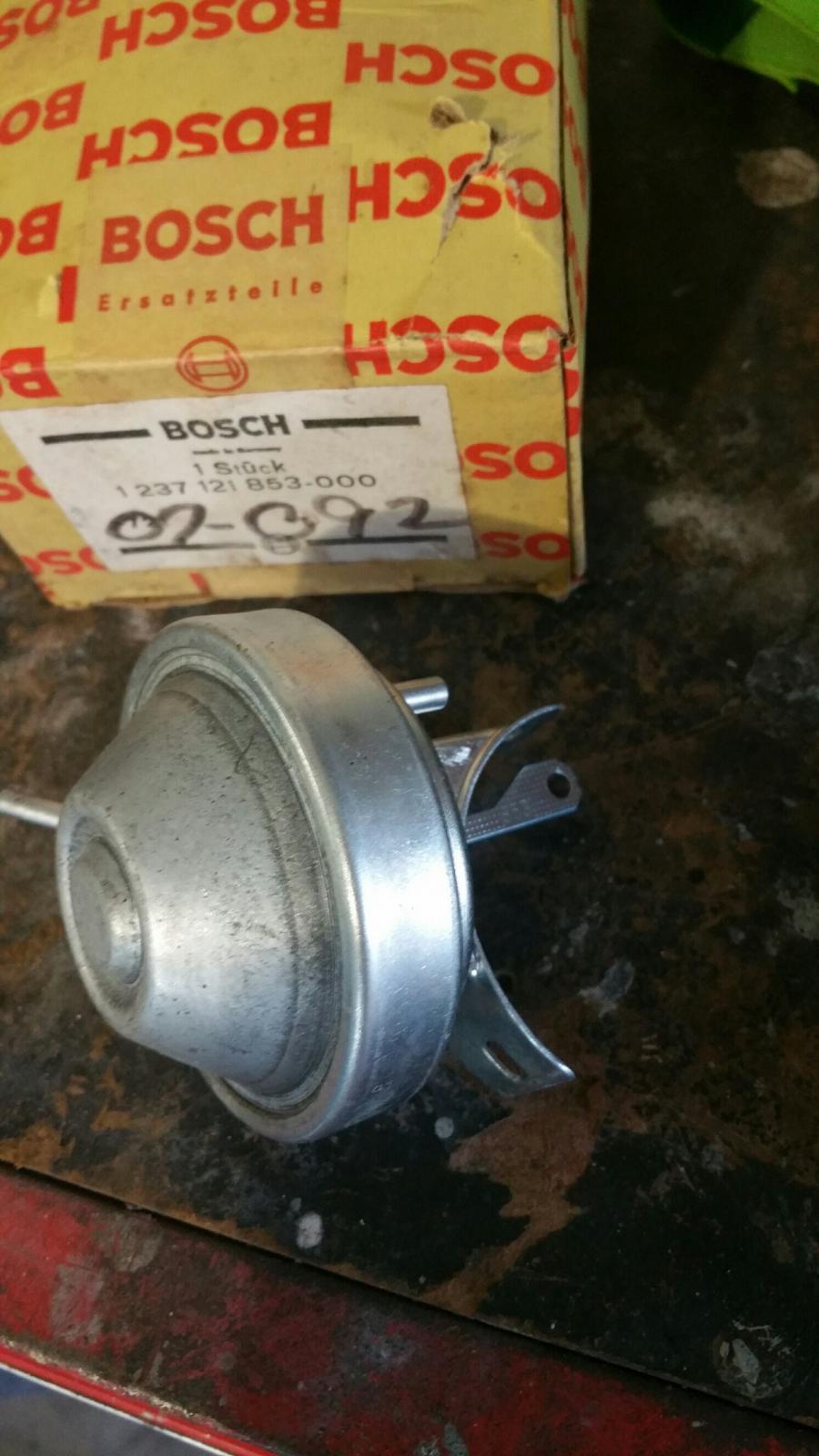

I don't understand what things like DVDA, SVDA or Federal means - can someone point me in the right direction as to what diagram to follow? Thanks!
SVDA single vacuum fitting, dual advance. Has one nipple on the distributor, vacuum canister.
DVDA duel vacuum fittings, dual advance. Has two vacuum fittings on the dist. vacuum canister.

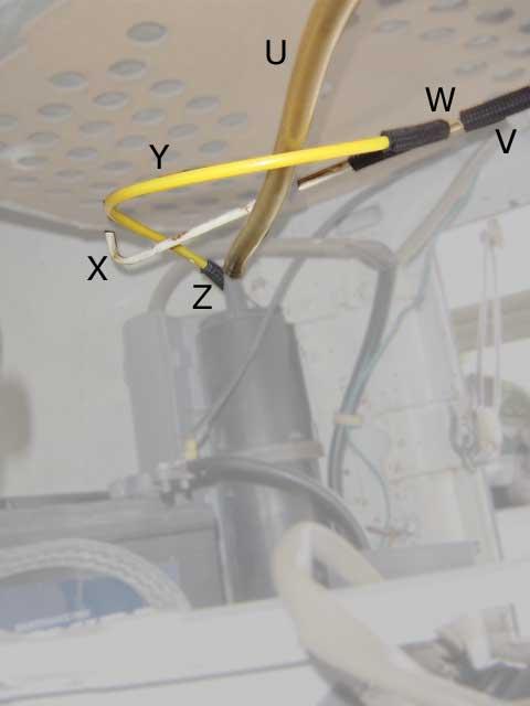

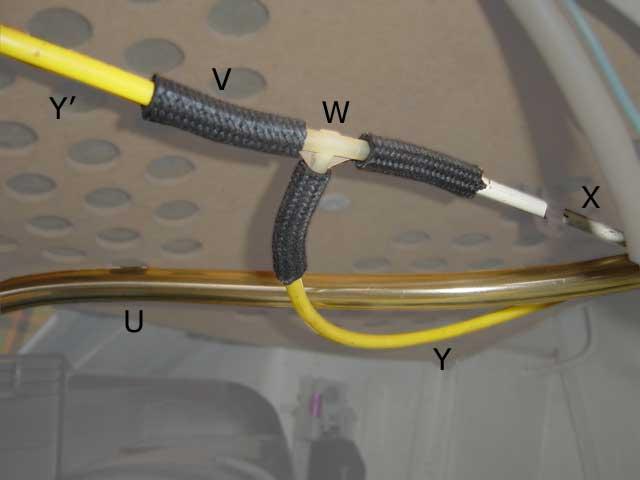

Posted: Sun May 28, 2023 6:37 pm Post subject: Re: Fuel Injection Diagrams Collection FAQ |
Quick question. I know this is an old thread and there is a ton of information here that is a great help. I had to redo the entire vacuum system on my '78 bus and the vapor line hoses as well. On the fuel vapor hose chart, where it comes off of the T with the letter W connection to V then to Y' (not Y), I cannot figure out where that fuel vapor hose is supposed to go? I have looked everywhere and cannot figure it out. I have a cap on it but I would like for it to be exactly like it's supposed to be as my bus is having a hard time idling and if everything is correct then it helps to narrow down the issue which I do believe is in the AFM.

Welcome!
Tank fumes come from both sides (Y' and X), then through that Tee (W) to Y which leads to the charcoal canister beside the RH tail light, if yours are capped off the tank can't vent and may be part of your problem. _________________ Rust NEVER sleeps and stock never goes out of style.

tonytoney Samba Member
Joined: May 20, 2022 Posts: 2 Location: Georgia
Posted: Mon May 29, 2023 5:31 am Post subject: Re: Fuel Injection Diagrams Collection FAQ |
| busdaddy wrote: |
Welcome!
Tank fumes come from both sides (Y' and X), then through that Tee (W) to Y which leads to the charcoal canister beside the RH tail light, if yours are capped off the tank can't vent and may be part of your problem. |
Actually, I am connected to the canister correctly and all connections are made correctly except the Y' coming off of the W tee. I don't know where the Y' connects to from there (what point on the engine, etc.?) so the Y' is what is capped. |

Posted: Mon May 29, 2023 8:03 am Post subject: Re: Fuel Injection Diagrams Collection FAQ |
| tonytoney wrote: |
| busdaddy wrote: |
Welcome!
Y' should lead across the roof of the compartment to the left side metal vent pipe coming from the air scoop area. _________________ Rust NEVER sleeps and stock never goes out of style.
